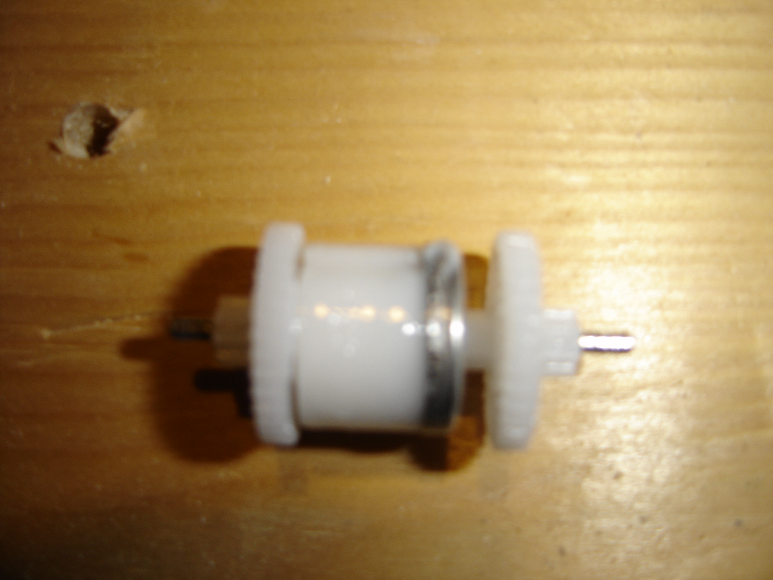

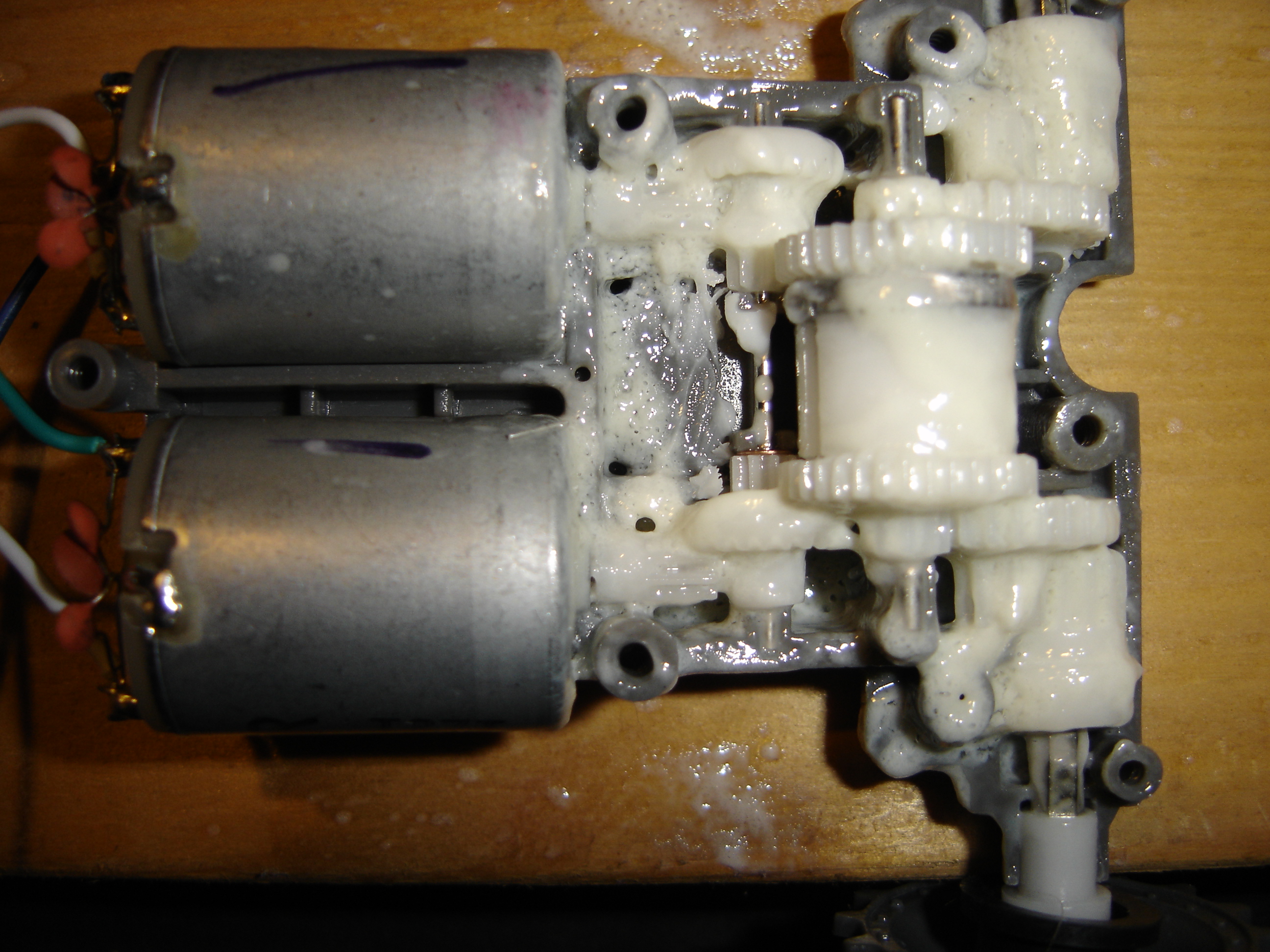

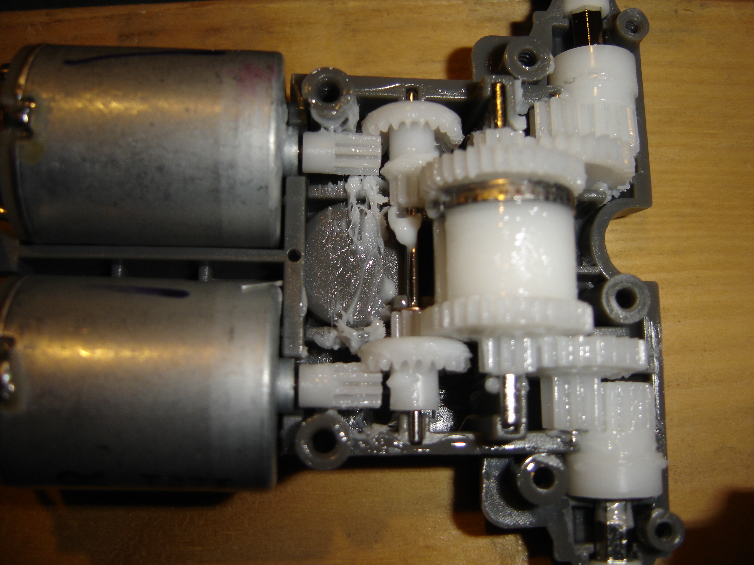

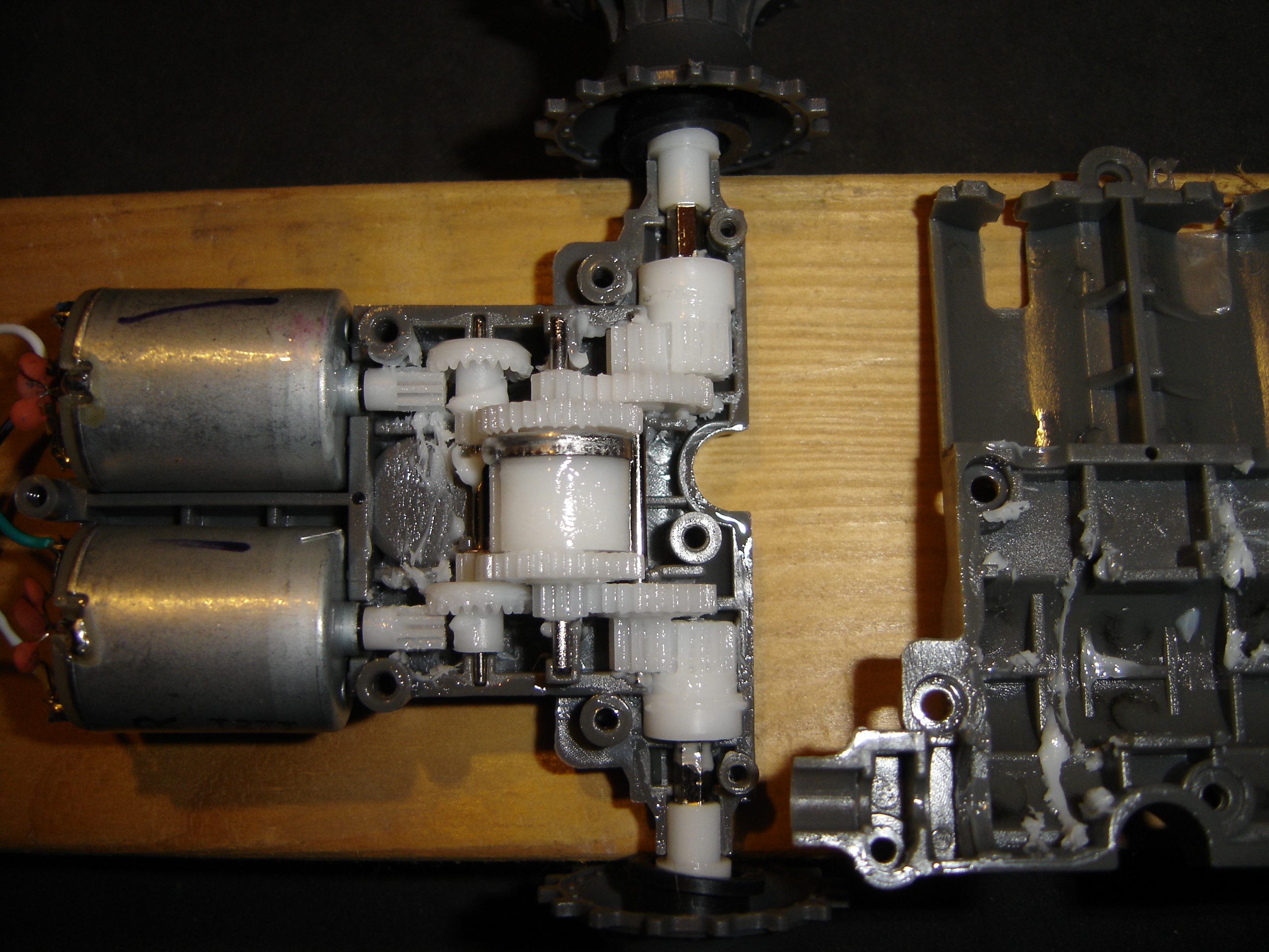

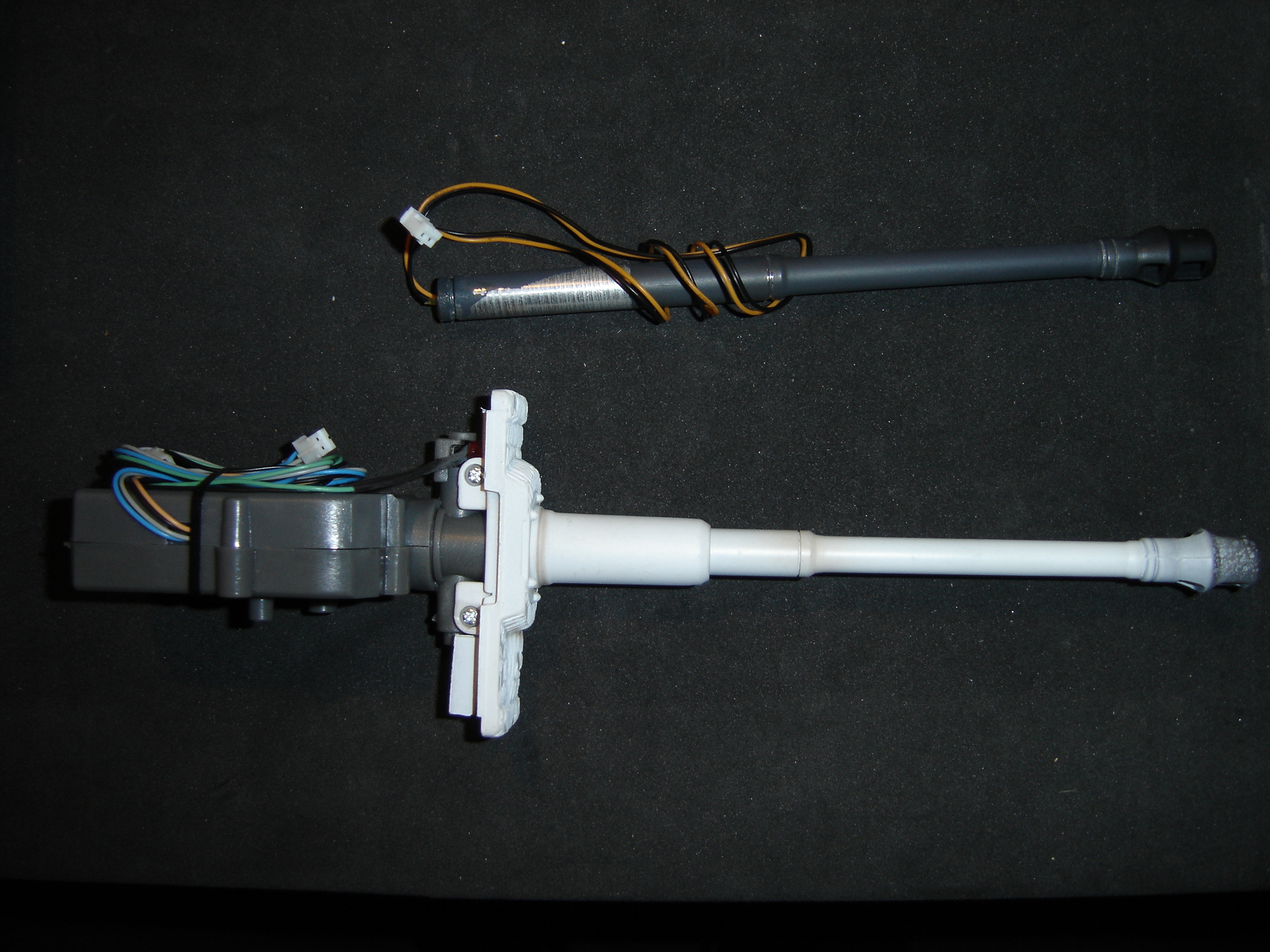

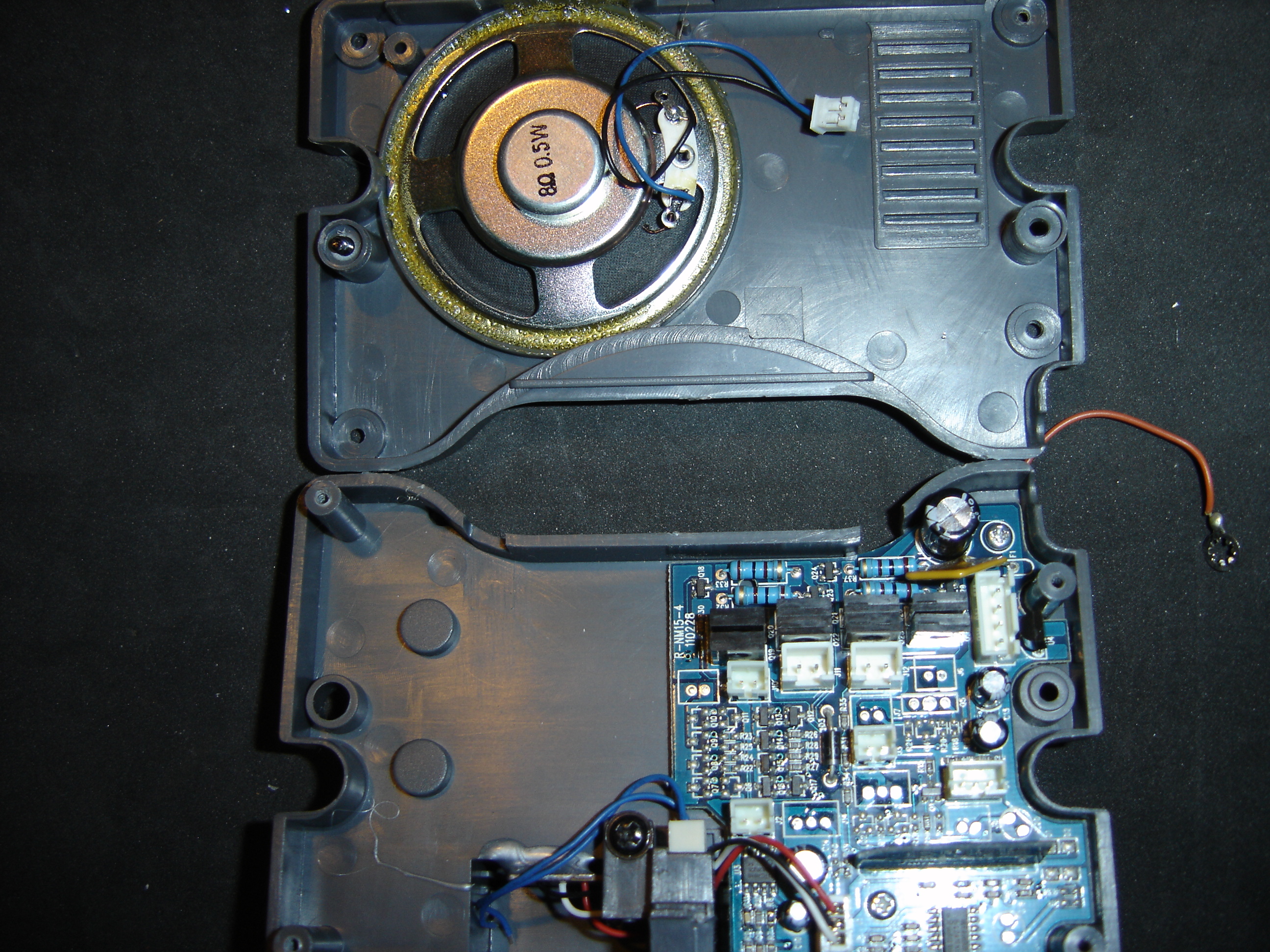

Chuck all the connections are on connectors on the main board inside the tank. Unplug them and reinstall them. Has to be a bad connection.
Here are some pics that might help that I took when taking apart some vs Tiger tanks.
Also some pics that might help if you work on the trans.
The not too good pic is the slipper clutch.
O yeah, have one long colt.
