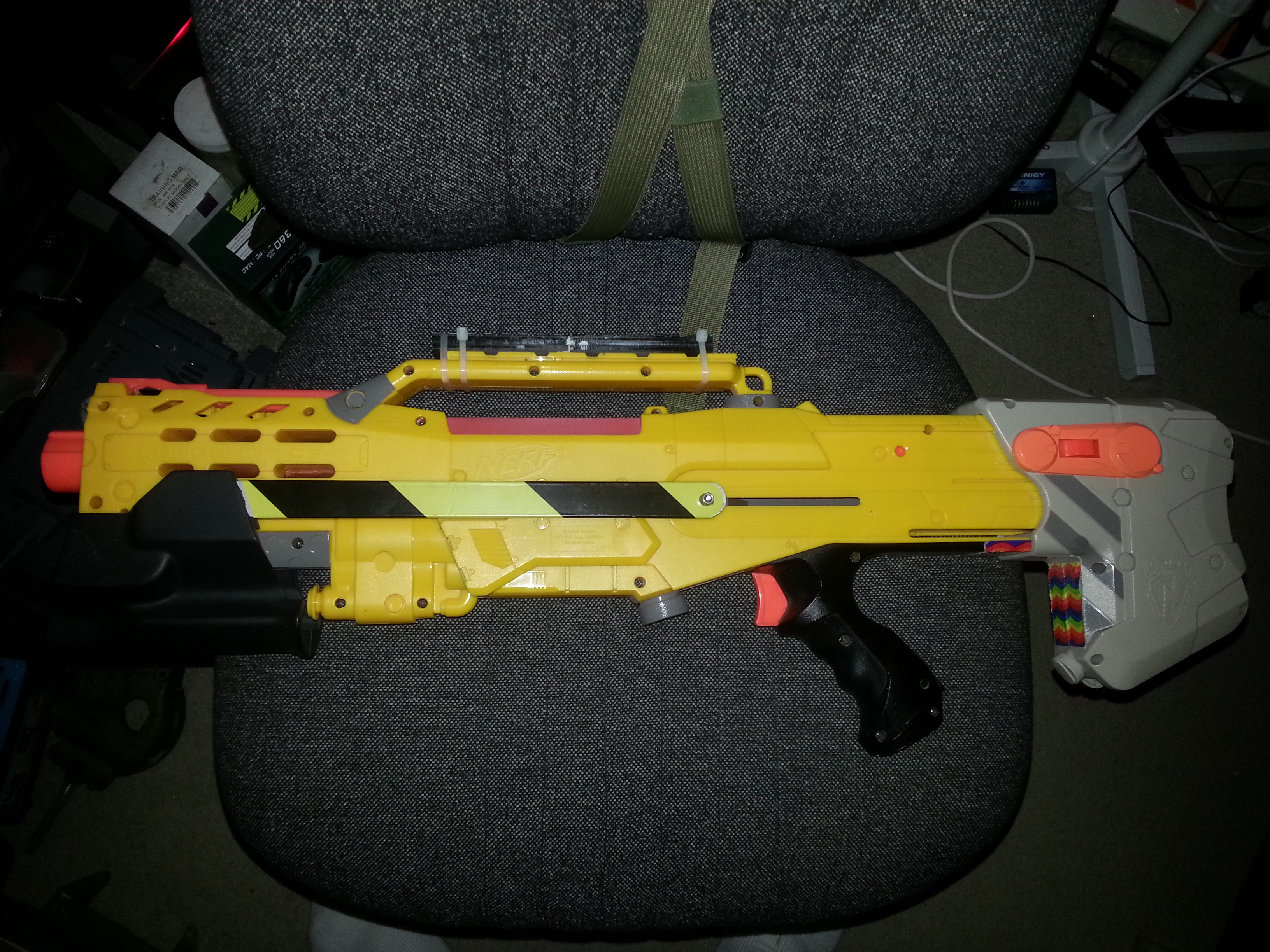

This is what I mean. This blaster in particular needs reinforcement if you are going for a bigger spring. This is my personal war blaster and I have spent close to $250 AUD. So really, in both hobbies, reinforcing the "toy" may lead to longer life.
I like how you can just see my Panzer IV and an old Sherman turret in the background. So, technically, it's RC tank related.
