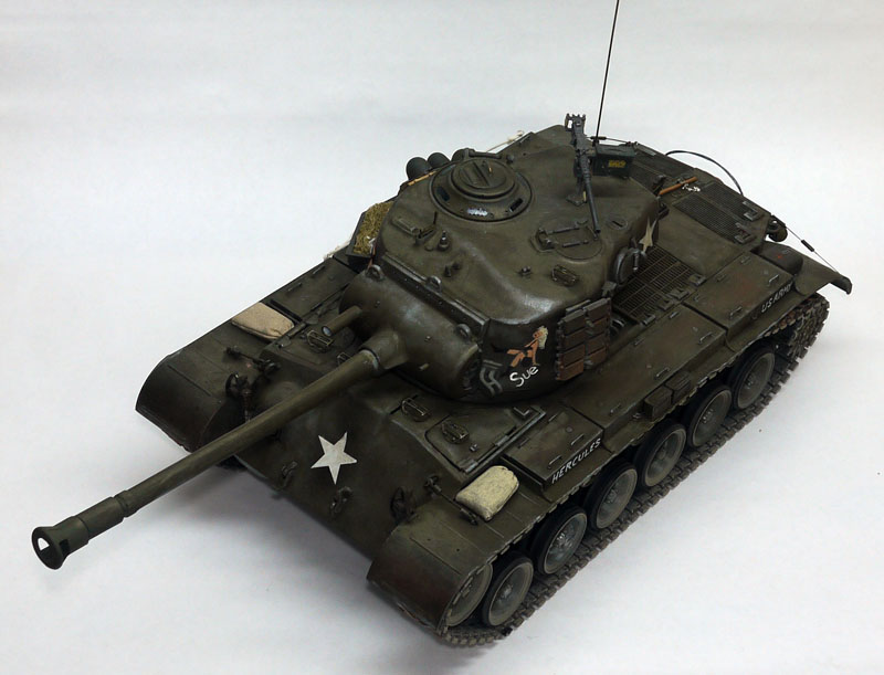

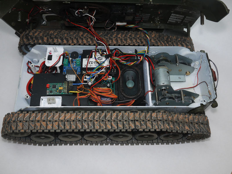

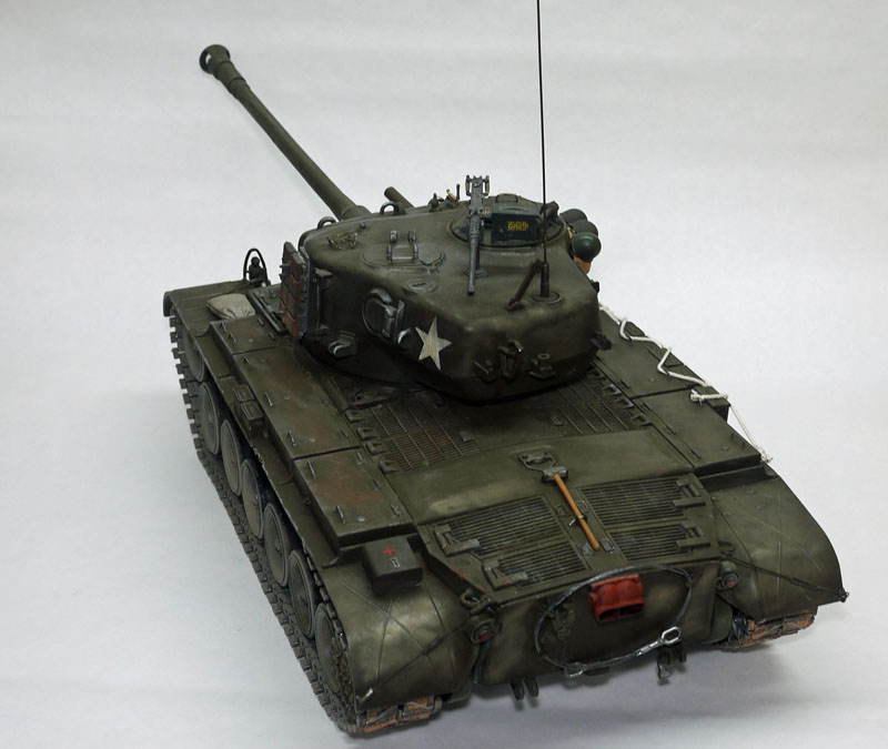

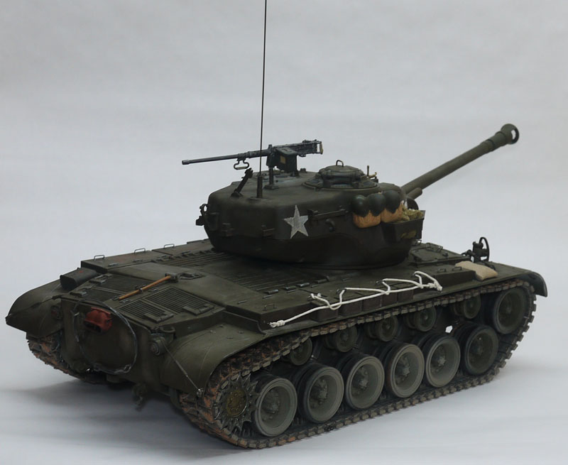

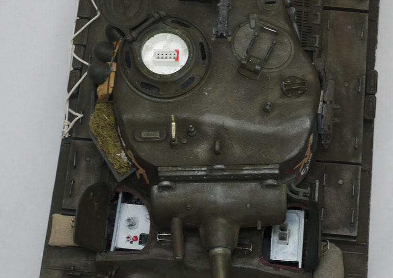

I took another tank off the shelf and updated it. This time my Pershing. Stripped down with the interior haul painted and then added a TBS/DBC/15watt amp with IR equipment with a Ford V8 for sound.
Cut off all the molded handles and added wire ones.
Turnbuckles on the vendors
Metalized the paint and now it needs some weathering washes

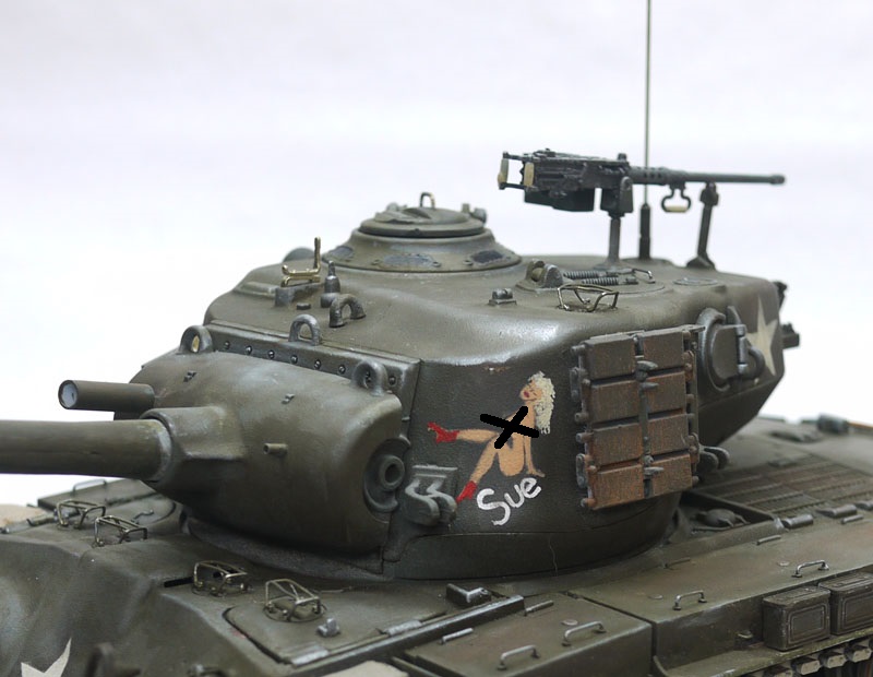

I censored "Sue"

Pershing looks great. Do you have any build notes? Particularly how you built the main gun and the muzzle brake?
Old 04-22-2014 | 04:39 AM
YHR's Avatar
YHR
Joined: Nov 2006
Posts: 8,976
Brass tube was fitted inside the original barrel and the another brass tube was slide over that to give the right outside diameter. The muzzle brake was scavenged off of something, but it was not a purpose built piece. I noticed it and said, "hey that would make a great Pershing muzzle brake": Sorry I can't remember exactly what it came off . Might have been a piece out of an old hair dryer or something
I cover the barrel in a coat of auto body spot filler, and once dry, chuck it in my drill and sand it all smooth..
