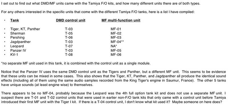

Hey folks Im looking to swap out the mf unit in the m51 I'm building to give me recoil. My question is what engine is the mf-07 from the super Sherman based on? Some people have said the kv-1 mf is a better sound match but want to get some other opinions before I dive in and buy one.

Tom I found this Chart with some info on DMD amd MF matches. Maybe this will help you?

Hey Maus, funnily enough I came across this earlier. Sadly it doesn't give details of the supersherman mfu!

Originally Posted by Panther G
Which is the MF o7 I don't even see one listed. i thought that is what was used on the Leo but that is a self contained unit not 2 separate units. i dont think there is a MF 7
That is actually the T-07 DMD which uses no separate MF unit. It does have a remote main gun flash strobe power supply instead. The T-07 is also very large and has switches for its many light functions.
