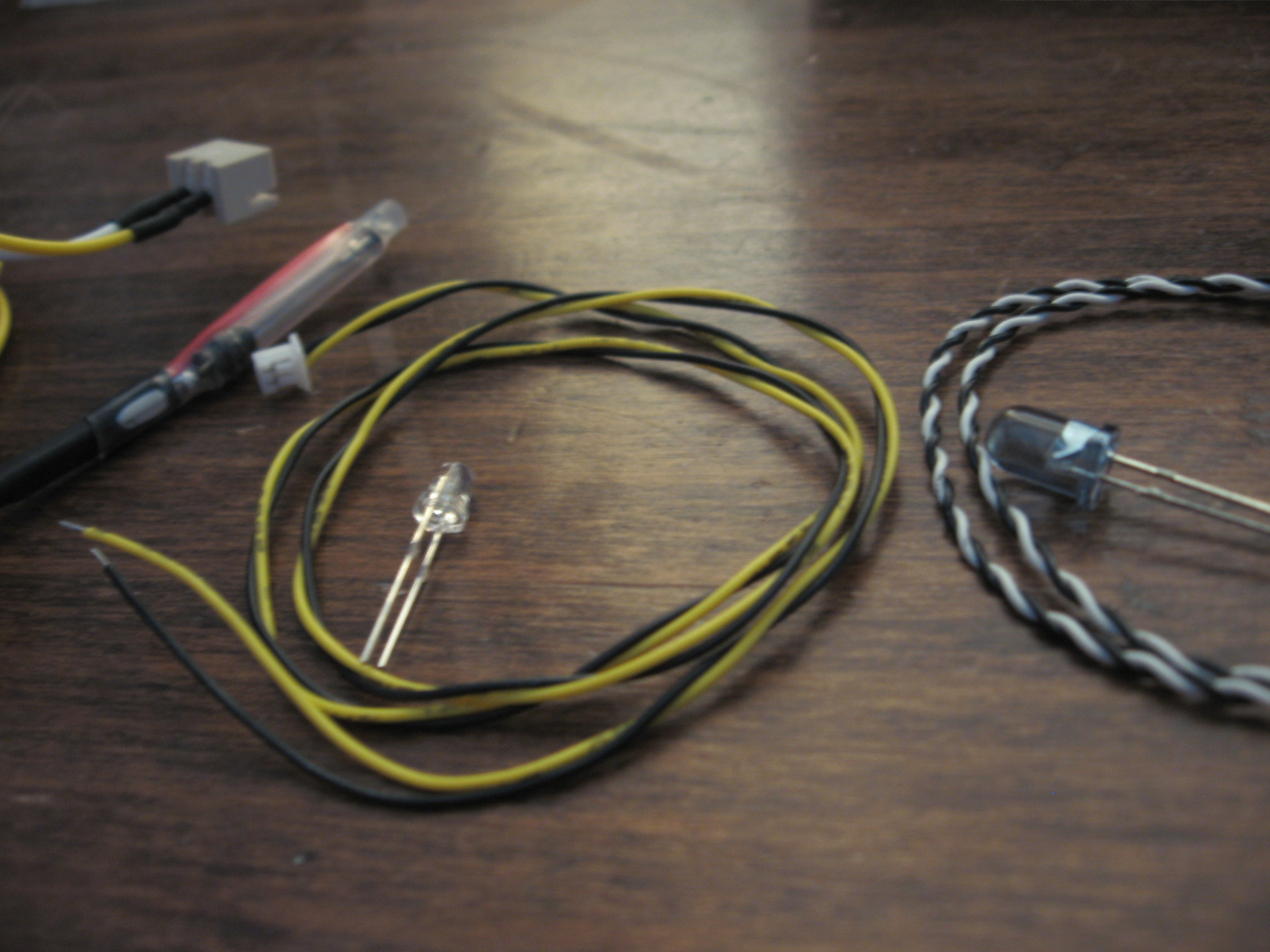

Alright, my TK22 came in today (two days early!), got the clark board, flash unit, tbu base, found out now he is back ordered on remotes though...
Gonna start this thread for a question or two I have now, and the inevitable future ones
What is this small LED next to left of the emitter? Is it for the headlight..?
Is there a method to getting the HL plugs out of the RX18? They my arch nemesis right now, taking forever just to get one out

The little one be the Flash for the barrel
Old 05-07-2014 | 03:30 PM
Joined: Mar 2011
Posts: 829
From: WV
whats flash tube like thing attached to the flash unit? Additional flash?

Do you have the other switch installed? If so, just jump the connection on the board with regular stock motors. You have a choice of which flash unit to use, the LED, or the xenon bulb, which is also shown in that picture. The xenon bulb is big and gets very hot with multiple firing of the main gun if installed.

I assume the xenon bulb is more powerful, How hot does it get? Do I have to worry about melted plastic? The barrel is metal, but the muzzle brake is not.

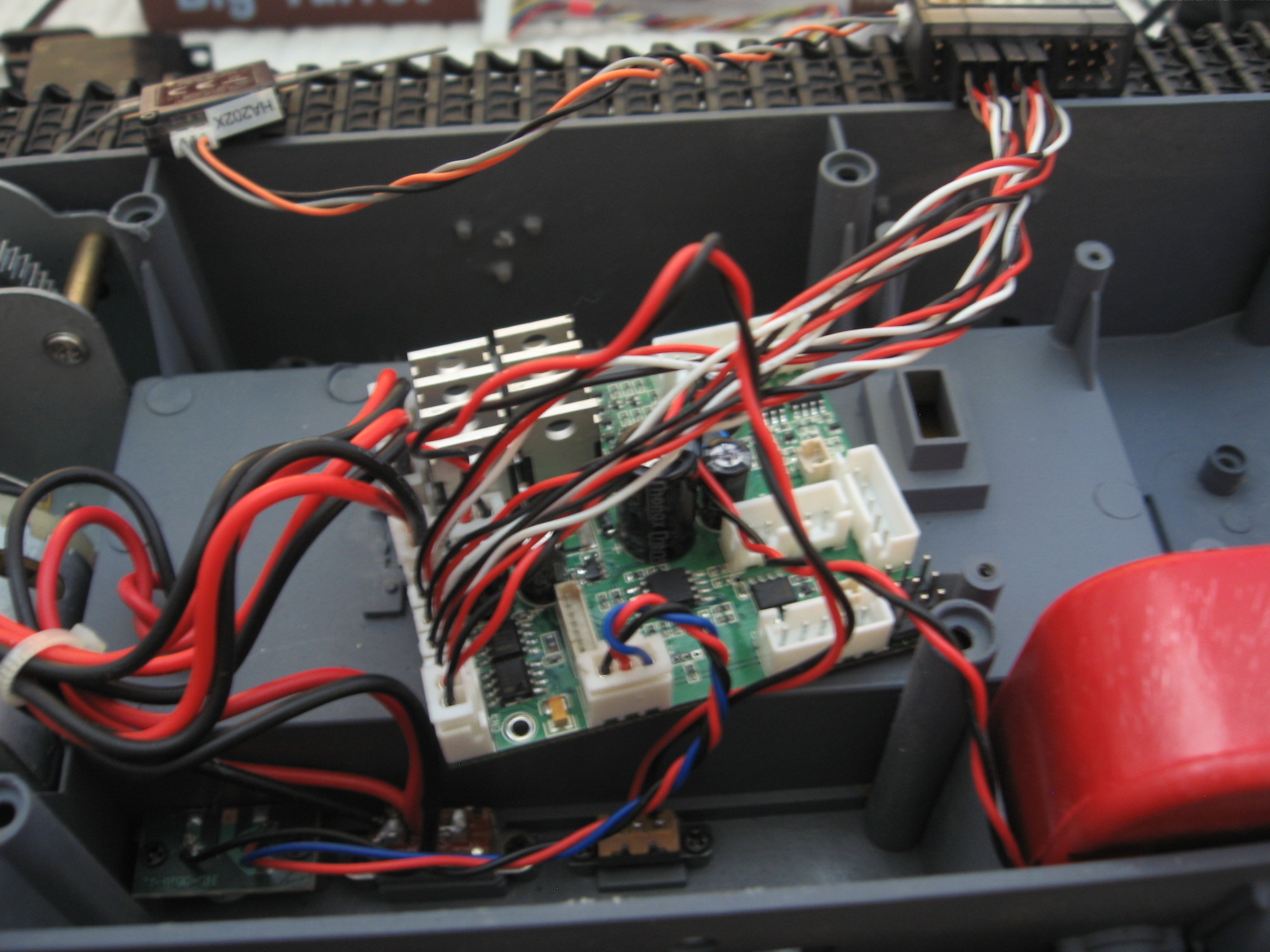

Alright, I can't get it to do anything. Checked the wiring countless times, rx is binded, its recieving power, I can see the light on my rx turn on when I turn it on, and the speaker makes a small noise when its shut off.
Any ideas? Not getting any sound or movement from any stick movements
I don't have any IR/gun related or led functions wired to it right now if that matters
Old 05-08-2014 | 08:53 AM
Joined: Mar 2011
Posts: 829
From: WV
Checked all the wiring again this morning, everything in the lower hull is wired, but it still doesn't do anything, I hope to god its not a faulty board and I just have something miswired.

Old 05-08-2014 | 02:37 PM
Joined: Feb 2008
Posts: 3,143
From: hillsdale, NJ
added pic of setup
Don't get discouraged. You are doing what many tankers cannot, so carry on. If all else fails just bring it to Danville with you next Friday and we will sort it our with you. What radio are you using? Many guys use sophisticated radios and when they are not set up properly the DBU & Clark boards become troublesome. Check the trims and base settings. If you are not used to digital trims they can be difficult. FYI.... I have the Sony remote for the Clark and I will bring it with me to Danville next Friday.

martellus Your remote is going out tomorrow and here is the connections for all spectrums that should work
Spectrum Series Of Radios DX5e, DX6i, DX7 ( Orange recievers and Spectrum recievers are the same set up )
Clark Board Receiver
Channel 1 Aileron
Channel 2 Elevator
Channel 3 Throttle
Channel 4 Rudder Throttle and Elevator are Reversed, Aileron and Rudder are Normal
Old 05-08-2014 | 07:05 PM
FreakyDude's Avatar
Joined: Aug 2011
Posts: 1,063
From: Cambridge ON, CANADA
your wiring looks ok from what I see. I am thinking it could be that you have the wires going into the reciever backwards. the white or signal wire should be at the top of the reciever or the side with the printing on it that faces you. I can't really tell in the pics you posted.
Old 05-08-2014 | 07:08 PM
Joined: Mar 2011
Posts: 829
From: WV
I have the black wires going to what I thought would be negative, (side facing up in the pics with the stickers), but yes, good idea, i will try that.
Also yeah, I have a box I am using as a block
Old 05-08-2014 | 07:28 PM
Joined: Mar 2011
Posts: 829
From: WV
They were all in the right order already, I swapped them with the white wires facing up, still nothing though
if the white wire is signal, then judging by the markings on the reciever it should be facing down, but neither orientations result in anything working, so I guess its probably not that
was hoping it was, lol

Hahahahaha, wow am I dumb
I plugged in a random servo to my reciever to make sure it was working and noticed it would go to default position but not respond to controls...
Rebinded reciever, and it started right up....
Now just to get everything else setup.
