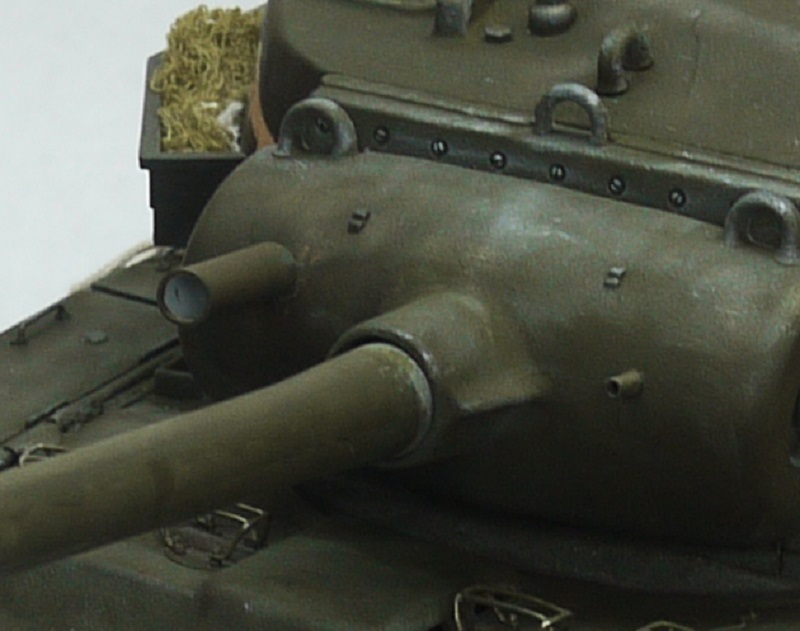

An aluminum tube would be ok for an emitter tube right? As long as its within the width and depth requirements? Just want to be 100% before I install this
to clarify as in, its fine being metal and unpainted. I don't need to paint the inside or something?
Make the tube yourself if you can. Brass or Alum or even plastic. I've seen guys effectively use drinking straws even. Nine mm depth from LED tip to end of the tube, and as narrow as possible for the Emitter. DO PAINT THE INSIDE WITH FLAT PAINT. Or else you get "IR Splash" tot eh left and right (really bad on metal emitter tubes) which results in many "Friendly Fire" issues. Don't paint over the emitter either. Glue it in place with rubber cement (easy to remove and reinstall). Some of the nicer tubes you can buy have retaining clips and or screws. On a Stug put it where HL Had their IR emitter. Blow the IR tube out with air every now and then with canned air to keep out dust, dirt and FOD.

Yeah I bought some tubing from the little K&S stand at the local hobby shop and cut it down, Its actually a bit more than 9mm just to be on the safe side.

You can buy styrene tube of the exact size ID to fit tightly over an emitter , and easily cut to length.

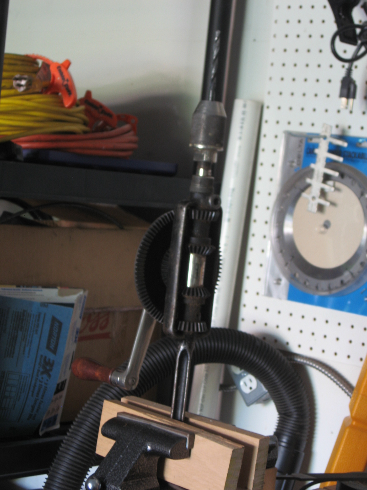

just did some small drill/dremel work to get the emitter tube a nice space in the mantlet, the drill batteries ended up being dead so I had to take an alternate solution lol
