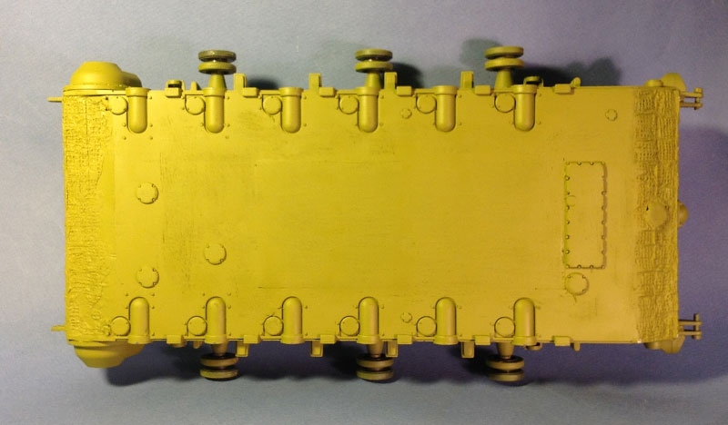

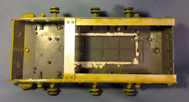

ID:	1996991   Click image for larger version
Old 05-20-2014 | 02:44 PM
Joined: Jun 2012
Posts: 96
From: Merrick, NY
That looks like it right there!!
