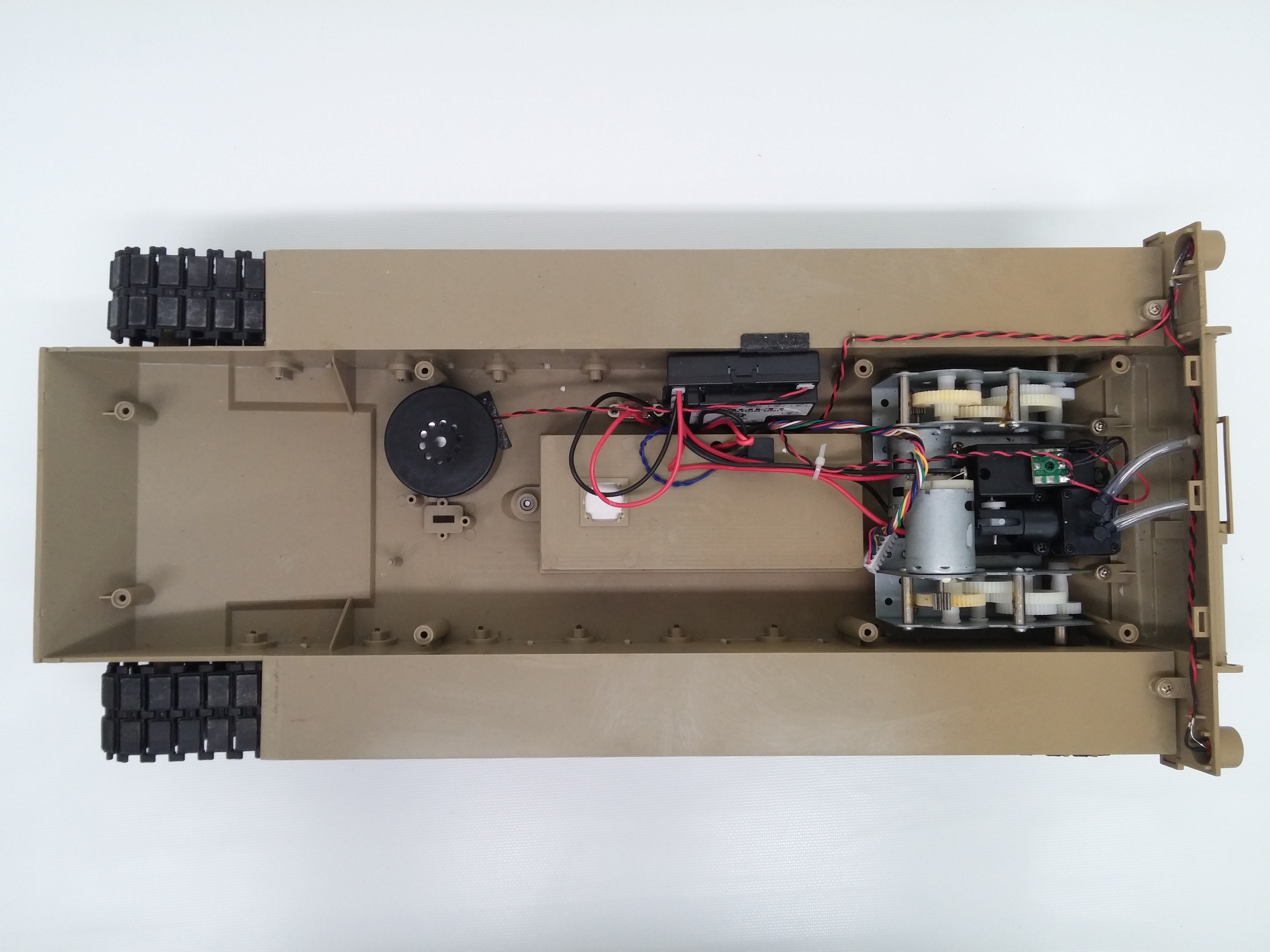

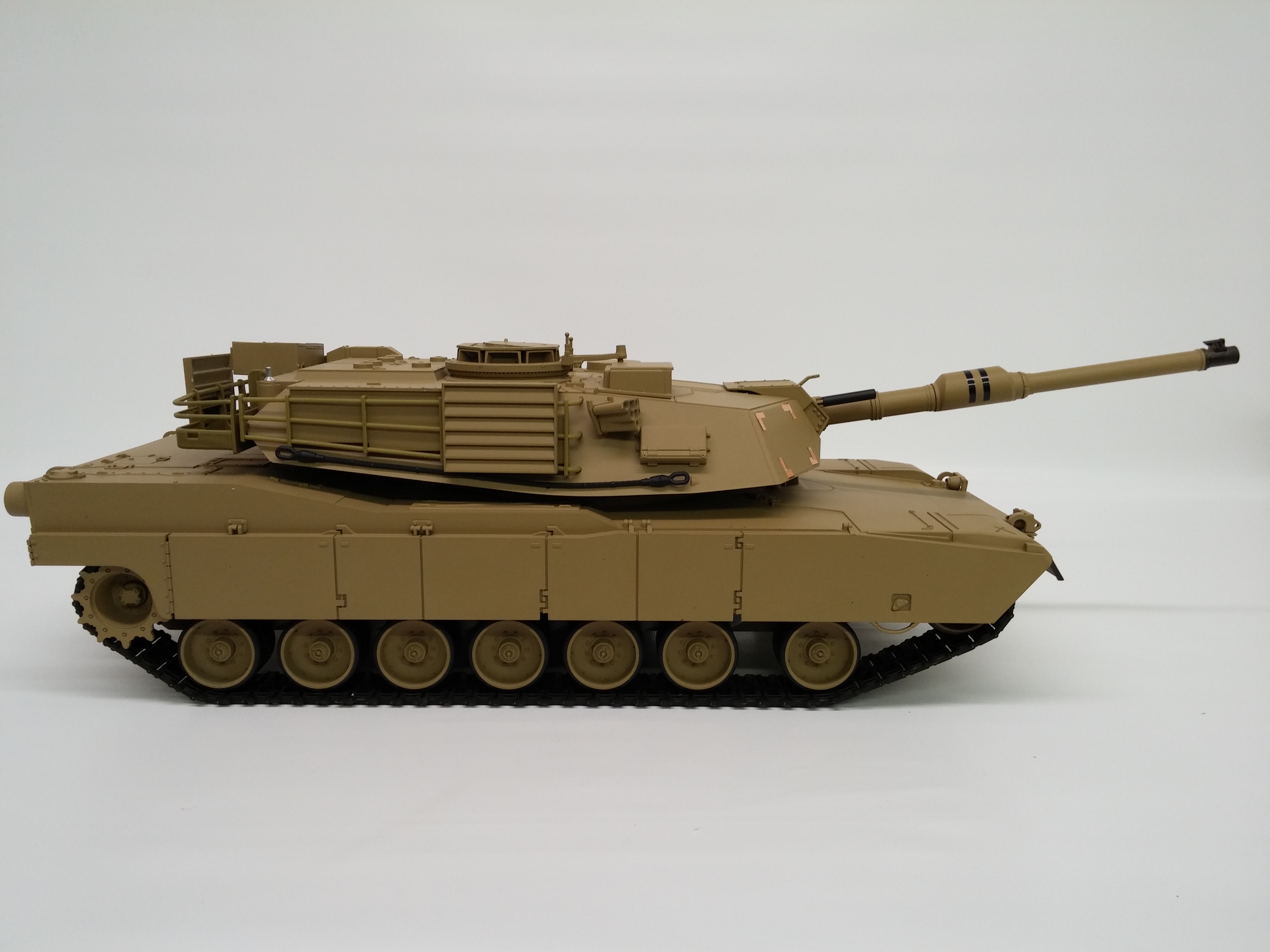

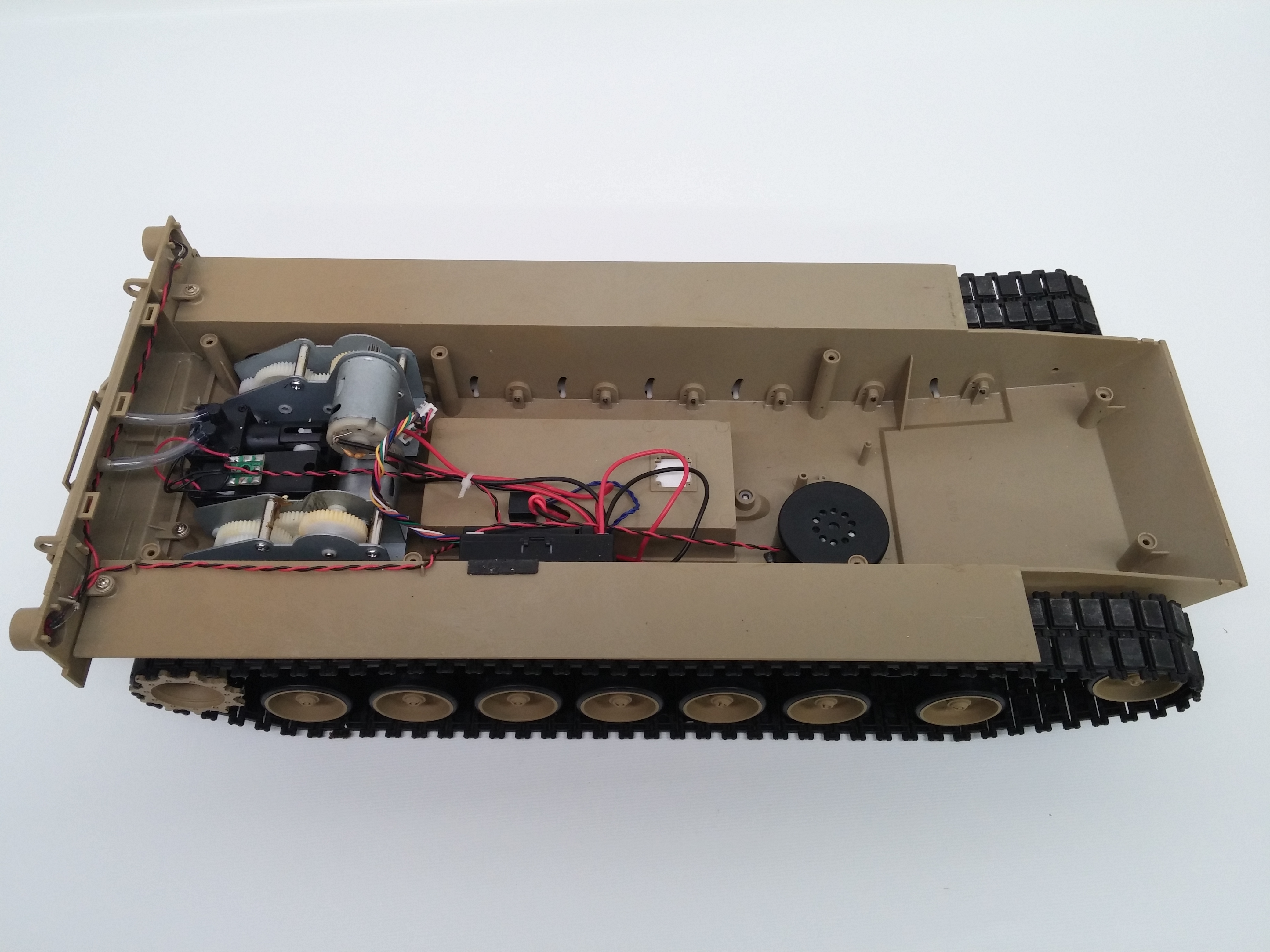

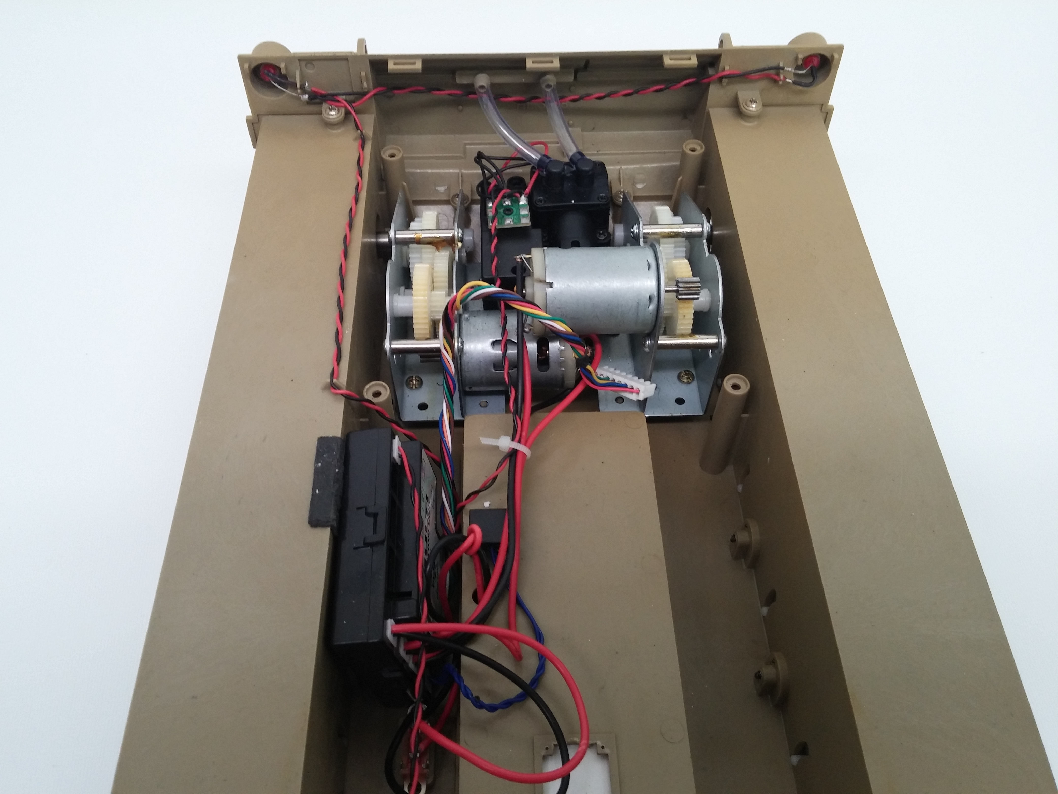

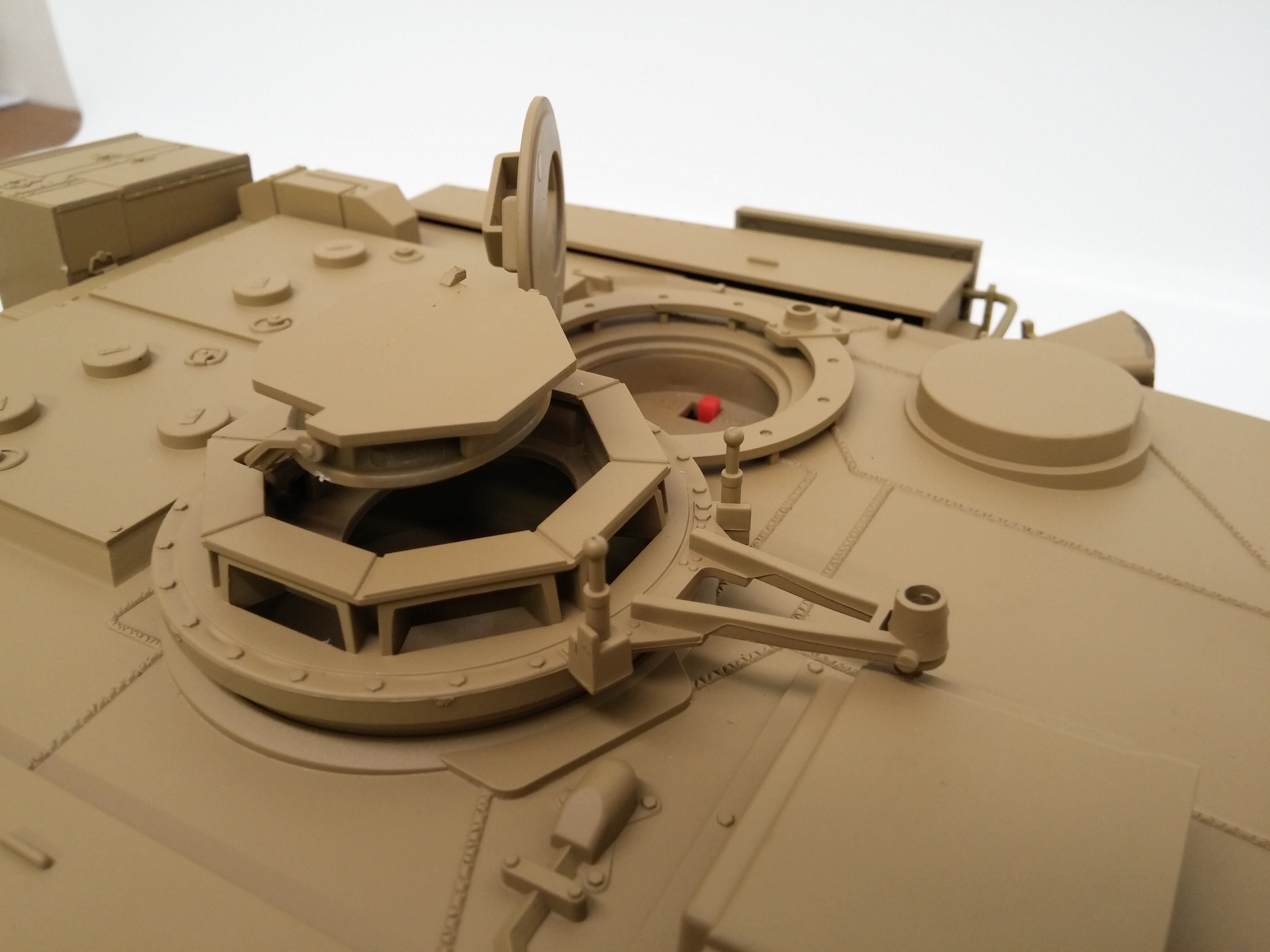

Also, if you want to see the HL Abrams, here are a few pics. At the point when I got this, there were only 2 of them floating around.
As you can see there is plenty of room to work with on the inside. Also Taigen will be making upgrade parts
Can anyone say metal lower hull?
