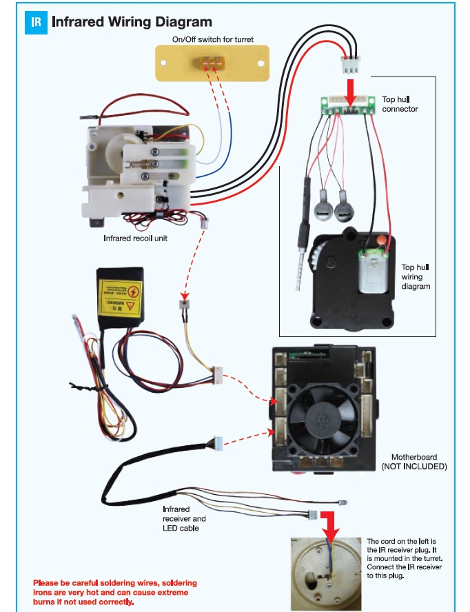

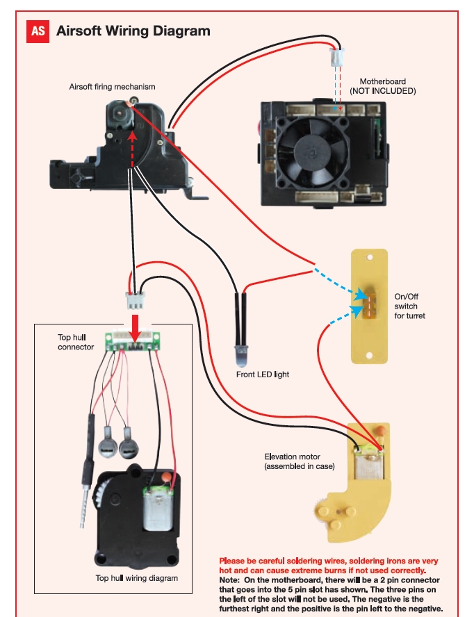

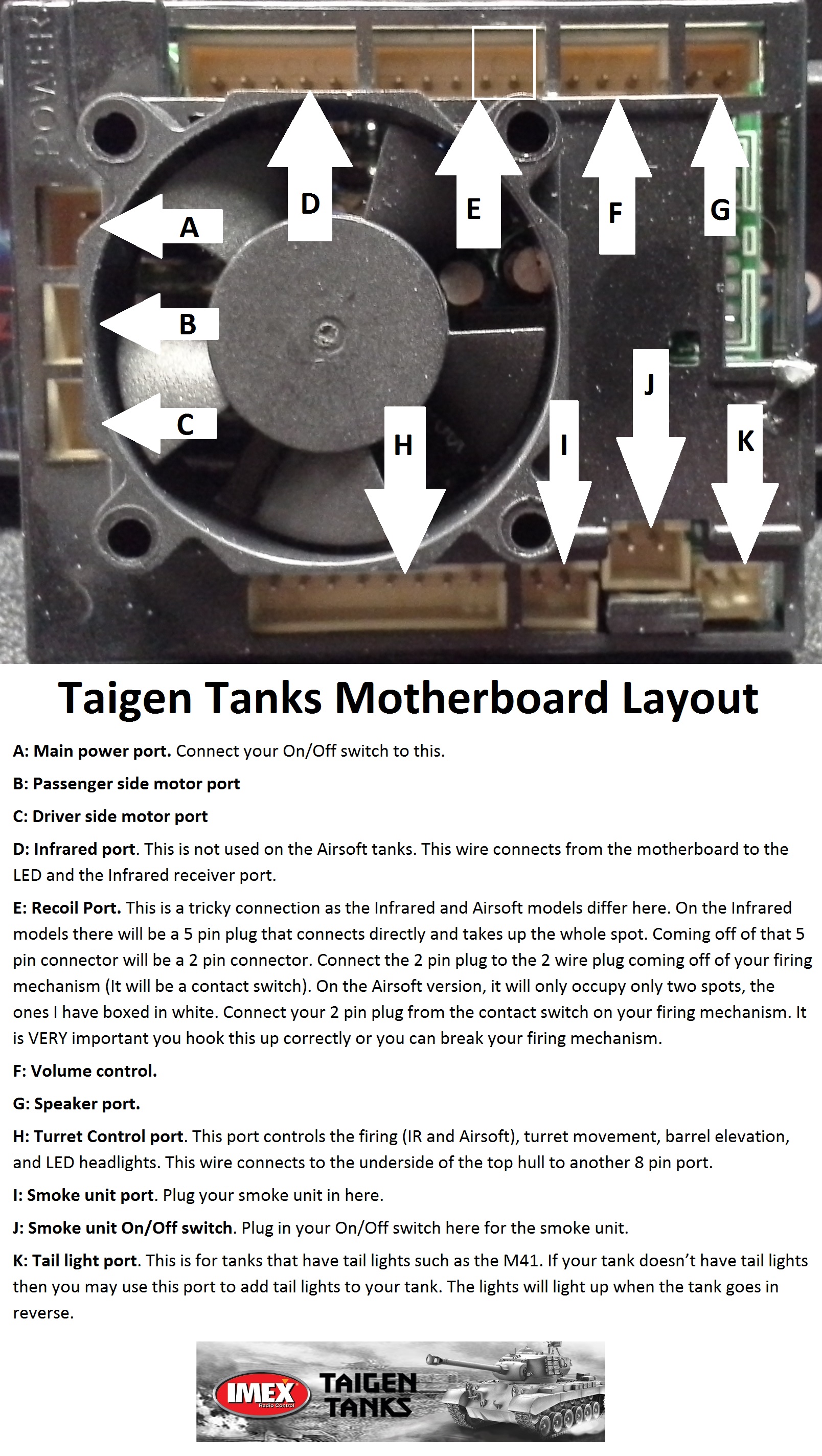

Once your tank comes in, PM me and I'll make you a video on how to adjust for that model. As for the wiring diagrams....
Here are the main three you will need. If you have any other questions please ask
Name:	Tank motherboard layout.jpg
ID:	2030278   Click image for larger version
Name:	Wiring Diagram for Airsoft v3.jpg
ID:	2030279   Click image for larger version
Name:	Wiring Diagram for IR v3.jpg
