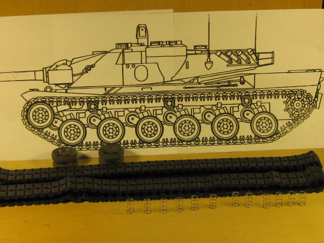

For years I have had the MBT 70 on my bucket list for a potential scratch build project.. I think it has a terrific looking turret. Thanks to forum member Tanque, who made mention of it in a previous post, I got all fired up about it again and moved it up to #1 and decided to give it a try.
About a year ago I got some ZTZ 99 track just for "spare stuff that I might use someday". Well, someday showed up. and in researching the MBT 70, I discovered the ZTZ track looked to be real close to the MBT 70 track design, length and width.. Also, I had a couple of spare Pershing road wheels that look exactly like the road wheels on the MBT 70. The thought of building a working suspension occurred to me and my box of springs provided what I think will make a workable suspension. I also found a good line drawing that I was able to scale up to 1/16 scale for dimensions and details. A Google search turned up a bunch of reference photos that are great.
It ain't much, but it's enough to make a start with. The turret is gonna be a bugger, so I gotta do the lower half first, and then I will be at the point of no return and I will have to finish this project no matter what ...... no excuses ..... death before dishonor !!!!!!!!..
Now that I have shot my mouth off, I gotta shut up and get busy .............

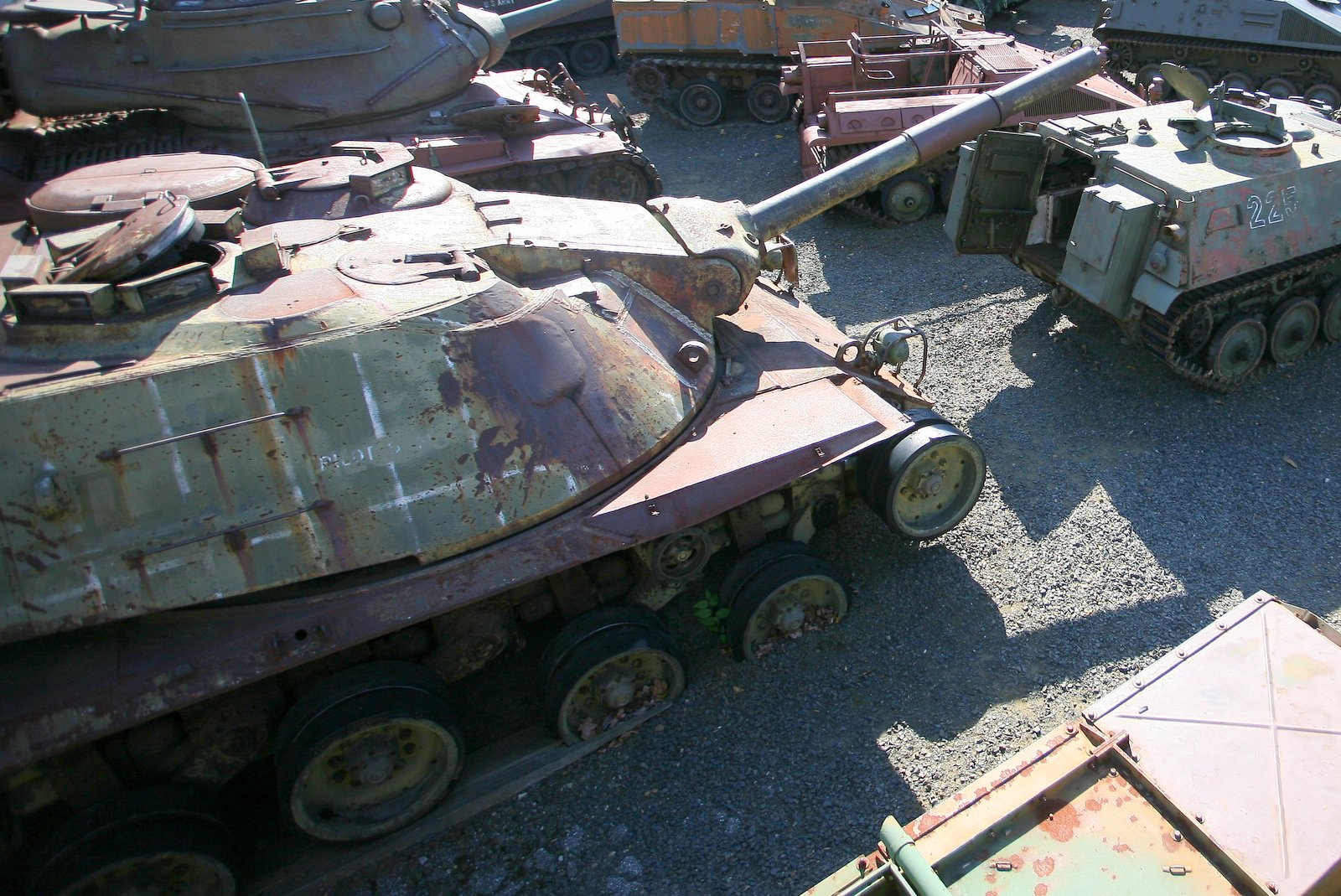

Here are three photographs I took of the mild steel prototype MBT-70 that was a range target before being rescued as an exhibit for the Military Museum of Southern New England. NEAD will be headed over there in a couple months and if you need specific photographs I could try to get them for you during their open turret day.
Looks like a M41 Bulldog to the left of it. Grab photos of both!
That was one heck of an expensive range target.....
Those are actually M48/60 main battle tanks, they're all in the same corner of the museum, having them all side by side shows a great evolution of tank design. You can still find M26 Pershing features on some of these tanks which highlights the design legacy, right up to the M60.

I'm going to give this model my best effort. I am not going to hurry through the build. I am going to plan my work, and work my plan. I am going to measure twice, and cut once (I am going to wear my glasses when measuring and cutting). I will not take shortcuts. I promise, trust me, I never lie.
The one thing that amazes me is that there are no hatches or vision ports on the glacis for a driver and co driver. I found the following explanation very interesting.................The MBT-70 was designed with a low silhouette, unlike the M60, one of the tallest tanks ever built. The MBT-70 ended up very low, just over 6 feet (1.8 m) from the floor to the turret-roof. This left no room in the hull for the driver, who had to be moved into the turret. He was located in a cupola which was geared to rotate so that he was always looking in the same direction even if the turret turned. He could also spin the cupola around, so the tank could be driven backwards at full speed.[SUP][2][/SUP]The tank's low silhouette, which could be lowered from 2.59 metres (8 ft 6 in) to only 1.99 metres (6 ft 6 in), was also a big advantage. Compared to the M60 tank, the MBT-70 had a lower profile. With the hydropneumatic suspension lowered it was also smaller than the Leopard 1, which gave the MBT-70 a better hull down position.
