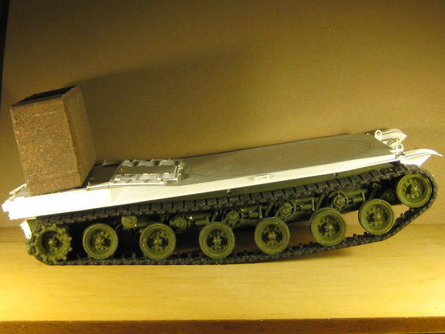

Like this ------ ?

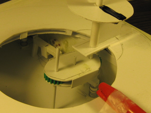

Mal ...... I just spent the afternoon building my idea on how to do it with a linkage arrangement and It was not successful. It worked in my mind, it worked on paper, but didn't work in styrene. Hey .... at least I got two out of three . LOL I was considering a reduction gear train of some sort too, but there also is a space limitation that exists. I think the answer is to teach the driver to stick his fat head out of his hatch wearing a helmet and goggles. If that was good enough for Patton it should be good enough for him. Right now I'm just bummed out about this. But tomorrow is another day

The linkage arrangement that I did was inside of the lower hull and a shaft ran up thru the hollow turret to rotate the cupola. I just built a test rig to see if it would work, it wasn't anything permanent. A few minutes ago I just had another brain storm on a way that might work. Or maybe I just had another brain fart.
Old 10-05-2014 | 04:45 PM

Ohhhh Nooooo, please don't tell me the wheel has already been invented !!!! Actually, I do have another gizmo thingy that will/could work. I will make a test rig this morning and post photos of my glorious invention today. Unless it doesn't work.

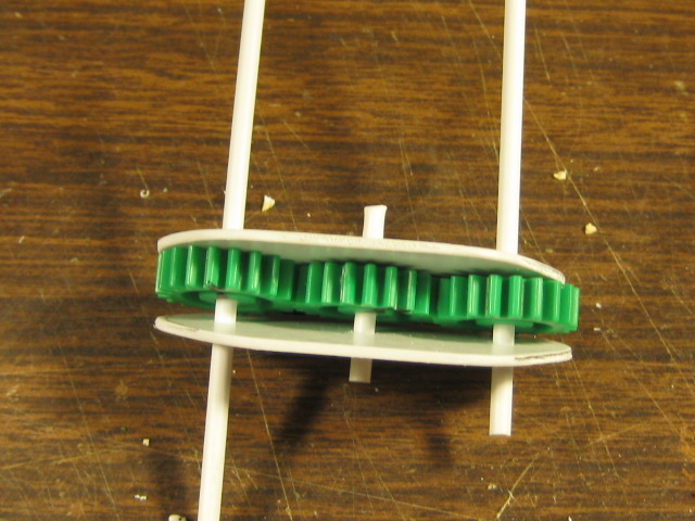

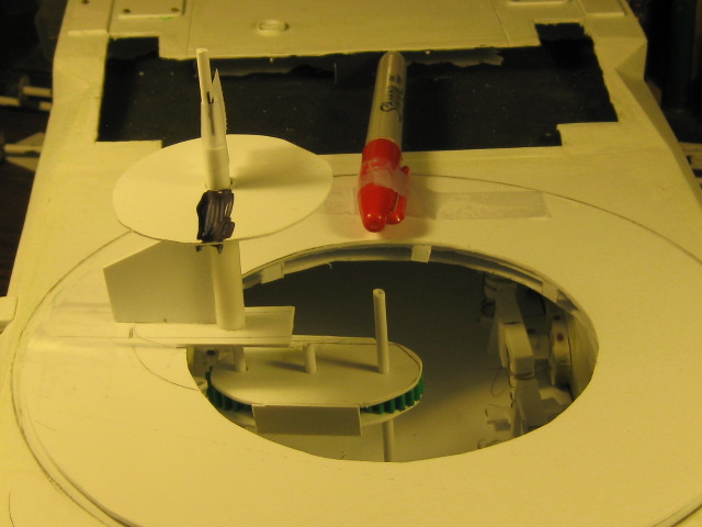

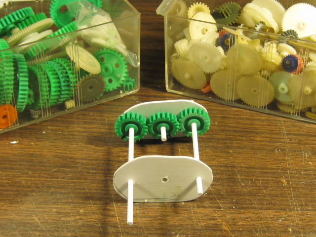

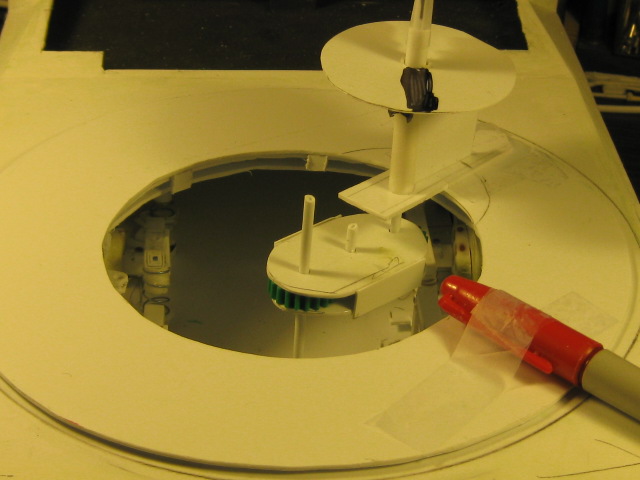

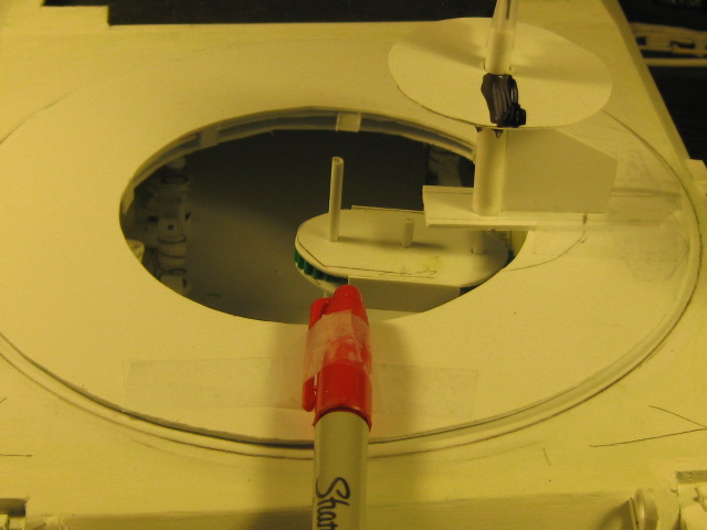

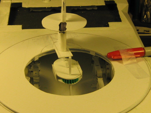

Mooooohahahahaha!!!" ........ Ja Mein freund ........ IT LIVES !!!! Igor ... open the Champagne !
Well, at least it works. By a stroke of good luck and a minor miracle, I found three identical gears that looked like they might work for a reverse rotation gear train. Incredibly, the distance between the turret center and the cupola center exactly matched the axle center spacing of the three gears. The central gear is fixed and the next gear rotates to turn the cupola gear in the opposite direction. How simple. could it be? The cupola always faces forward no matter in which direction the turret is facing. None of the turret rotation ring gears that I have will fit this turret, so I will have to make a new ring gear to drive the turret. No big deal, just another fun problem to handle.

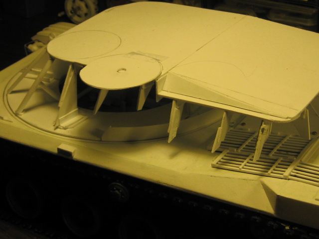

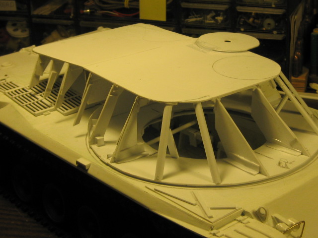

I installed some rough framing and will use some thin cardboard to make patterns for the outer skin. This will allow me to see if I got it right and make corrections before I skin it with styrene. There are some details of the equipment on the sides that will require some cutting of the side skin to build and I only wanna build this thing once............ It pays to plan ahead. I just might try to start doing that on this project.

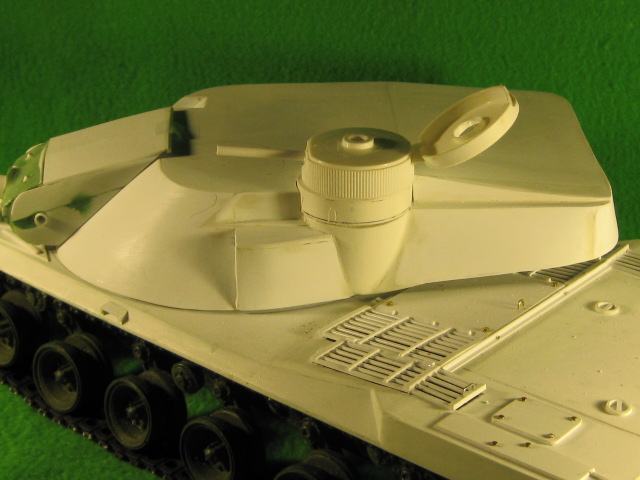

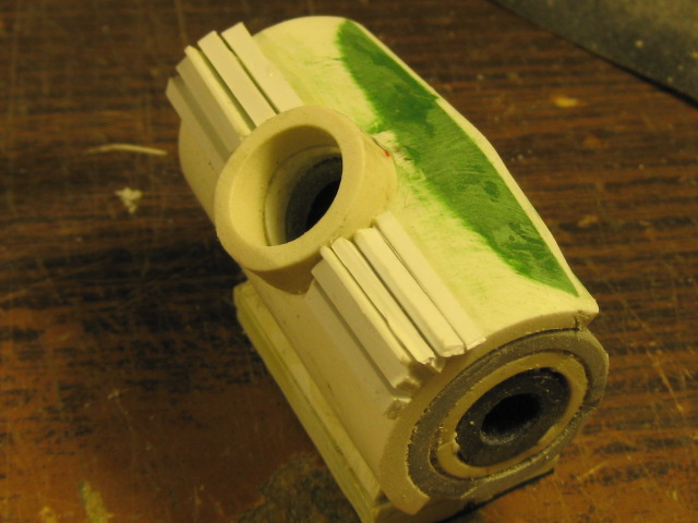

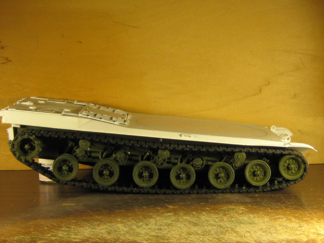

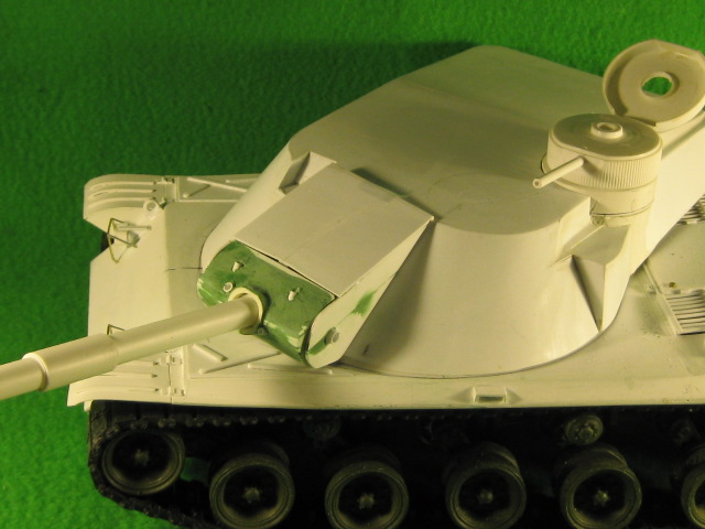

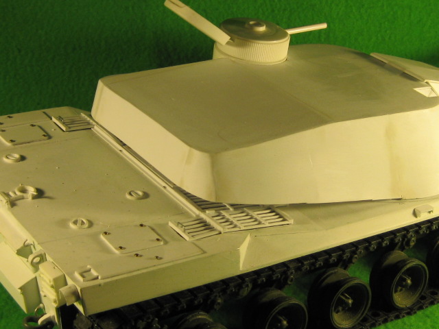

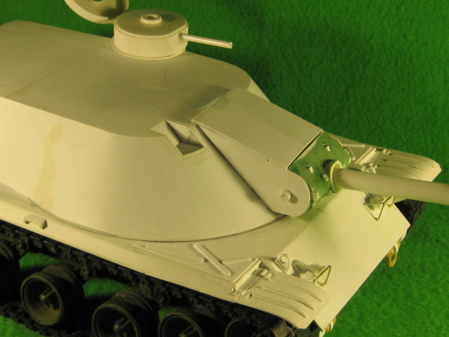

Some progress has been made, but before I post the update on my MBT 70 project, I am thinking about starting a thread about "Helpful Hobby Hints", starting with the subject "Safety is Good".
HHH #1. When using a Dremel tool with a circular saw blade spinning at 30,000 rpm, be careful so that it doesn't kick back and come in contact with any fingers on your left hand. Since the razor sharp very thin blade is rotating at warp speed, you won't even feel the intrusion into the digit that opposes your thumb until you begin to wonder why your work surface is turning red with a warm sticky liquid. Find the source of what has caused this messy situation and take the proper steps to correct it immediately. A formica work surface and white styrene will wash off nicely with warm soapy water.
And now, for the update photos.. I am done building the big parts and will be moving on to the medium and small details soon, unless there are any more unforeseen mishaps.
It's weird where you can find tank parts sometimes ..... I opened the door on my refrigerator and saw a small tank turret for an MBT 70 ...... WOW. It was made by that famous German weapons manufacturer ------ H.J. Heinz ----- and it fits pretty good, but not perfect. It looked like a shortcut that would save me some time and allow me to ketchup because I am behind schedule building this project.. But the turret I need has a split hatch cover, so I might as well just build one.
