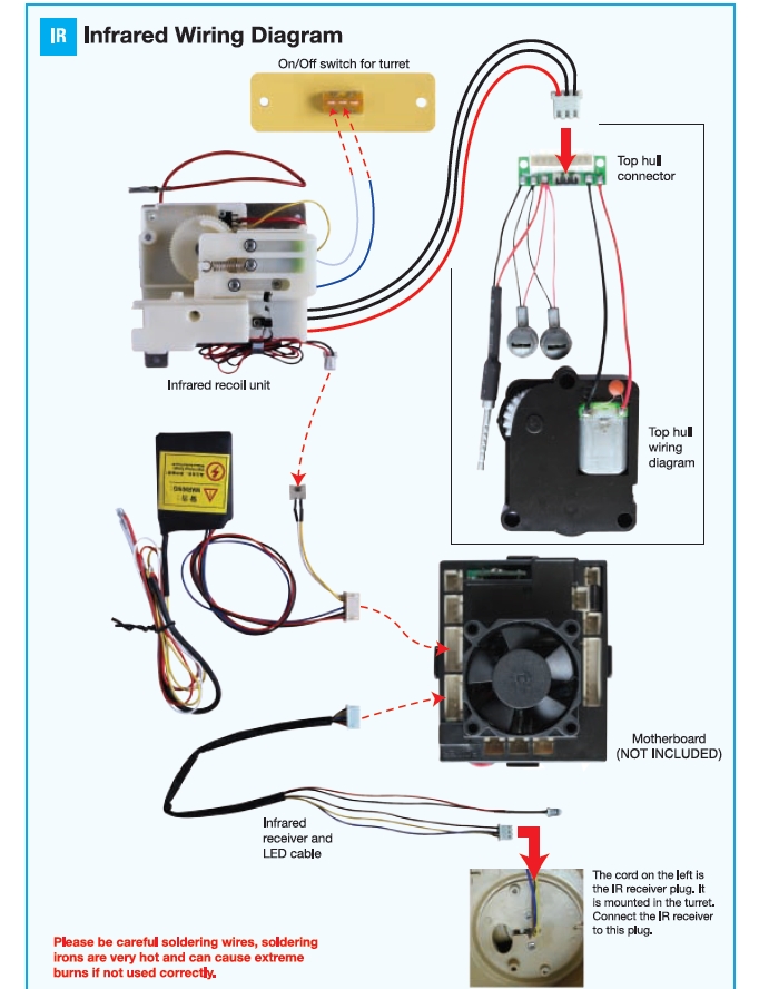

OK, so I read with interest Strato's Pershing build to figure this unit out. I know this unit is technically made for my Stug 3, but there were no directions so I am unsure how to install it. I think I may be able to get it mounted by hacking it in, but I am wondering if anybody has a wiring diagram for it or directions on how to install it? I have no clue how to wire it up. The stock electronics were not present when I bought the tank and I am usually a Tamiya guy, so HL is a bit foreign to me....

Possibly something like this? Which unit are you using? There is a special sized one for the Stug 3 if I remember correctly.
Name:	Wiring Diagram for IR v3.jpg

I will be using Clark electronics...
Thanks Erik, I bought the unit from you. It was listed under the Stug 3/PZ3 parts list.

Thanks to the wiring diagram, I have figured out the connections, but the unit clearly does not fit inside the citadel. I have purused Google and have yet to find a good picture of one mounted in a Stug 3. Does anybody have any ideas?? Thanks!

It is a quite small fit actually. Most people who swap over use the smaller IR unit from HL though, it is the one shaped like an airsoft unit. I unfortunately do not have one here to show as I am all sold out of the IR versions and the next batch will be airsoft I will see if I can find one though, I'll PM you something.

the Taigen recoil unit won't fit in a Stug, The Stug just doesn't have the space that the PzIII has. You need to use servos probably or get the HL IR recoil and modify it.
