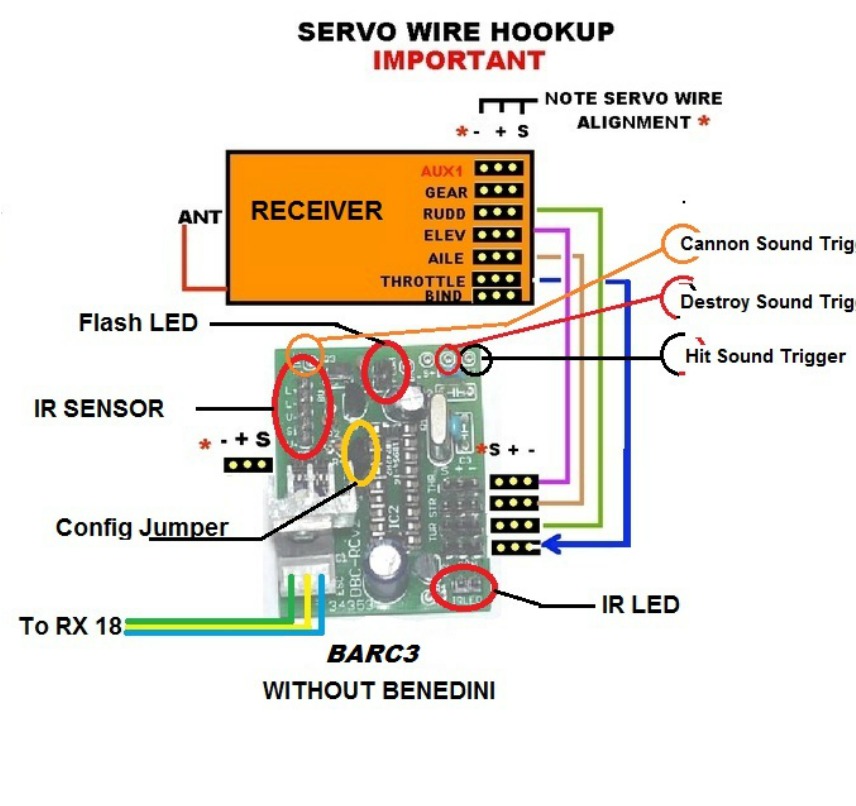

OK, I got the DBC / BARC and installed it by the directions yesterday. Very easy, but it became immediately apparent that everything was plugged in wrong- wrong sticks activating wrong functions. I am using a JR 9303 2.4 transmitter, so I figured maybe the drawing was just for Futaba channel order. Tried moving things around, but ended up just getting more confused- which channel should control firing/recoil? When I had everything hooked up one time the recoil worked with the elevator stick, but if I change that channel to the throttle stick on the left it doesn't work? Am I going to need to play with end point adjustments or something ? Seems like the unit will work good but there is something I don't understand LOL.... Thanks for any help ya'll can give!

I will help you. Because people have there own personal preferences the connection to the receiver can always lead to trouble. Let me know how you want your radio to function and then we can work at getting the servo's plugged into the right spot on the receiver. ie what stick do you want for throttle and steering I am guessing they are mixed up.
Do you have a spare servo??? This can help in identifying servo function,
Did I email you an operation manual.?

I just did some searching online and I have the feeling that I can handle this if I have the manual. Heck, I thought you just plugged it in and it works, lol. Try emailing that to me and I will get back to you with any questions after that. Thanks much!!

I got everything working on the table last night, looks good- fire is working with my retract switch, everything else works just like the stock transmitter. I'll try it outside tomorrow and see how she does.

I am glad to hear that Bill. If you ever want to upgrade to great sound you can as the BARC is a Benedini Encoder as well as everything else it does.
You now have the option of turning off the hull recoil, which can allow you to shoot on the fly. You can also disable the superspin if you wish, and add momentum. Be sure to read the operating manual, as it gives clear instruction on how you do this from your transmitter, prior to starting the engine., Once changed these options stay as you left them, so you don't need to go through the process every time.

The BARC has a momentum feature that can be turned on.. You set this with the left stick before you start the tank. What it does is add a small amount of speed up and wind down to the ESC so the tank doesn't act like a Jack Rabbit. Ie It won't go instantly from forward to reverse. It will auto slowdown and speed up in the other direction. It is not a lot of momentum, but it is enough to smooth out the tank and improves the performance of the ESC.( RX18) It blends on the speed steps together so you end up with a very proportional response from the RX18
