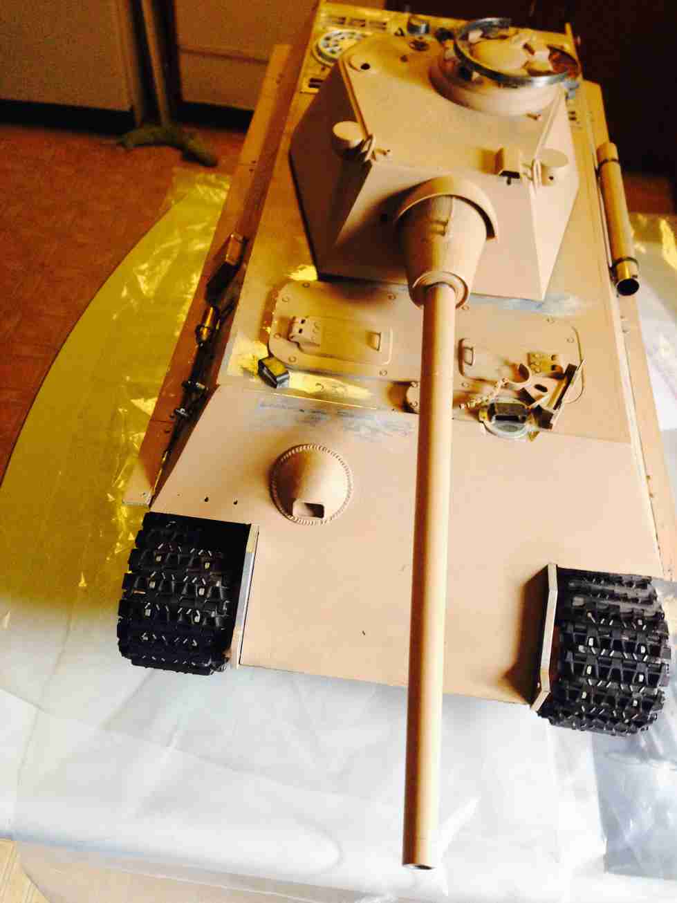

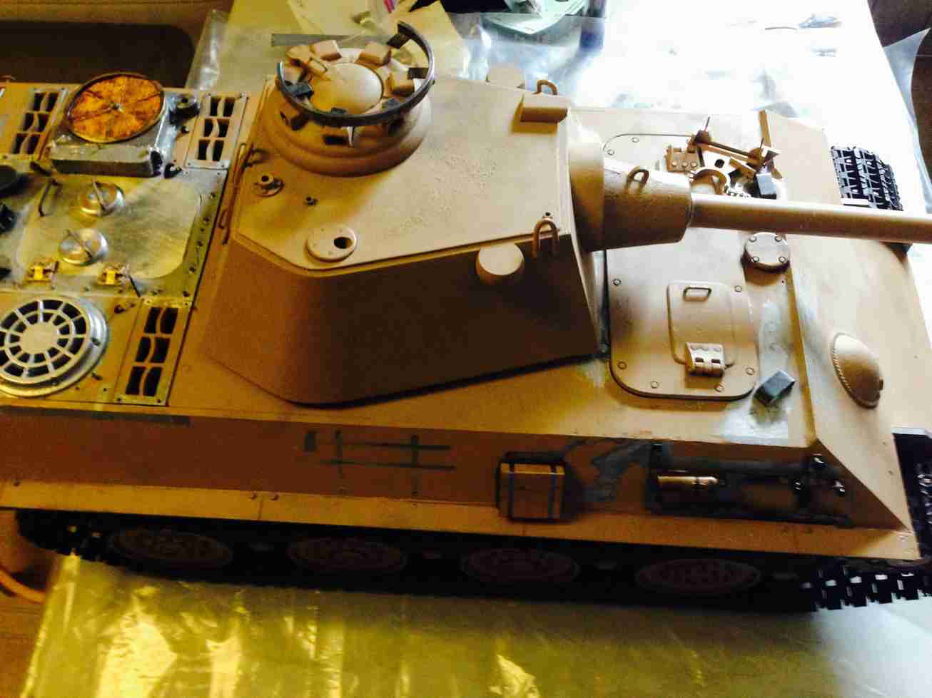

....whether it is nobler to just do it and take the heat later
I'm rapidly reaching a point in this model where I need to decide whether or not to make and attach
a muzzle brake. All the photos and sketches seem to indicate there was none during tests but it also is obvious
that the SOP of the Germans was to have one, the notable exception among tank guns being the JagdTiger.
I thought I'd read tha the small turret was to have a rigid mount that didn't require the services of a muzzle brake.
I know they experimented with that for the smaller gun of the Hetzer.
I am leaning to mounting a brake anyway.
Thoughts??

While that mantlet looks good without a brake, like you said, used on the JT or Hetzer, they both had much more space for recoil than a turret, especially a smallish one like you have here.
So, my artistic side says leave it off, but the engineering side says add it.
Good to see you heading towards the finish on this one, your scale and work are only a dream to most of us.

You could always thread the end so a muzzle brake could be screwed on/off as you pleased.

Well yes, the barrel isn't my own construction and was originally made to have a press fit muzzle brake fitted. It can't be readily seen but
there's a cap pressed on to simulate what I believe we see in photos of the original prototype- a threaded cap in place of a muzzle brake
probably to protect the threads on the original barrel. I'm being sort of lazy and don't want to set up my lathe to cut some one off odd thread
on this thing and I don't think there's enough 'meat' left to cut a conventional thread but that was my thought as well.
It's like stepping through the looking glass. If I cut a thread, I can't just make a threaded muzzle brake, I'll have to make both the brake and the
locking ring that the original had so I can set the orientation of the brake baffles correctly, timing if you will. Not opposed to it but now you know why 1) I'm so slow
2) it takes me so long to build anything.
There it is.
Jerry

From: God’s own country “England”
