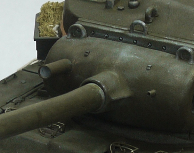

A bunch of new guys are adding new systems to their tanks, so I thought it might be time to share an idea I have used on all my IR battle tanks.
This was brought about by the need to easily experiment with different IR LEDs without having to solder them up. Also if you ever have an IR LED fail on the field on a tank that you have mounted the emitter in the mantlet you can lose some valuable battle time as you have to remove the old one and run a new one. This socket idea means you can change an IR LED in seconds.
The first picture shows a filed down 2 wire socket that has been mounted in the mantlet. The second picture shows an LED is pressed into the socket and a shroud is installed over the LED to make it legal.
Two things
  • This make LED replacement very simple.
  • The LED is removed when not in battle just like the TBU so your model has better display qualities..

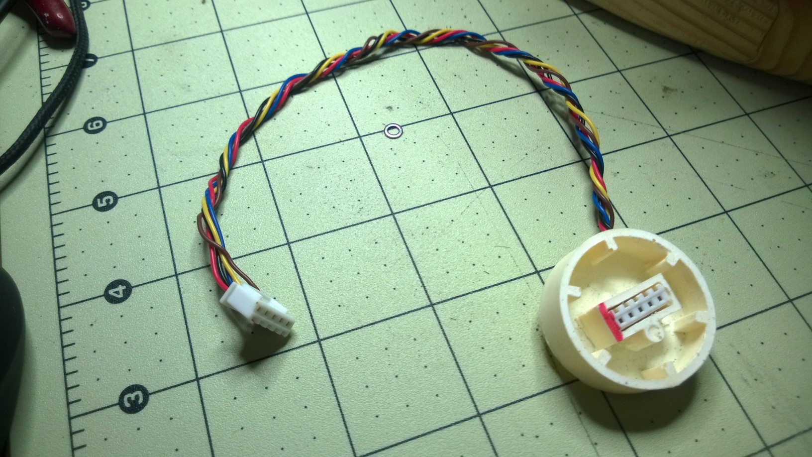

Does the IR sensor mount come with the white 5 pin insert or do I have to provide that? If it does come with the insert, what's on the other side of that?

Hey Gary here is a picute of the IR Sensor mount that i got from Dan at Battle Armor the red marker on both ends represent the positive pin. hookup seems pretty straight forward. I just haven't gotten to that point yet.

I can add the cable to the sensor. The Clark board has an orientation socket, and it is 180 degrees different so I have to know ahead of time you are adding it to a Clark so I can change the pins..

The cable I supply plugs right into the Clark Board.
