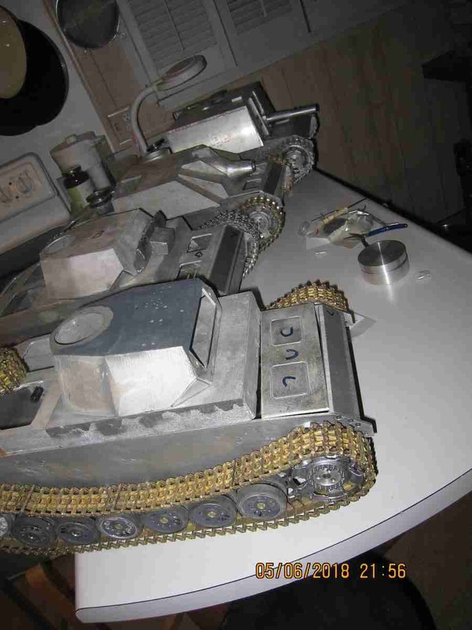

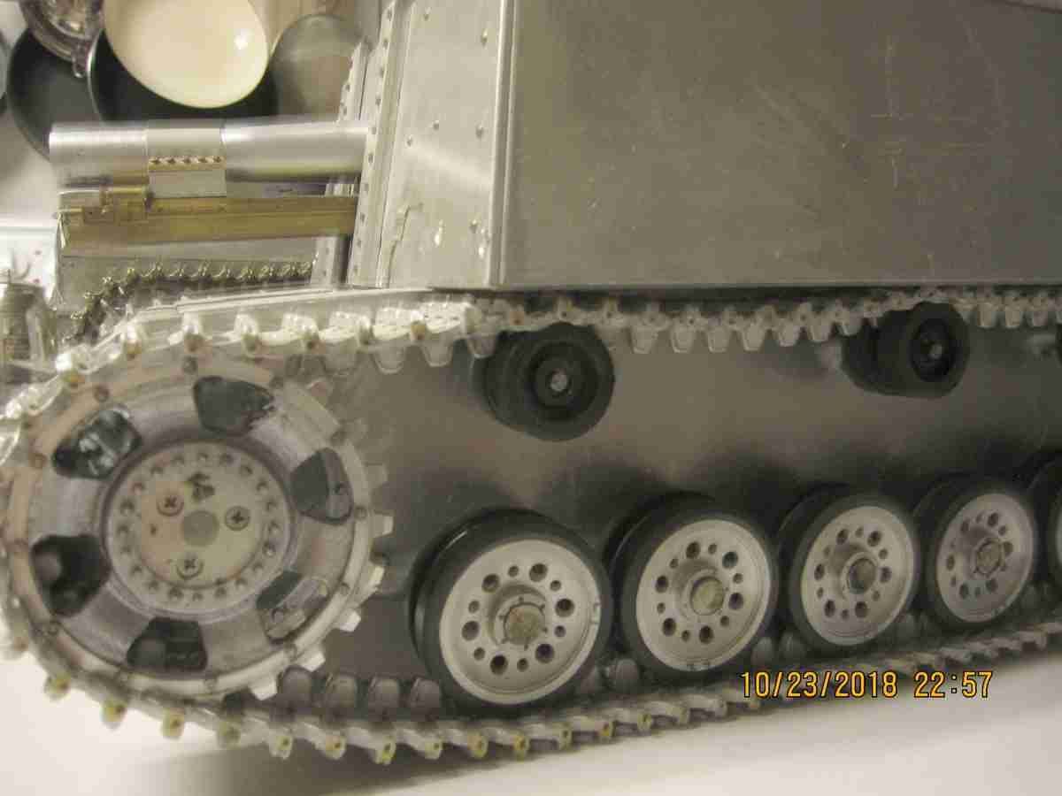

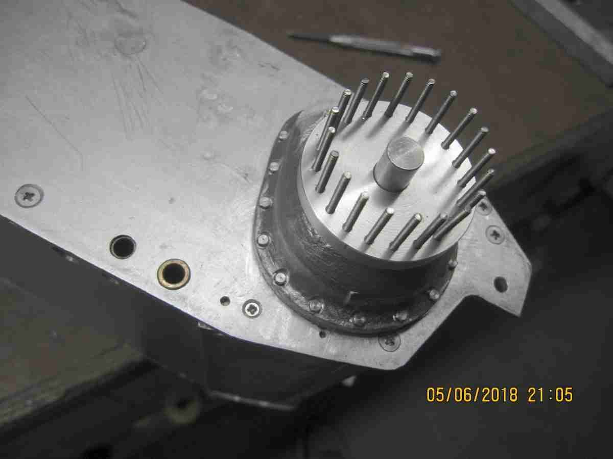

I haven't updated this thread in a while. Still making progress. I've done the very initial, but the most difficult part of assembling the running gear on 4 of the 5 pz III variants
I've been working on. When looking over the photo below keep in mind this is just me having mounted the sprocket/ final drives and idlers of these four models. The track tension mechanism, shock absorbers, and return rollers are not yet built and installed. The alignment between road wheels, sprockets and idlers is not set and the track chain lengths are all over the place. I just put these together in this way to give me a little feeling of accomplishment so they begin to look something like tanks...
With this fourth model done just this evening that leaves my old original StuG III which I've not touched in a very long time. Two of these models have aluminum track sets the other two tracks from Geiswerk. Not quite certain what I will do for my old StuG...

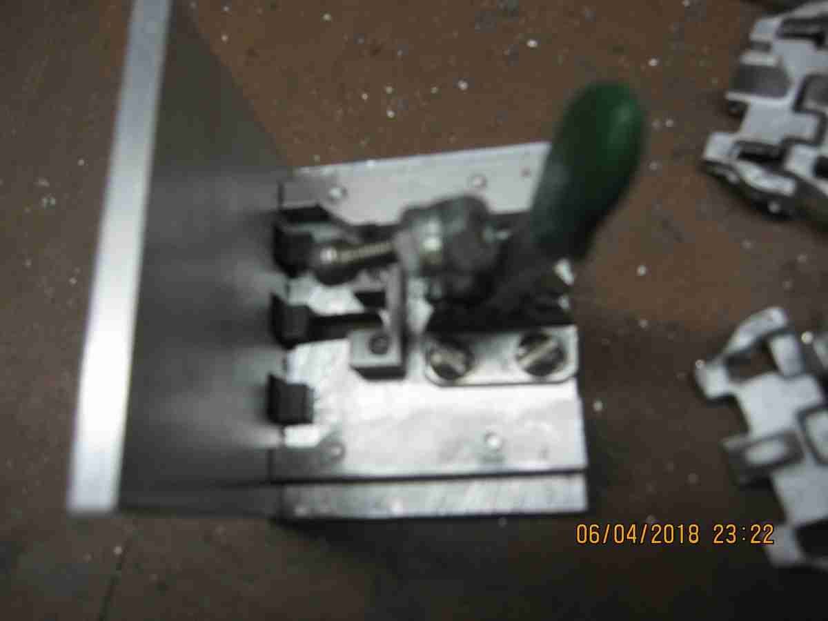

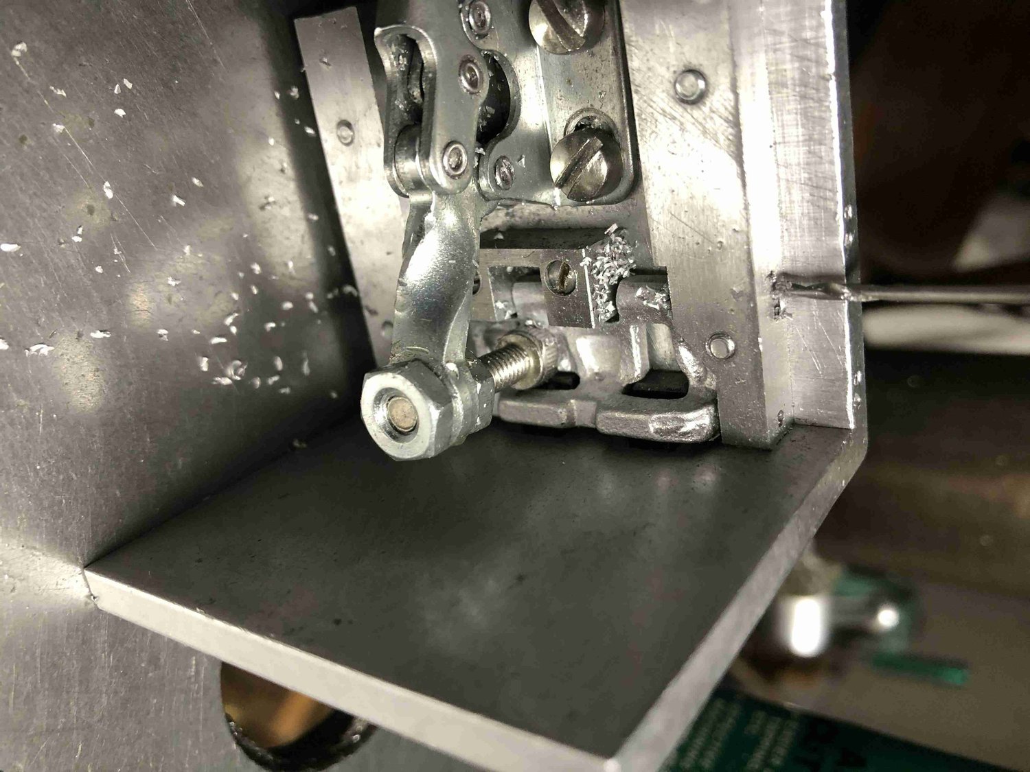

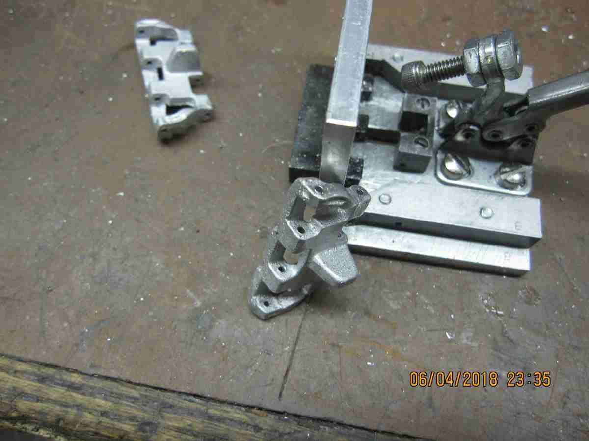

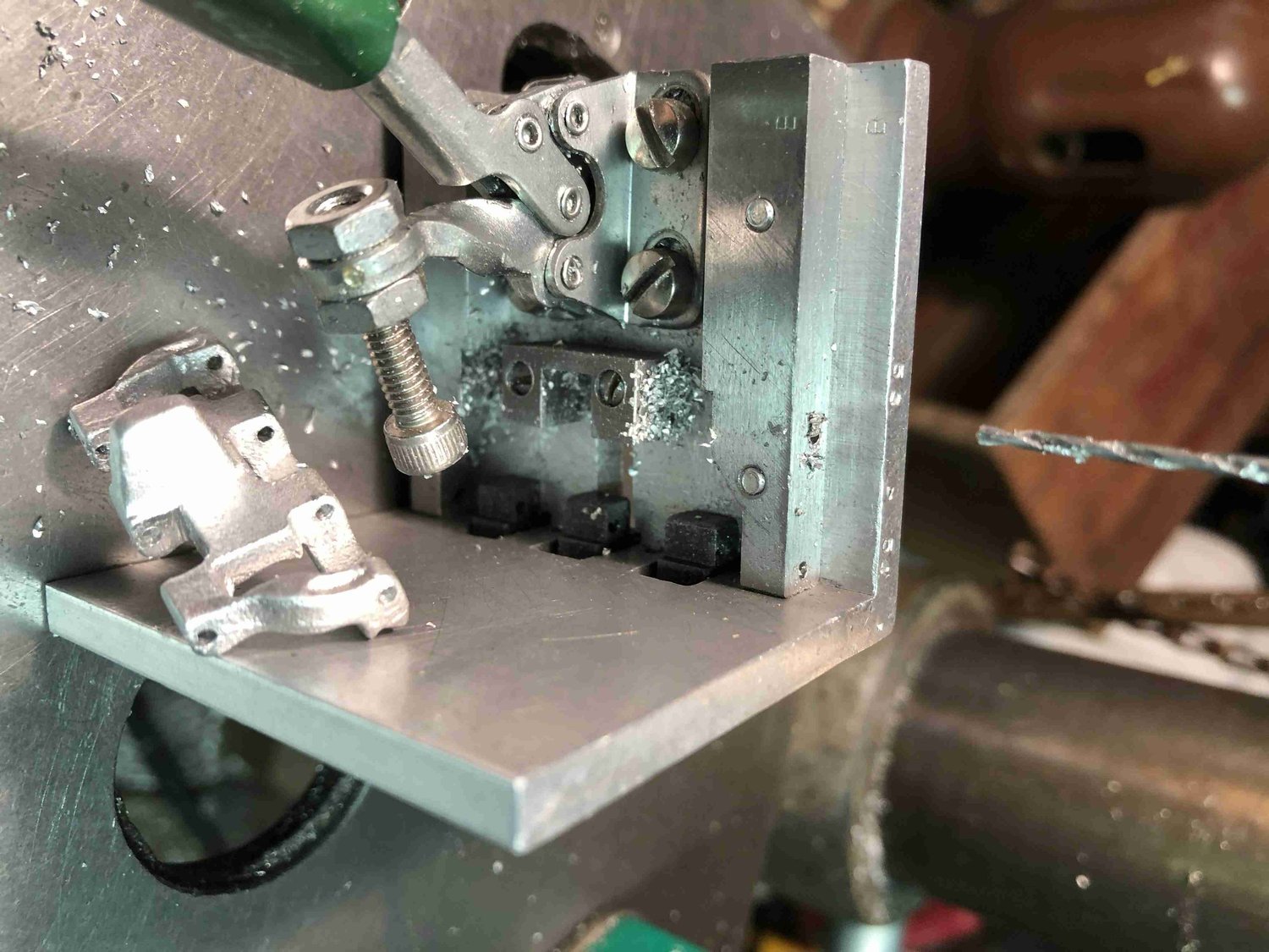

The work continues! Spent time over the last week of so preparing a drilling jig for drilling the pin hols in the track link castings I have.
Won't go into the details here but drilling links has never been my favorite pastime! It needs to be done and I do just a few each day
so not to OD on it.
Jerry
so not to OD on it.
Jerry

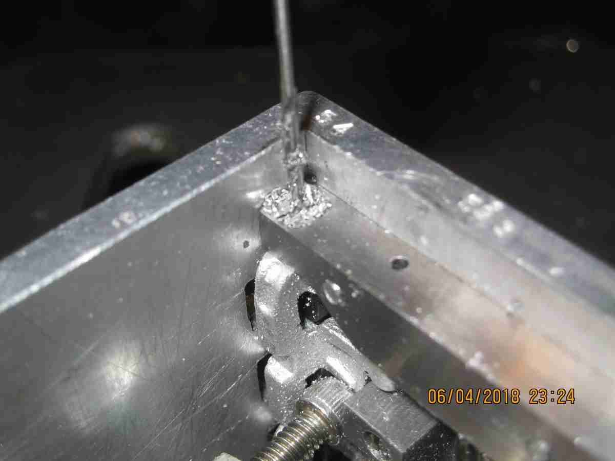

In danger of repeating myself from the previous post however.....one of the more dull tasks in making a model AFV. Drilling track link pin holes. At first glance you'
d think this is pretty brain dead work but actually it isn't. Drilling aluminum can be treacherous to the drilling apparatus as alloys vary in their "chewy_ness", without proper care and sensitivity, proper lubricant one of the very thin( .055" and .059") drills can snap off in an instant making for an annoying removal task. I've revised my drilling fixture a few times and I now actually have been able to make some decent progress. For the approximately 200 ( including tests) holes that these 91 links represent I've broken two drill bits. So the work continues. My old StuG here, I began it in 1989 (
) is sort of a special case. I already have a set of Geisswerk's Ost Ketten for her but I want a 'normal' set as well. I've begun preparing the links for the second chain and hope to be finished this week. Then it's back to return rollers, (I'll likely revise those on this old girl), aligning the entire running gear on the other 4 models and track tensioners for all. When all 5 of these models have fully realized running gear and a few other bits I plan to take a break from them for a time. I want to finish my KT and there are two others including one I hope to make into a pre-prod with Porsche turret.My ultimate goal is to get all these models that have been in my building queue to much the same level: the lower level detail phase so I can focus on 'mass- producing' details that are more or less common at the same time. All in all I have 9 tanks that are in that pool.

I like The Jig, Jerry. I wish they had used one of those when they did the tracks for my hetzer. I actually used to work for Destaco, the people that invented that type of clamp. And I know exactly what you mean about those tiny little drill bits. You just have to really take your time and when they break pretty much all you can do is cuss a lot.
#57
Crius, thanks. It took me a while to get this one more or less right. Those clamps are marvelous. I have several now. This was my first attempt at
making a fixture like this but not the first for drilling tracks. I made my own tool steel drill guides and that was the most trying aspect. I tried to harden a first attempt for the upper and it didn't end well. The inner portion of the forward guide is sort of hard. I just recently purchased an electric lab furnace that can go to about 1900F and next time I'll use it. I don't have the specs on the steel I have but I'd try oil bath hardening first and water second if
oil doesn't work. The other challenge is that the tracks castings, I didn't make them, have variations which required modifications to the fixture to allow for them. The castings I believe were made by different founders and there's different amounts/types of cleanup required but I made the holding area more generic. This fixture isn't perfect but it is ok and right now allowing me to make good progress.

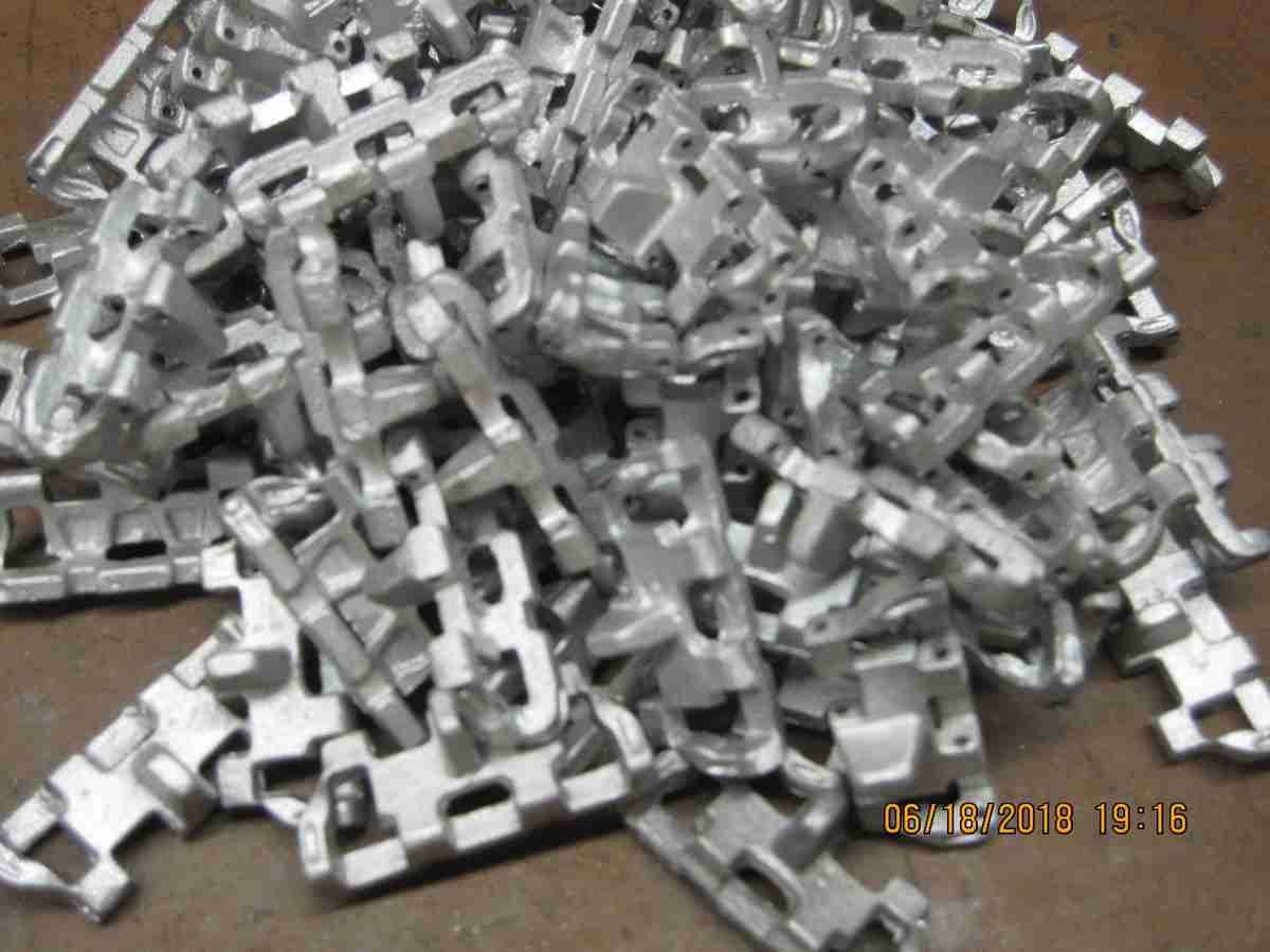

Inching along. I'm glad most of the tedium of making tracks is behind me. Besides making up some spares and fixing the link pins
properly so they don't work themselves out it's pretty much done. Doing this is one of those things you want to do least often. It's
just that the track link castings need quite a bit of clean up, sprues mostly and just can't just use a pair of diagonals to nip them off and filing to be consistent before they'll fit in the fixture and even look right. After actually drilling a few you get a feel for the tiny drill and how it will behave in the metal, you mostly know when to back off when the drill is getting loaded up. I broke 3 number 54 drills in the 270 links I drilled but was able to resharpen them once and I broke no number 53 drill at all. I also use A9 cutting juice. On to the next task. Return rollers, track tensioners.

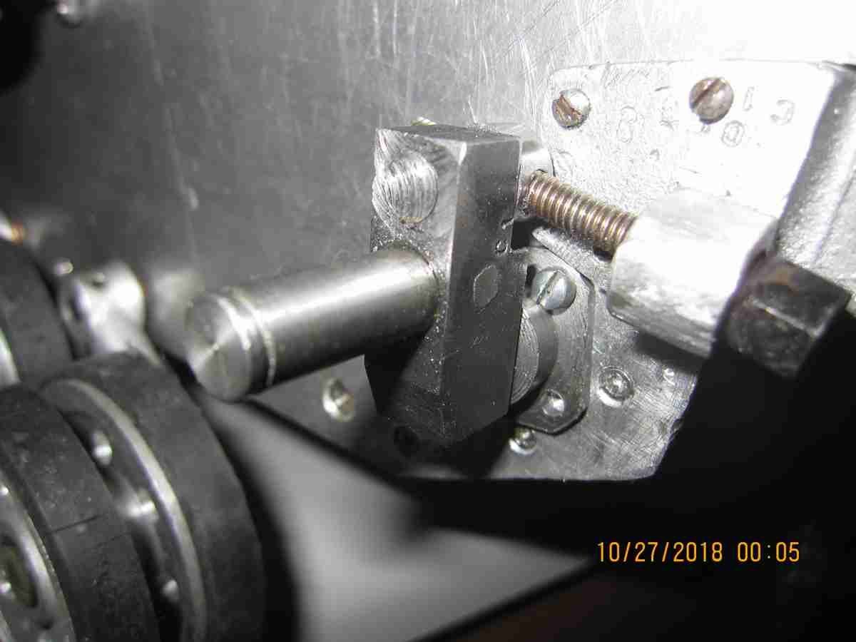

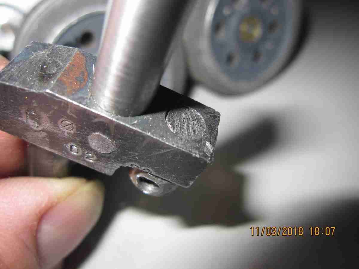

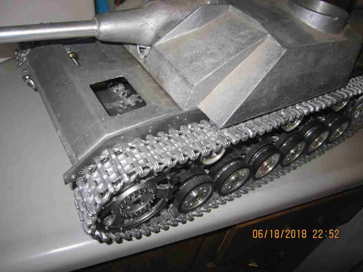

Progress is being made on my set of Pz III variants, albeit slowly. Working out track tensioners or rather how I want to make them. I believe I've it worked out although I will likely change
to a thinner profile hex bar for the actual adjustment rod. I've been making return roller tires slowly, a rather boring task but grateful I can do it. My goal of bringing all of these models
to the same point so I can take a break from them is nearly realized. At least now they all more or less look like something instead of that pile of miscellaneous parts in my closet.
I've begun tuning the suspensions, making adjustments, new stiffer torsion bars here and there however the final adjustments need to wait until the models are nearly complete as it depends on the final suspended weight.

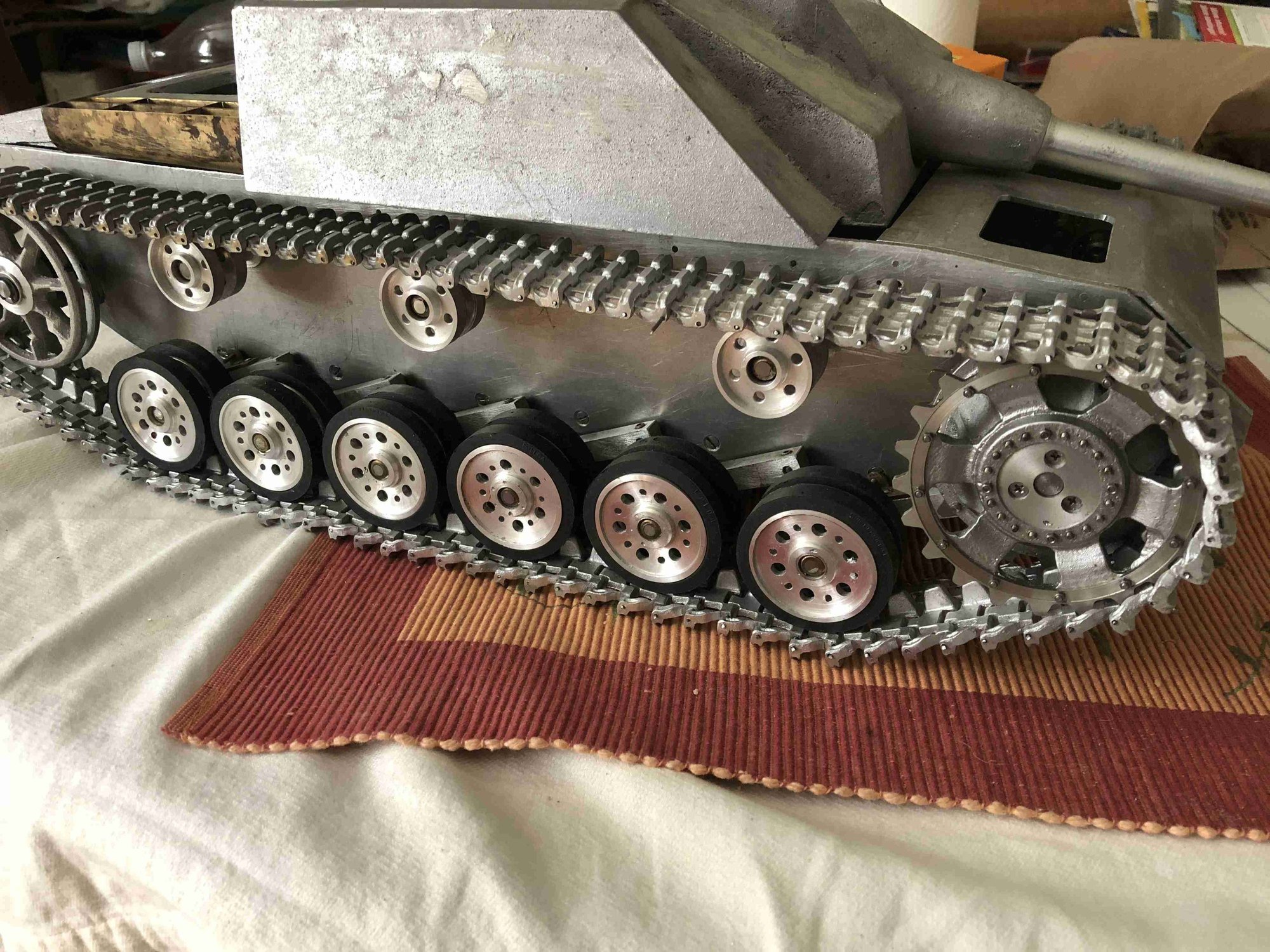

Here's the lineup as they sit right now. I wanted to bring them to this point before a take at least a partial break from them. They are all more or less at the same level of development; most
of the suspension components are installed up to the tensioners. There is of course much much more to be done but I think the most machine intensive bits are complete. I wanted them to at least
look roughly like tanks before slowing a bit. Slowing up a bit will give me a chance to consider how best to make the bits that remain and still work on them as the mood strikes. I want to work on that transmission that's sitting in from of the line. I believe it is an older Veroma unit I picked up somewhere, was pretty worn but I went through it once. It was for electric power however want to modify
it to work with a VT49 engine which you've ever heard one is a very quiet 4 cycle engine. I'll need a reversing gear certainly. Anyway there it is.
BTW sorry for the giant photos, they are reduced to 30% of the originals but they're still showing up here as giant....
