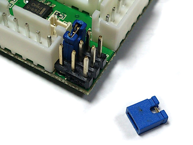

Has anyone had any issues with programing the Clark TK22? I have 3 of them and the remote, all are IR. Here is what it wont allow me to change. It gives no LED flash when trying to change the function.
I cant get all the functions to work with the remote. Ex.Mixer mode, invulnerability time, strength of firing tank gun hull recoil, reload sound on, off, ... I have new batteries in remote and freshly charged in tanks. Any Ideas??

Well forgive me for sounding a bit patronizing but troubleshooting always starts at the basics... have you used the jumper on the 2 correct pins (Servo recoil pins, 2 closest to the IR emitter port) while you turn the tanks power on? That enables programming mode.
See here
Once that is in the proper mode you need your IR sensor and LED indicator hooked up correctly. I use a Tamiya sensor so it all plugs in only one way into the 5-pin cable.
All the info you need is here, follow the procedure step by step, I use the same steps every time
http://www.clark-model.com/eng/prod_rx20/index.html
