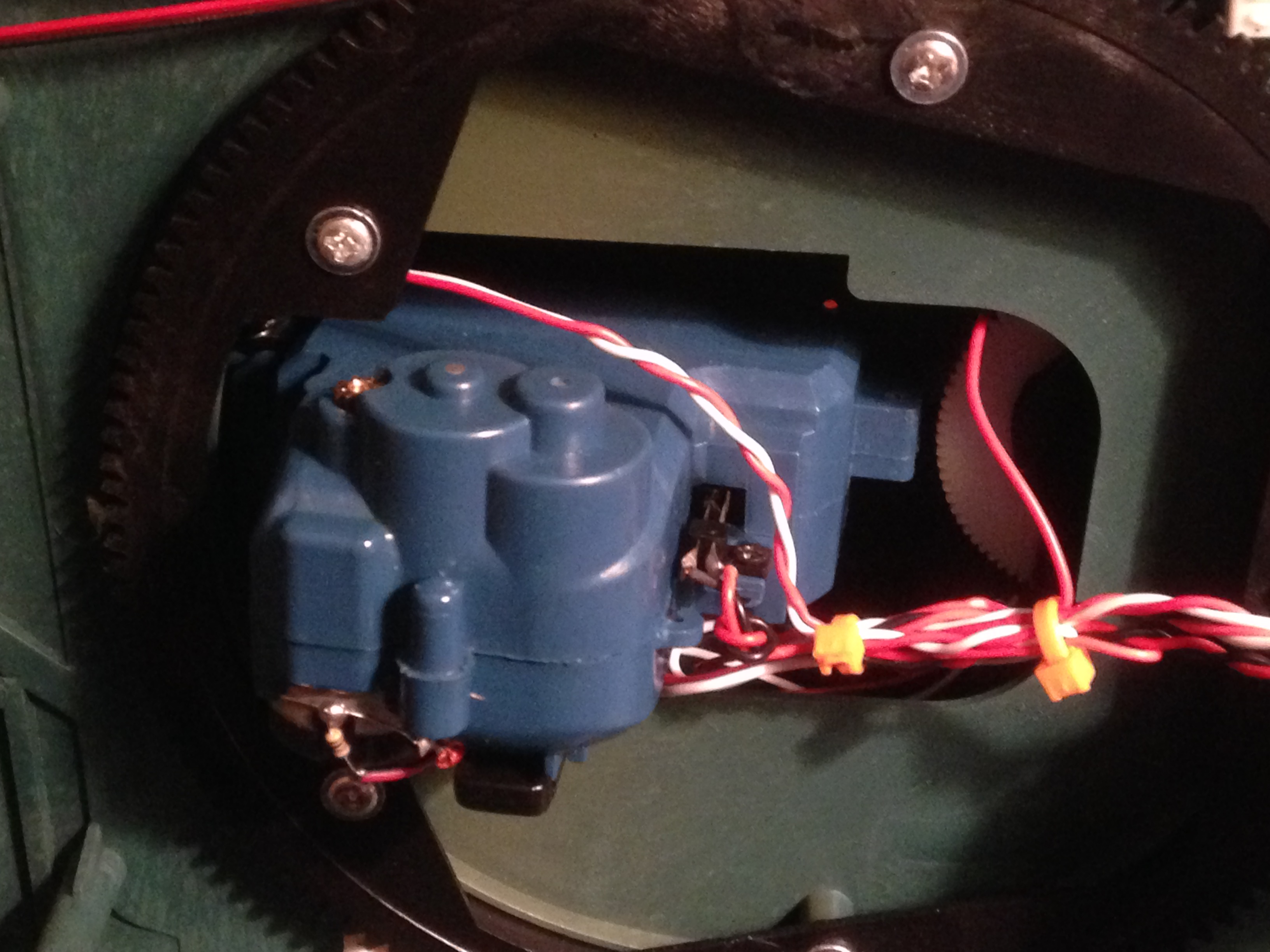

I would check the limit switch on the airsoft gun. These are a flmsy affair. If the switch is staying in contact then there is nothing to turn the airsoft off. Open the tank. Look up in the turret to the airsoft gun. You should be able to see this switch. You will need to pry apart the contacts ever so slightly..
Everything else works, except the gun keeps cycling?
Cheers.

Hi, sorry for the lateness, been busy fixing up motors and fans hehe. Limit switch? Do I need to take apart the turret to get to that? Sorry, still kind of new to this.

You have to pull the upper hull off and then you can see the contacts Dan is referring to. They're at the back of the housing extending up into the square opening. Here's a pic of mine since I have it apart at the moment.

Just checked it out. My limit switch seems to be fine, looks exactly like yours. For good measure I tested the tank with the 2-pin connector from that switch unplugged. Same results - turning on the airsoft function from the turret results in continuous firing, just withou sound and track recoil.

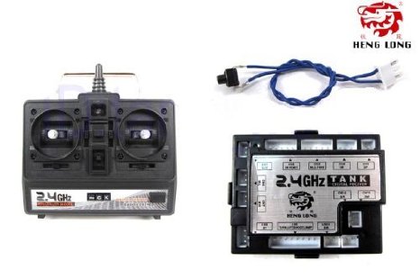

Old 11-23-2015 | 06:18 AM
Joined: Sep 2015
Posts: 21
Oh wow man you don't have to do that! Maybe I could fix it up on my own, if it's possible? It's a HL Leopard 2, the 2.4ghz version. My only tank for now, but hopefully it's the first of many!

Old 11-29-2015 | 04:51 AM
Joined: Sep 2015
Posts: 21
Sooo given that the contacts are fine, is the MFU definitely the problem, and there's nothing I can do to fix it other than getting a new one?
