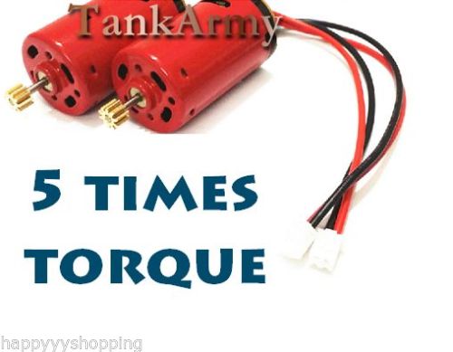

Hi All,
I recently bought 2x High Torque motors for HL Leo2A6. (Apparently 5x times stronger)
My gears are all full metal to handle the gears.
I installed them, works fine, went fast if accelerated at full speed, etc... EXCEPT!
1. When i turn RIGHT, it didnt have much power, then the tank went dead. Then i had to restart the engine from the controller. (reminds me when you have not much power on battery and due to recharge)
2. But when i turn LEFT, it has power to turn, but not much as i expected comparing the power when your tank go forward or backward
I fully charged the battery
I tested the tank on paved bricks floor. Standard HL metal gears works fine on paved surface, but not the new high torque gears.
Could anyone kindly suggest what the problem might be?
Thanks in advance

I think this what's happening to your tank.
I don't think it's a battery discharge problem because you can move forward and back fine right?
I think it's your motors that are drawing too much current and the board just shuts down. The reason why it only happens when you turn is because one motor is basically moving the entire tank weight, so that motor is drawing much more current than when two motors are working together to move the tank. The reason why the right is more affected than the left is because your your left track is more rigid, it takes more torque to move it, hence more current being drawn by the left motor.
By any chance you're using metal tracks too? Metal tracks requires more torque to move, so taking them off might help.
Do the following test: Take off the tracks and test your motors just with the sprockets. If they run fine without the load, then it's the motors drawing too much amps than your ESC can handle.

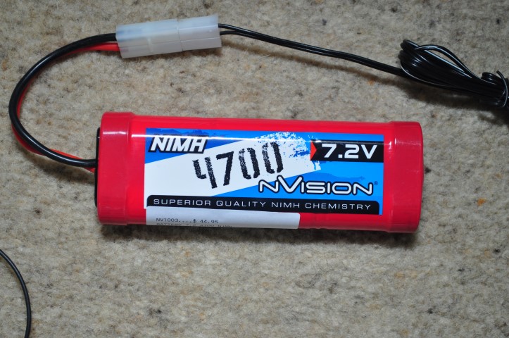

Oh this is the battery im using.. i think it can handle more than stock battery does.

If all is well in the gears, then it does sound like your Hi torque motors are drawing more power than either the battery or control board can supply?
For example - I have a set of high rpm 380's here that will basically move the tank about 6" before shutting down the Tamiya DMD that they are hooked up to. I did some research on the model they were intend for and discovered that it comes with a 70A ESC(!) - the DMD can only supply about 20A before it shuts down.

I agree with Pat. And there is really no easy "fix" to this.
1. If you want to run these motors, you probably have to get a better board/ESC that can handle the current. Email the people you bought the motors from and ask for what recommended tank electronic to run them. Ask for the motors continuous current and peak current are also useful to know.
2. Use old motors or get motors with current that matches your board motor controller. For example, these promax 480 motors (ACC348) draws only 12A max and they are very strong. (http://www.maxxprod.com/mpi/mpi-10.html)

Sounds like stall current problem with motors drawing too much current for the ESC's.
Need to compare the motor data sheet with the stock motors and 'find' a motor with better torque/RPM that does not let stall current go through he roof!
5 times the torque usually means increased current draw (especially for one motor as in turning) and thus a bigger ESC is needed. The battery is good for all types of ESC's so don't worry on that.

I have found Lipo's are the battery to use in situations like this. The issue is more the battery then the ESC. If you use a lipo this issue will stop or fry your ESC if the motors are truly drawing that much amperage.
IN all the cases where I had tanks shutting down from to much amp draw( Brownout) the Lipo cured it every time, and to date all my RX18's are still fine.
Also what gauge wire are you using to supply the ESC from the battery.

It's probably a combination of Battery current drain, ESC max surge and motor stall characteristics.
I'm sure a hot motor can be used if the stall current is low for his application.
Now that I think about it Dan, your point seems more valid as I have experienced some browning from batts freshly charged. In fact after running them a bit the browning goes away.
Maybe some batt types need 'warming' for the chemical reaction to surge when needed? Sound viable?

This item has been used in many heng long tanks without any problem. I suspect your 4700 mah battery has caused the problem. It is recommended to use with heng long 1700mah battery.

nexusys have you checked this video posted by maxu 52 360 Hi-torque Motors in Modern Tanks (A Squad Video) you haven't mentioned it and for the $7.00 & that includes shipping sounds like the cheep way to go and get the tank running. instead of burning the rx 18 in this one out or spending money for a transmitter to use the clark board, that you still don't know if it can handle these motors either
Yep, i just watched them, (was at work yesterday, so no go for youtube videos). That looks good, just what i was expecting to have. I got all the speed, but not when spinning, and climbing.....
Yea I saw those "5x the torque!" motors and knew something like this would happen. An easy way to find out if you are pulling too much amps is to get a 5A auto fuse and hook it up between your motor and your motherboard. If you blow the 5A fuse you are pulling too much power. 5A is about max it can handle if I remember correctly.

Yes, Lipos can deliver way more current then NiMH batteries. That is why they are so dangerous. Dead short one of these and something bad will happen.
All I know is that when I am running a Benedini ,15 watt amp with a 12 volt power convertor the brown out with NiMH is almost inevitable if the tank gets into some heavy lifting. With Lipo's there is no issue. Maybe if a guy went back to a receiver batter pack might help as well and isolate your electronics from the mechanical side of things. .
You use a 12 power inverter, I bet that's the issue with your battery browning.
From my experience building power supplies, the current draw can be excessive (and instantaneous) to maintain voltage level on the output. The recovery of battery is typically too slow for most inverters when drawing surge current from my experience.

Hey YHR, can you confirm this? i would consider to get LIPO instead...
I dont use any other wire apart from stock supplied stuff...
Hey Kizwan, this is it... no brand or whatsover..
