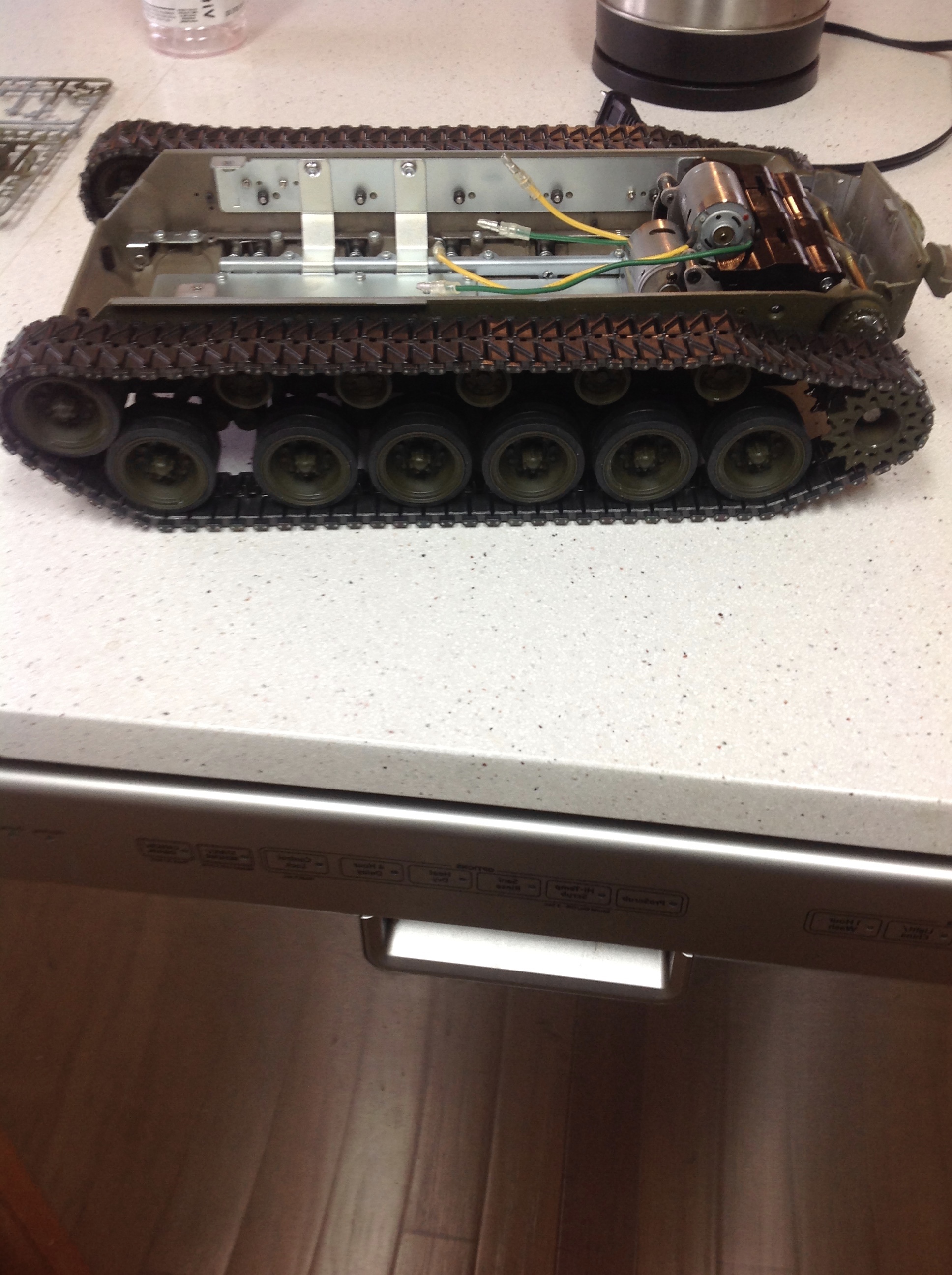

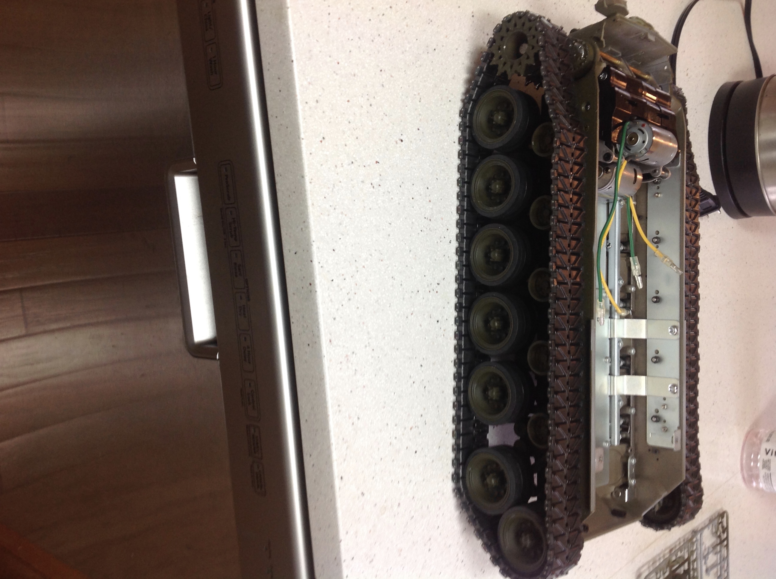

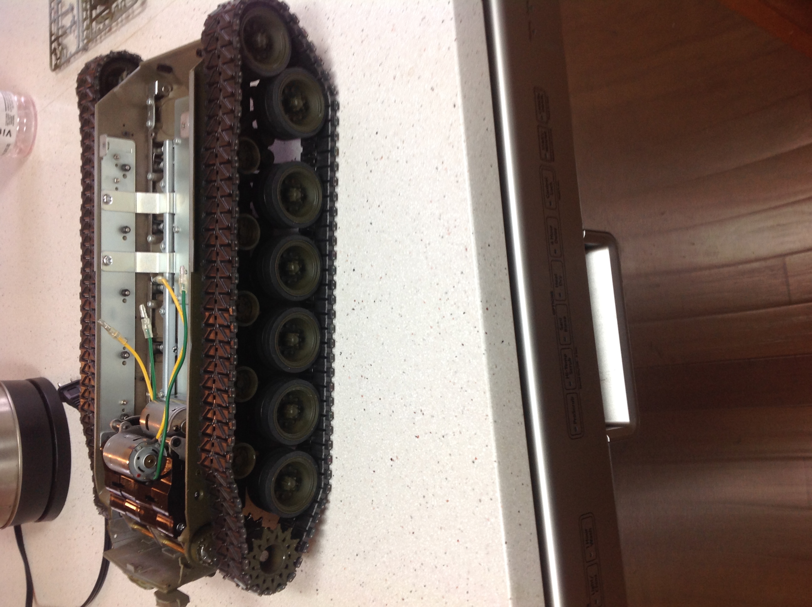

I've installed the road wheels, tracks and idlers. The idler system leaves a lot to be desired, I don't see anyway of adjusting track tension. Are you guys running aftermarket idlers? Sorry guys, I can't get the 2nd photo to lay flat. I've tried flipping it but it keeps uploading vertical.

[QUOTE=Tanker 10;12144150]I've installed the road wheels, tracks and idlers. The idler system leaves a lot to be desired, I don't see anyway of adjusting track tension. Are you guys running aftermarket idlers?[/QUOTe
The stock idler system works well. I've only seen a tammy pershing throw a track under extreme conditons of deep loose dirt/sand and doing fast pivot turns during IR battle.

So that pin to hold the idler arm doesn't give you any trouble?

Are you talking about the cotter pin?
It is a little tricky to get in and out, but I would not really call it a problem.
The Idler adjust is limited to 3 positions.
I think mine has always been in positioned in the middle/ with the pin almost straight up and down.
I tried the Schumo aftermarket idler adjust to get more positions, but did not care for it as it was too loose.
Mitosal sells their own version, which appears to be engineered better than Schumo's, but I don't know anyone who runs one.
So I use the stock Tamiya one w/ no issues.
I never had a problem w/ my 1st set of tracks that I ran for 4 years.
But my replacement set that I bought a few months ago, were a little 'sticky,' or too tight between the end caps and the links.
This caused them to bind a bit which mad a kinda popping noise as I drove.
So I took them off and massaged them a bit and put a little lateral torque on them by hand, which loosened them up a bit.

Looking at your photo, it looks like your idler is in the loosest position, with the idler wheel basically touching the 1st road wheel.
Try the next position up, which should put more like a few mm between them.

Yes, the pin. I can see the hole in the arm enlarging after a while and then causing slop. Thanks for the tip on the idler wheel, I'll check it tomorrow.
