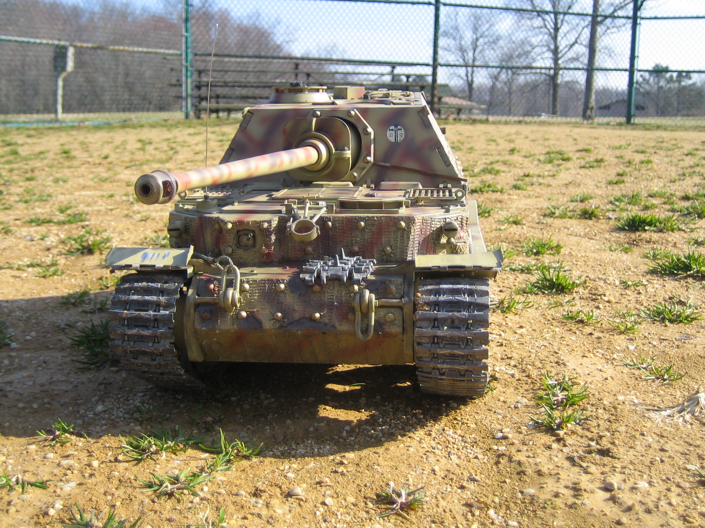

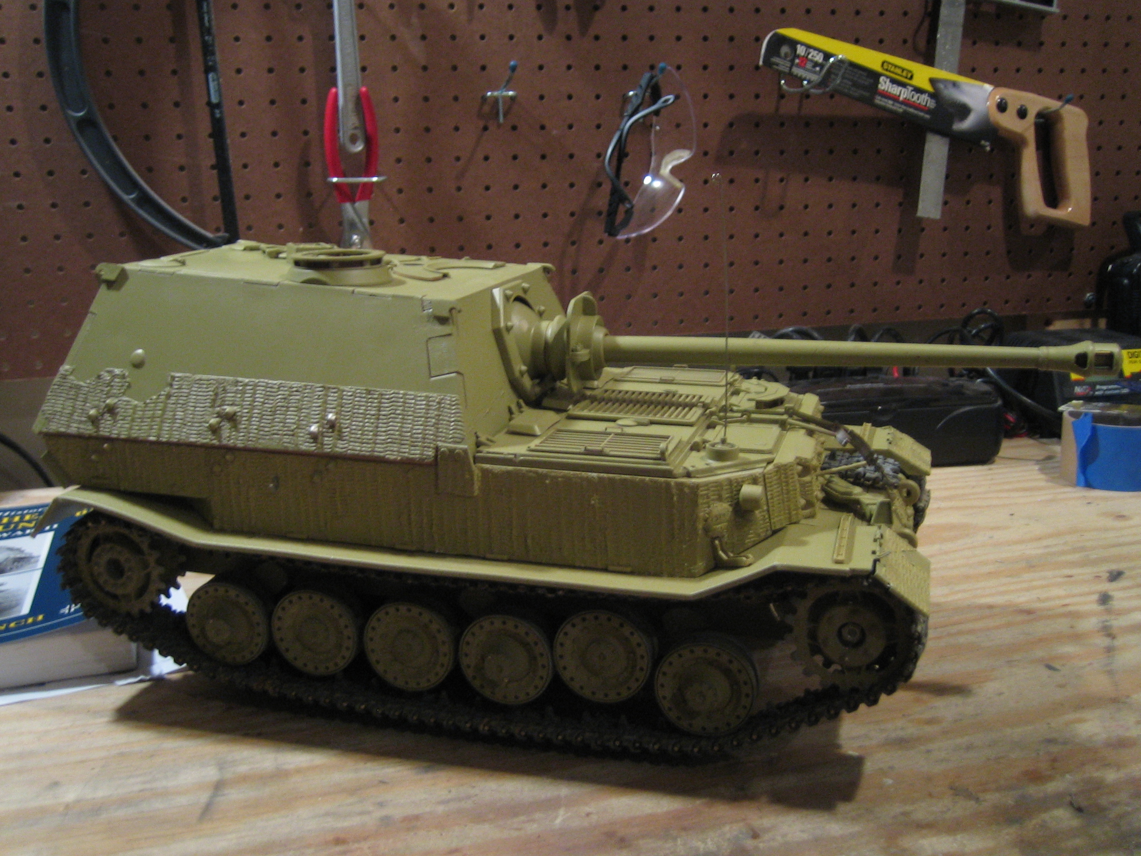

Old 02-28-2016 | 05:13 PM
Joined: Jul 2010
Posts: 3,148
From: West Grove, PA
I did the flash behind the IR emitter that was in a brass tube in the muzzle break of my Elefant. The flash will not interfere with the IR signal but you will not have much visible flash looking straight on the barrel, only from the sides. You can kind of make out the tube in the first pic and in the second pic you can see the very tip of the tamiya flash unit towards the back of the muzzle break.
