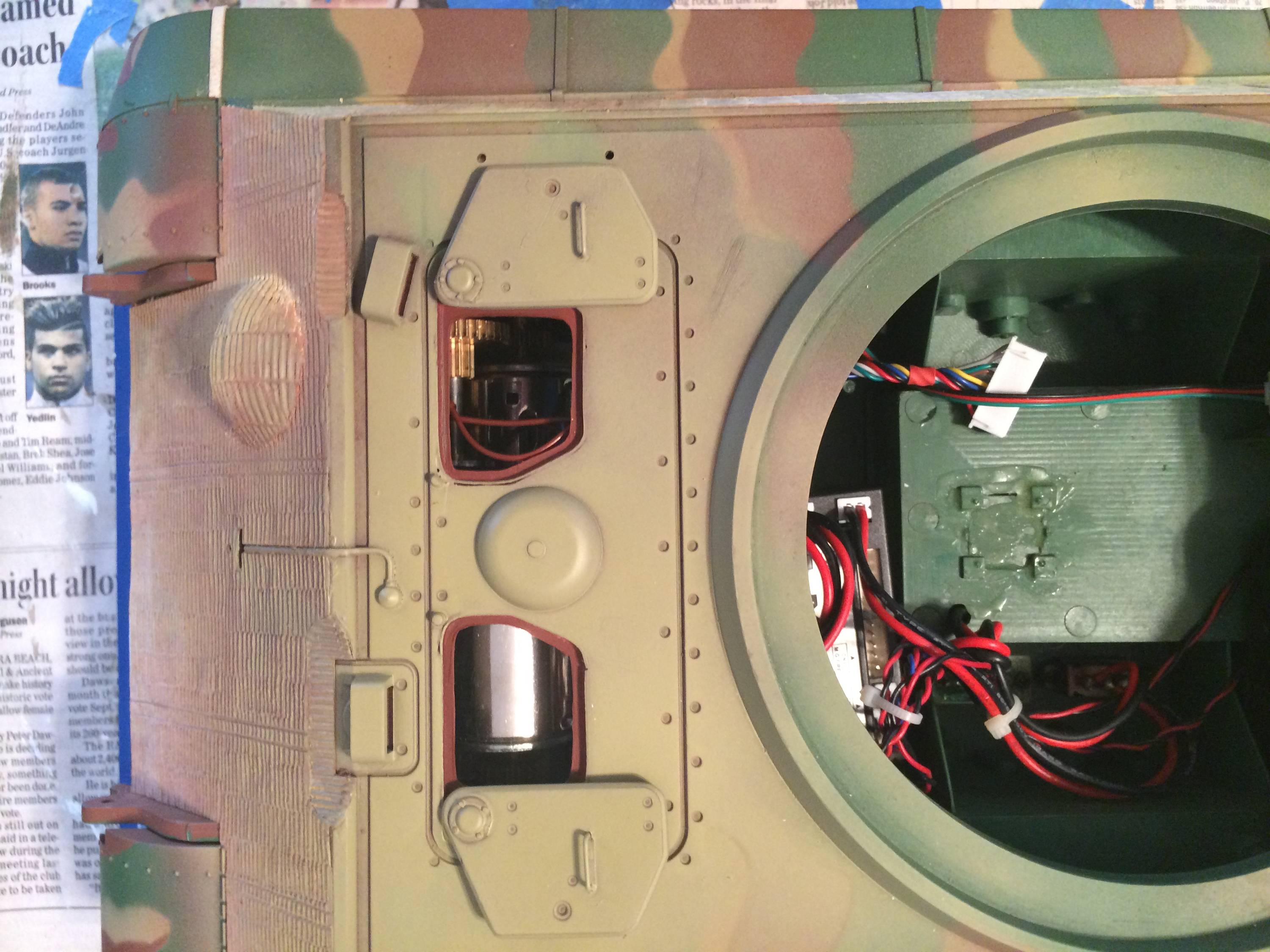

Old 03-10-2016 | 05:59 PM
Joined: May 2009
Posts: 1,506
From: Evans, GA
This is what my KT looked like after the Hatches were cut out and reattached with a screw, spring an nut Those are the same hatches that I cut out

Old 03-11-2016 | 04:54 AM
Joined: Feb 2015
Posts: 494
From: Alexandria, Minnesota, USA
Very nice, I hope mine turns out as well!
