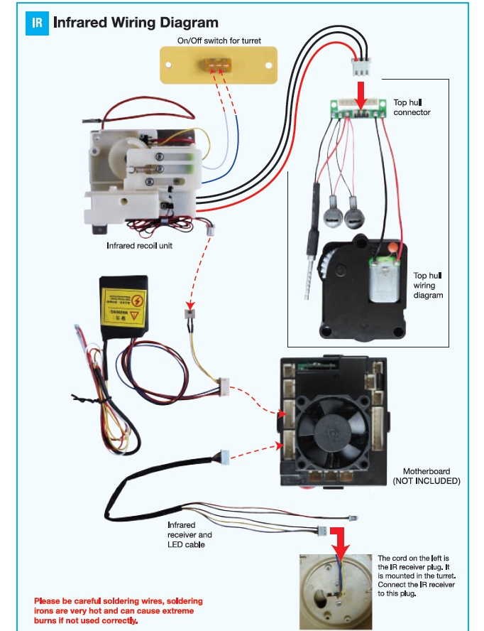

I'm not getting any barrel recoil. The tank was a Taigen scratch and dent. Recoil worked originally about 4 out of 10 times. I had been playing with the infrared switch and thought that might be the problem. I took the switch out and a little rewire about 6 months ago. Then disassembled for paint and detail. Now I don't remember the wiring. Everything else works.
I can trouble shoot. But I need to see the original wiring setup on infrared to check myself.
Does anyone have a diagram or good pictures of the connections?

Old 04-09-2016 | 05:14 PM
Joined: Sep 2015
Posts: 4,678
Received 319 Likes on 263 Posts
From: Detroit Rock City
Name:	Wiring Diagram for IR v3.jpg

The recoil unit is what I was looking for, the blue and white wire location
In normal infrared operation do you get a recoil? Nothing on the Taigen site.

Yes, it should have barrel recoil with the stock set up.

According to the diagram, the turret on/off switch cuts power to the recoil motor.

Found the problem!
Bad recoil motor. Replaced it with one from my parts box.
