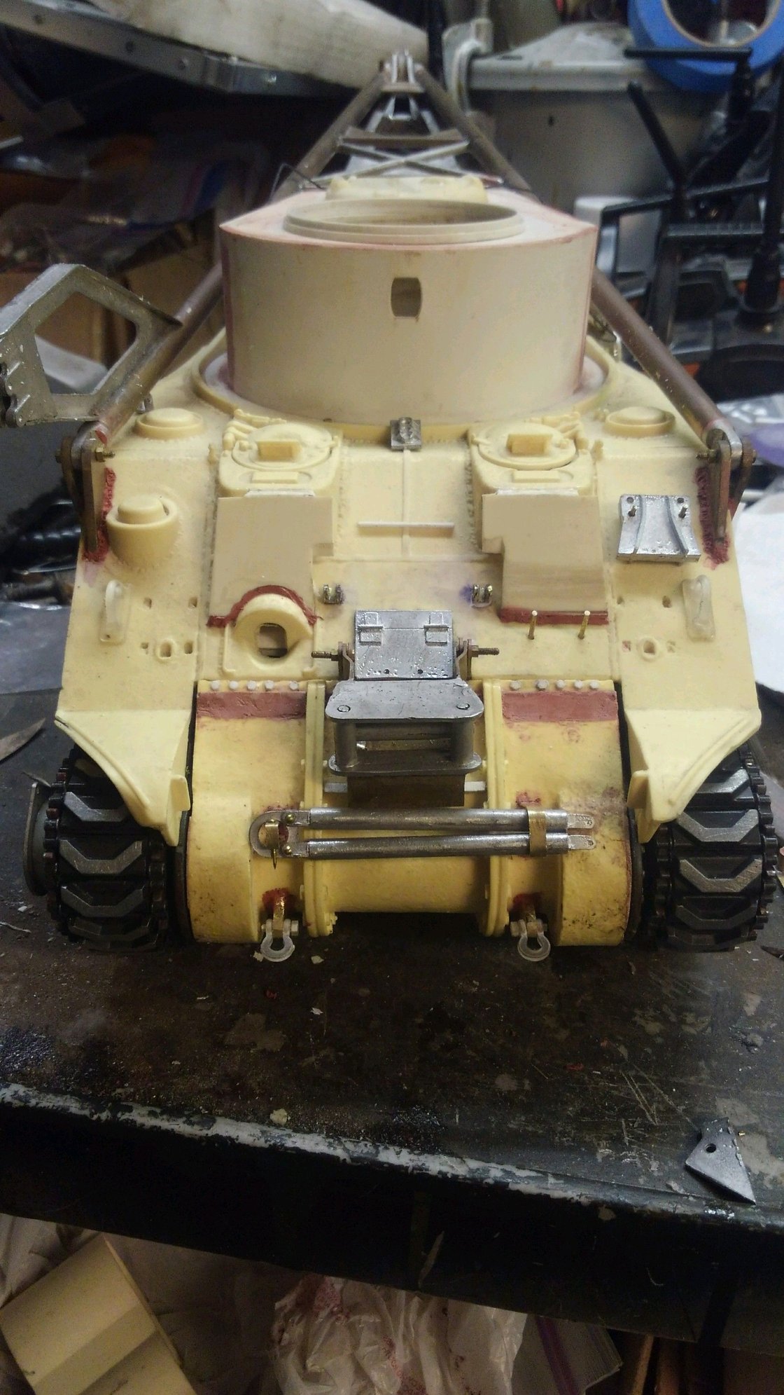

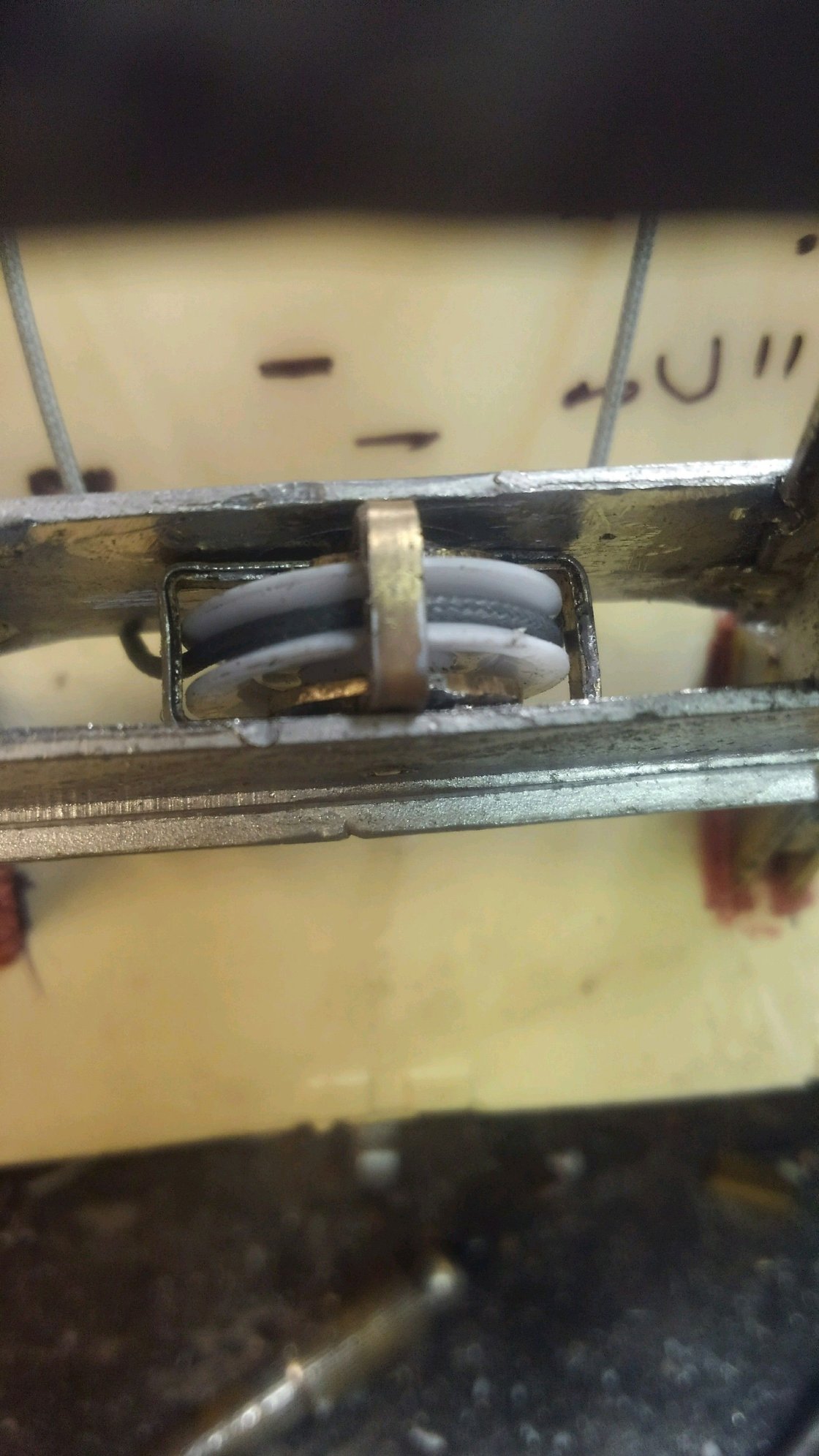

Wow more than a year I haven't touched this model. It was time to do something.... So I made the front fairlead roller contraption. A hand full of days worth of work. Used Ludwigs top part and roller but the rest of his parts were all wrong so I made some templates up and made brass parts and soldered it all up. Not a fun project, lots of burnt fingers and hurt ego when doing this kinda work.

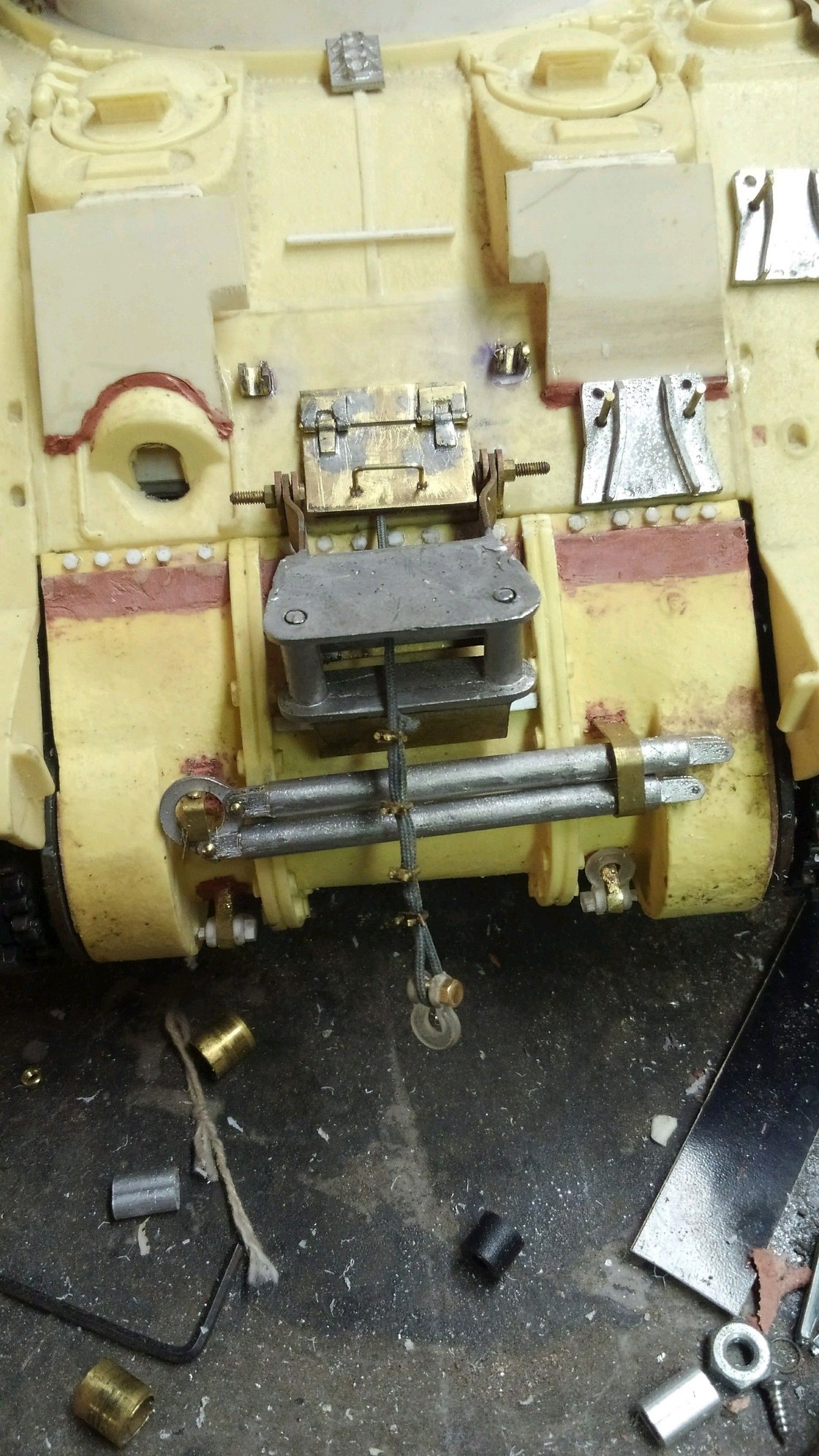

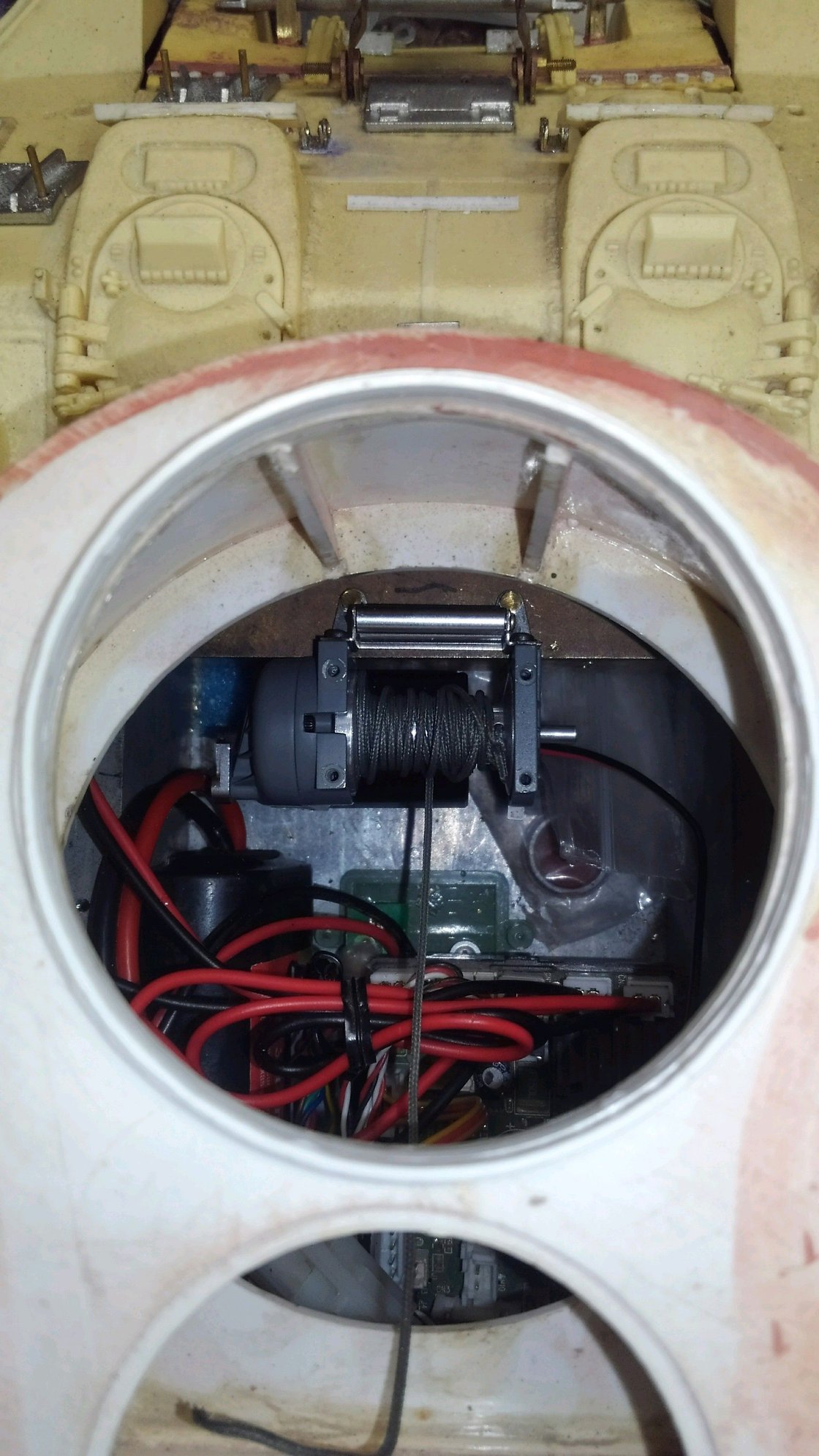

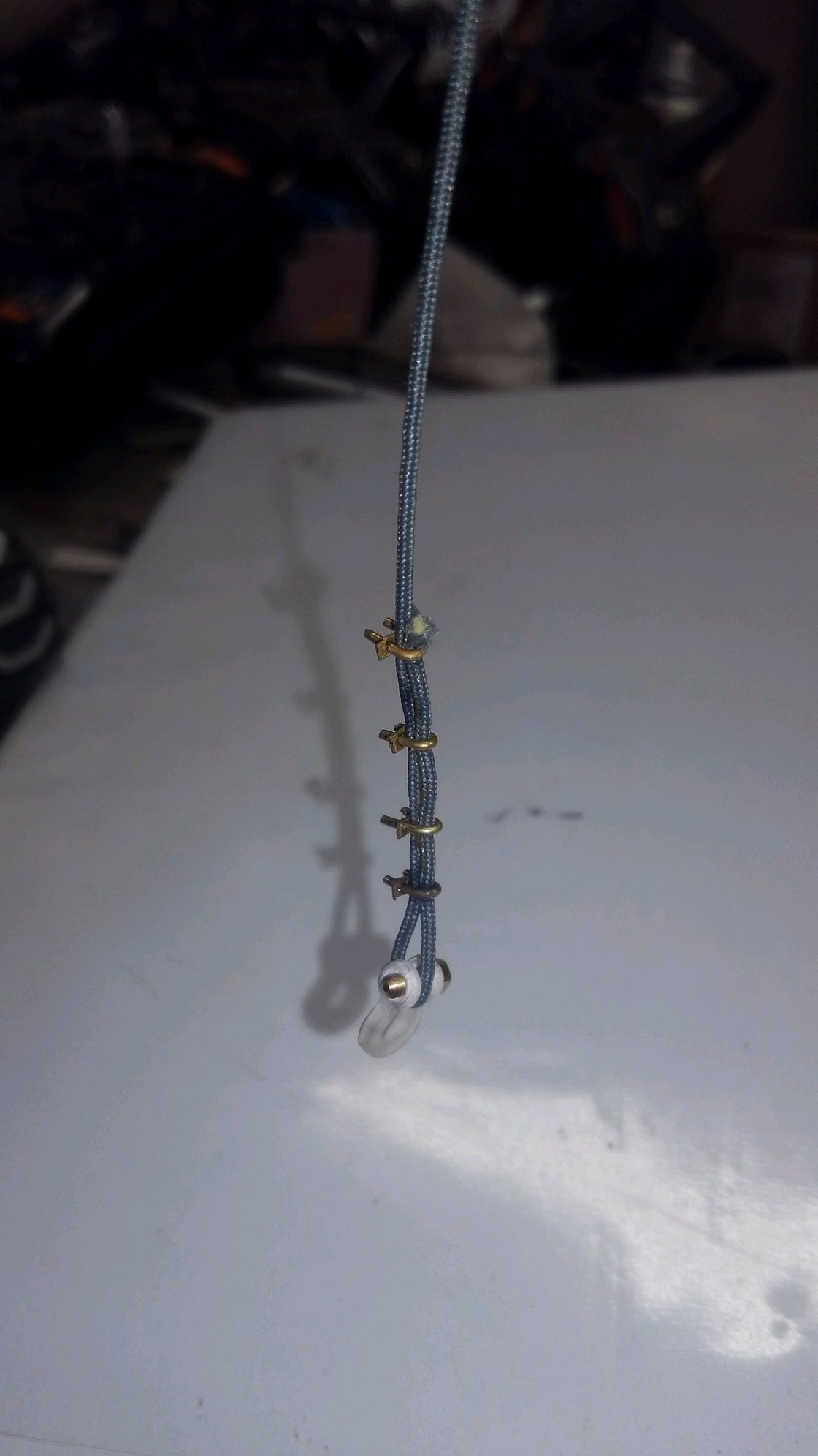

Wow been working all day power building. Got a bunch of tiny stuff done.
Its not really the work that takes so long, its going through 1200 pictures doing research on each little thing to get the details correct then make it up. Some trial and error also occurs.
Im especially proud of my winching/lifting cable end. Ive got it just right as the real ones are with 4 wire crimps. The whole design of this model is intended to be able to winch a tank out or two a disabled tank, yes I know rc tanks wont roll because of the motors, I will set up a henglong sherman to be towed, Also will have a lift off turret! But thats eventually.....

Sounds like I might have competition for "Messiest Workroom in the World".
Another fine job, Rich. This one truly is impressive. One of these days when I have lots of money I plan to see you about an E8. I know you don't often do custom builds, but I'm hoping you'll make an exception for your printer.
And where did you score that awesome cable? I assume the U-bolts are scratch built? That's gonna be an excellent detail on an excellent model.

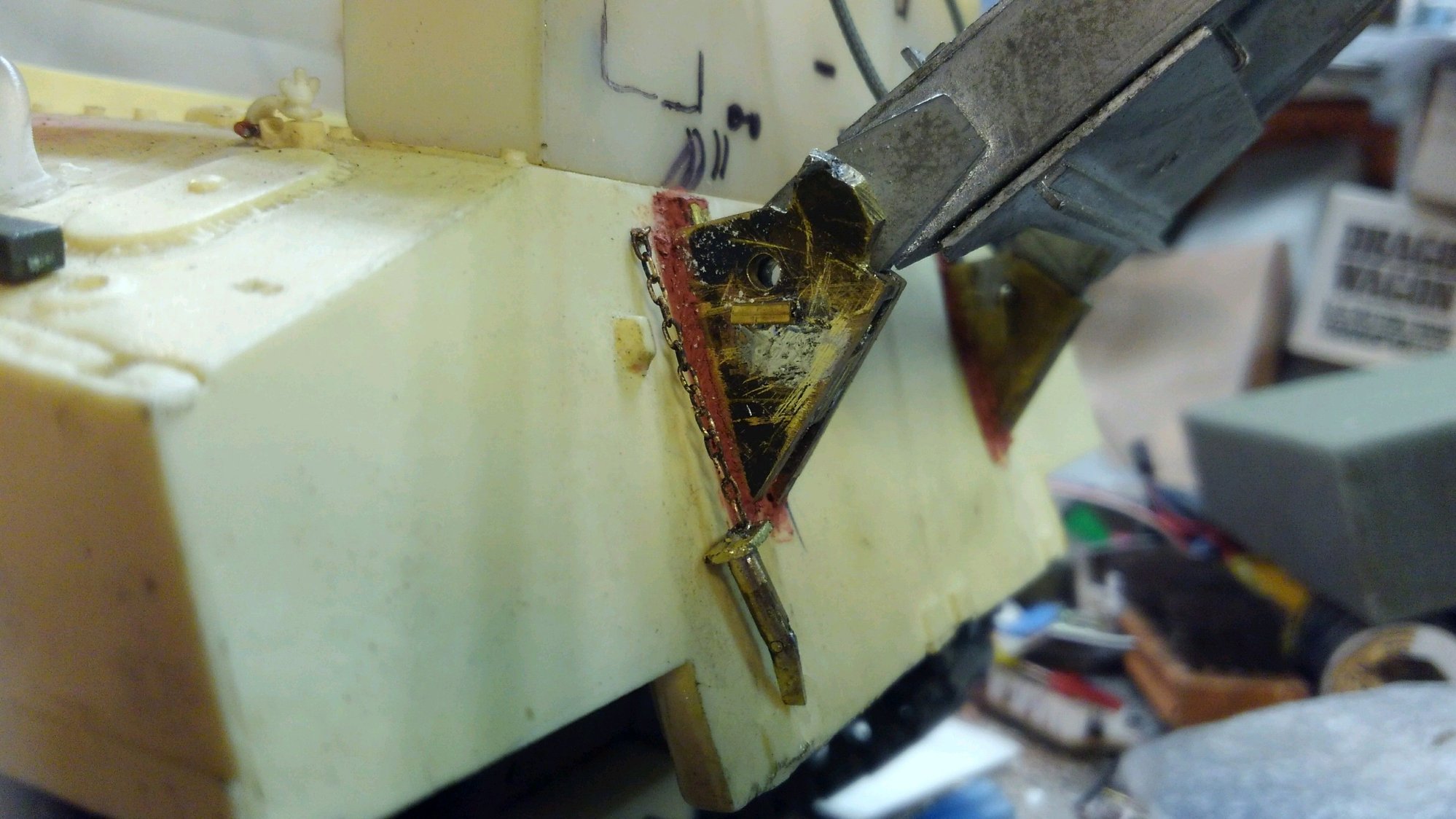

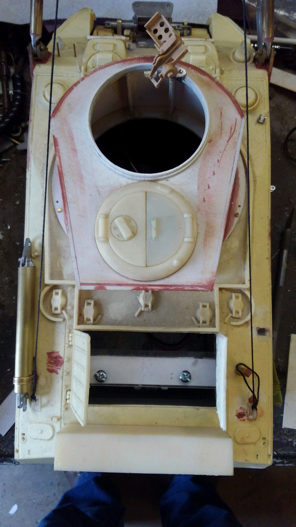

I fianlly got the front door fabricated. Ive been dreading making this part since I started this project 4 years ago. I knew I wanted it to actually work but I wasnt sure my skills could do it 4 years ago so back then I was entertaining just using brass doll house hinges. Im glad I never made it till now as I was up to the challenge to make it 100 percent accurate.
Now, if your an M32 expert you will notice I did not put the bullet splash on the bottom of the side of the door. I just dont think it would line up well into the hull and I was also afraid that if I tried too much heat the hinges would all fall apart and entire days worth of work would be lost along with my sanity so I just left them off. I could glue on some styrene strips later if I really want that look.... maybe. Enjoy the pics. Ive spent all night just looking it over. I played with the door in my fingers for a while just marveling at my work, really this one was a masterpiece by itself.

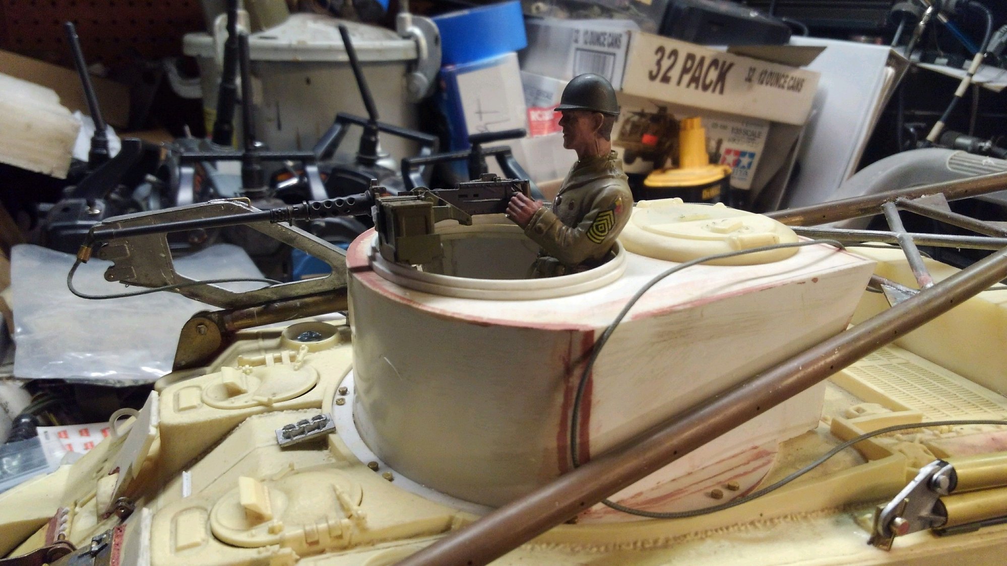

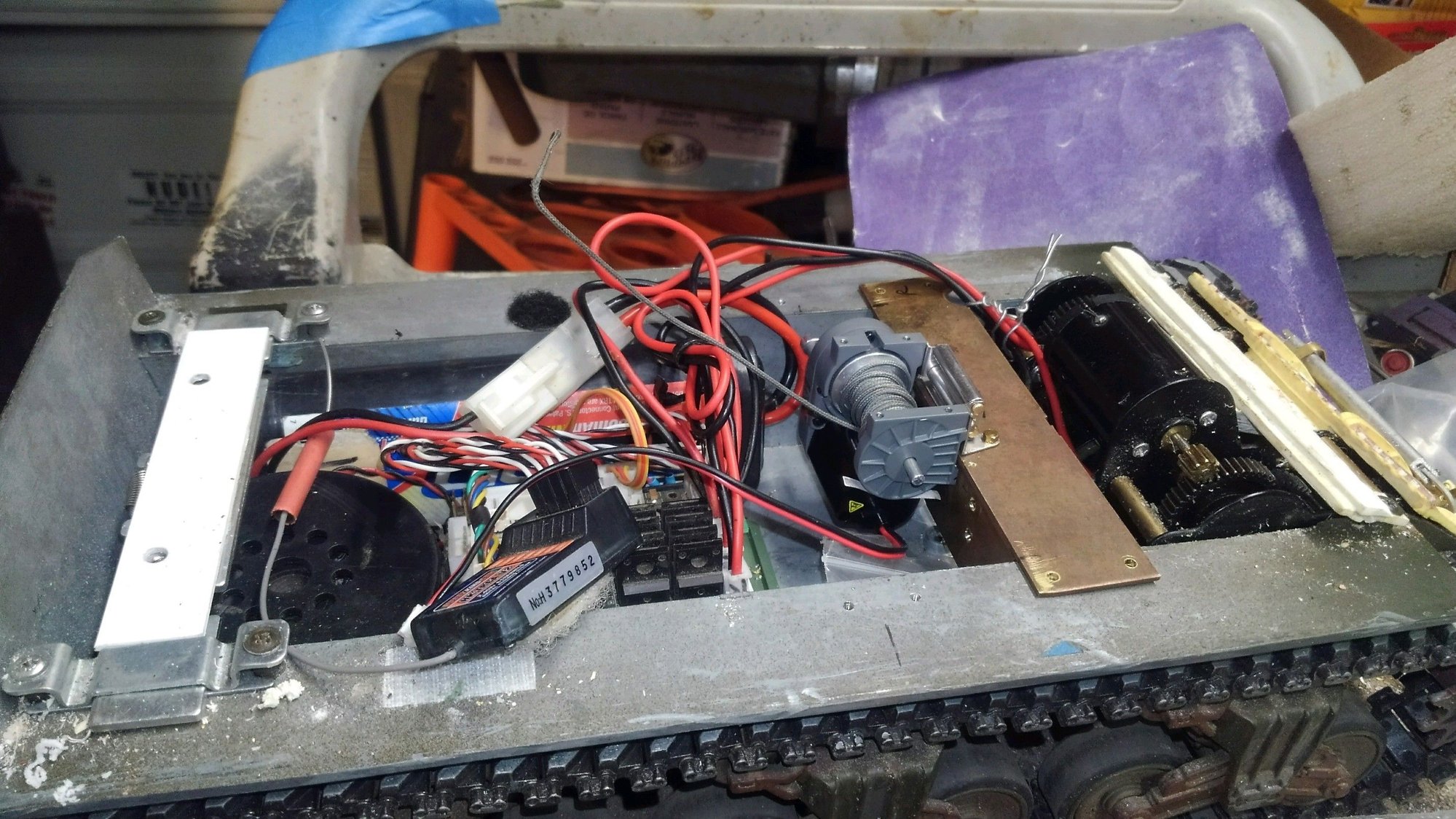

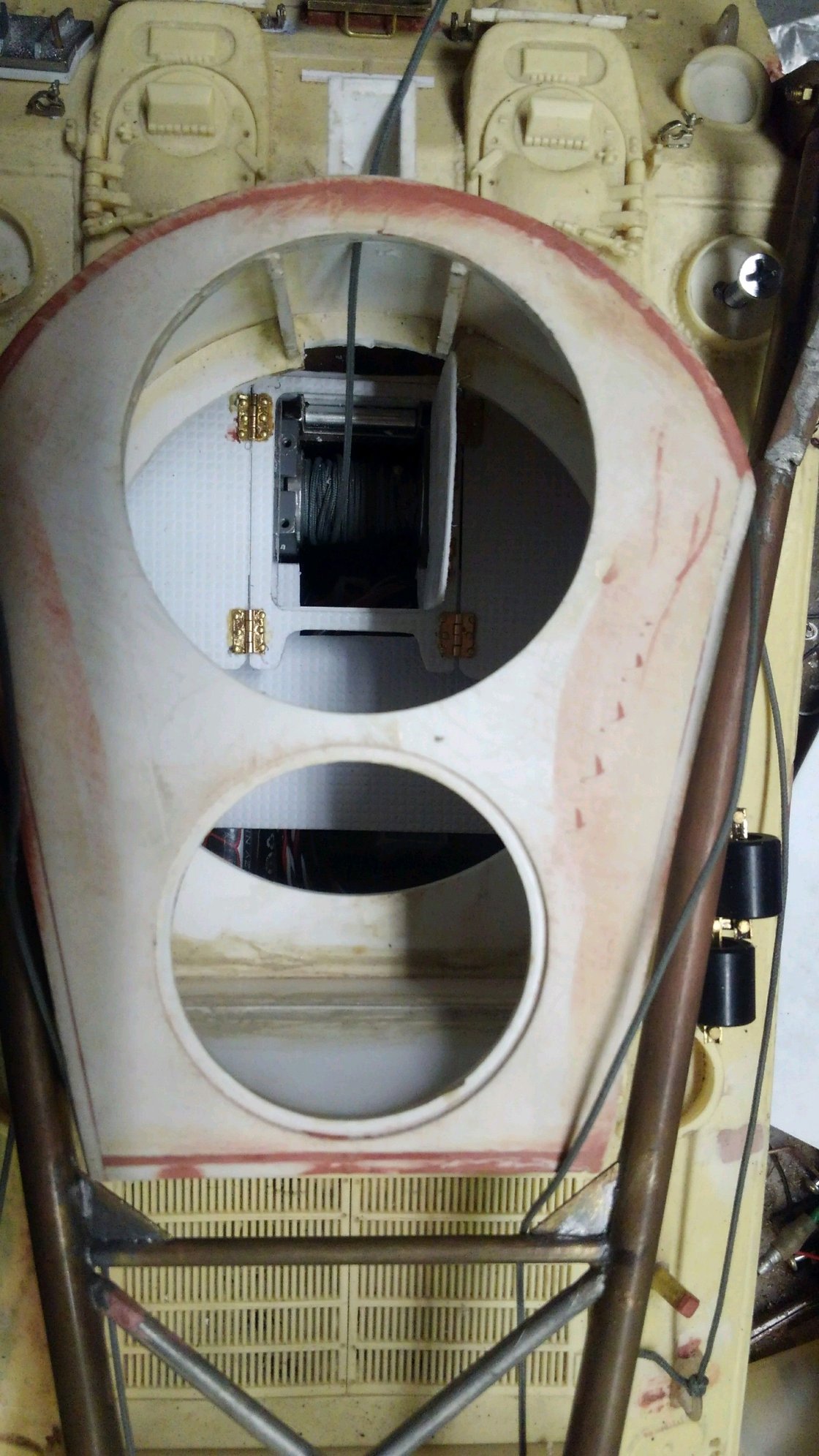

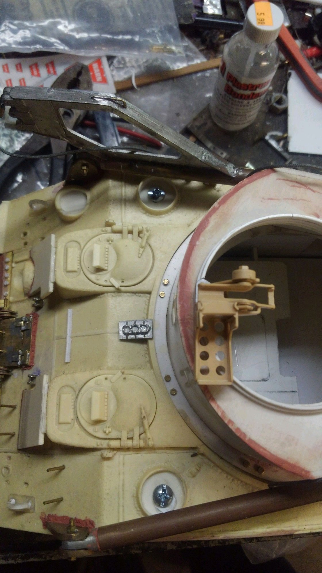

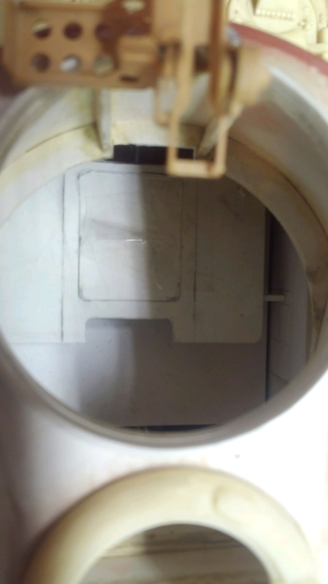

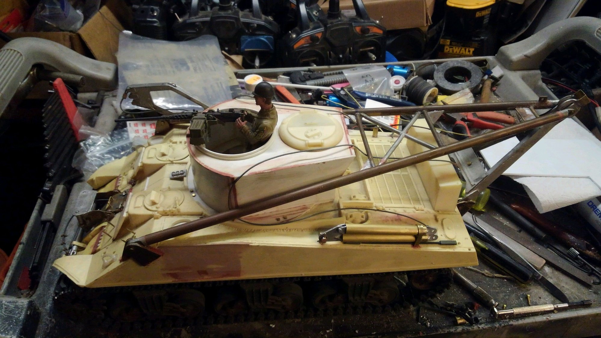

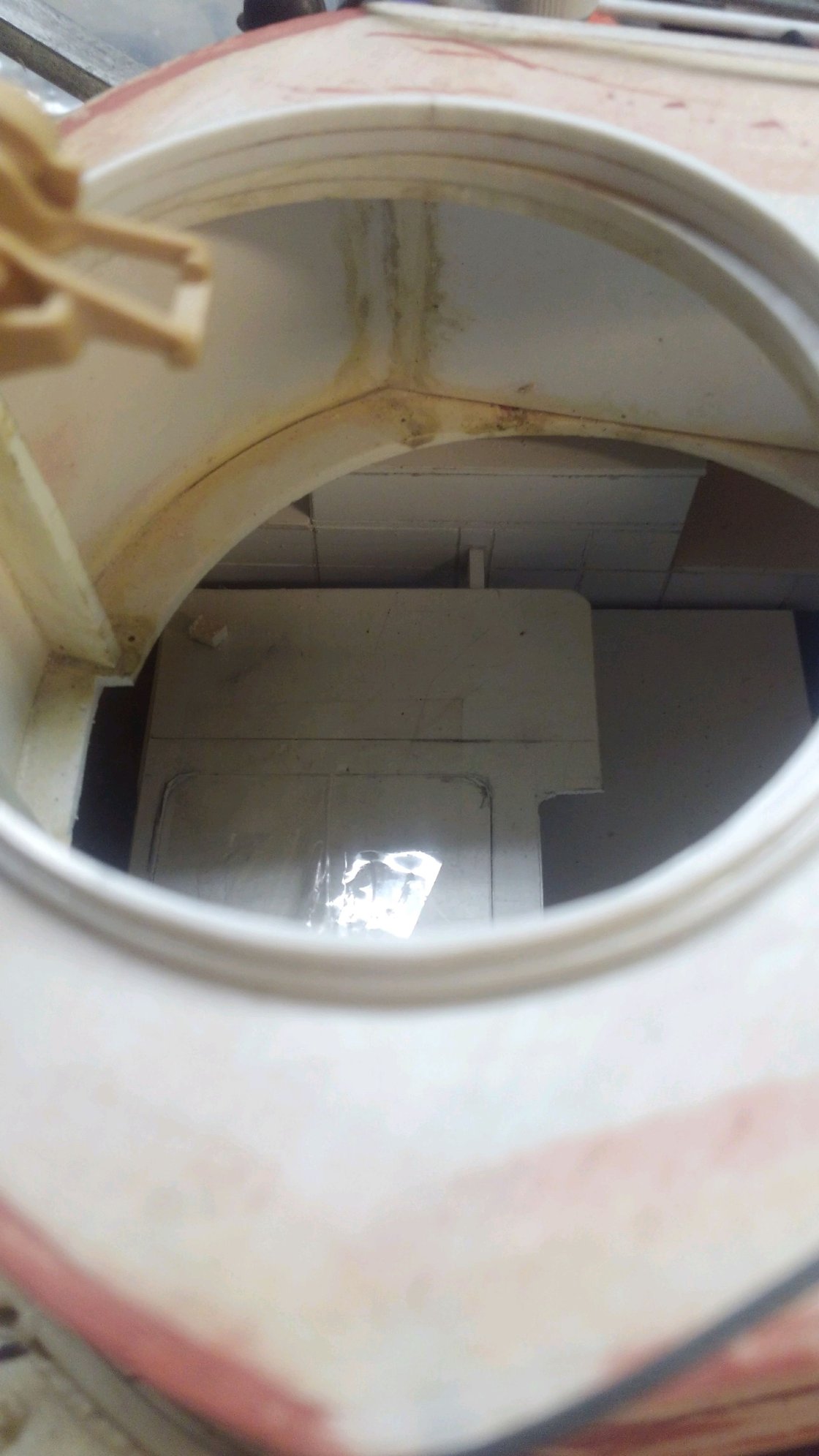

Well Ive gotten quite a bit more done though it wont seem like it. Planning takes hours of photo study, trial and error and fitting and refitting.
I have the interior of the hull (not the turret) mocked up. The tool boxes on the sides and bottom floor are completed as is the base for the MG platform. The bottom floor and the MG platform will eventually be diamond plate so just waiting for that to arrive some day. The current platform is the Template. It will all be hinged per the real thing, it has to be so I can access the cable and move it to the front exit or up to the top or out the rear with my long wire hook cable manipulator to use it as I need to. The cool realization when all my guestimation and hoping added up to the figure at the right height for the MG to be used and the floors all lined up about right with the top down photos I have. Its as close as I can get without measurements.
I also cut out the center of the A frame brace which was just a round cylinder the wire rope wrapped around and fabricated the pulley and keeper brackets. Early tanks had just the dowel to hold the cable but that changed quickly and a pulley was installed in all subsequent M32 conversions and older ones were upgraded to the pulley as fast as possible.
Oh I also completed the front anchoring system for the hull. The hull of the tank needs to be very firmly attached to the chassis for all the winching work so it has 4 screws now holding it down. Changing batteries will be a major PIA so I may just make a charging plug up, yet still, it all comes apart down to the hinged false floor to open up and get the battery out when I want to.

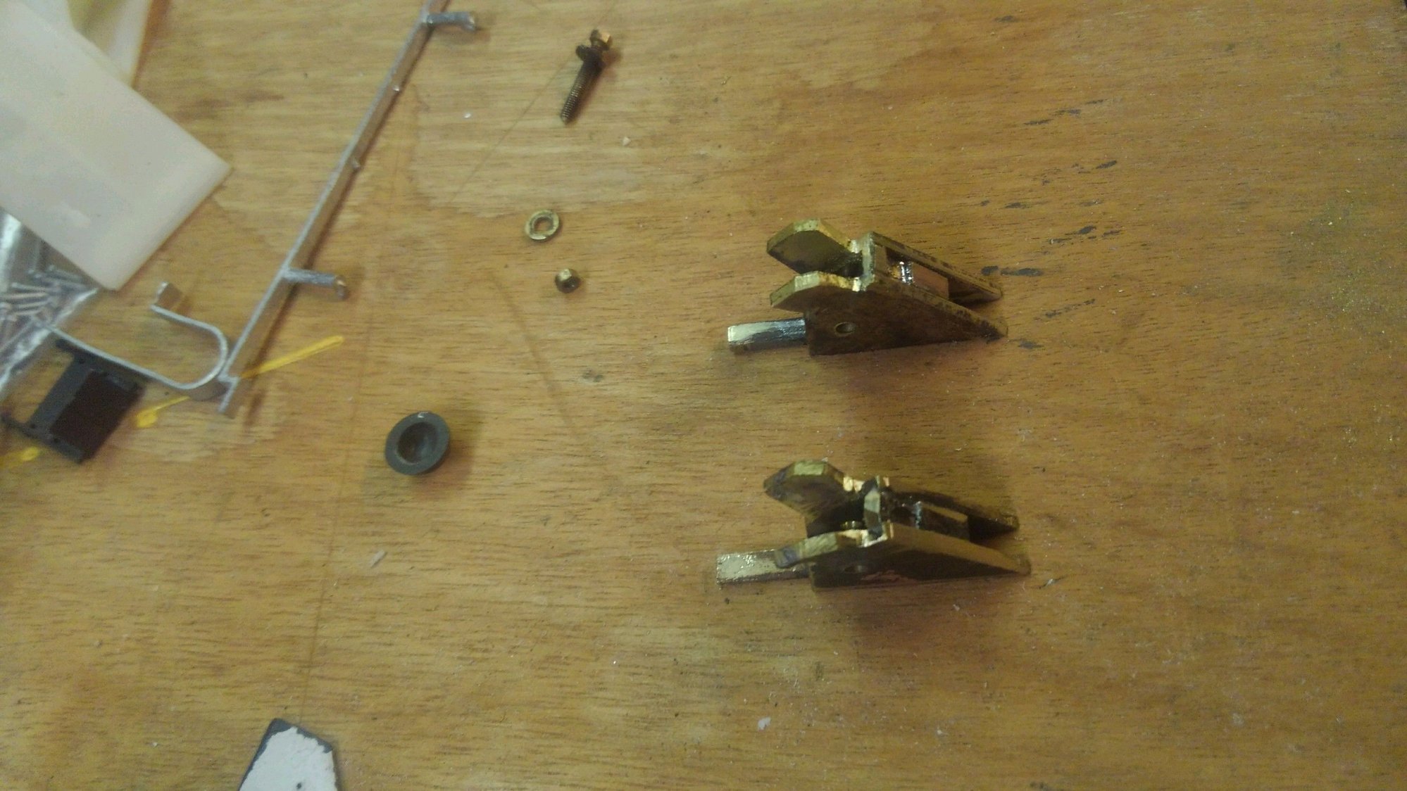

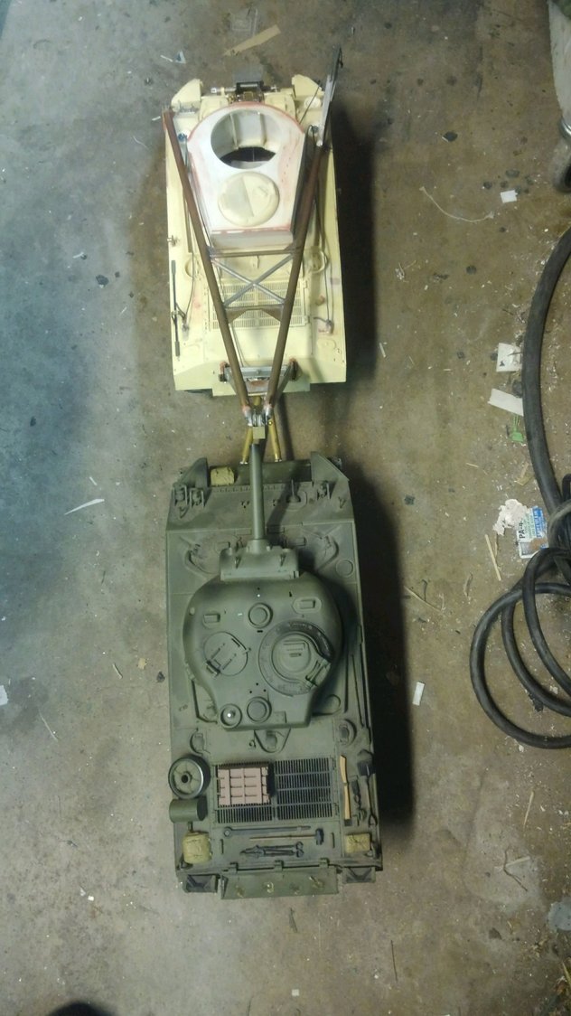

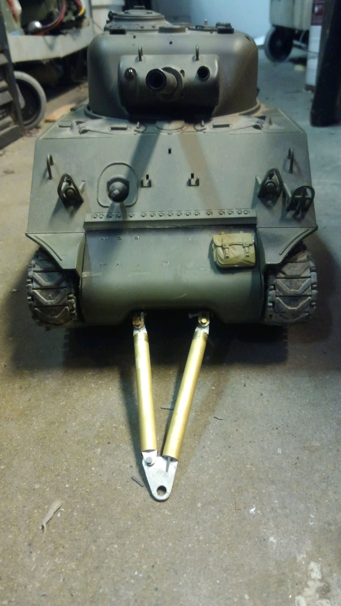

I did some more work on the tow bar tonight and fabricated the towing cleats that actually connect the tow bar to the tow lugs on the sherman front. Fun project. They need some refinement but anh, here they are.

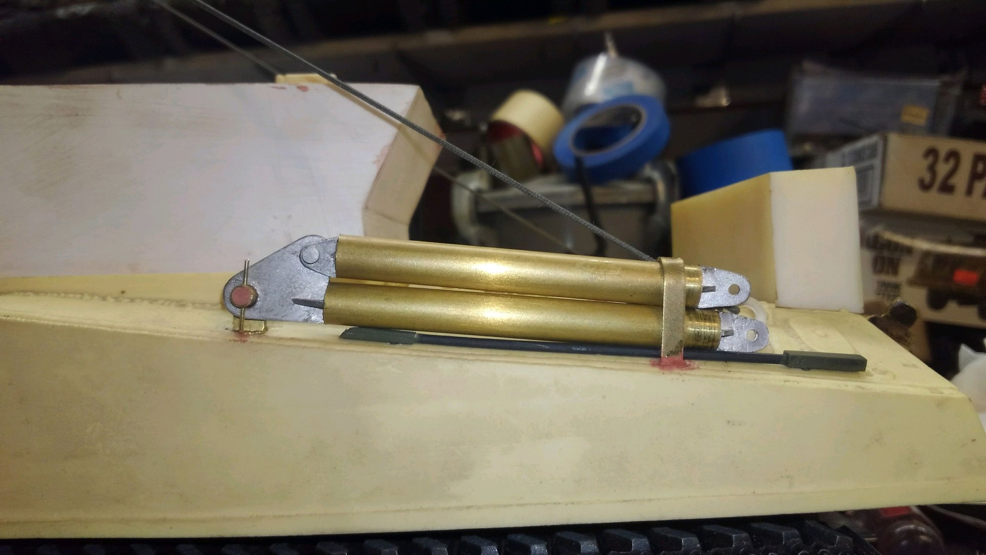

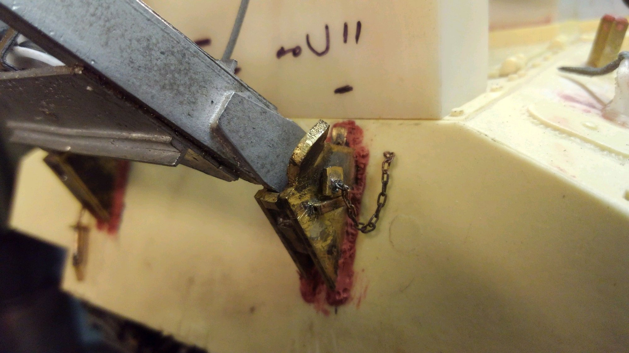

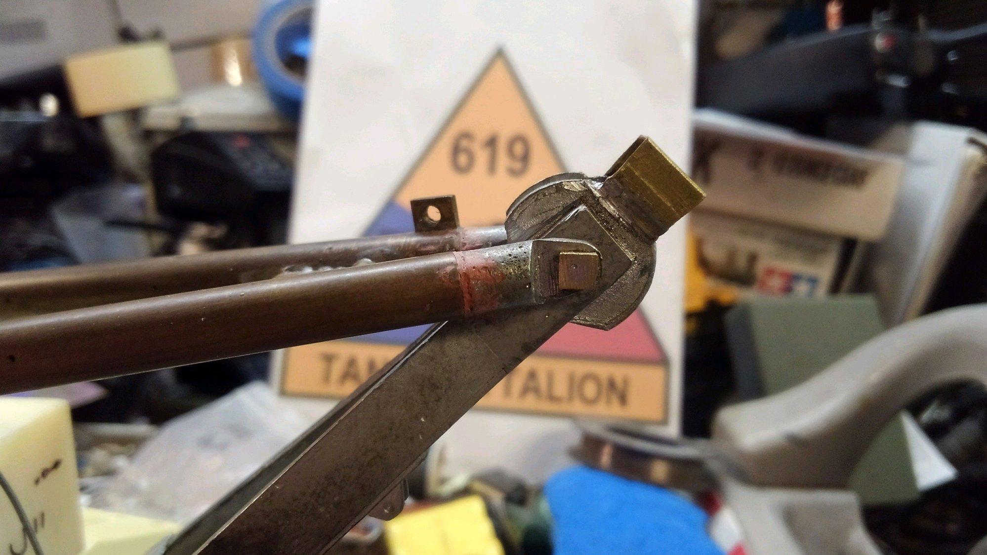

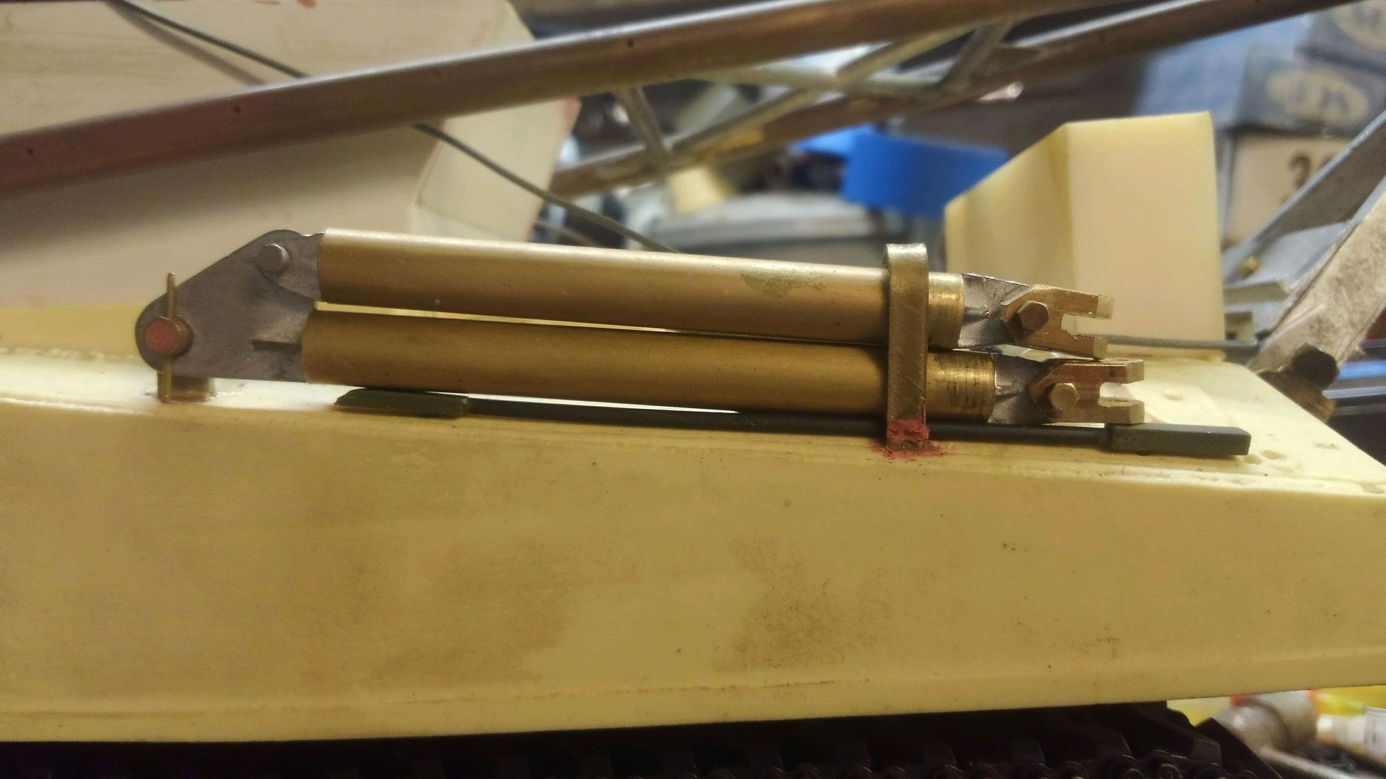

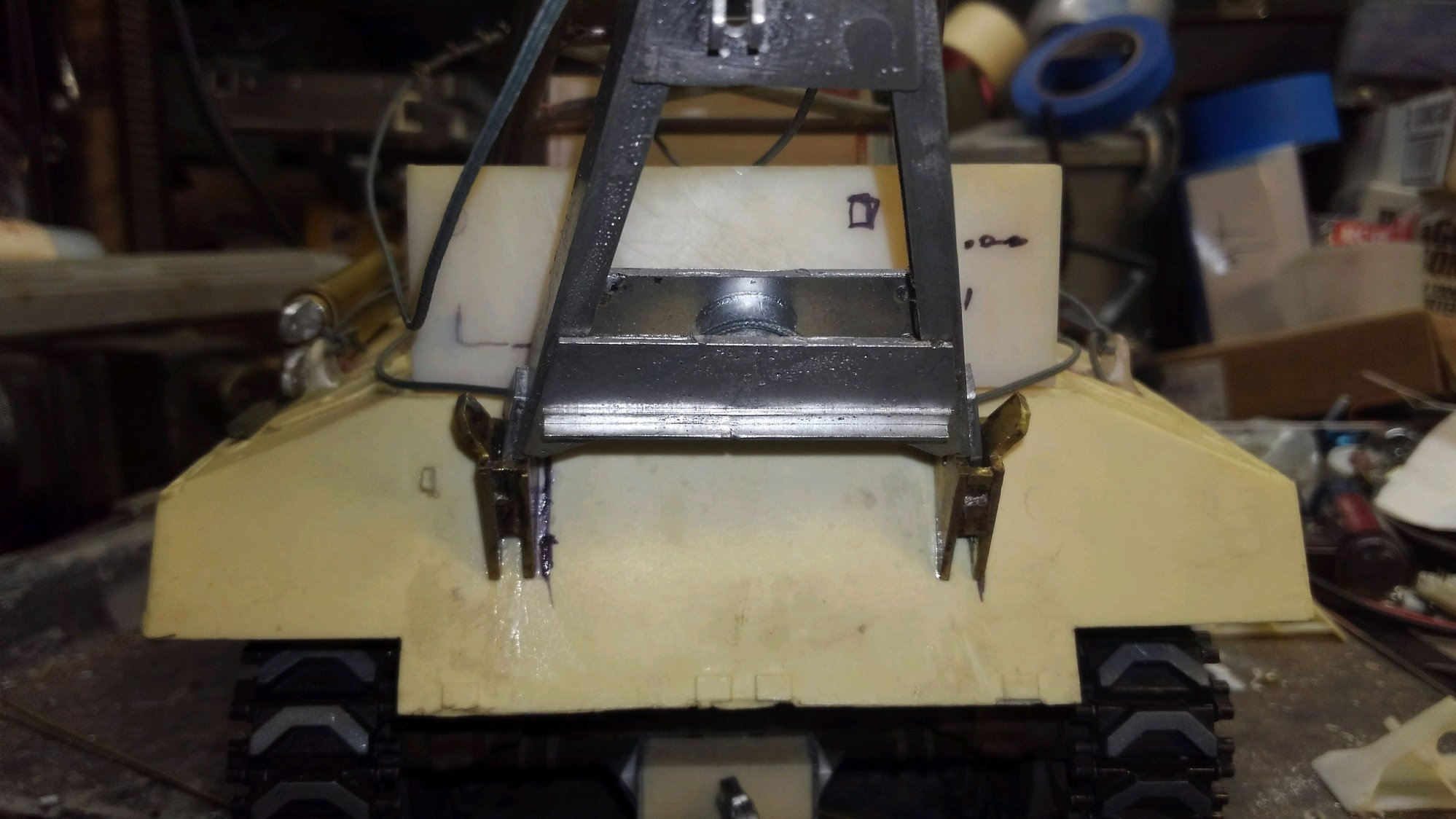

I completed the return roller stowage brackets on each side and have the rollers bolted in place on their brackets.

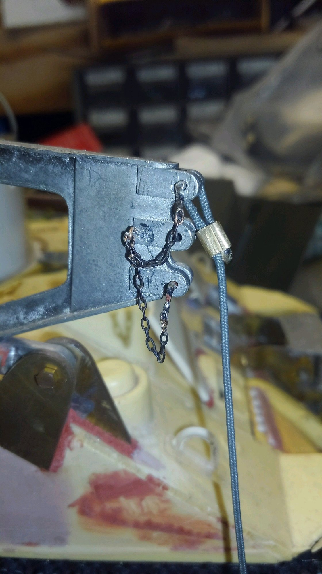

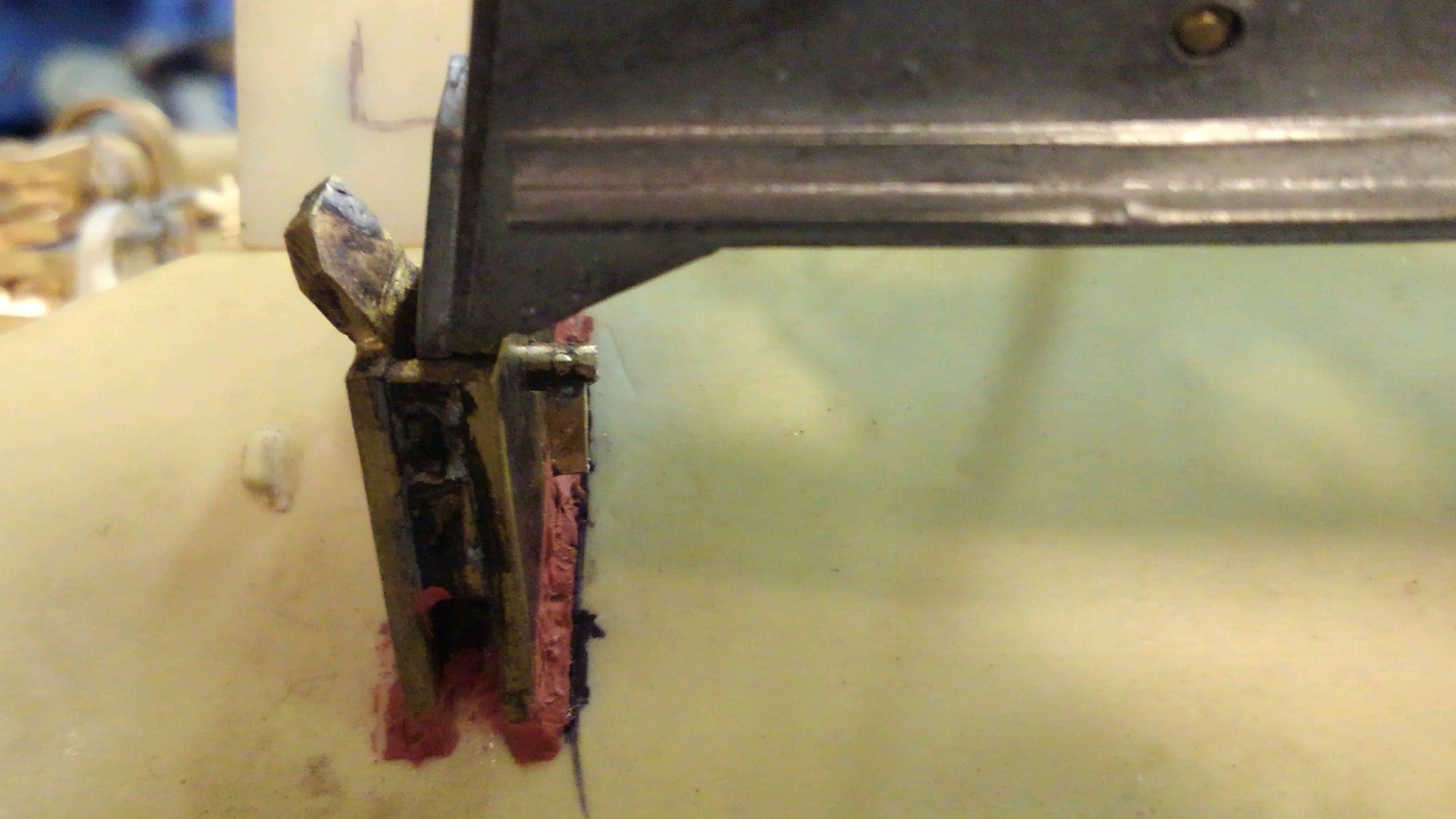

Also finally dealt with the A frame boom retainer pins. They have a folding tab at the end that drops down when they are inserted to retain them, as well as a bar under the square head of the pin to stop from vibration rotation. I soldered the bar on after I took the photos so it’s noticeably not here but it’s done.

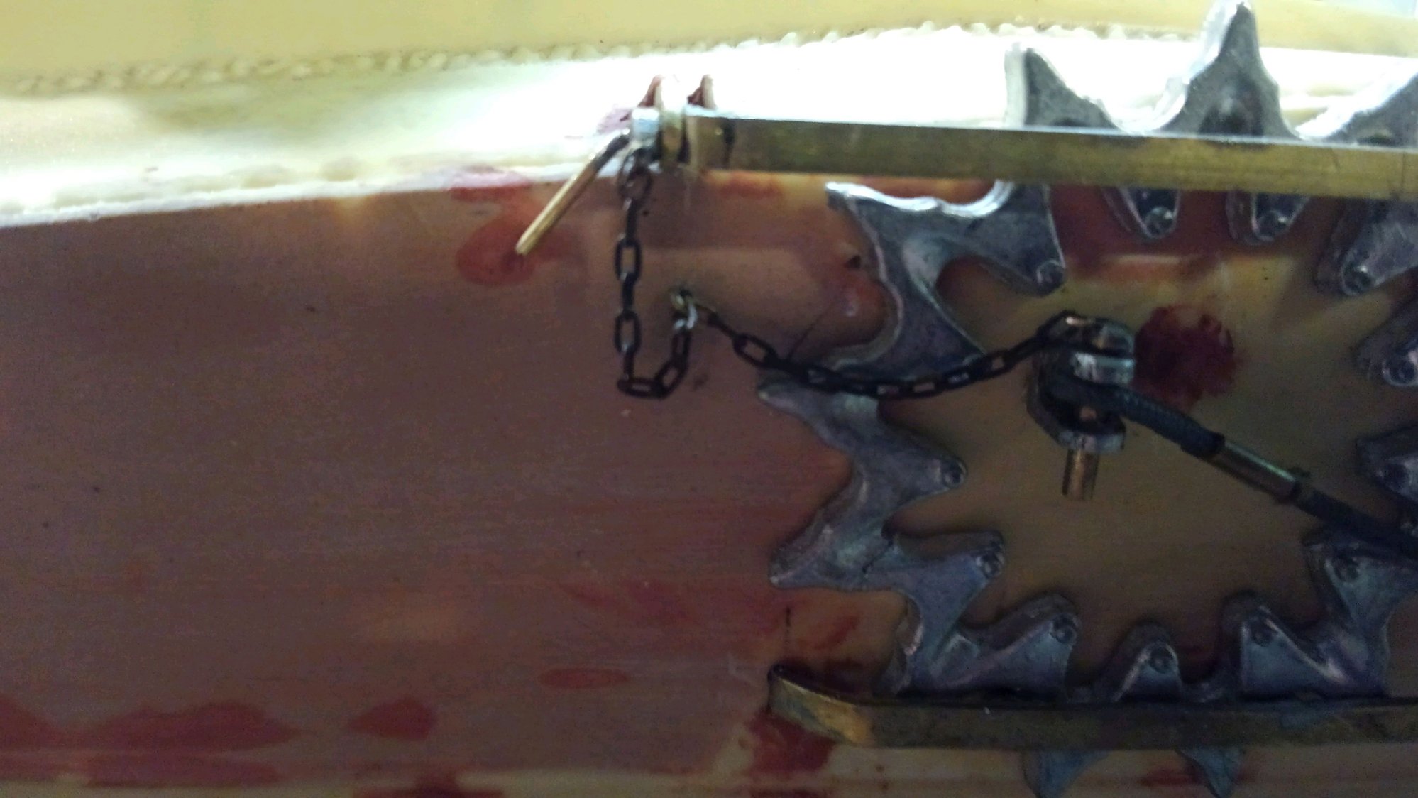

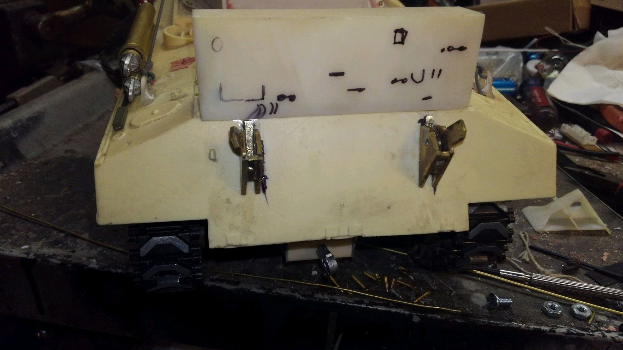

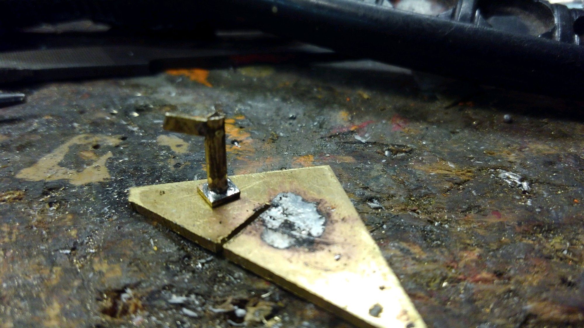

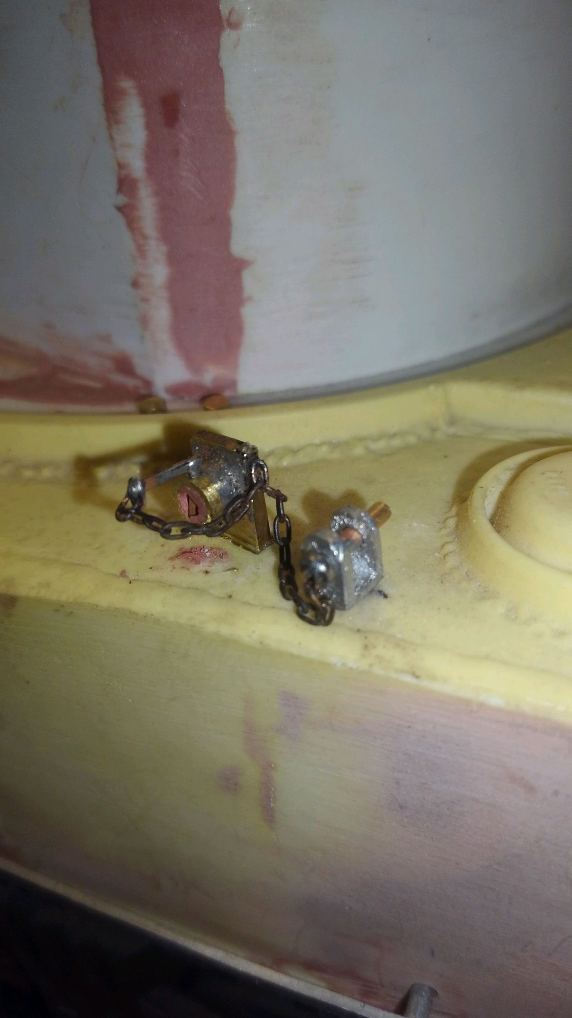

I got a lot accomplished tonight. It doesnt look like much but over the last two days I converted the large bolts, 2-56 to square head bolts by turning down the hex head and inserting it into brass plate and soldering. Also made the corresponding nuts much larger to be in visual accuaracy with the prototype. I drilled out larger brass nuts and then turned down the 2-56 nut and soldered them inside. This took hours to do and was not fast.

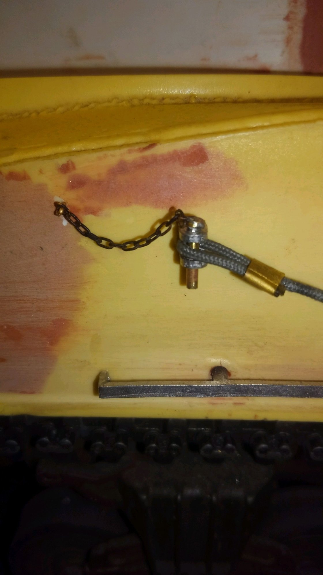

Then I wanted to get to where my rear boom A frame retaining pins would not get lost, I am tired of taking them in and out already. So I got the photos out and made up the retainer chains and soldered them in. After they fell apart a few times and I lost a part and had to remake it I figured out a technique to get the chains soldered on without the pins falling off the other side. Again, hours of work for two tiny dumb little chains. But they keep the pins from getting lost now.

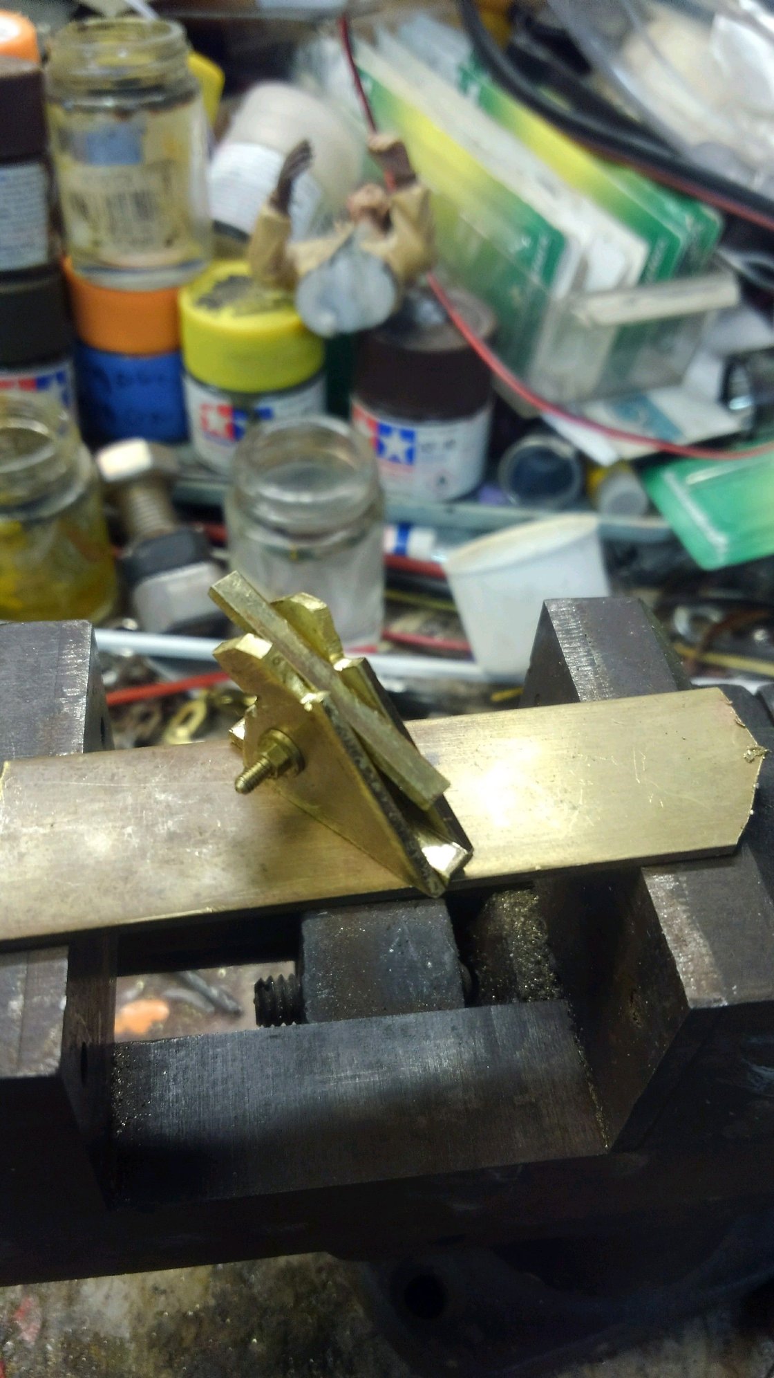

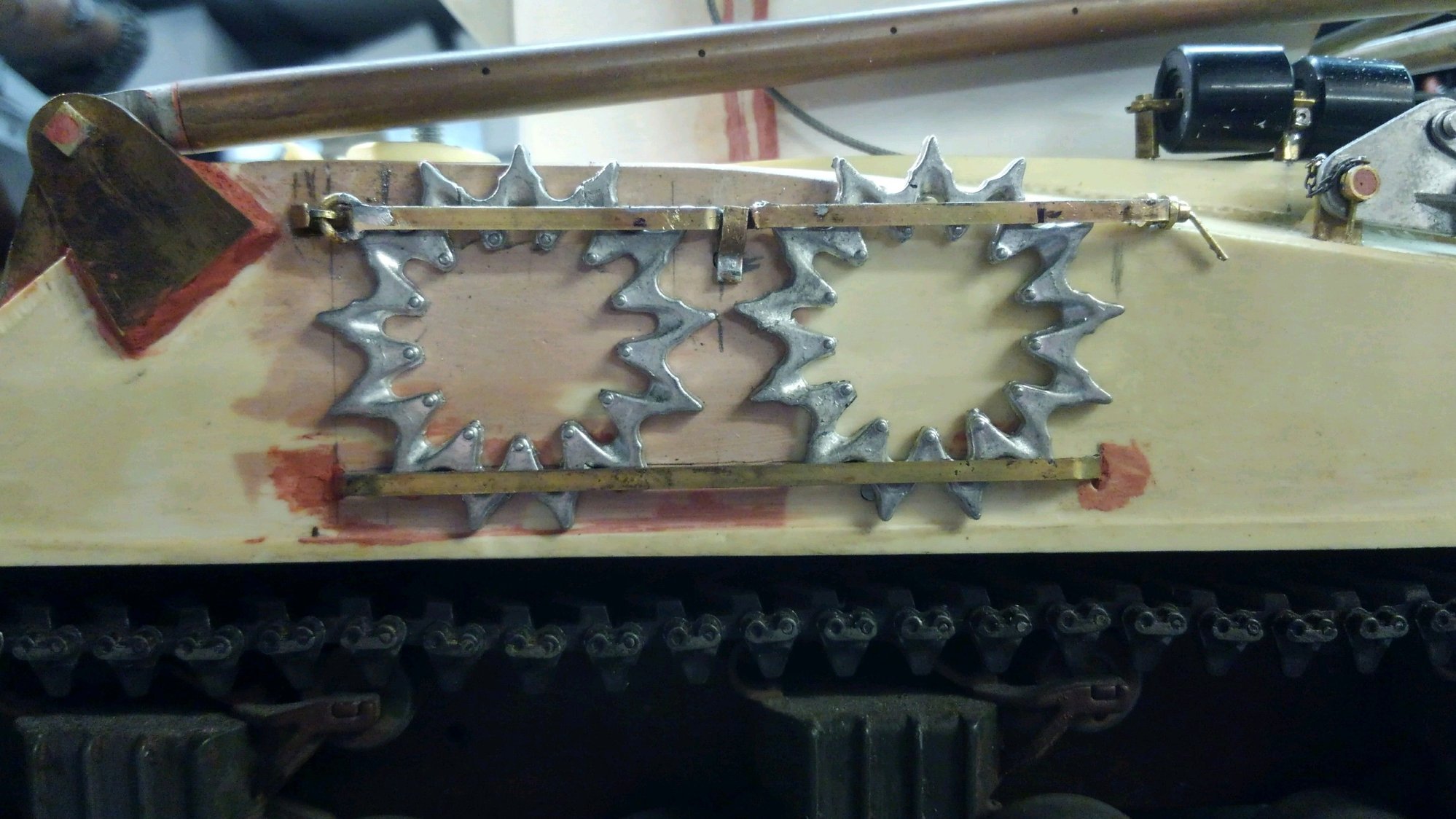

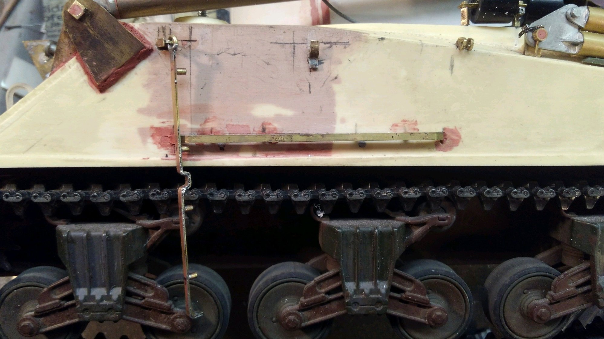

Well, 3 plus days of work and here I am, one side done. I didnt like the soft metal strips that came with the kit so I did what the mad scientist usually does, rebuild it all perfectly out of brass. This particular project drove me crazy. So much planning and replanning and planning ahead.
Now to do the other side.....

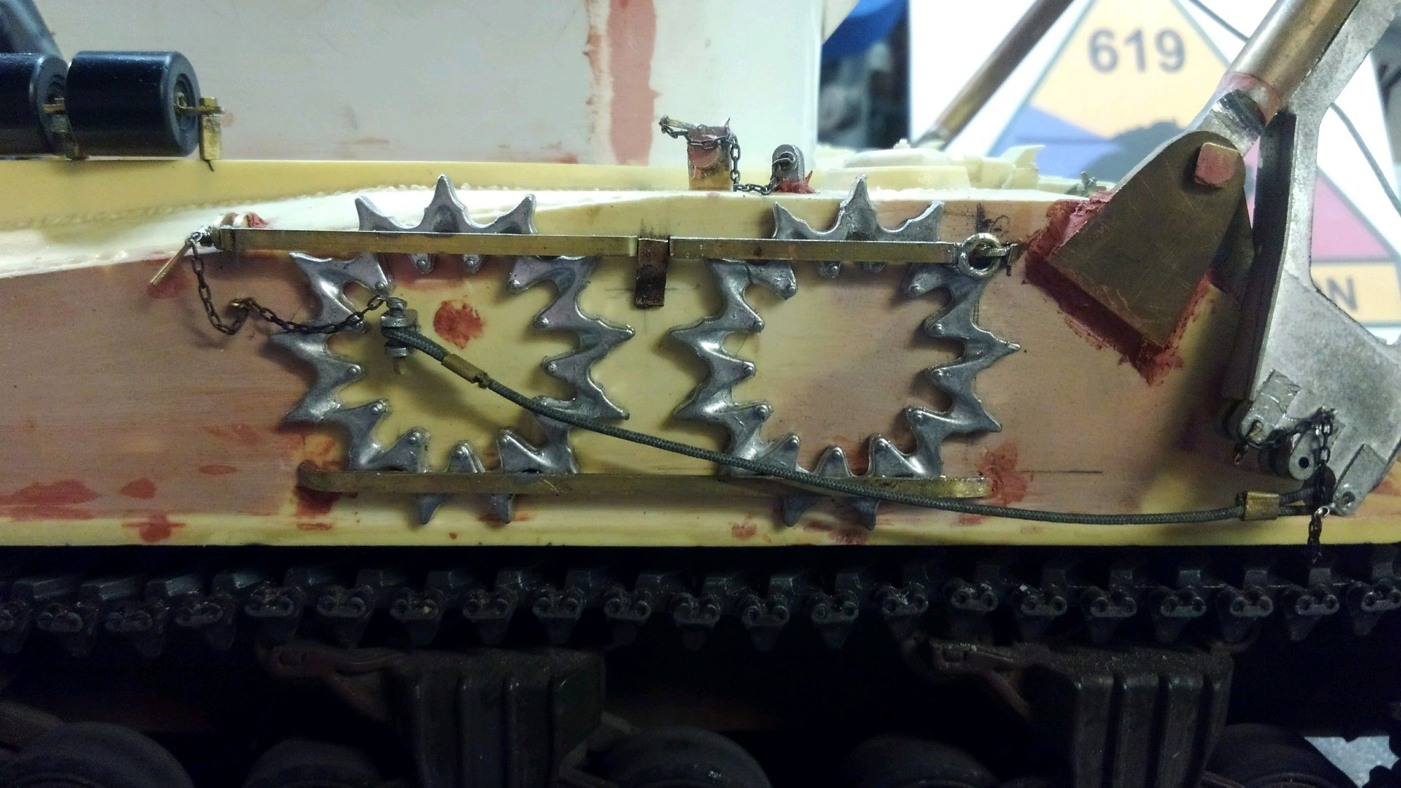

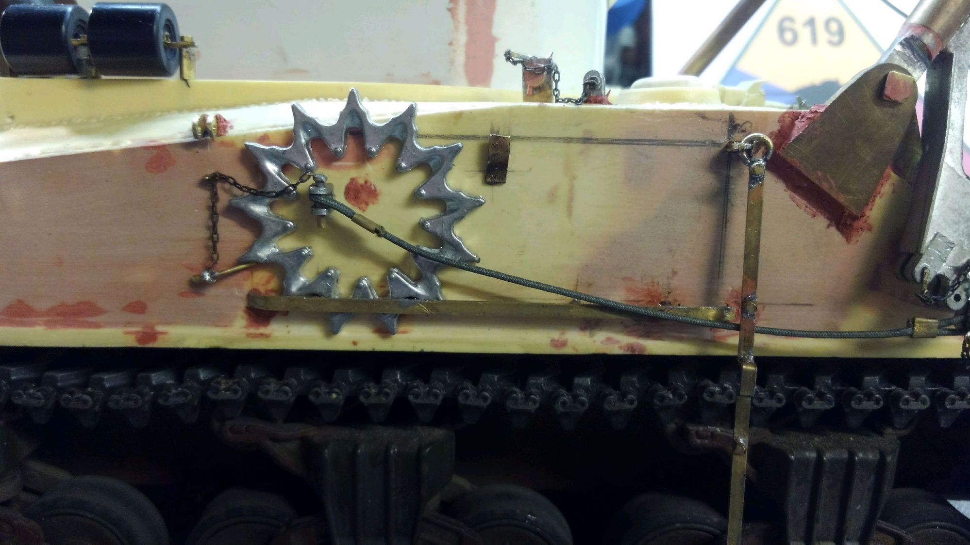

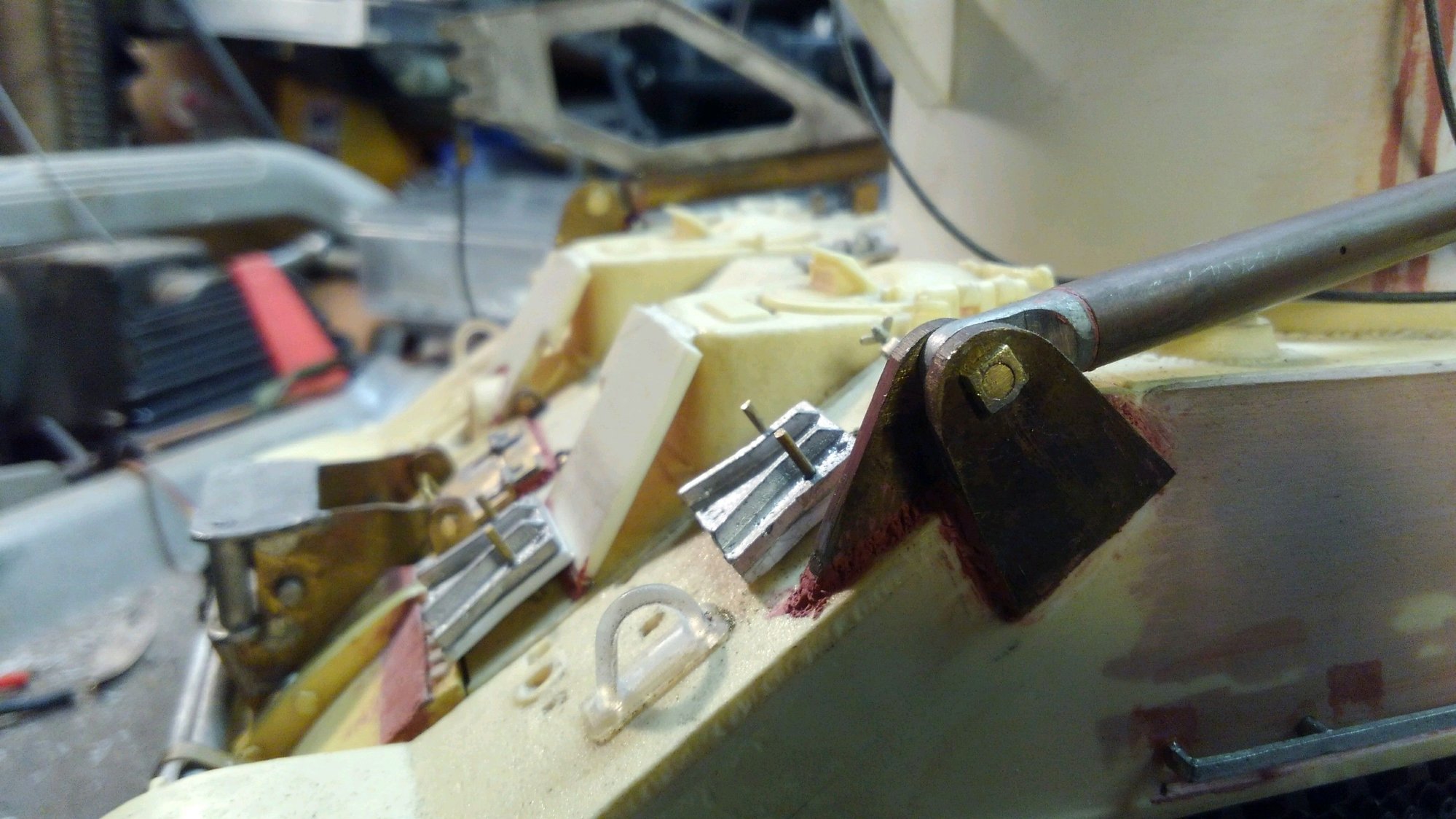

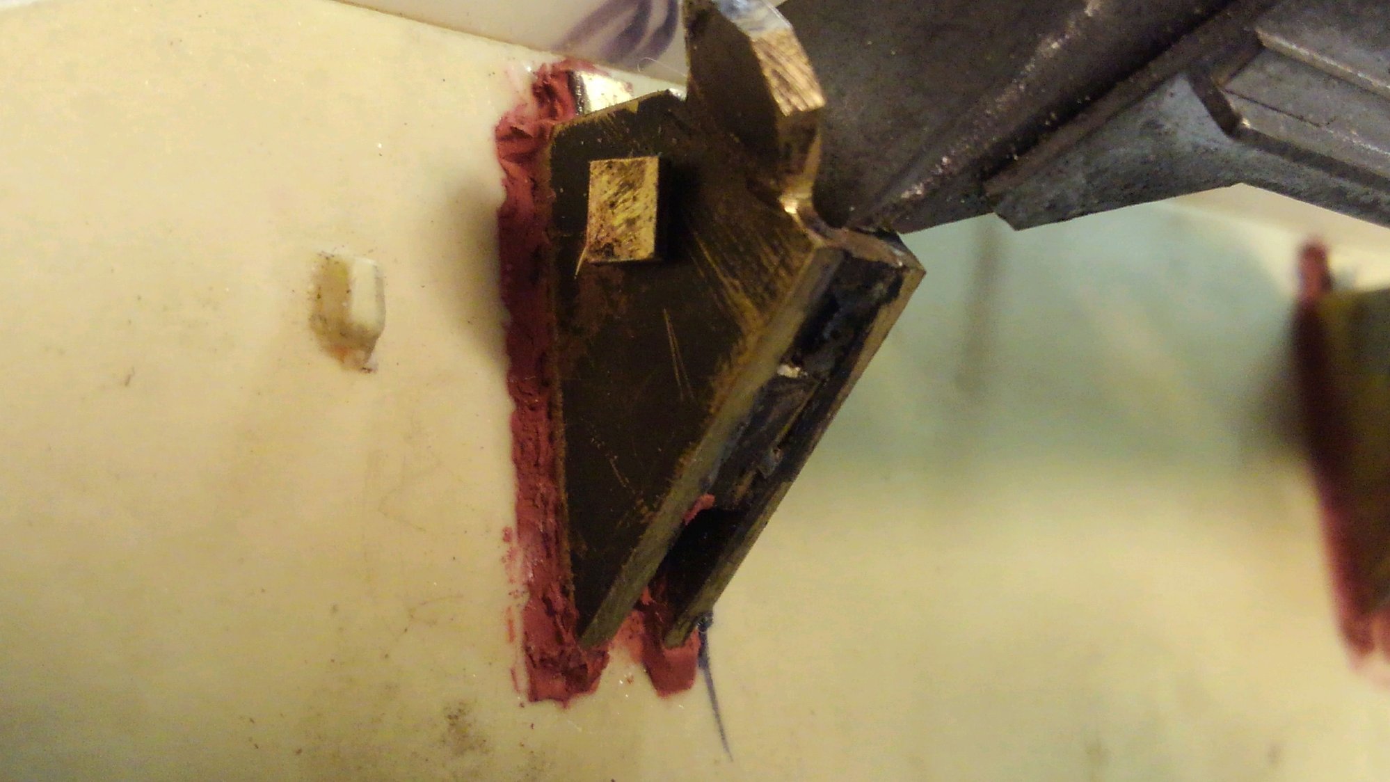

I have finally finished the sprocket brackets on the sides of the hull. This has been another very challenging project for me. Soldering it all out of brass is very difficult and stuff falls apart alot while your soldering other parts. Im mostly happy with how it all came out. I made some mistakes but I think no one but me will ever notice. Hats off to you if you do.
Also a sneak peak at the inside progress as well.
