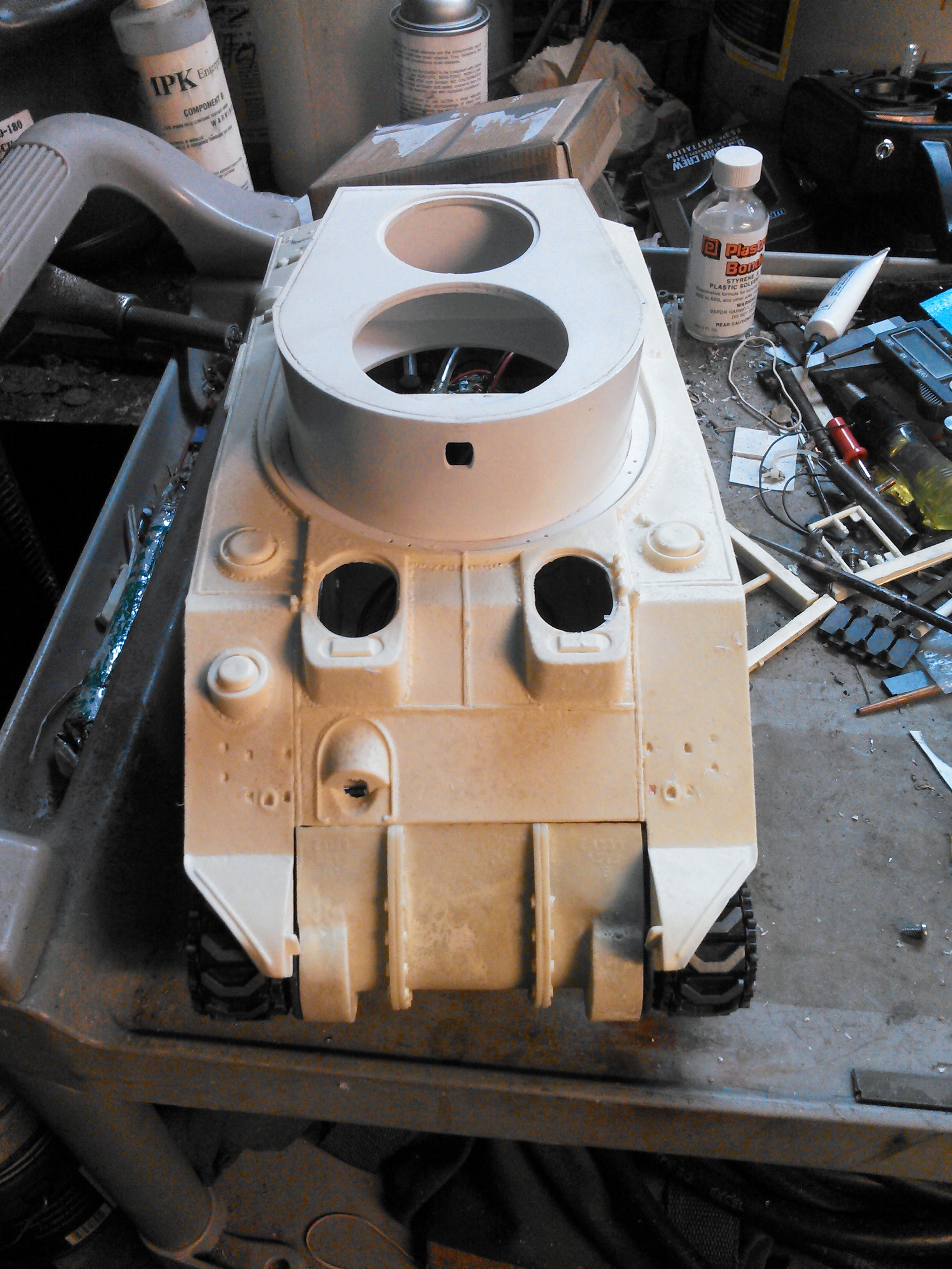

Well, really its going to be an M32B3 which is an ARV on an early M4a3 vehicle.

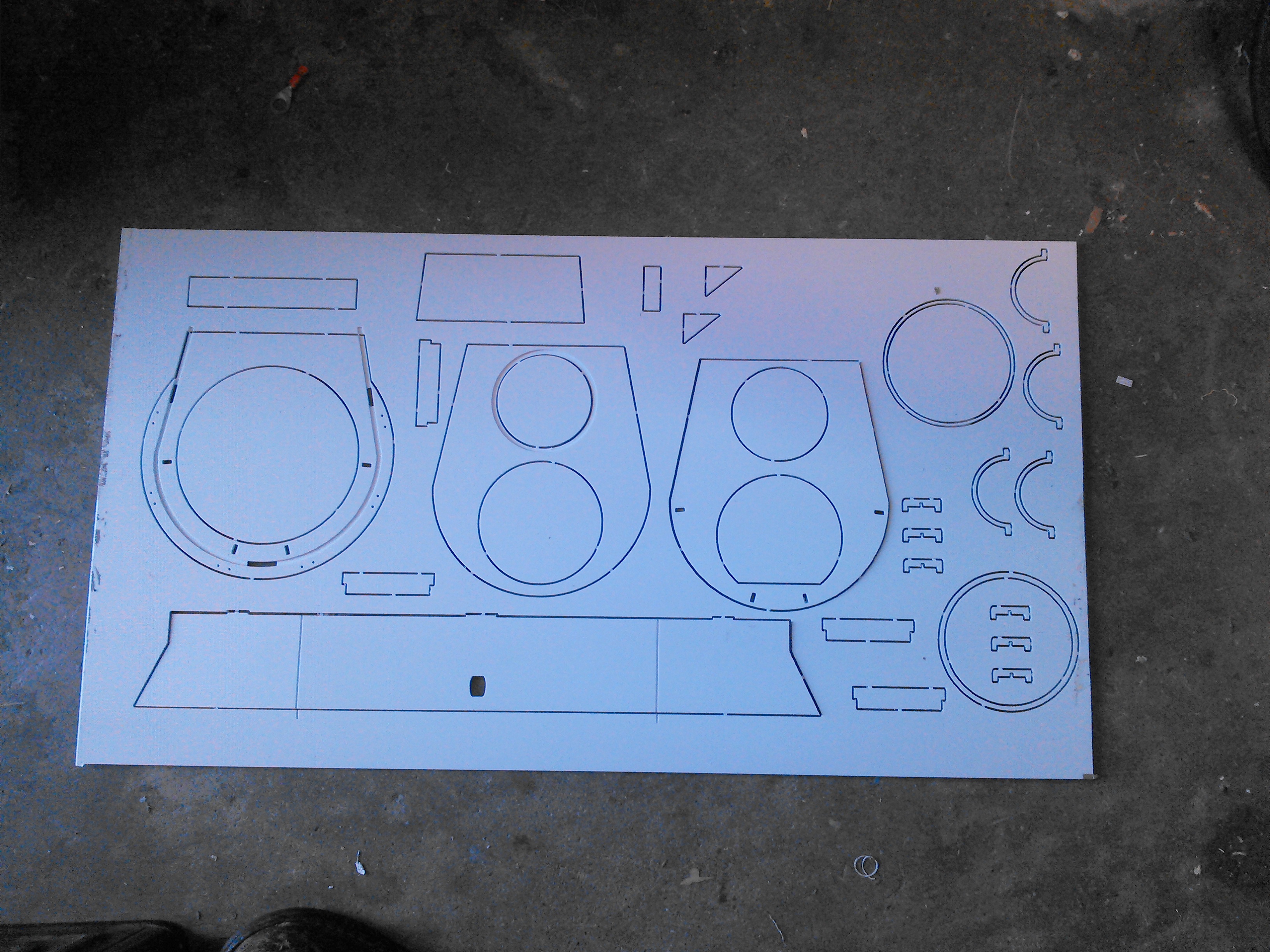

I got Ludwigs kit and decided I wanted to save his nice A1 small hatch hull for a tank so I am substituting an early M4a3 welded hull from Nick Aguilar.
Here is the styrene sheet of parts.

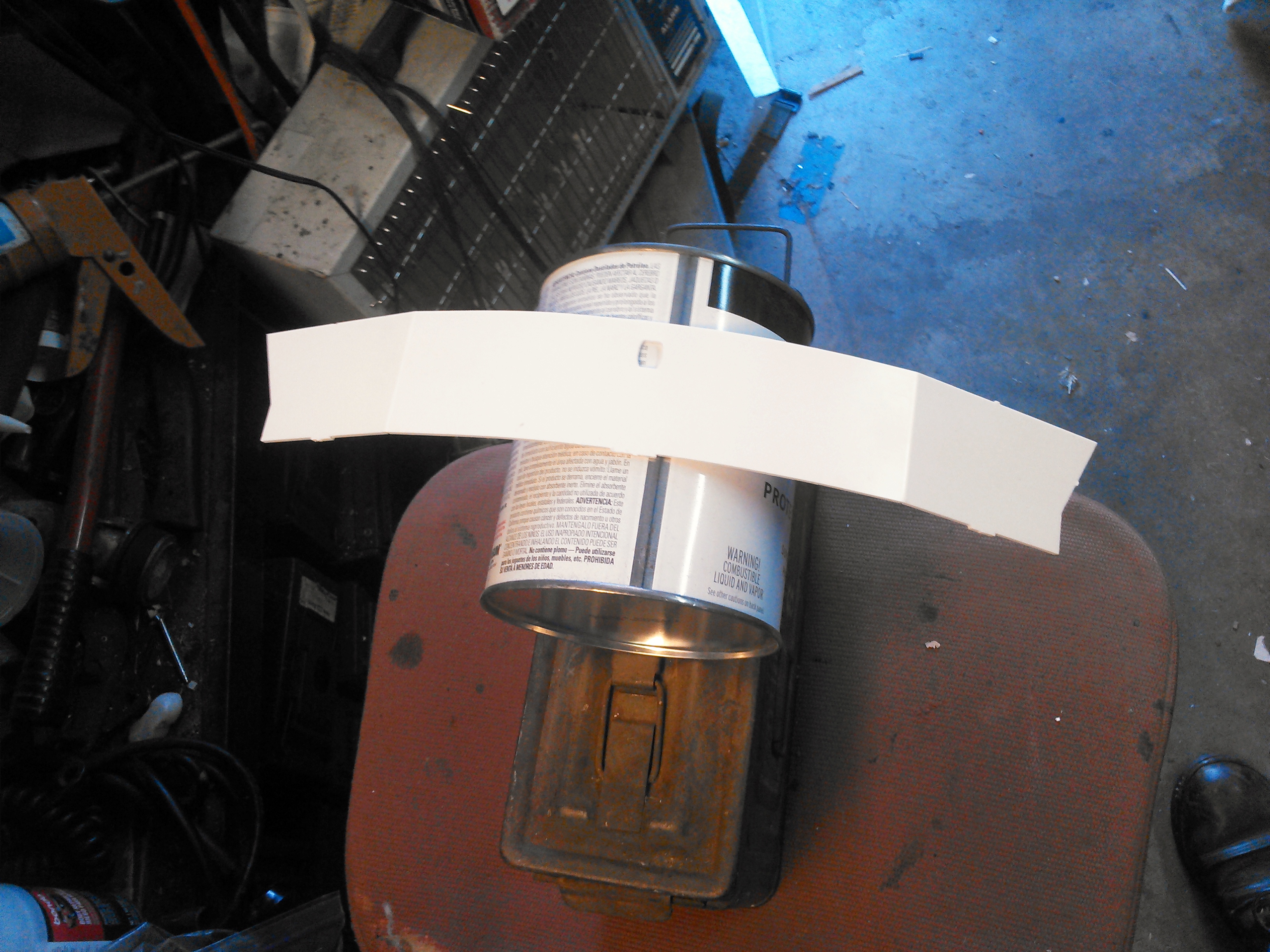

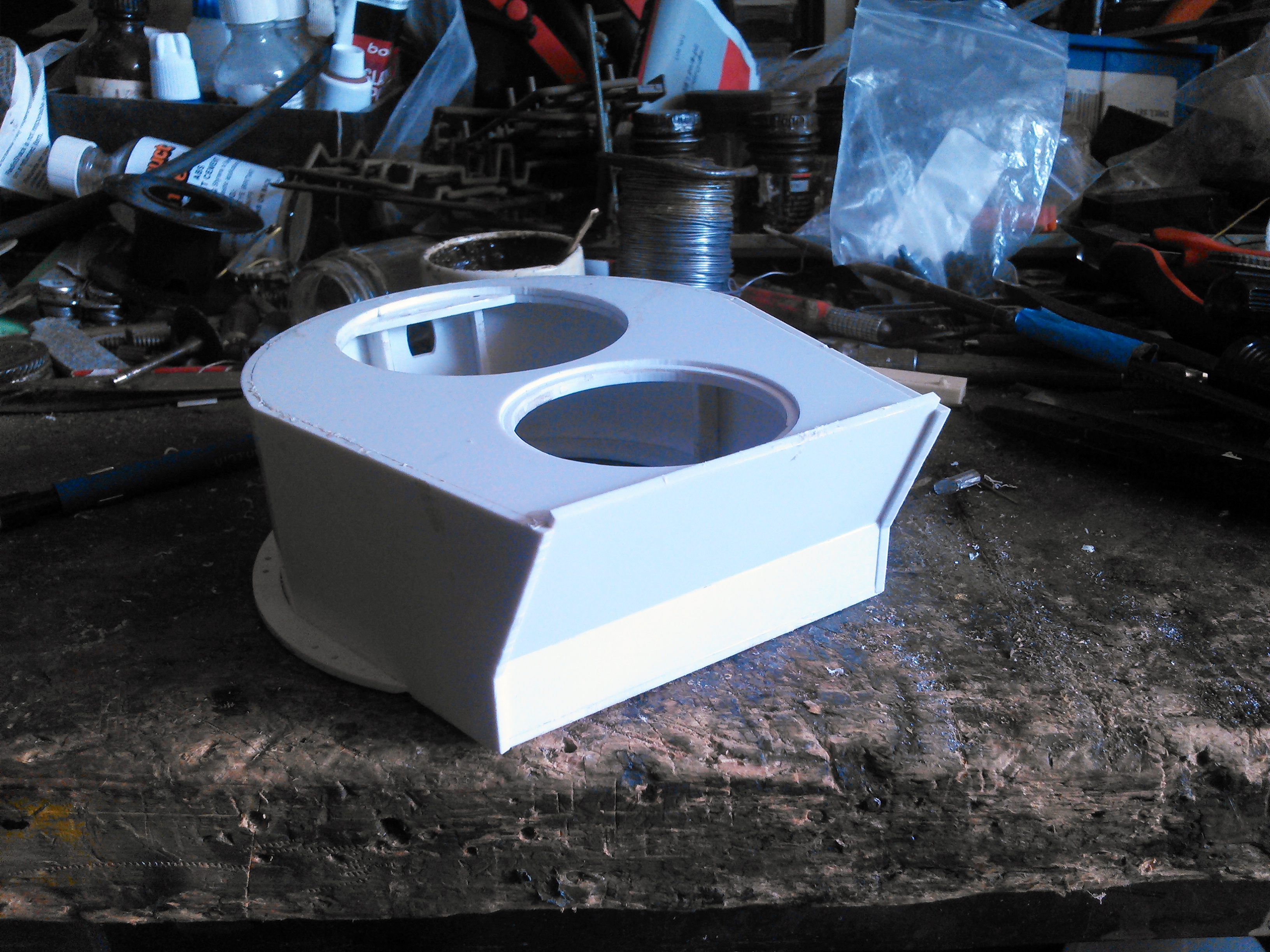

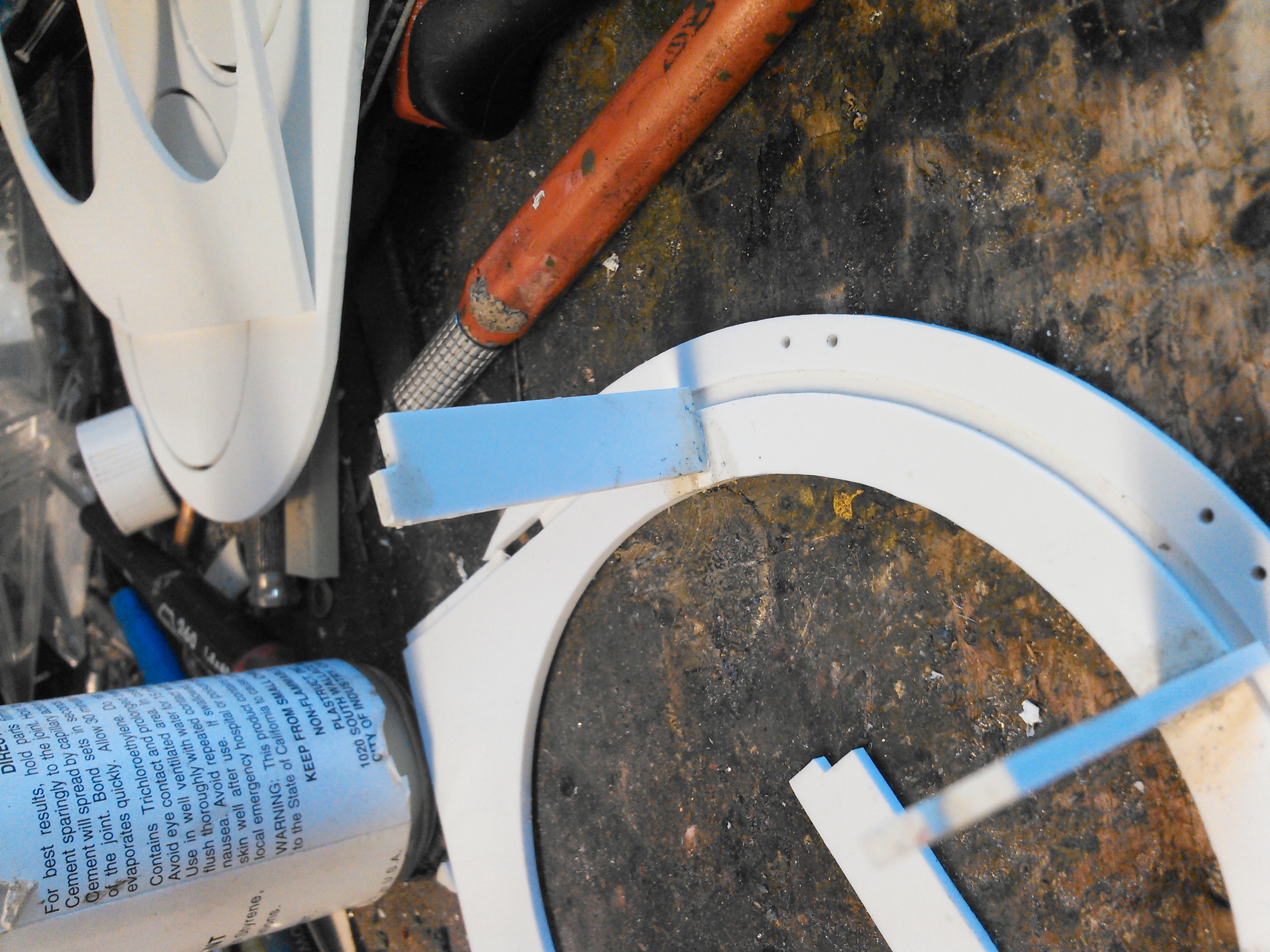

I began by trying to curve the armor wrap for the operation compartment. I decided to heat up up over a paint can to help form its curve.

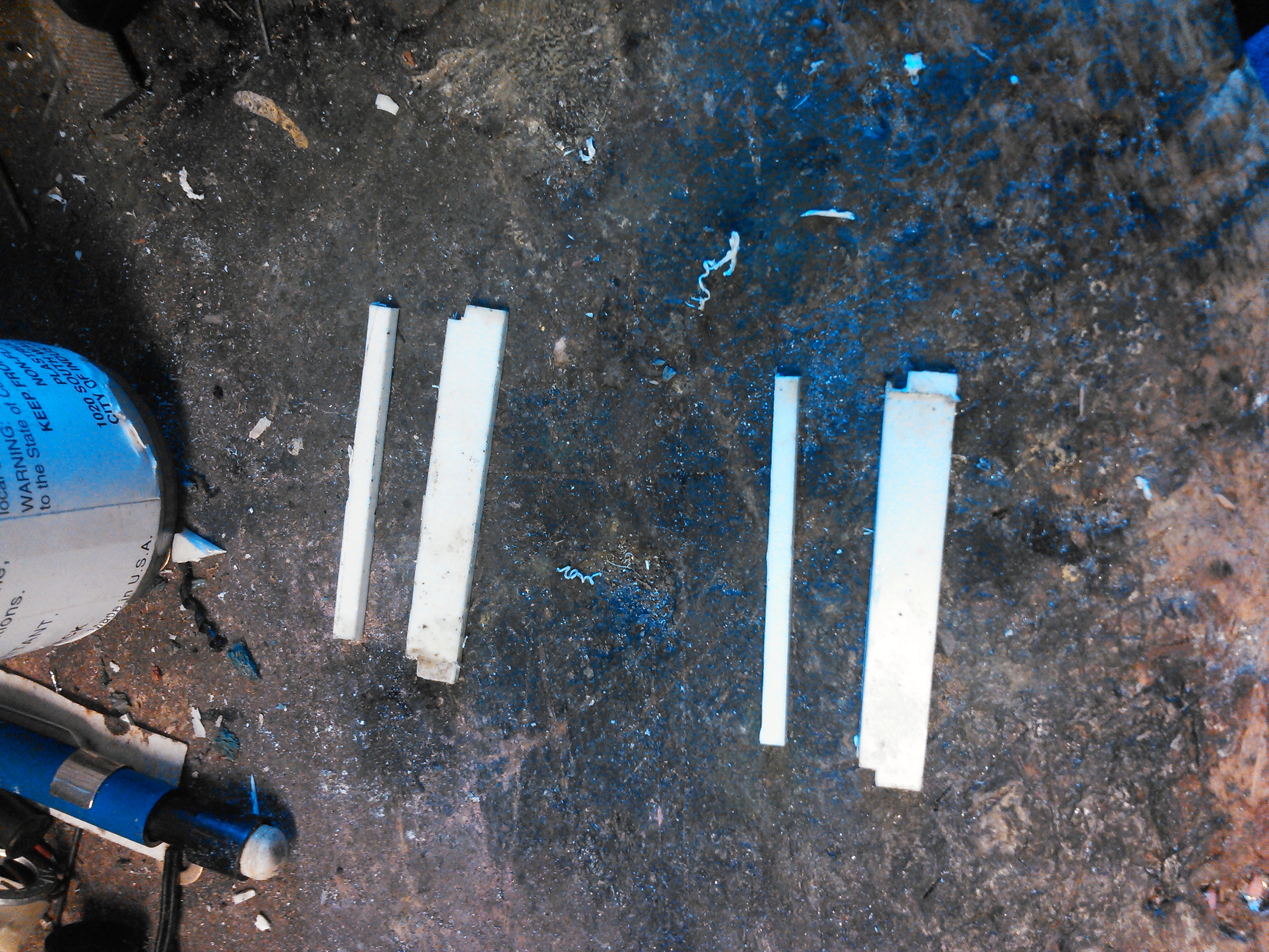

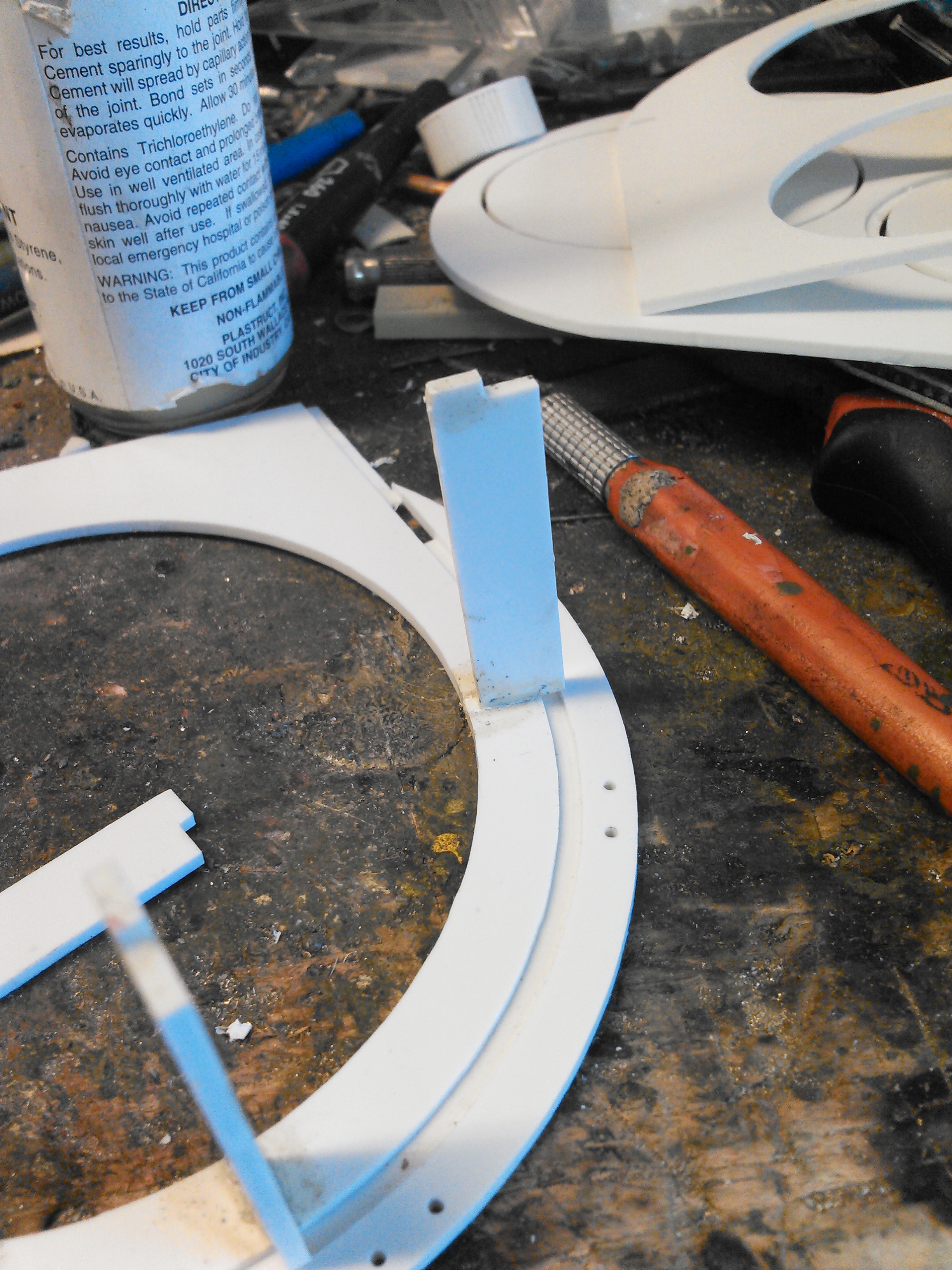

The base has a groove machined in it that the curved armor plate fits into. These vertical tabs hold up the lower piece of the top. The top is a sandwich of two pieces. These vertical tabs were a problem. They did not fit either way. One way they hang over the groove as seen in the photo below, the other way they will not contact the surrounding curved armor coupola wall and they would hang inside so I measured the proper gauge and sliced them down to make them fit to brace the curved armor wall.
Here is the operation coupola after assembly. There is some overhang that was unavoidable, believe me I tried but it just would not fit perfect. Glueing this thing with styrene/abs cement takes lots of clothespins to hold the curve together. Also it should be done slowly but all at once so the parts and flex and move as everything is slowly glued into its final place. I had to push soft glue joints around a bit to make it all fit.

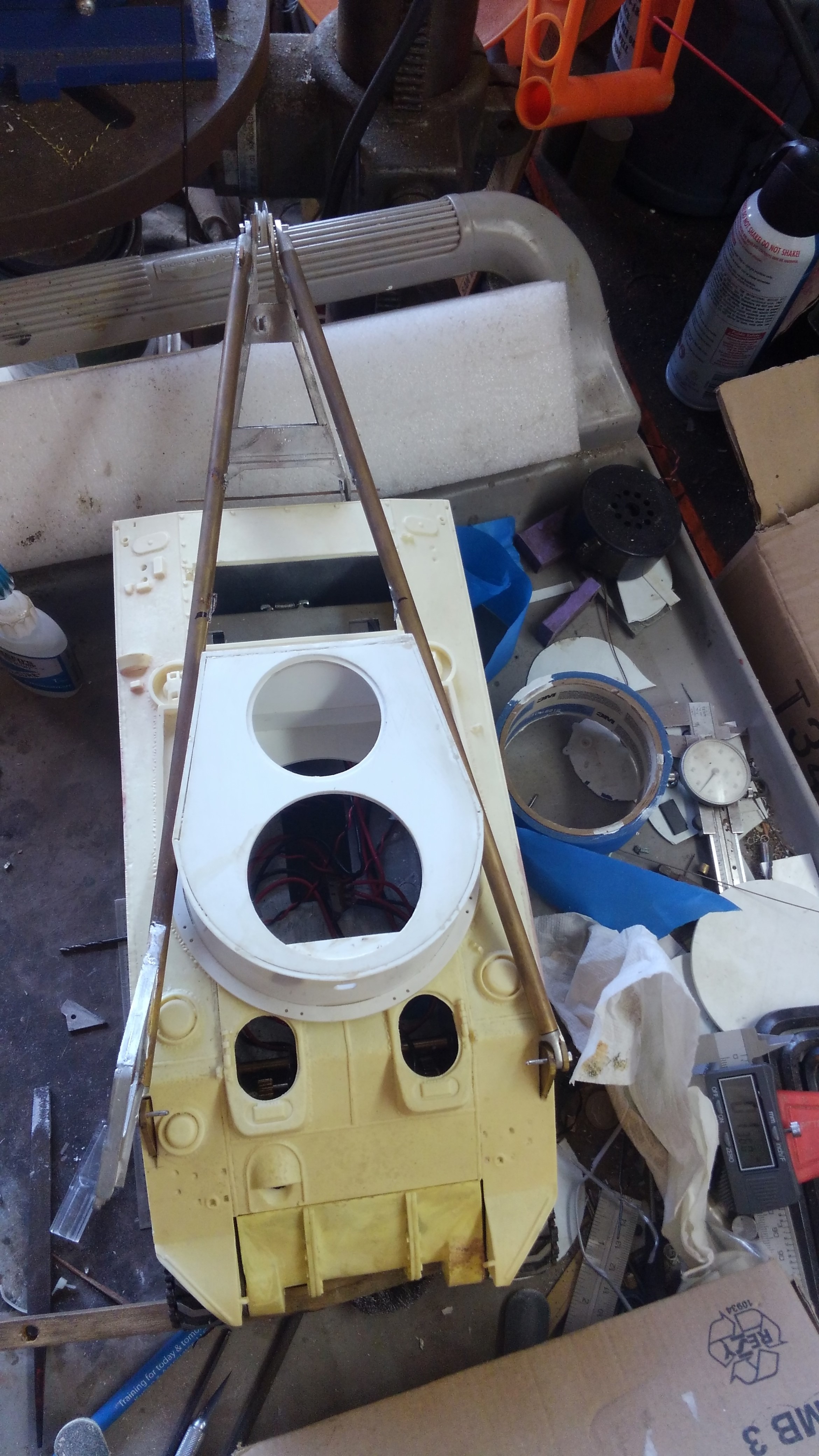

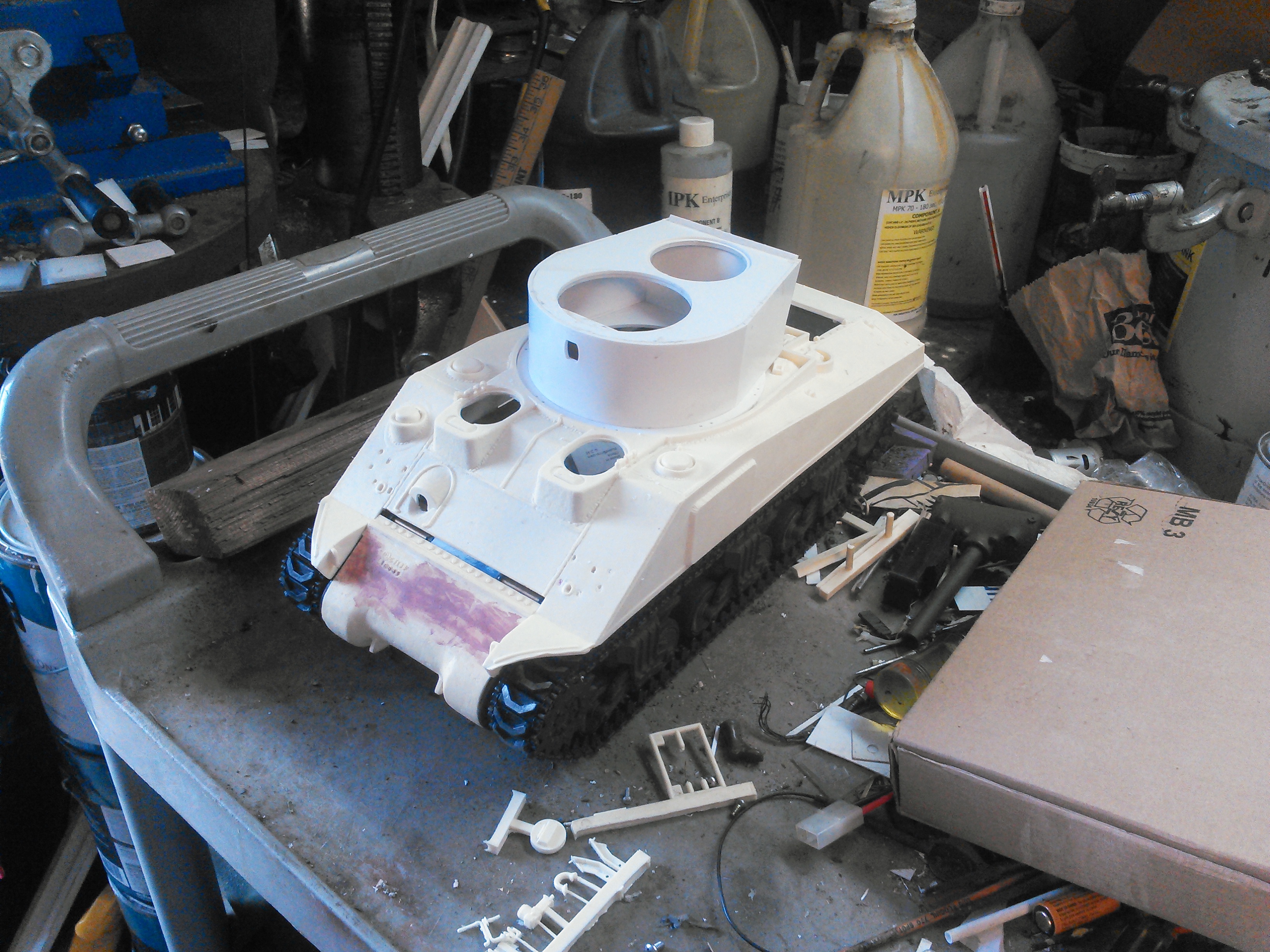

Here it is so far. Operation coupola sitting on the A3 hull. Im likeing this build. Cant way to complete the boom mounts and get it mocked up.

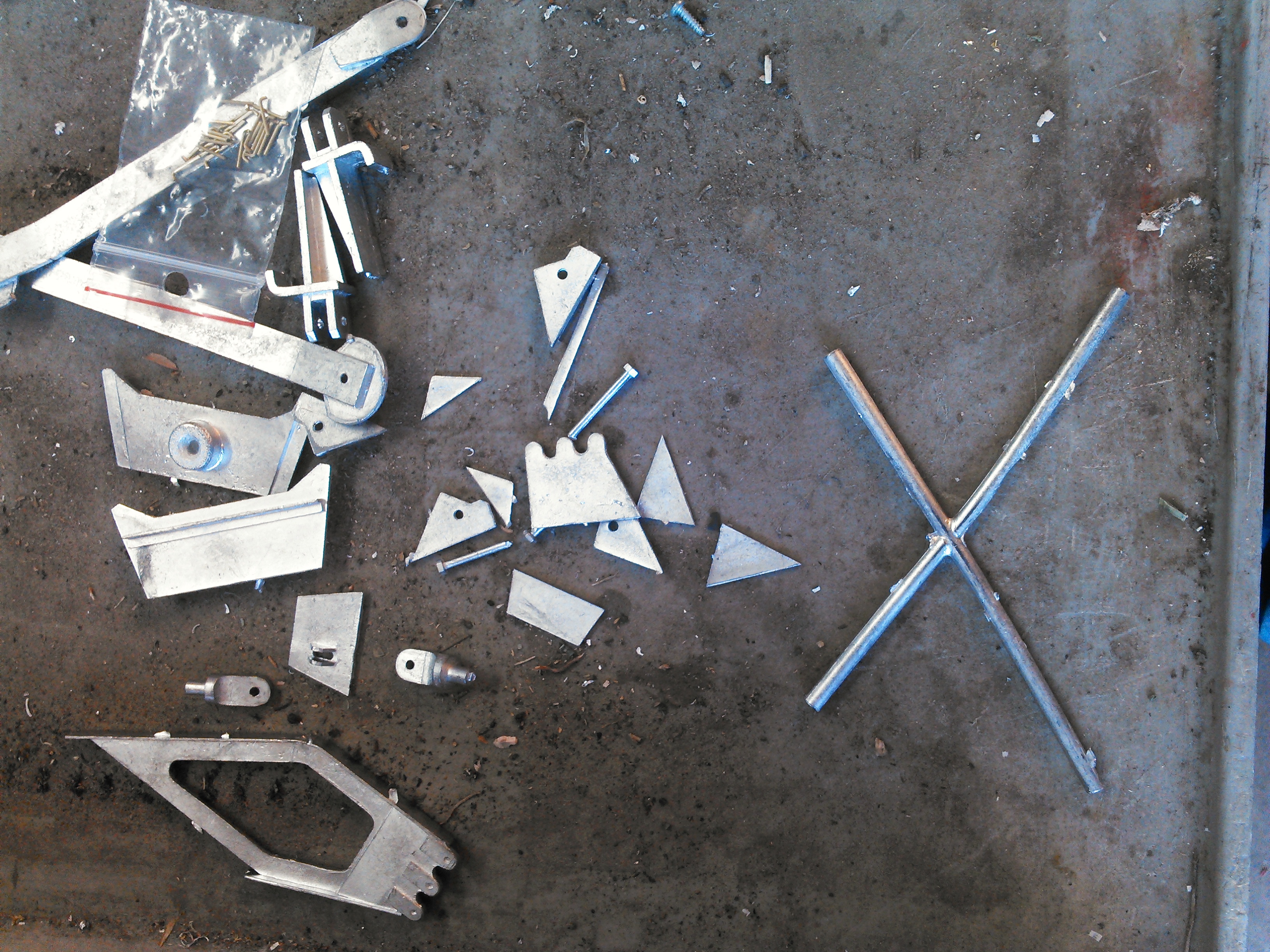

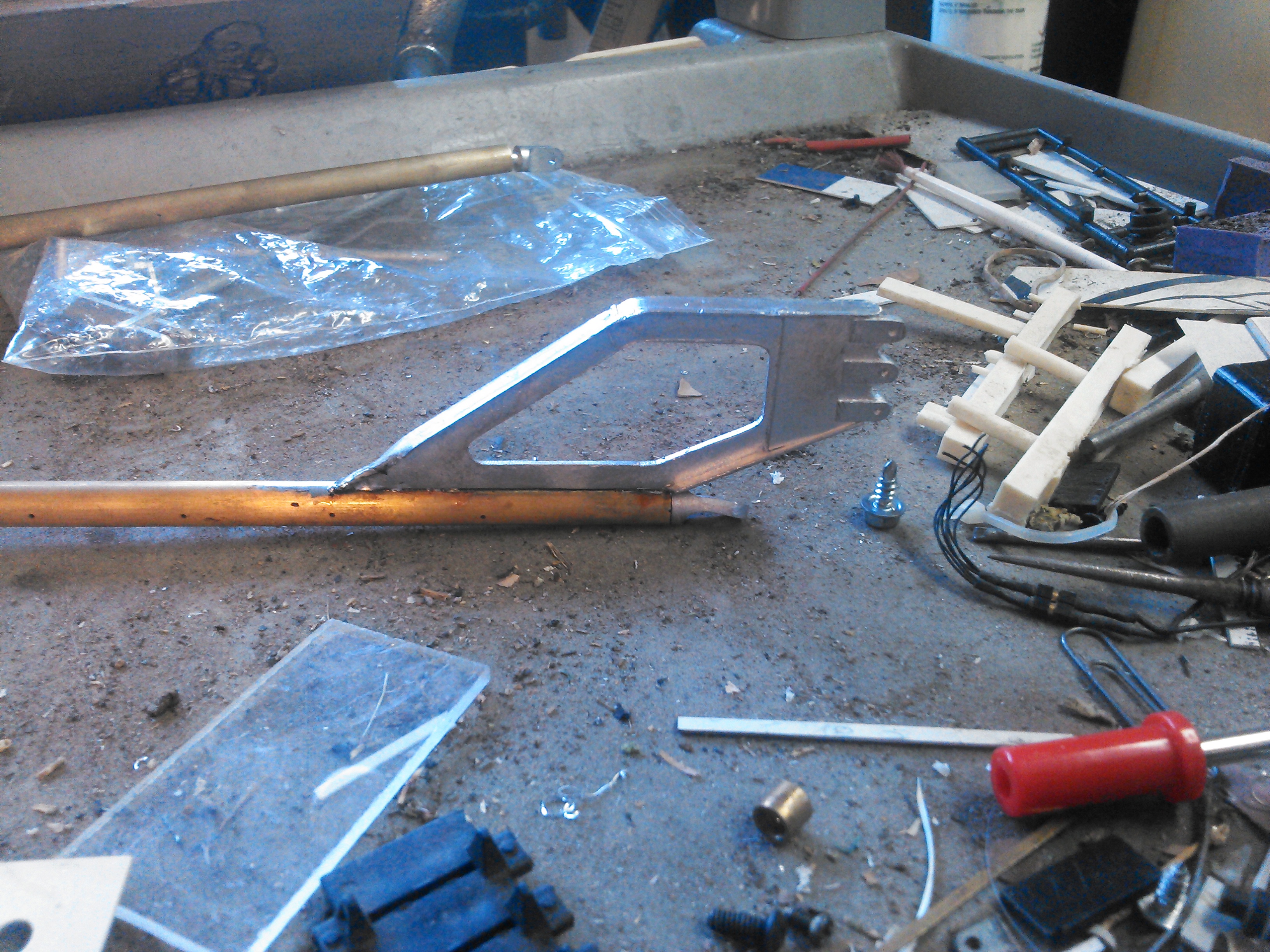

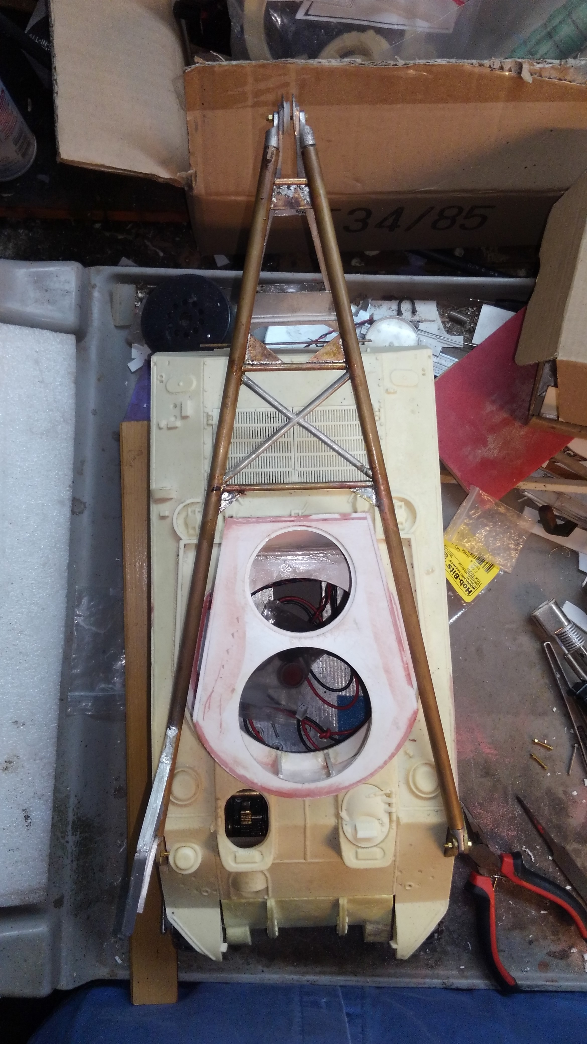

Here are the metal parts for the boom system

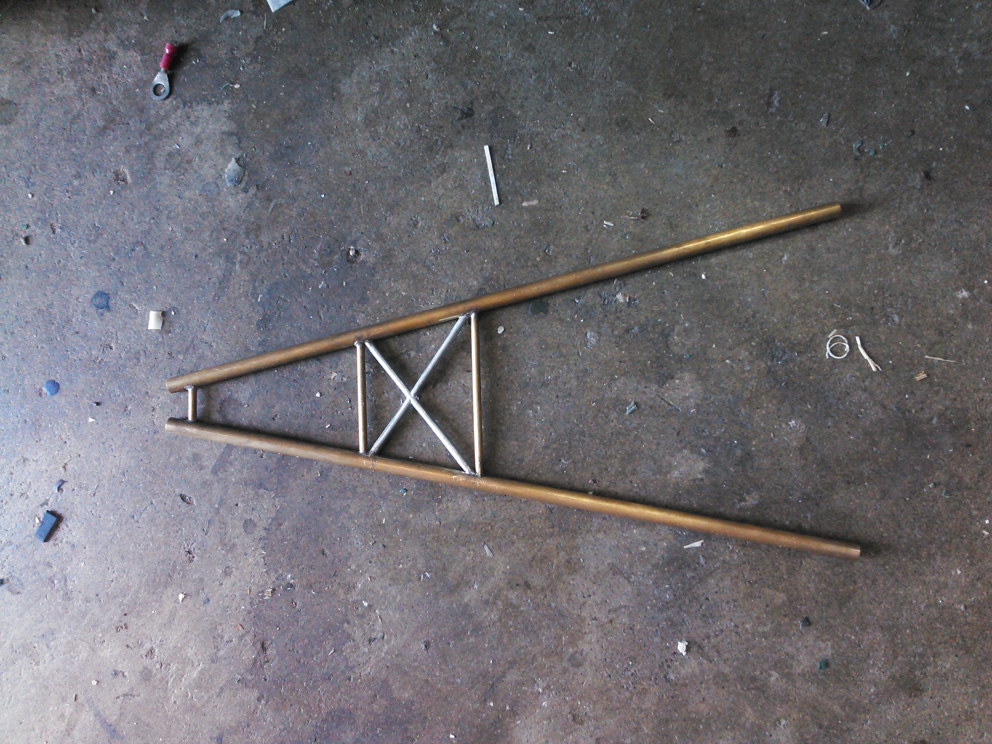

The actual A frame is brass rod that comes in the kit is pre soldered. The rest of the parts are cast white metal to be glued in place.
I have experience with soldering white metal to brass at low temps so I decided to solder some of the parts, the X brace in the middle has to be cut to fit and its ends filed with a round file tapered to fit. Then I soldered it in place.
I then tinned the boom end and soldered the funny bracket on the boom. Unfortuneately my toddler came into the garage while I was doing this and I lost focus worried about him next to me with torches and soldering irons out and I slightly melted the pointed end of the bracket, mostly the strap brace over the top of it. I could leave it and call it bent damage but I think I will cut that piece off and solder a piece of brass strip stock in place to repair it.
Next is the triangle gussets that go in the boom corners, but I might make them out of brass instead of the supplied white metal and silver solder them in place.

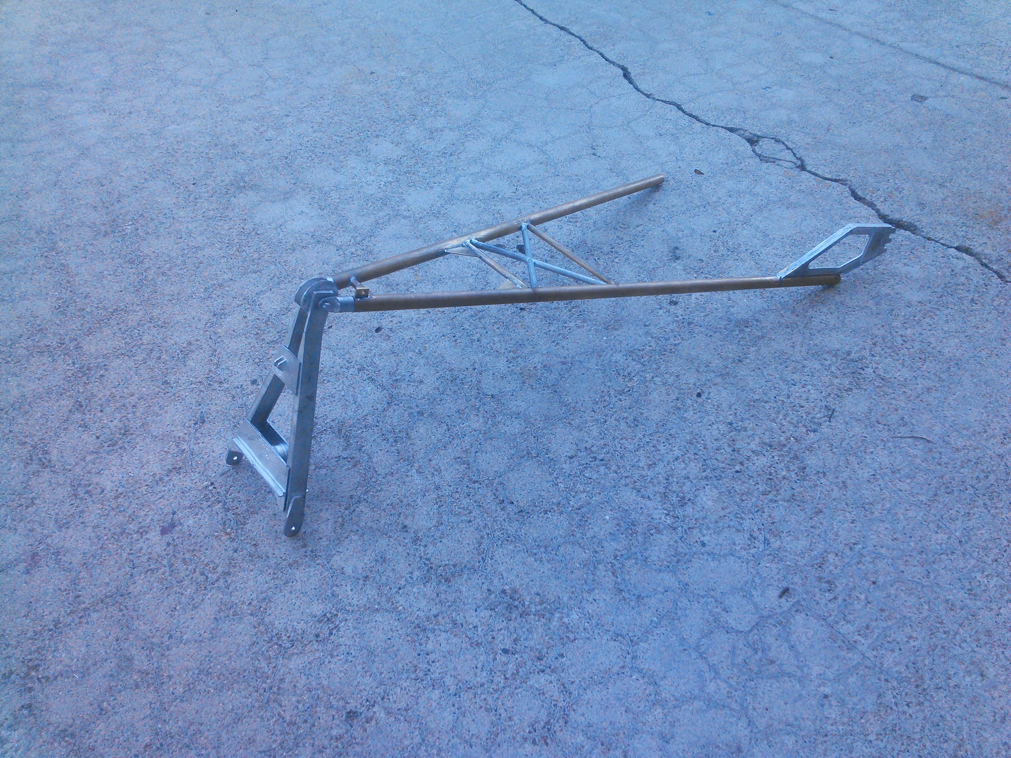

I got the boom mostly assembled. I have a few more things I want to solder on but that will come.

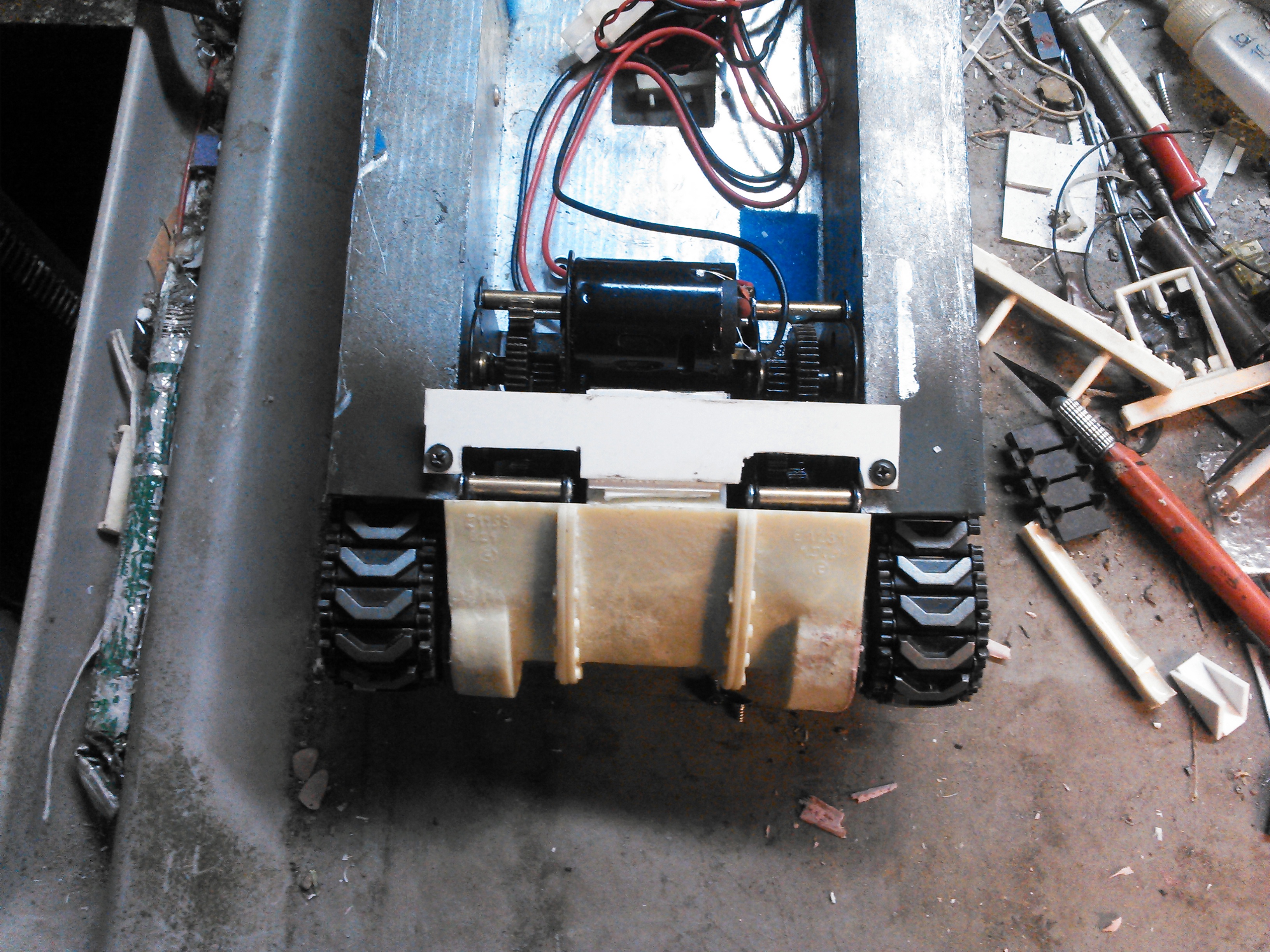

I had to cut 1/8 inch off each side of the taigen chassis to make the M4a3 hull casting from Nick Aguilar fit onto it. What a job that is. Takes a good half an hour per side. Its messy rough and tough on the face if you don't have a shield while using a dremmel cut off wheel

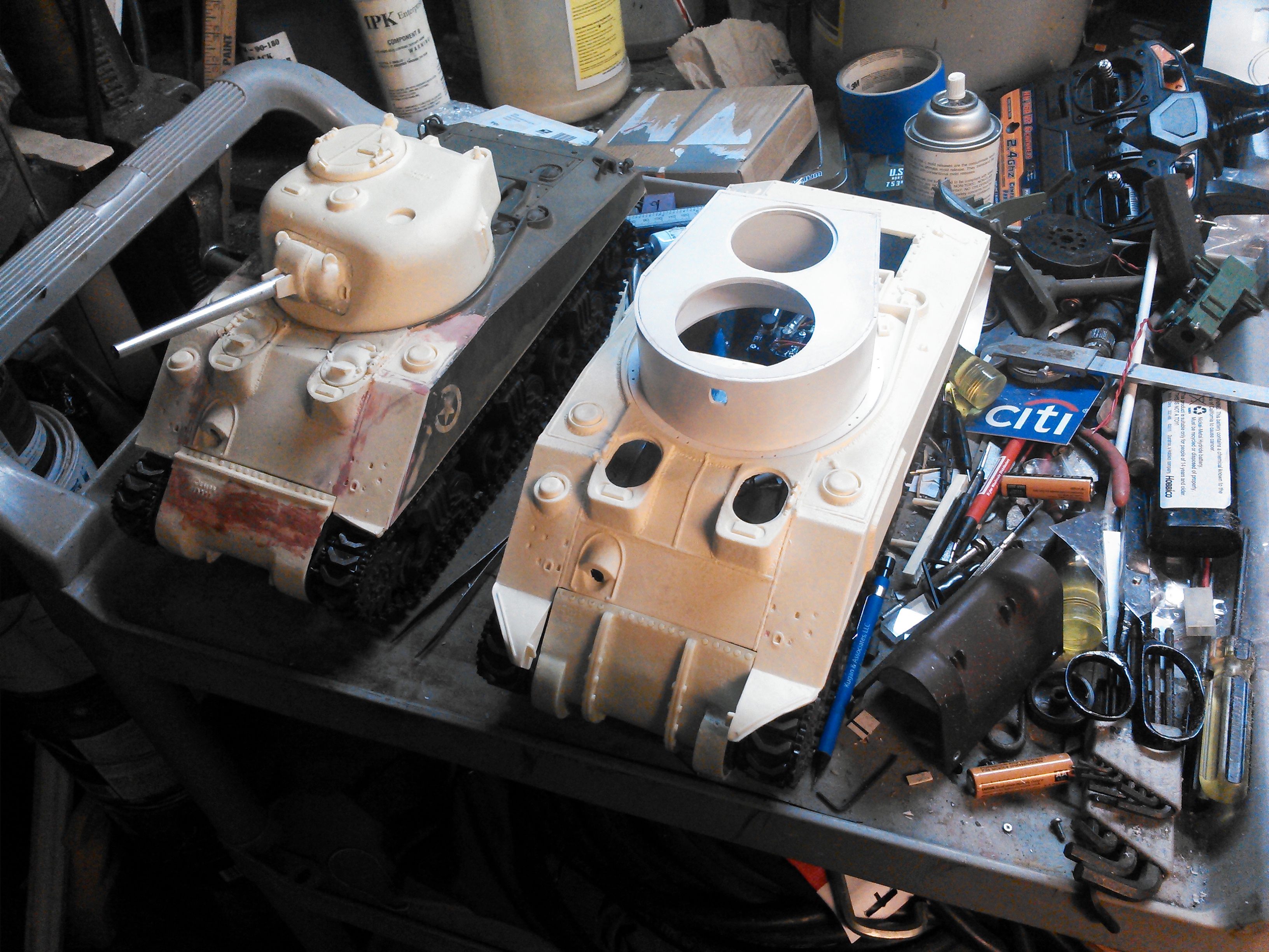

Here are the two small hatch tanks Im working on. The M4 and the M32B3. I have roughly fit the 3 piece tranny cover that comes in Christians M4a4 kit onto the taigen, but its not fitting well since its was made for a HL. Its too tall and long. I cut the bottom back and heated it up to reshape it a bit after grinding away lots of the material inside. Its still about 1/16 too high pushing the hull back so I am going to trim that much off the bolt bar, then reshape the bolt bar further forward on the tranny cover and sand the bolt frame braces of the 3 pieces back to shape. Should work in theory, we will see. Otherwise I will just cut down another nick tranny cover to fit like the m4 or maybe try to use the taigen, but it has a few issues preventing the hull from sitting down in place. Metal is so tough to work with.....

I have found that to fit the nick hulls I have to grind 1/18 inch off each side and then replace the metal tranny cover. The upper screw tabs protruding from the metal tranny cover prevent the urethane hulls from sitting down in place. His early nose worked but I had to cut some out of the middle and put the upper portion back on (see my M4 build)

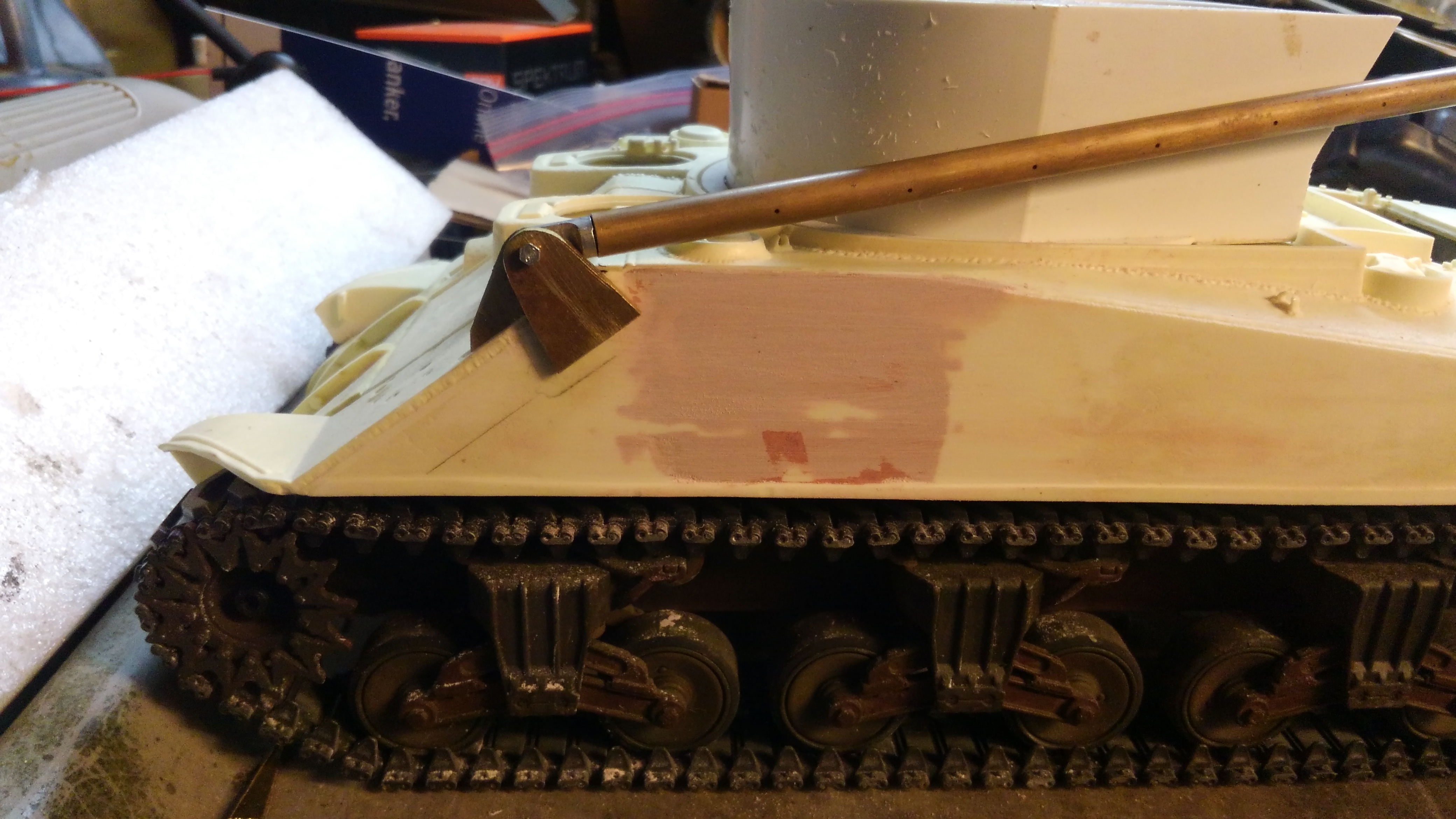

I had to grind the side hull applique armor off, then bondo the damage to clean it up and smooth it out. Worked on that tonight.
Also, the way the boom attaches to the welded hull is with these metal slabs welded to the side of the hull, as opposed to the super beefy brackets that were used on the cast A1 hull. So to make the boom fit on the welded hull, I have to narrow it up by like 1/4 inch. Yes it sucks so bad, kind of the reason I have put this off for so long. So....

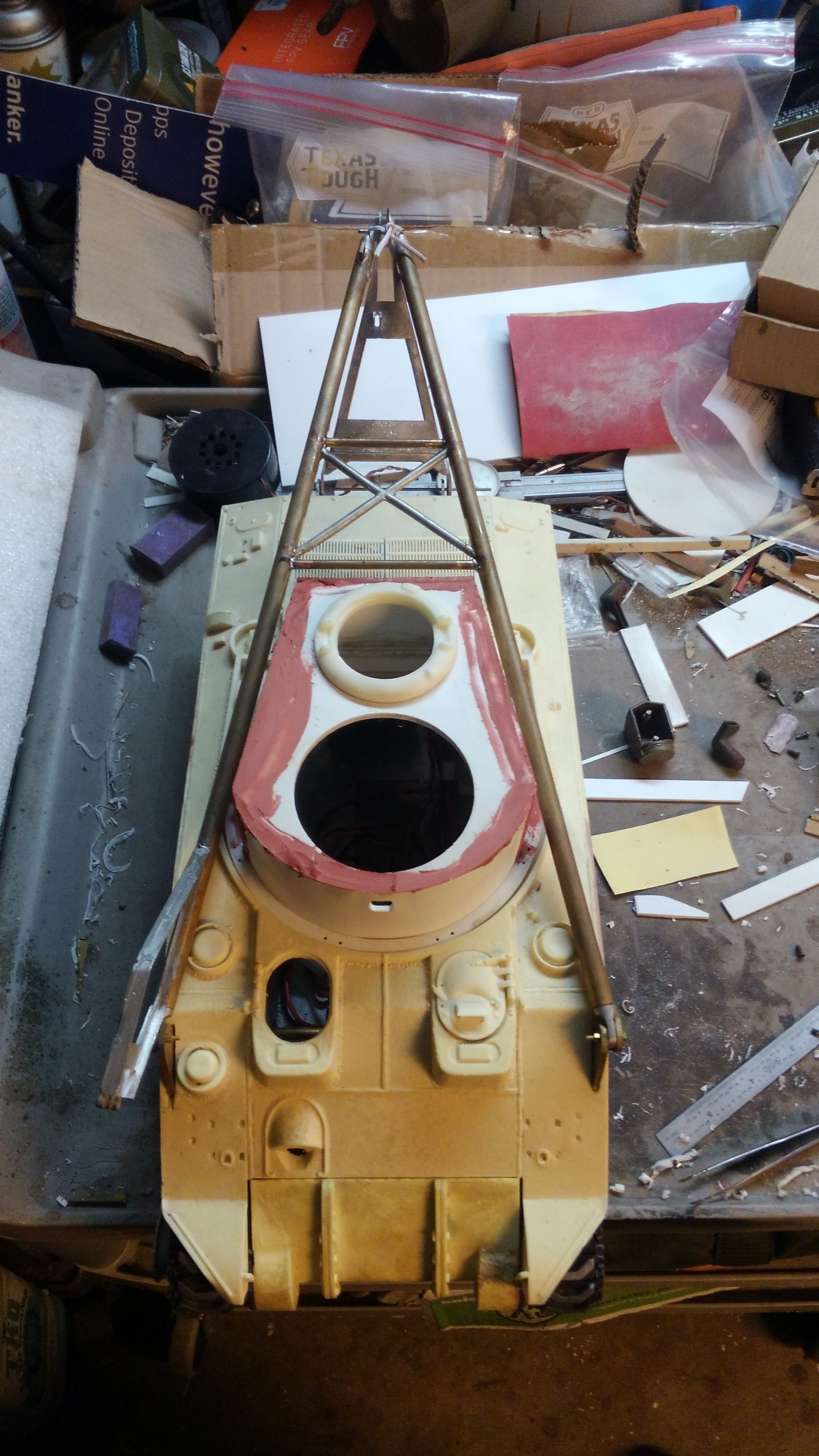

I removed all the cross tubes and bracing from the boom tonight except the top bar.

I had to remove all the cross bracing from the A frame boom to make it narrow enough to fit the Ford A3 hull from Nick Aguilar. Now, problem is the Turret is too wide to fit between them, but I know I have the hinge pivots in the right spot and the rear A frame is just about correct, give or take a MM so..... Weighing options on how to proceed, seeking help from those that may know better on other forums....

Ok, Got all the rest of the braces and gussets soldered to the boom. Now I need to glue the top pivot points for the A frame to the tip of the boom and square them up.

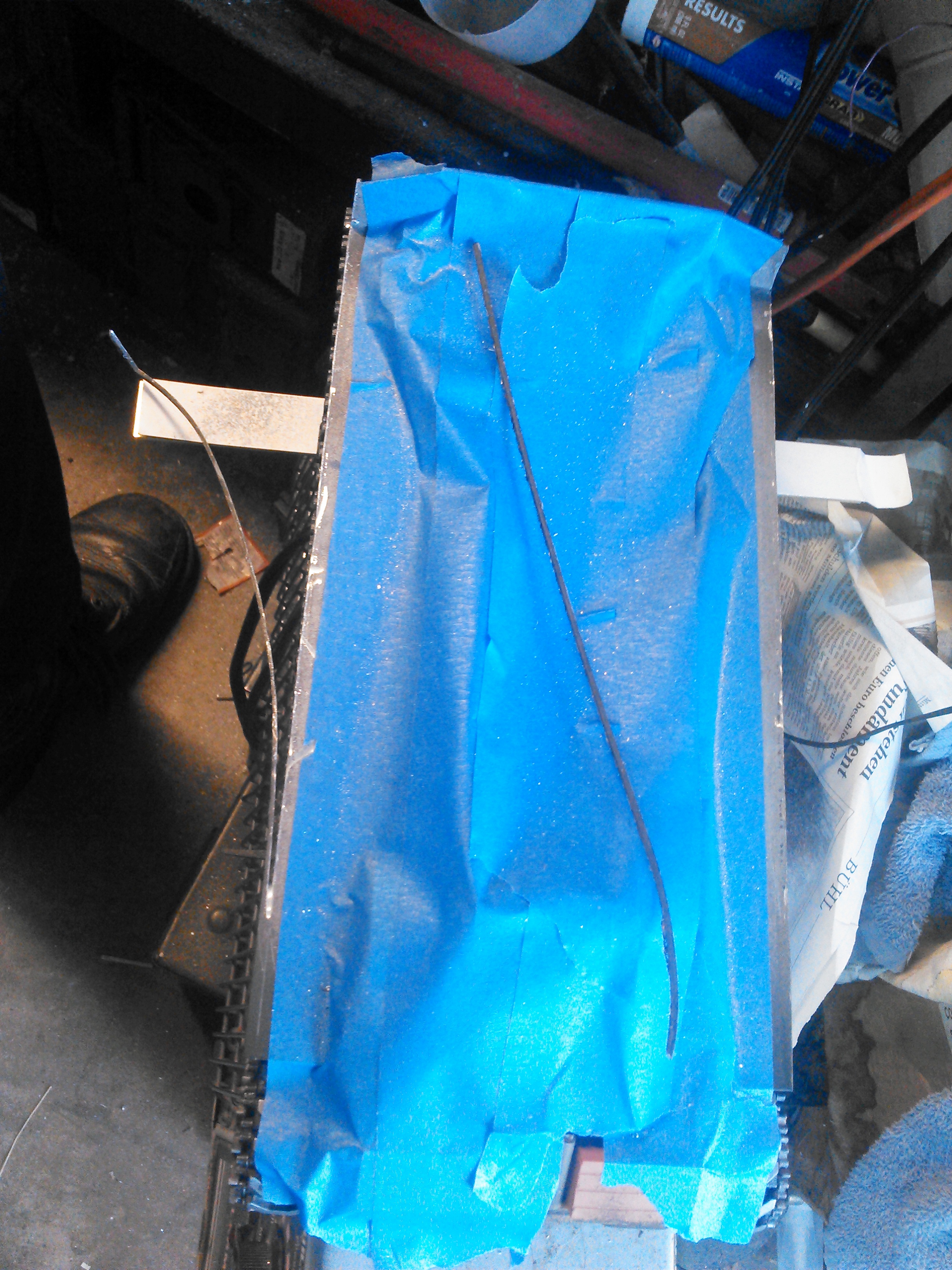

Then Remove and relocate the rear tabs on the back slope of the hull where the A frame stows into. Im debating using the metal castings as patterns and making them from brass like I did with most of the details on the boom. There are a few different types of rear brackets for the A frame, Some have a secondary attatchment point below the A frame spots for a big tow hook to drop down. As seen on the M32B1 on the back of the RR flat car here. So, need to ponder these options and do some research etc etc before I move on too fast. Also need to fabricate more padded lift rings for this early A3 hull. Sigh, I loath that work, it took me so long to get them shaped right on the Alco M4 build I just finished up. They are really tough to make but they do look awesome on the finished model since they look so different than the later bent rod lift rings.
