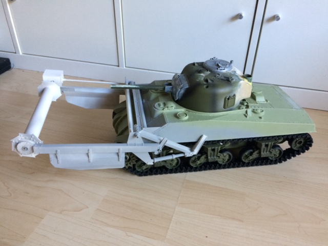

..my latest WIP..

Where did you get the M4A4 upper hull? Is it a scratch build or maybe a conversion job? I am planning on doing a flail on the Mato cast hull just to see if my plan will make a working, but I would prefer to do an accurate model on the correct hull.
rex
Old 08-30-2016 | 11:39 AM
Joined: Mar 2008
Posts: 995
Received 8 Likes on 4 Posts
From: kettering, UNITED KINGDOM

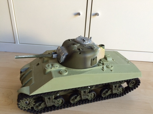

I got one of the DGS firefly kits and used the turret on a hybrid build, so I had the upper hull and transmission cover..so stretched a HL lower and modified a HL turret

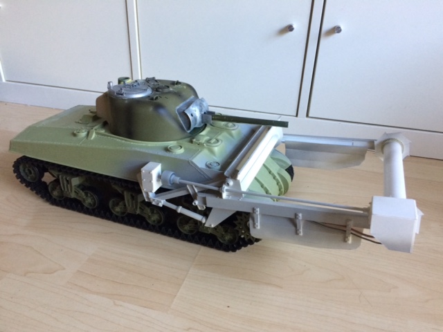

..made a start on the chains..

I am going to use chain like yours but haven't decided what would work for the weights on the ends. At the risk of being called a copy cat, what have you used on yours? I have zoomed in on your photo, but I can't recognize what you have there.
rex
Old 09-02-2016 | 01:16 PM
RichJohnson's Avatar
Joined: Nov 2014
Posts: 2,896
Received 428 Likes on 264 Posts
From: San Diego
I think they are Fyn's legos...
Old 09-02-2016 | 02:46 PM
Cromwell user's Avatar
Joined: Jan 2016
Posts: 32
Yeah i was going to say aren't those lego chains? I guess they would work perfectly considering the stud on the end would double as a weight! Nice looking tank though!

Yep the guys are correct, they're Lego chains..hopefully they'll work ok when spinning..I thought I'd try and keep the weight down by using plastic and also the links are molded as solid pieces so may be stronger than say brass ones..

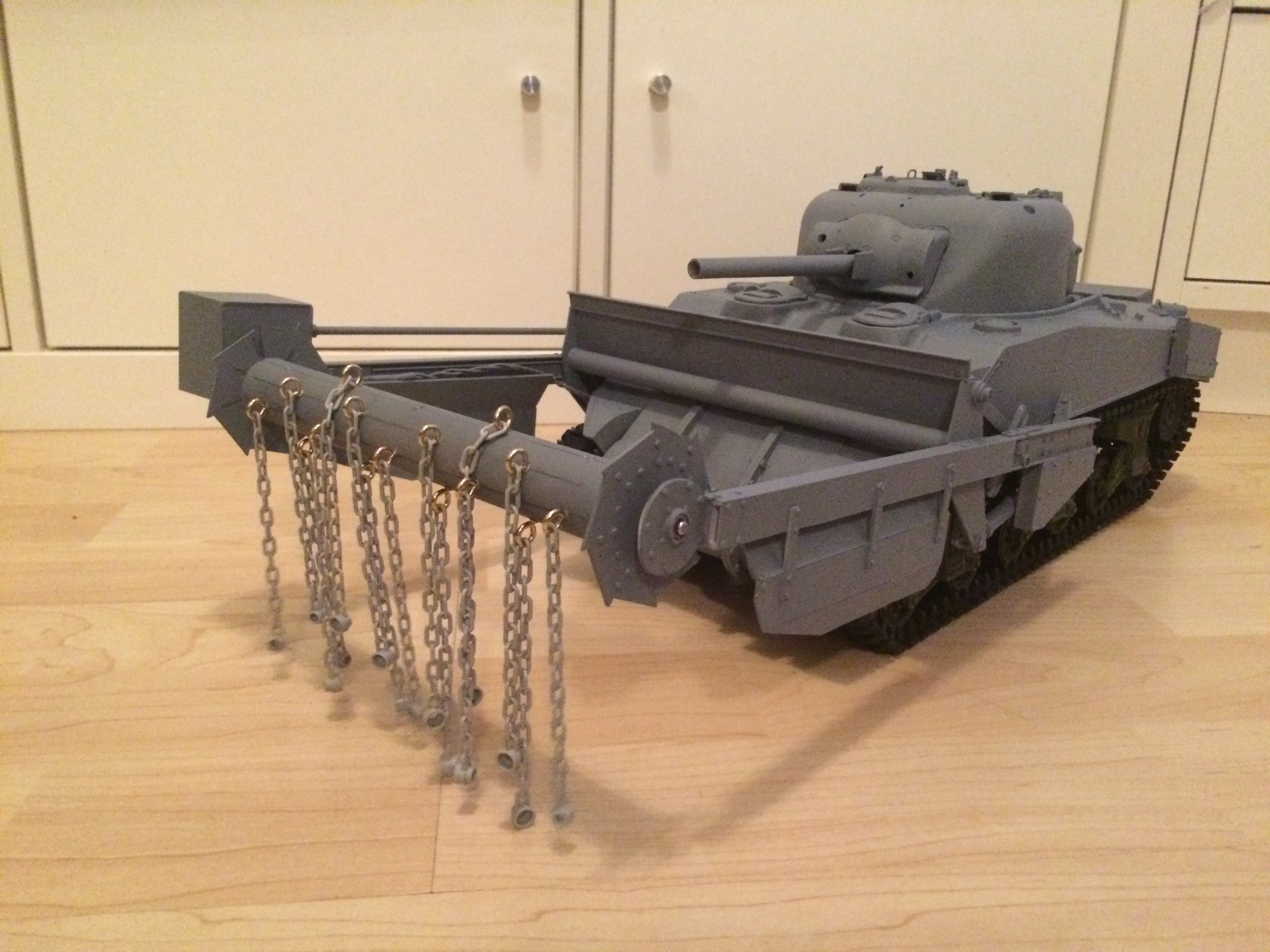

...first coat of paint and all the chains attached...

Hi
Great job
Don't make the mistake, The rotation direction
https://www.youtube.com/watch?v=95QNFXgUP5M

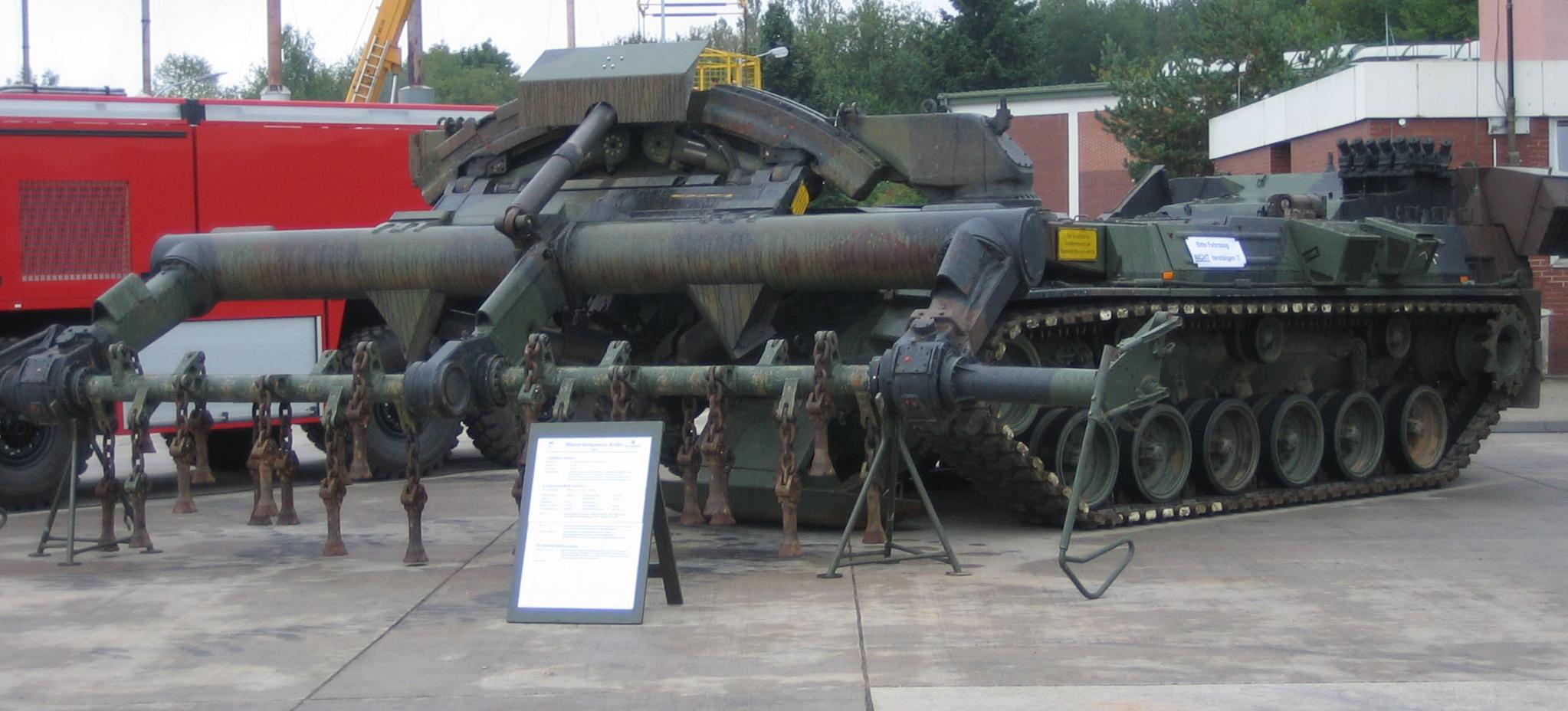

Damned that's a FAST spinning flail.... Sure looks faster than "factory".
http://panzerserra.blogspot.ca/2011/...nnie-mine.html
The Crab's rotor carried 43 flails and was driven at 142 rpm by a driveshaft running down the right hand side of the tank.
Sooo retro compared to later versions of flail-style mine clearers...

Of course it is... In my head... where my flail is still chewing up brain matter at alarming speeds.
I was just wondering just how fast those flails are spinning on your Crab. Likely a good thing they are light lego chains (definitely see why you thought one piece links were better).
