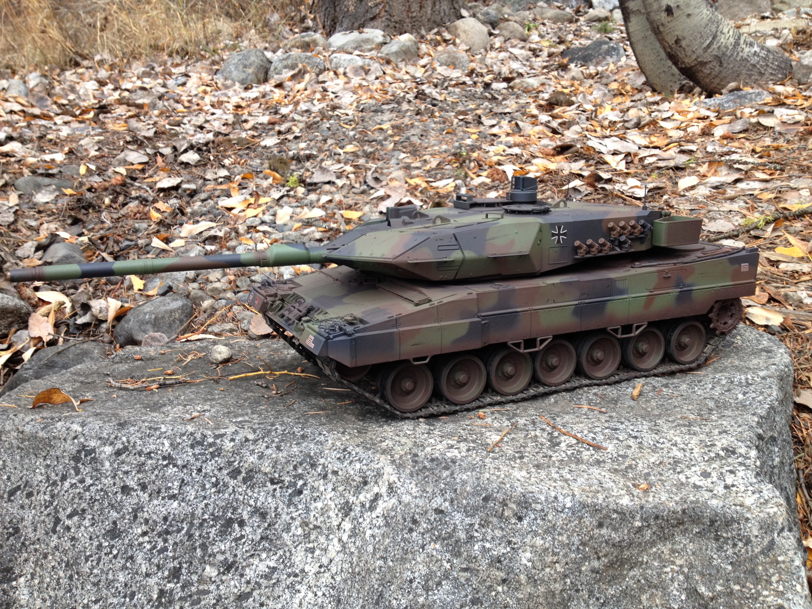

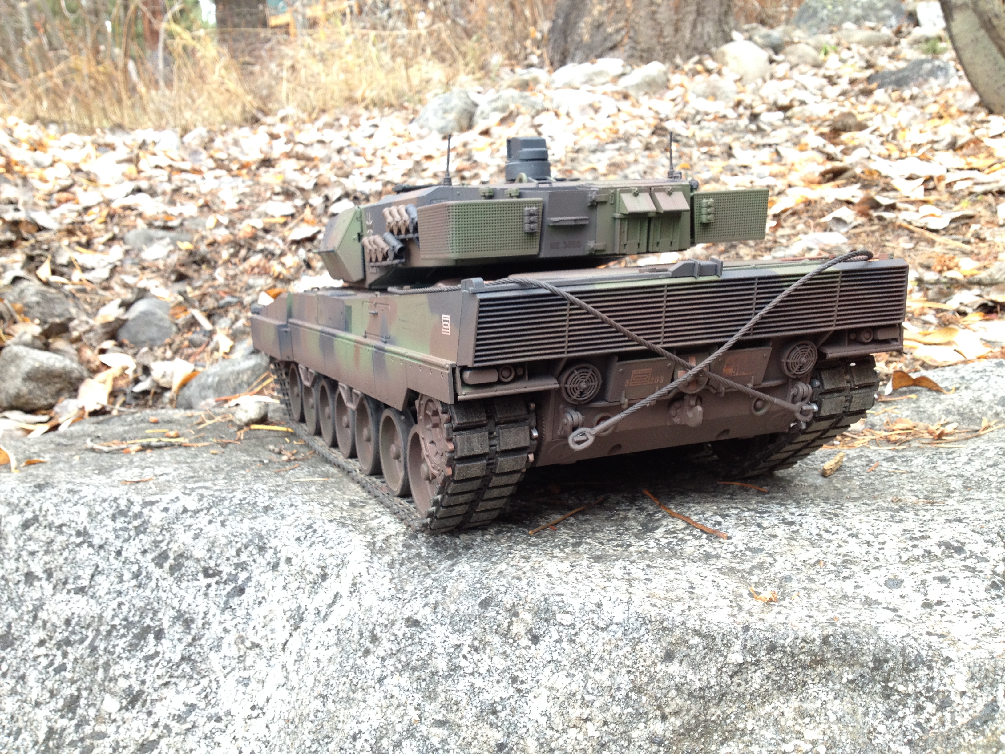

I've airbrushed 3 tanks today, figured I'd post a picture of the Leopard now that it doesn't look showroom new! Made her a little muddy.

Looking good!
