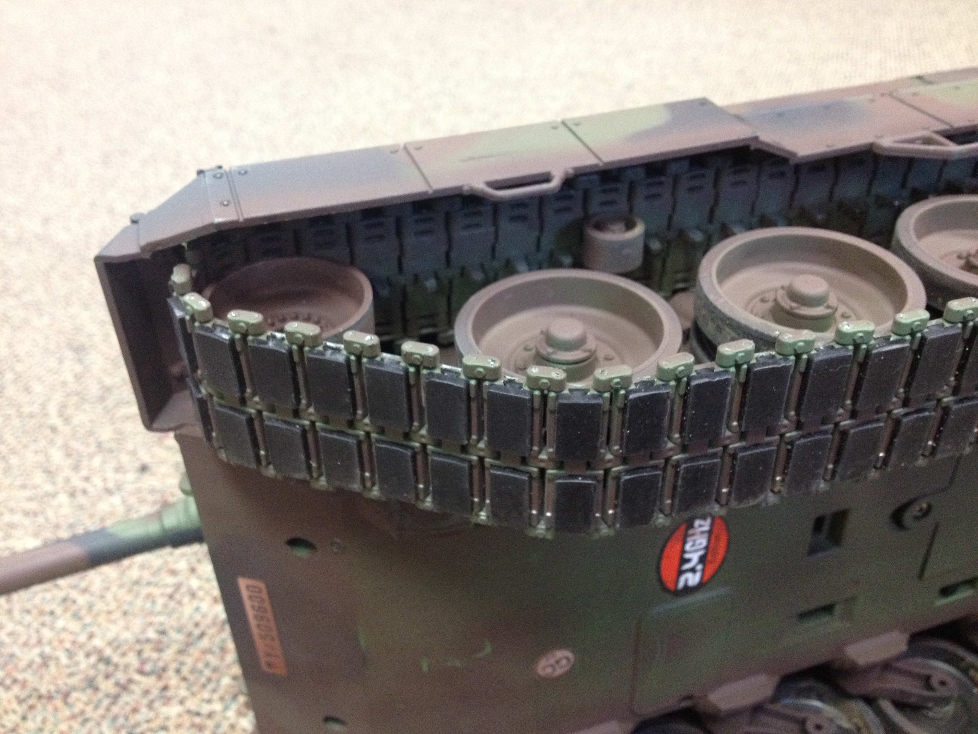

Got the metal tracks all detailed up and on the tank for now. Still need to find a glue for the pads, I've tried 3 different types of CA and Shoe Goo, nothing sticks to the rubber and I can barely get adhesion to the metal. It drives horrible with them on too, binds up pretty badly and the gearboxes are screaming in pain. Going to get the Ultimate II gearboxes in there soon. Here's some pictures for now and even though they suck to drive right now they look really good.

Try this stuff you first apply the primer let it set for a min or 2 then use the CA it makes it stick to stuff that CA normally don't stick to,

I thought people were putting the pads on these and then dropping CA glue into the holes on wheel side of the tracks. HL524 said he only threw a few pads using this method while filming his extreme off road videos.
The Tamiya tracks come with the rubber pads permanently attached. Have yet to damage or lose a single one.

I can try that, but CA just doesn't stick to the rubber at all.

It sounds like the rubber may be vynil or maybe silicon, If you use the locktite and use the primer and coat the parts first it should stick.

I searched around again and nobody seems to have found the magic glue for the pads. Can you buy a big bag of spare pads to last a lifetime?

That would be exceptionally annoying lol, I peeled 8 of them off in about 30 seconds driving indoors. I'll find something eventually I hope, otherwise these tracks were a big waste of money. The Abrams track pads are two pieces inner and outer and are glued to each other pretty well.

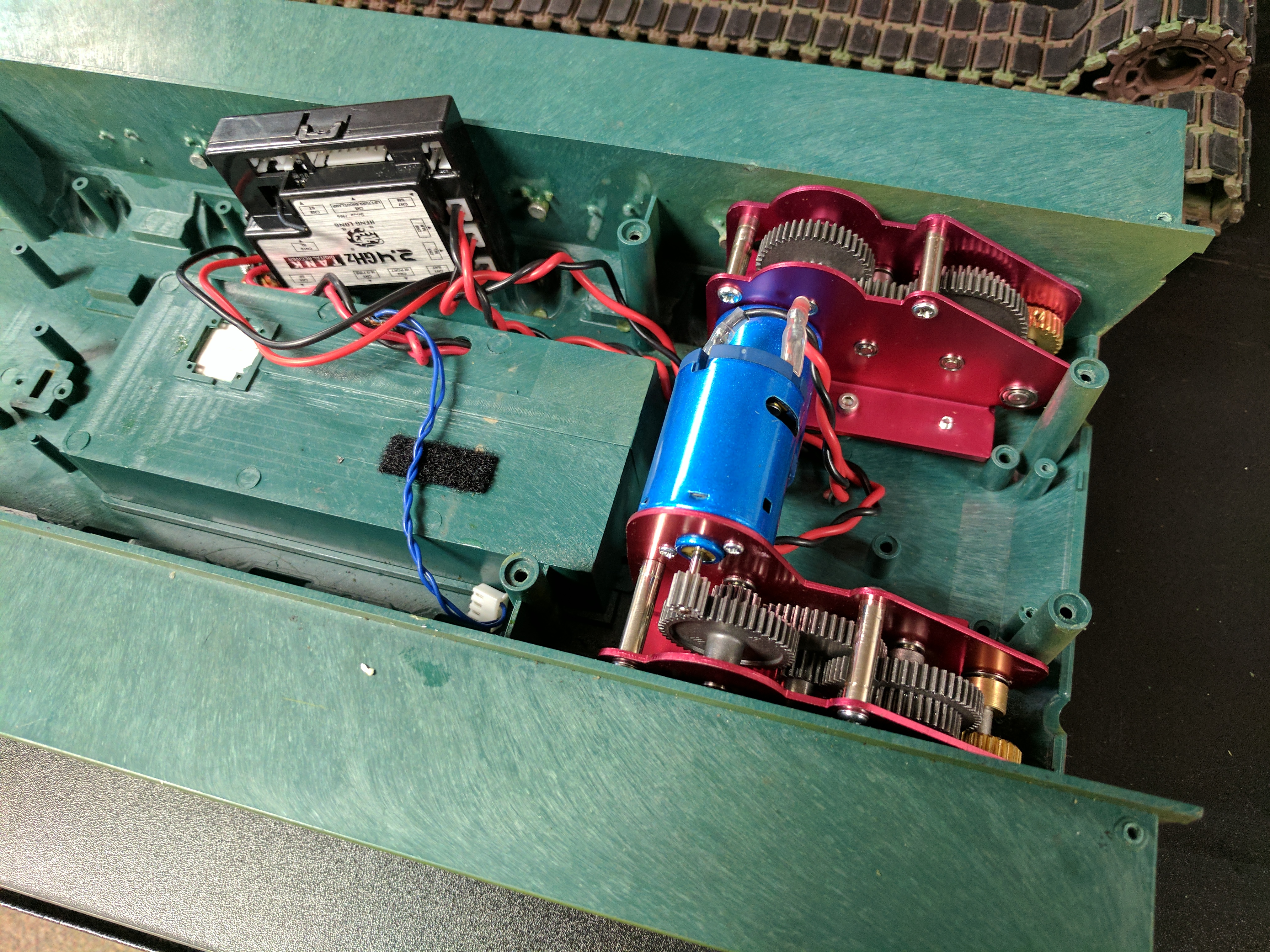

Today has been good so far! Installed Ultimate II gearboxes and printed another speaker box for the FRS7. I also grabbed some Liquid Nails at the hardware store to see if it will hold the pads on, fingers crossed. The gearboxes are pretty nice from what I can tell, could use some shimming on the gear shafts to limit the lateral play but they mesh good and are pretty quiet. Will report on how the motors do, might have to upgrade to 400's and heatsink/fan the MFU. I want this tank to actually be able to drive up some stuff eventually.

Cool! what are those blue motors are they faster and more powerful than the stock ones?

The blue motors came with the gearboxes, they are a higher speed than stock supposedly. I just ran it around the office and it is pretty fast, much faster than the plastic gearboxes that were in there, but the tracks are pretty stiff and not running smoothly. I think they need to be broken in to the sprockets, letting them run for a few minutes seemed to help but they are very jerky and don't mesh with the sprocket teeth very well.
I'm going to pull all the pads off again and see if running the tank breaks everything in to each other and then try the Liquid Nails on the pads.

Cool do they sell those blue motors seperatly?

I haven't seen the motors separate. I want to install 400's and heatsink the MFU, just because I can lol. More torque is welcome now that the drivetrain will handle it. Just need to brace the idlers and get metal tension arms.

Almost got a set but opted to try the full HL gearboxes first. They seem decent, better than the stock plastic for sure.
