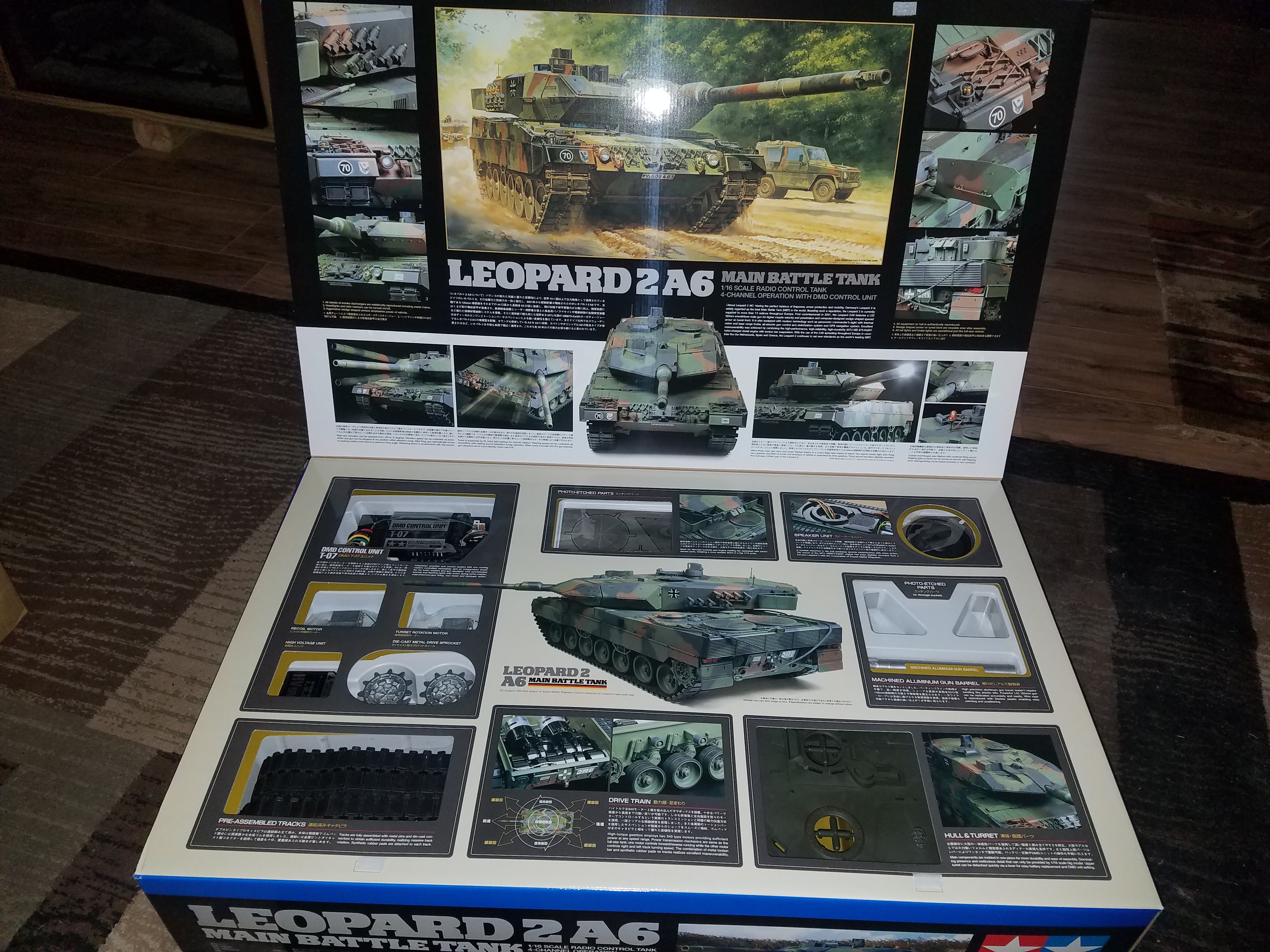

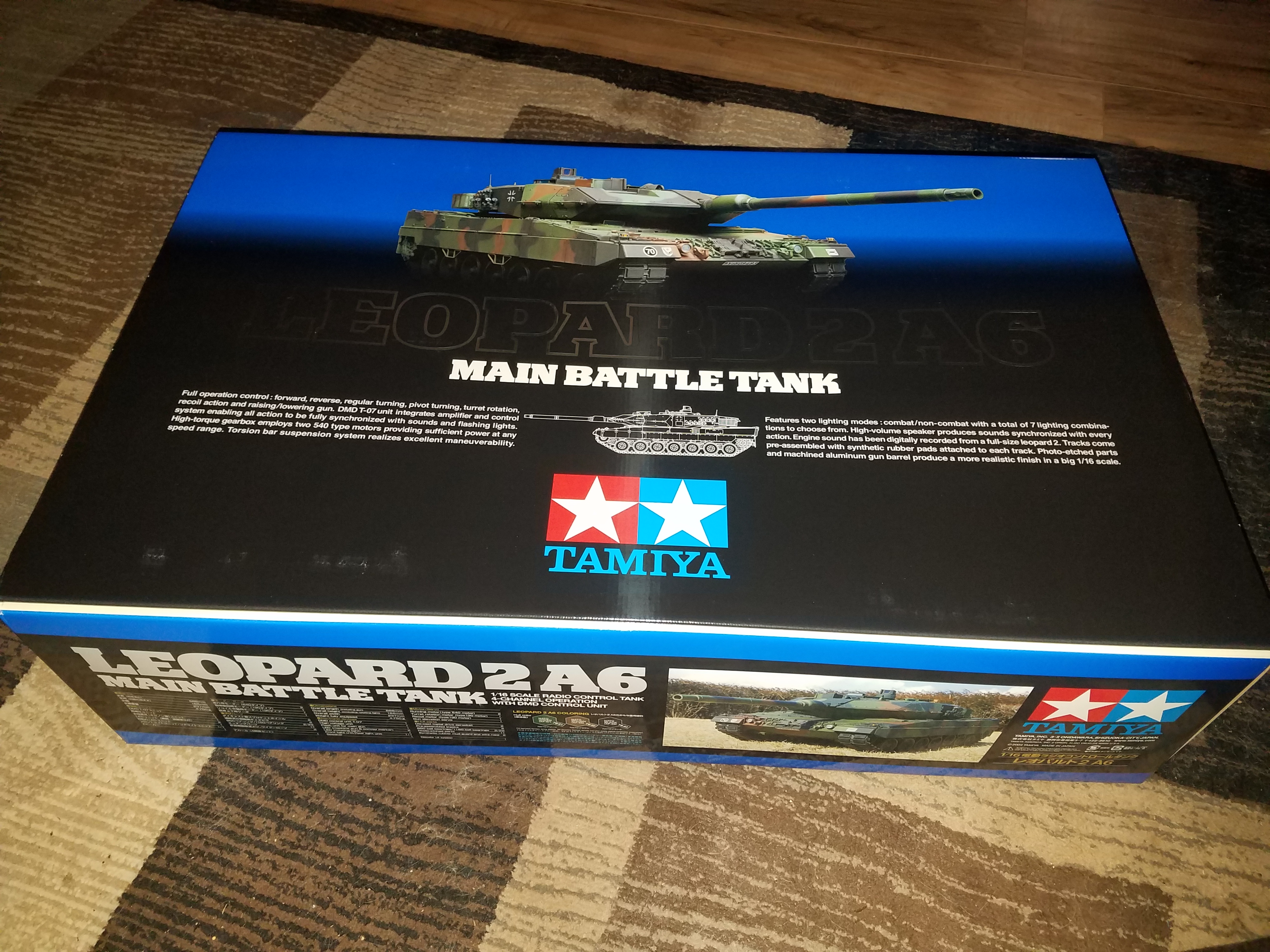

well my leo came in with the radio, really impressed with the the packaging and detail in parts. Will try to do a build thread on here. this will be my first build. Going to take my time on this one but hopefully it will turn out great.

Congrats, you're gonna love it. It's a suitcase of goodness.
I'd grab a bunch of small containers to keep all the hardware in. They're marked and referenced in the instruction, it's easy if you have all the A, B, C, D parts, etc in cups or something instead of rifling through bags.
Also, a few years back Tamiya started using ABS on some parts like road wheels (don't know why, the polystyrene holds up great), so pay attention. Again, it's in the instructions and marked on the sprue (PS, ABS).
If you're not familiar, normal modeling cement is for PS and won't hold ABS. You'll need Tamiya Extra thin, PlastiWeld, Tenax or any MEK or methyl chloride based glue.

thanks for the info, after looking at the directions, its going to take awhile to finish this, but im not in a hurry, will be a good learning experience for me. going to have to make a trip to get some ceramic grease, is lithium grease the same thing? never mind, it comes with ceramic grease. Guess I should have looked at all the parts.
