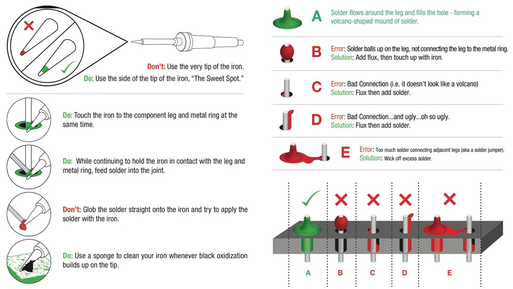

There are crimp connectors available, but the tool to install them is quite expensive. An adjustable heat soldering iron will work just fine for everything on a tank as will regular ones with some practice and experience. Get some wire of the same size and practice for a bit. It will not take you long to be proficient at it. I also like to use a paste soldering flux when soldering to make it a better joint.
Herman
Herman
The higher the wattage on a soldering iron, the better it can retain heat when making contact with something else.
A 25W soldering pen is cheap, but will be hard pressed to do any heavy duty regular solder connections. A 120W+ soldering gun is large and cumbersome, but very fast for heating.
One of the best units for most (IMHO) is a Weller WES51 which has a variable output (up to 60W) and replaceable tips. Of course you can get cheaper versions and some pretty powerful soldering pens w/o the large transformer station.
Some links.
http://www.instructables.com/id/How-to-solder/
Your best bet?
Buy a small spool of 20-28ga wire, a cheap wire stripper, a fair soldering pen and a spool of solder (likely under $40 total or less from ebay). And practice, practice, practice.
