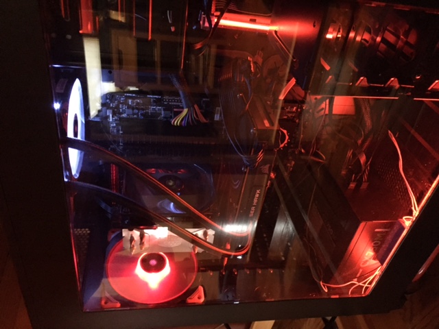

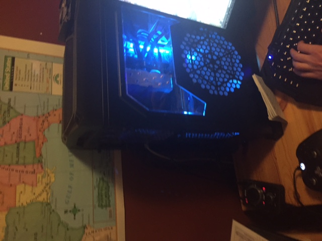

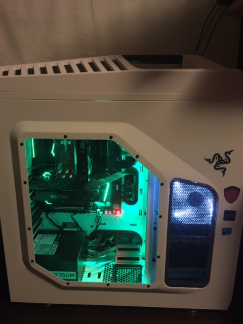

Old 05-23-2017 | 05:25 PM
Joined: Dec 2012
Posts: 760
From: littlestown, PA
I guess it is always like that. The last one I couldn't find the case hardware.
