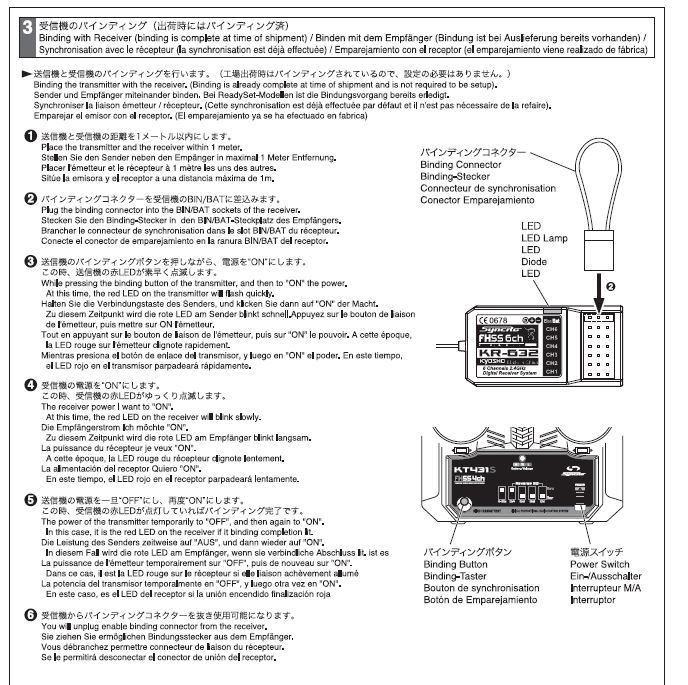

Has anybody ever tried to bind this Tx and receiver? I have tried for about an hour and have not been able to do it. Im using a tamiya TBLE-02S Esc. Ive seent hese setups on varies r/c stuff but I cant seem to get it to bind. And Im guessing that the tx and rx needs to bind before setting up the esc.

I've found a reference to the 431 transmitter and the 632 receiver, just waiting for the slow 60meg PDF download...
sgtparker01 05-23-2017 01:24 PM
great, thanks
Jarlath 05-23-2017 01:30 PM
1 Attachment(s)
Attachment 2216698
The receiver supposedly has an LED
sgtparker01 05-23-2017 01:33 PM
i guess it does, never came on when I tried to bind, Ill try again, thanks very much.
Jarlath 05-23-2017 01:35 PM
Link to the 58+ meg file I found it in.
http://www.kyosho.com/jpn/support/in...ZARD_FR_IM.pdf
sgtparker01 05-23-2017 01:36 PM
thanks, ill download it.

still cant get it to bind, heres how it is setup, battery to the esc, then from the esc goes the wire to channel 2, (esc directions say thats where to hook up the esc to.) I put the bind plug into the rx in the bind slot. I hold the bind button in on the tx and turn the power on, i release the bind button and the light flashing fast, (suppose to slow down after bind) I then turn the esc power switch on and it shows a blinking light on the esc(thats the way its suppose to be for a brushed motor.) and a led is suppose to blink on the rx but thats not happening, makes me thing that no power is getting from the esc to the rx.

I found the problem< I had the wire that was going from the esc to the rx in backwards, had the white wire on the right, suppose to go on the left. in other words, from left to right, white,red black.
