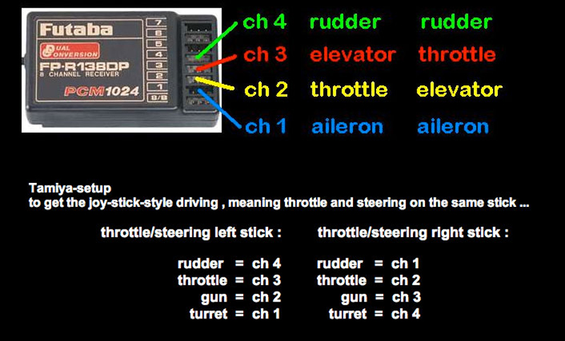

Are there certain switches for things like firing a shot or starting the engine sound etc?
I just got a Tamiya PzIV for Christmas and haven't found anything in the instructions much beyond where to plug in some of the plugs.
Old 01-02-2018 | 09:25 PM
Pcomm1.v2's Avatar
Joined: Sep 2013
Posts: 1,079
Received 49 Likes on 36 Posts
Go to step 15 in your Tamiya Pz 4 Assembly Manual and do what it says precisely. Note, first setup the tank electronics outside your tank as illustrated.
Receiver setup tips below for transmitter stick functions per "Willy".
