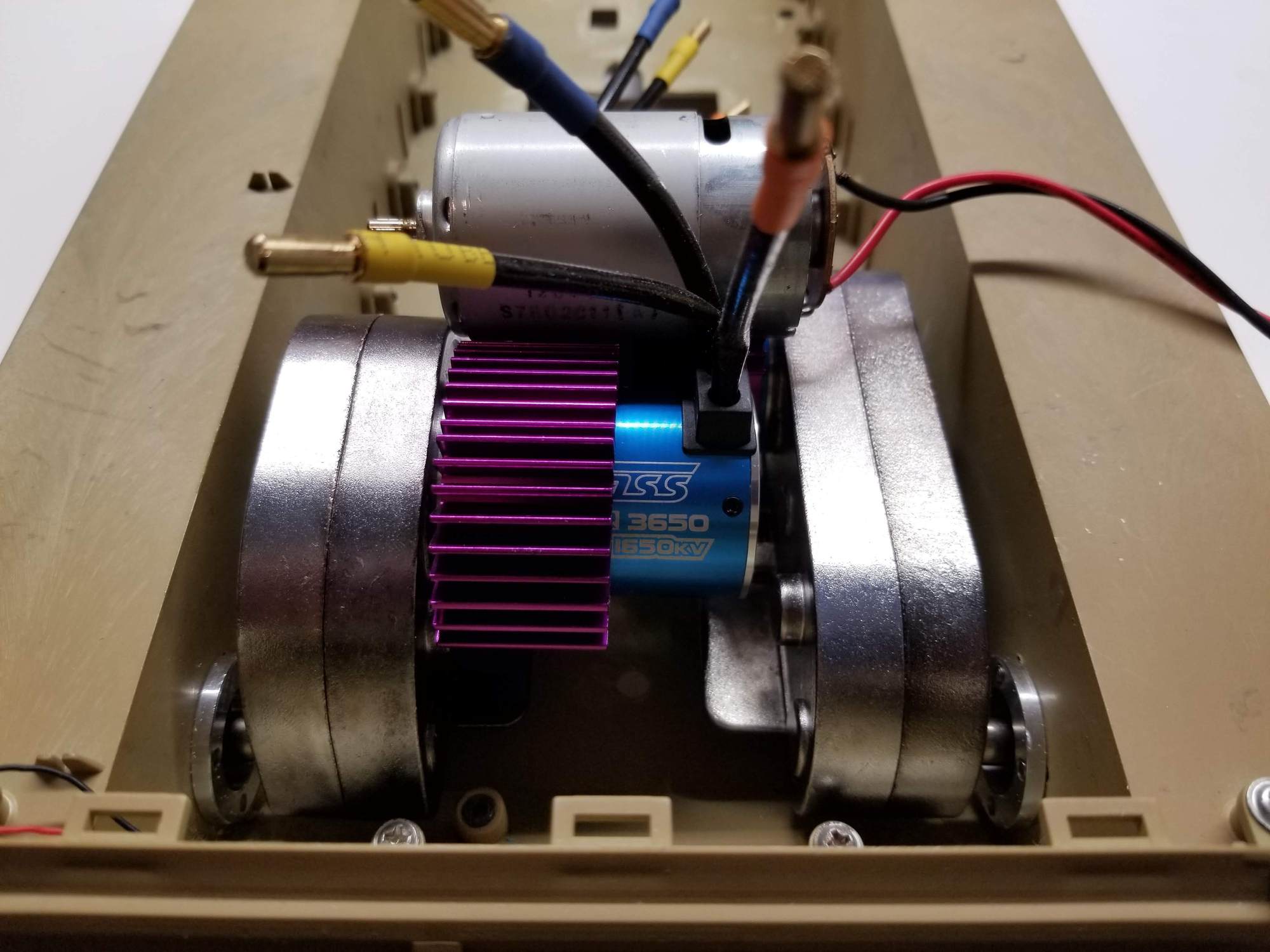

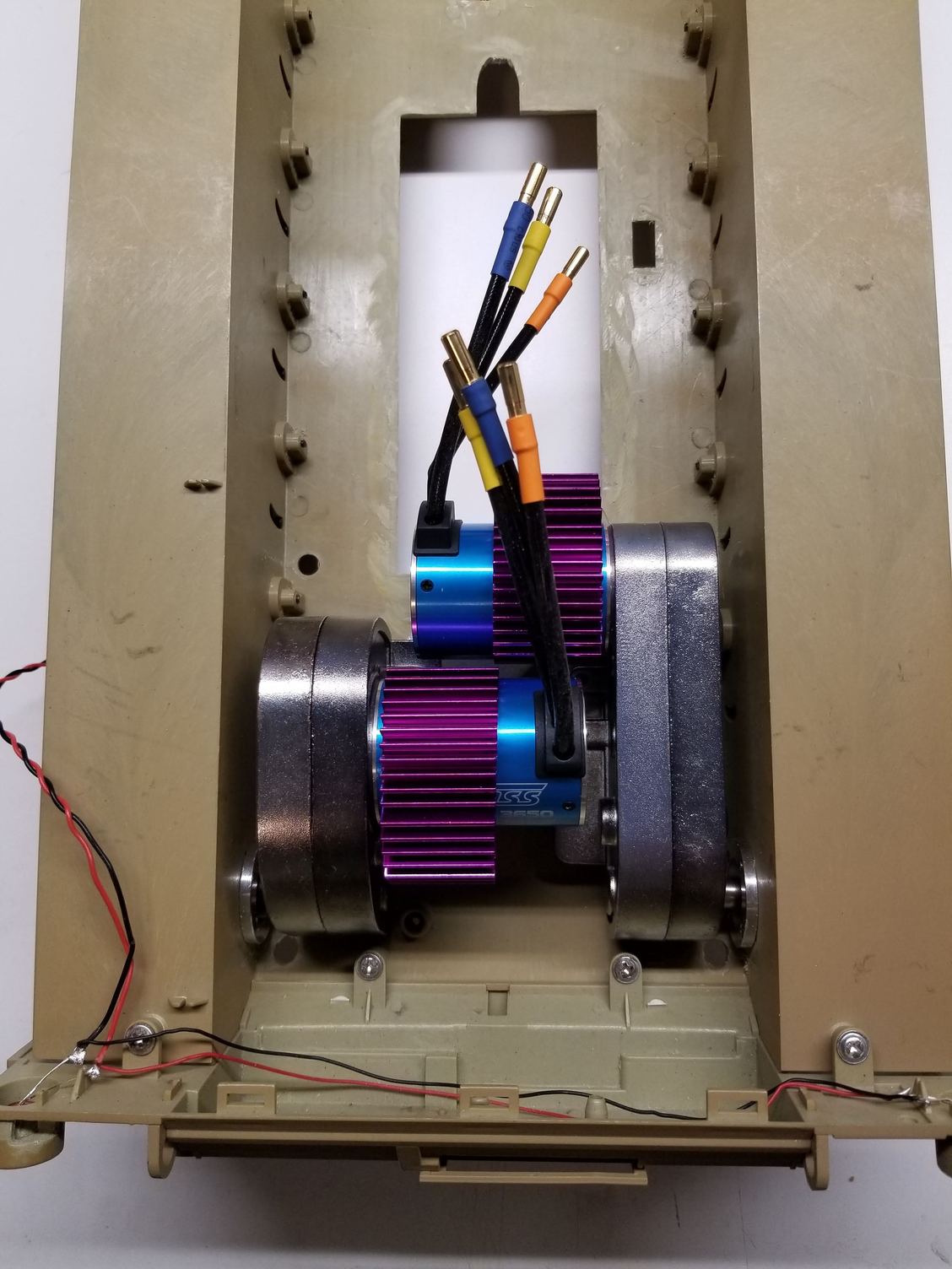

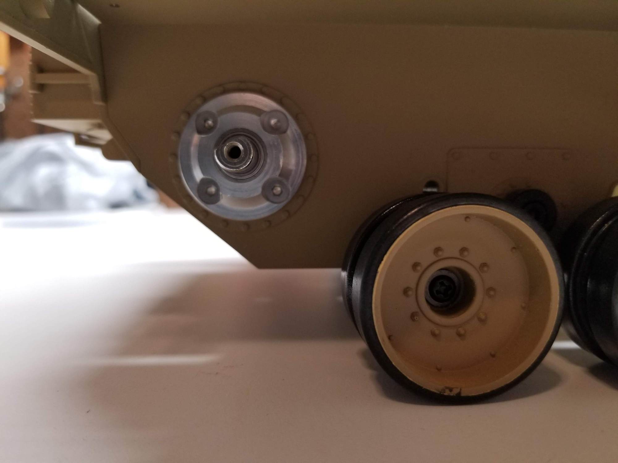

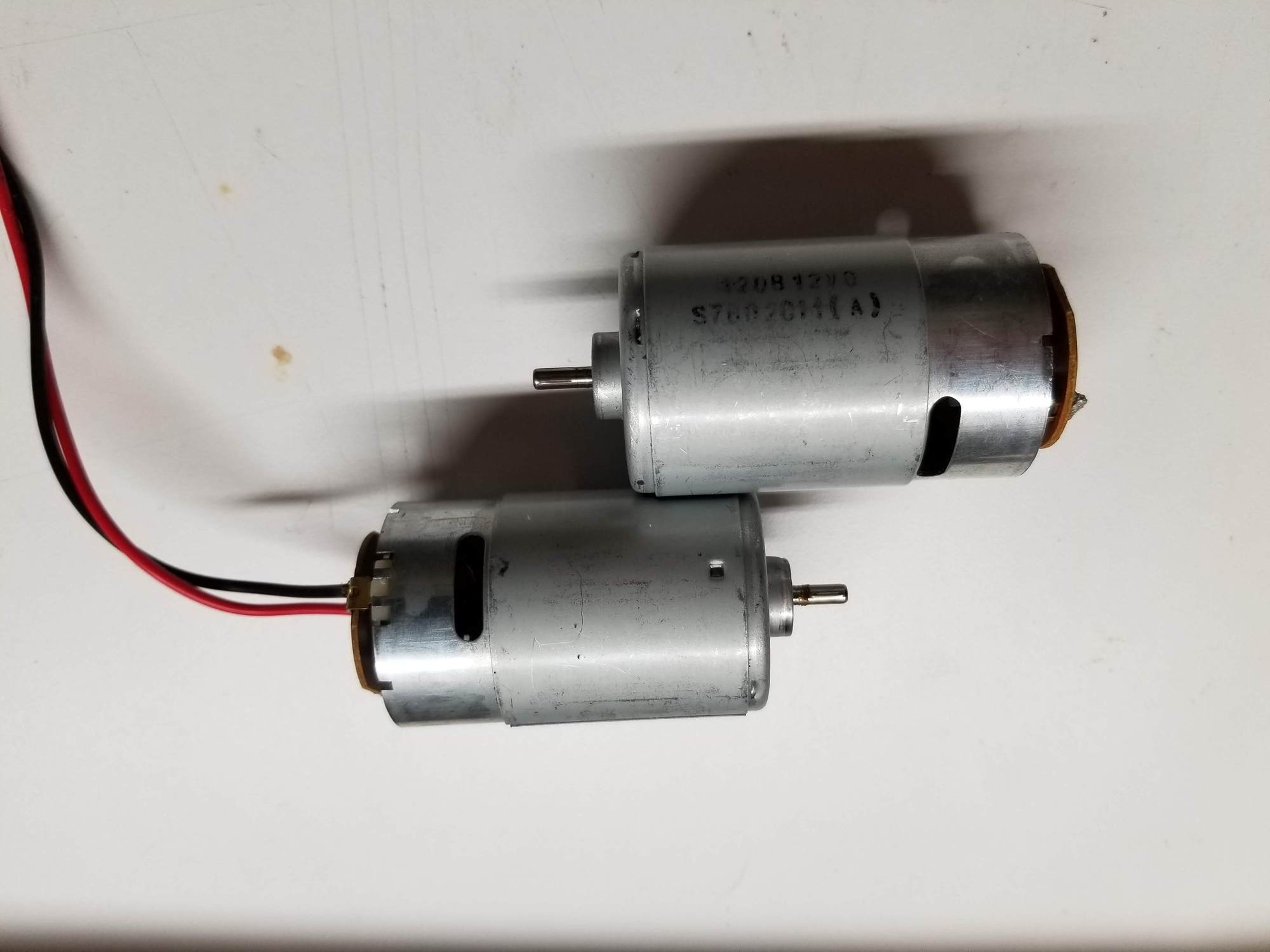

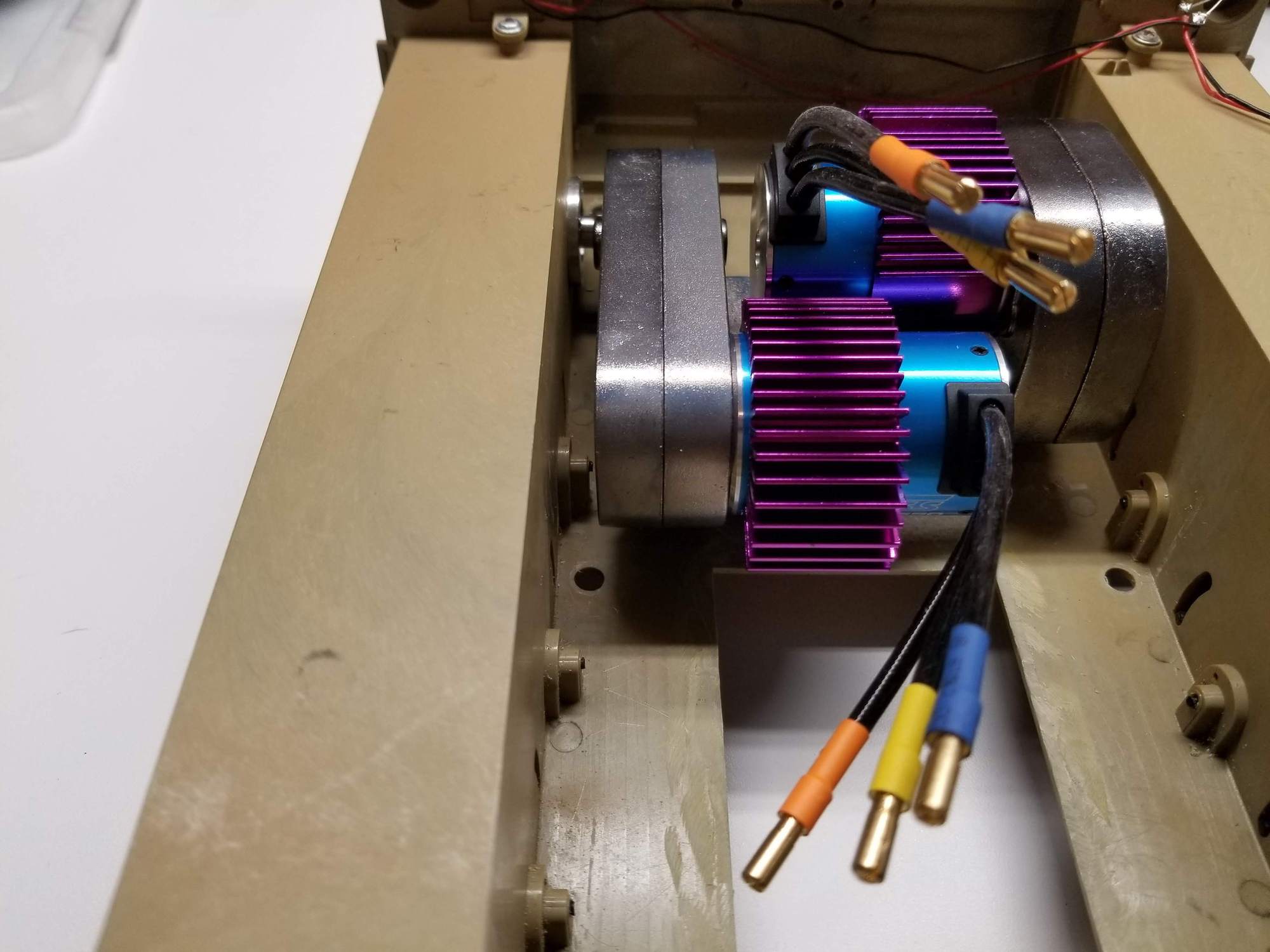

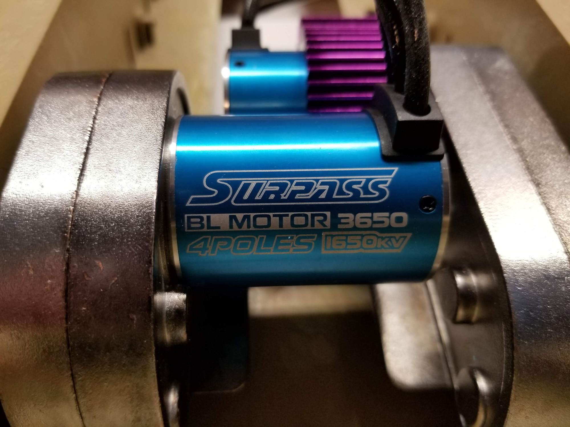

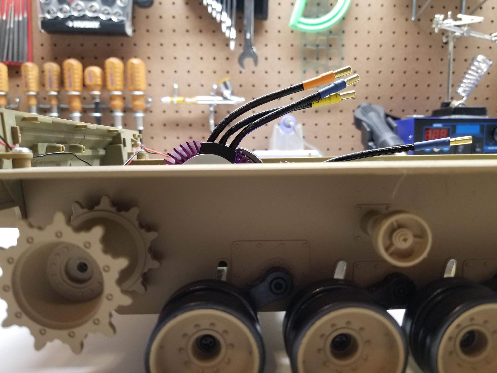

Well, the dreams of a brushless Abrams made some major steps forward tonight. A long time ago I purchased the original gearboxes that DKLM was selling for the metal lower chassis designed for the HL Leos. I thought how hard can it be to adapt to an Abrams? I found out...it didn't work. That was of course after I gutted all the standoffs and supports out of the stock chassis. So I decided to redeem myself and get the combo to work. What was killing my build was the length of the brushed RS-550 motors. The were 65mm long which made them too long to fit in the Abrams chassis and maintain the correct track spacing. I saw a brushless conversion of the DKLM gearboxes online and felt like the shorter brushless motors would allow me to mount the gearboxes. I didn't want to go the same route as the other person that converted to brushless since he drilled new holes for the motor mounts. I wanted to use the stock mounting holes. After and exhaustive search and a 3 week wait from China, my 550 brushless replacement motors arrived. I ended up going with a 1650KV 3650 (36 is the diameter and 50 is the length in mm) brushless motor. The motor also has the same 3.175mm shaft so the pinions moved over to the new motors without issues.
Top view.
Front view.
Mocked up height.
Shaft support.
New motor up close.
Old Motors
Length comparison.

Love what you have done! It is going to be a super fast Abrams once everything is sorted out. I run mine with traditional 390 brushed motor at high voltage (9+) and they are fast tanks (scale 50-55mph), cannot wait to see what speed you can achieve with brushless power adapted to an HL Abrams.
It is fun to watch the modern tanks rip across terrain at high speed. Unlike a WWII tanks where it can looks odd, with modern tanks properly balanced it does not. Just a friendly word of warning the speed leads to harder driving which leads to finding things to jump LOL. Here is one of mine getting some "air" just the other day. These HL Abrams hulls and suspensions are far tougher than most would expect. Looking forward to following your progress as going brushless is something I have been looking at in the near the future.

I don't want it too fast. The lower KV rating motors have less RPMs per volt. Being that it still has gearboxes to gear them down and increase the torque, I'm hoping the speed is within reason. It will be powered by an OpenPanzer TCB. Just can't do any testing yet since my brushless ESCs haven't arrived yet.

So the OP board can run 4s lipos btw (that is 17V btw) and does it no problem when paired with the Scout or Sabertooth ESCs I ran in my drift Tiger 1. I used x2 3660/3000kv motors on 4s on the 3:1 gearboxes, it was not only fun as heck but destroyed most of my suspension each time I took it out. It was absolutely hilarious taking it on the local car track, people loved it. Due to the height I could never get the top on but man was that lower chassis fun to play with. I know I have pictures of it somewhere, I'll look when I get to my house later and see if I can find it. I think it is like 3+ years old actually....
I've always wanted to go brushless in the tanks (at scale speed of course) due to the larger availability and better specs available for the motors. We could get a much better scale speed with 540 motors and adjusting KV ratings to the tanks. Mainly getting specs for BL motors are the killer for me. I like being about to adjust final speed by the motors. With a gear ratio of 39:1 (you have to use the 3:1 type, the 4:1 type doesn't have enough room to mount on top of each other) there is plenty of torque in those motors to drive as fast as you want and still have the low speed power to creep along. It really helps if you have something like the OP though as there a ton of ways to adjust speed without using things like dual rates which effects the sounds (you don't get the max revs if you D/R the limits) however that is one of the best ways I've found to do it as well and it is super simple to do.

Yes I am using the OP board, but it will be paired with some Hobby King brushless ESCs. I really like the idea of using these gearboxes because they are enclosed. Should eliminate gear oil or grease flinging. I will be beefing up the lower hull also.

I think you will like it. OP has that speed limit by percentage that really helps with higher voltage stuff. The momentum and inertia settings are fun to play with as well, I bet with a brushless application it will be even better. I actually haven't done a BL tank on OP, I bet with a sensored BL motor it would be awesomely slow...

My best experience was with HK 2848 2650kv motors (basically rs390-size) in original Taigen 1:3 gearboxes in a Bulldog. 11.1v LiPo... and watch it fly and spit parts allover the place. Indeed a laugh a minute, seeing a tank go like the retro tank-monstertrucks of the 80’s. Sadly, HobbyKing no longer seems to sell those. They were great. One of them is now happily sitting in my Skidoo-MX Snowmobile. Tried 2840 sized 2200kv 12-pole outrunners too. However, they ripped the gearboxes themselves from the chassis.. ooops.. a bit too much torque, I guess.
The biggest problem, oddly enough, was finding affordable 10-tooth 48p pinions drilled for 3.12mm.
In the end, I believe that even for us tankers, brushless will be the way to go. I’ve been eying the DKLM gearboxes for my Leo for some time. Your experiments pulled me over the line. Plan is to stick cheap 3650 sensored motors in them, and go for 21.5-turns. Should do about 2000kv. Loverly fast for the Leo.

My brushless ESCs arrived the other day so I can start playing with them using the Open Panzer board. I might have some time in the next week or so to get a rolling chassis working for the Abrams. I've finally been able to get stuff organized enough after buying my new house and moving to do some work on my hobbies. The DKLM gearboxes have all metal gears in them with bearings so I'm not expecting the gears to fly apart... Need to actually fabricate a mounting plate for the gearboxes and finish cutting the hull reinforcements.

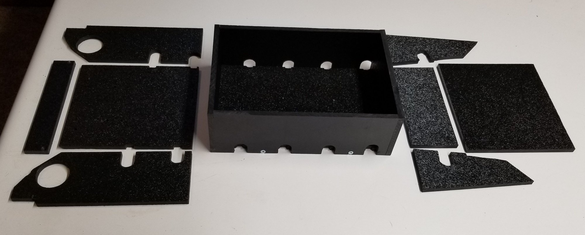

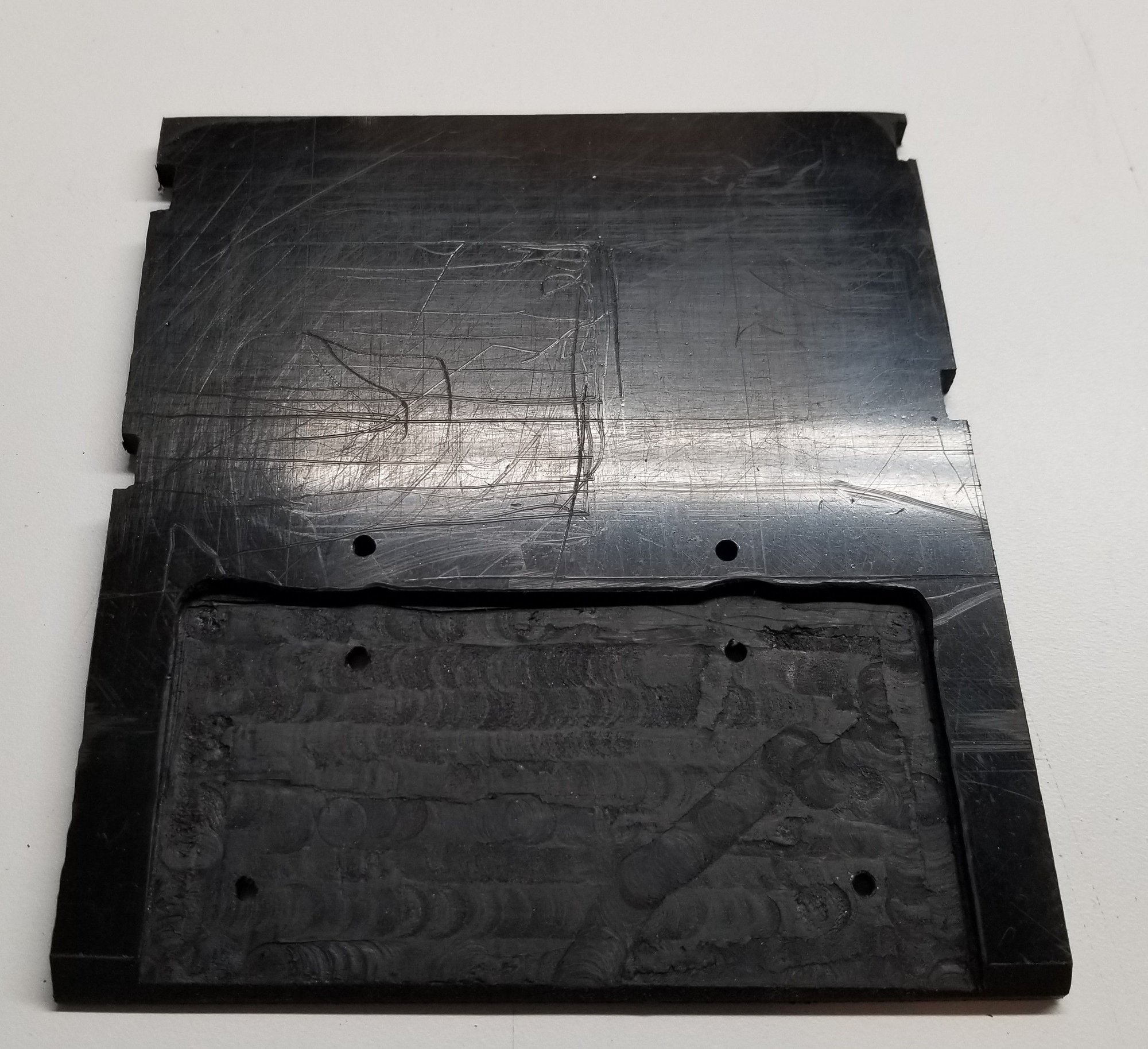

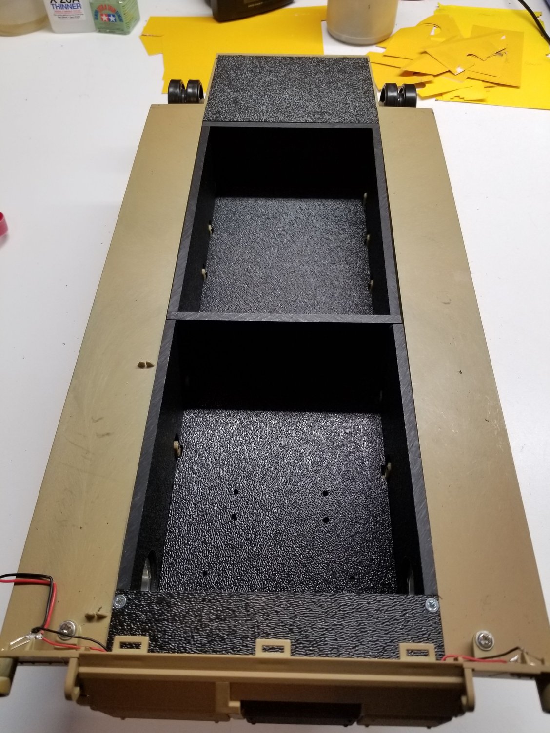

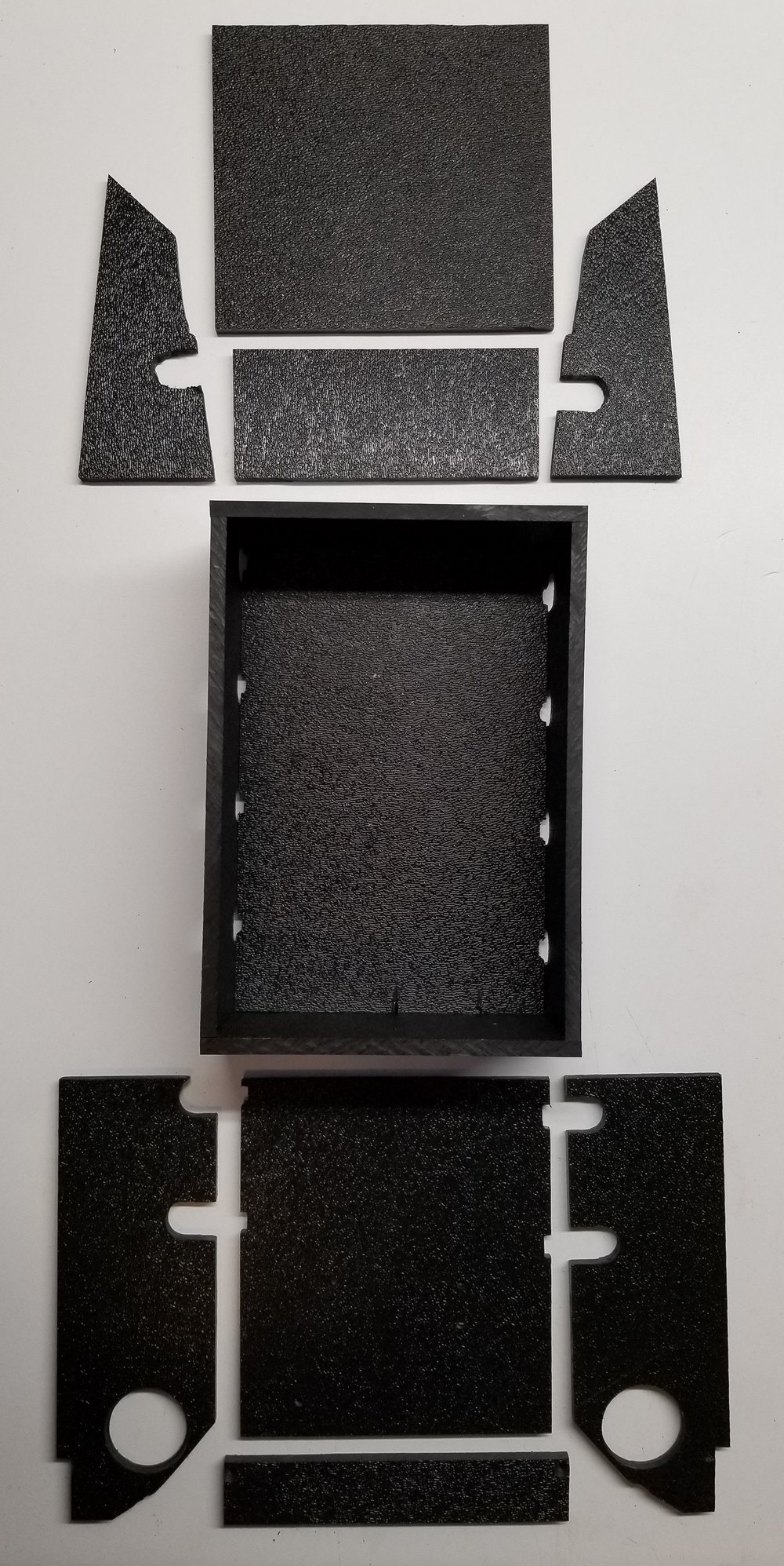

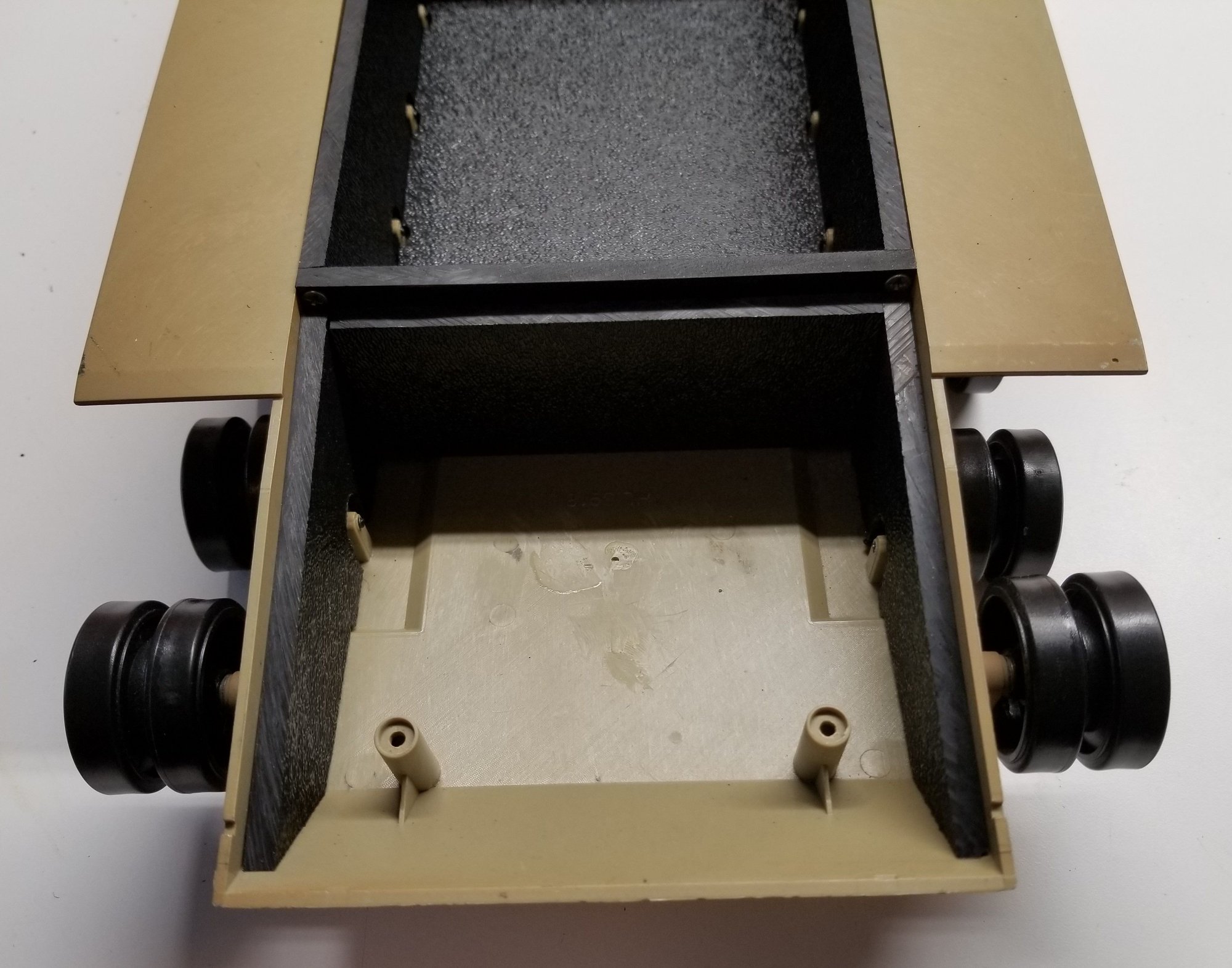

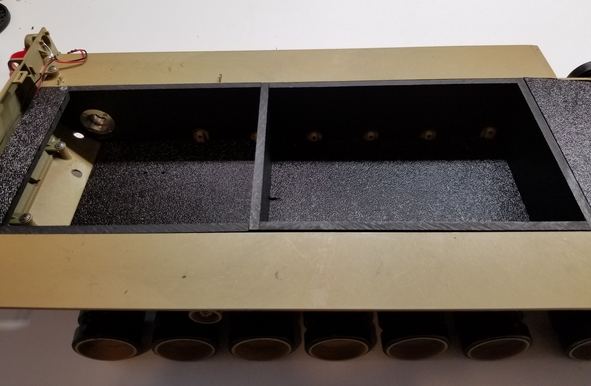

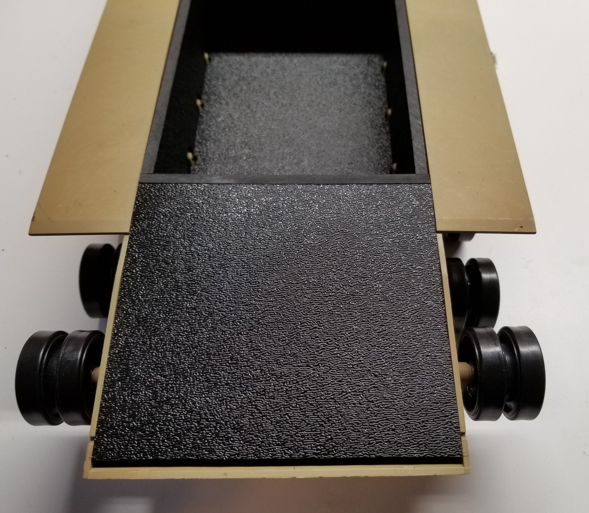

Finally had a chance to make some progress on the chassis improvements. I had a couple of sheets of 3/16" ABS plastic laying around so I decided to put it use on the tank. Made thin cardboard templates of all the pieces to ensure fitment before cutting them out of ABS. Right now everything is just dry fitted. I have some screws holding certain parts together. It makes the entire chassis very stiff. The center compartment will hold the batteries in the lower part and there will be another ABS sheet above the batteries where the electronics will mount. Batteries and electronics will be mounted with velcro. Of course some relief cuts will need to be made for the turret rotation and other things, but that's why the parts are just dry fitted and not permanently mounted. Being that I can take them out, I can make running changes when I find fitment issues. I'll probably be sealing up the suspension holes to keep the interior of the tank clean and dry. Anyway...at least it's progress...
Parts layout
Parts layout side shot

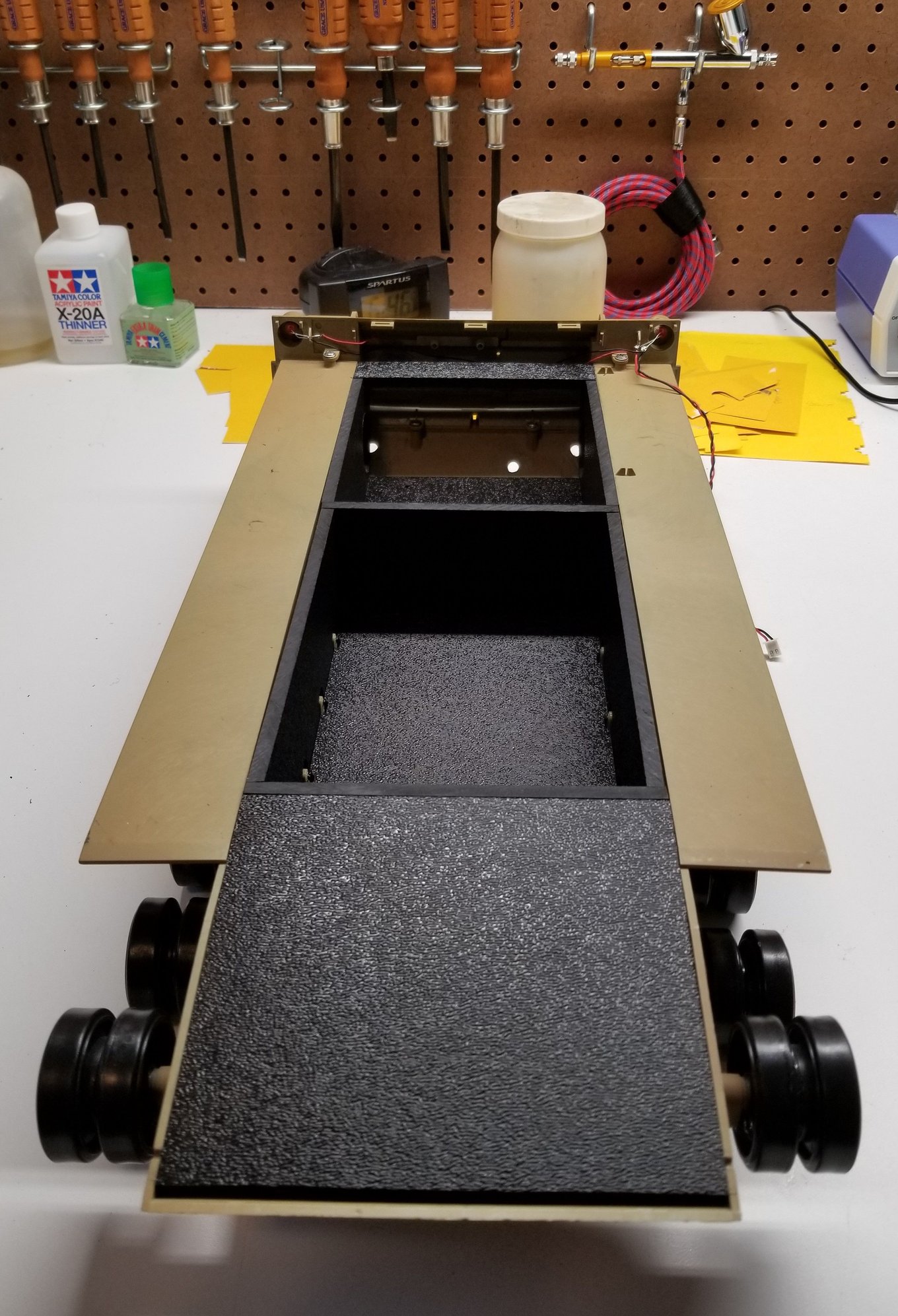

All parts dry fitted - front view
Dry fitted - rear view
Routed the bottom of the motor mount plate so it will sit even. Flattens the interior.
Dry fitted side view
Future home of a speaker
Speaker box open

I will warn ya, you dont want anything in the center under the turret above the original battery box level.
if i had this to do over again I would split my battery in half and put one set of cells as a stick down each side amd mount my ibu across where the battery door on the bottom is then the battery could be unplugged and charged in the tank from the bottom hatch, then put speaker up front. Everything i learned trying to arrange my 12v abrams the hard way.

I've been dry fitting the top this whole time also to make sure things won't interfere. Still haven't decided what method I'm going to use to attach the top (probably magnets). What specifically gave you a problem under the turret? I know I will have to allow some room below it for the 360 degree turret slip ring. I'm planning on using the metal x2 version of the turret rotation attached to the upper hull so I will need to cut down the rear bulkhead by the front of the gearboxes. Haven't quite decided yet on what I'm going to use for the recoil and elevation. Been looking at the DKLM metal one and I'm aware there is a recoil/elevation unit specifically for the Abrams (Clark?).

There are a few options for recoil units from okmo clark and dklm. Mine is clark. You need space below the turret ring for the breech and recoil servo to depress into without catching wires. My suggestion is not to have anything above the level of what was the stock battery box. This is a flat tank and hard to fit alot of stuff into , at least with a bigger battery. I also scrwed my hull together and am more or less going to leave the battery in even though i can get it out with effort.
