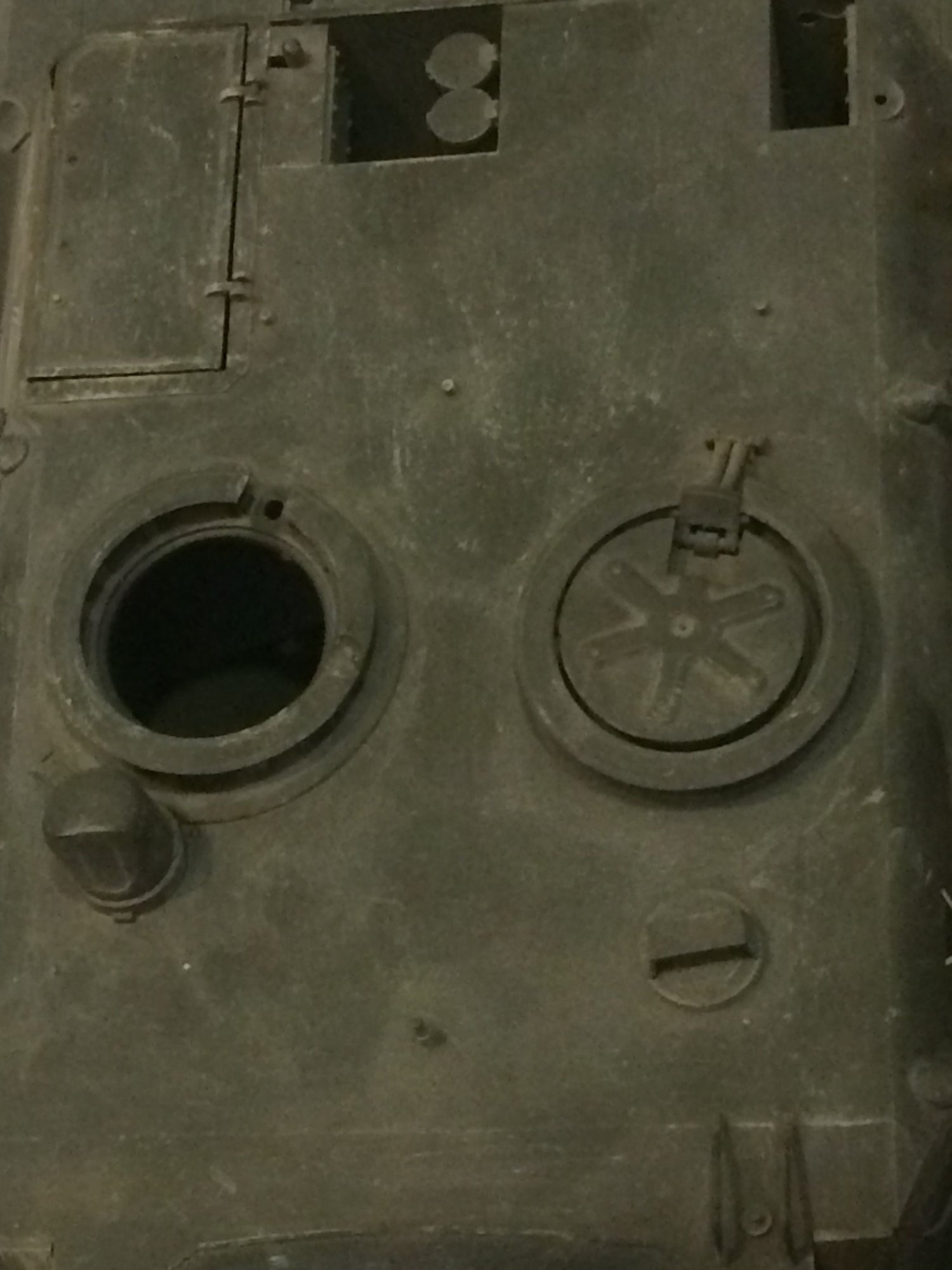

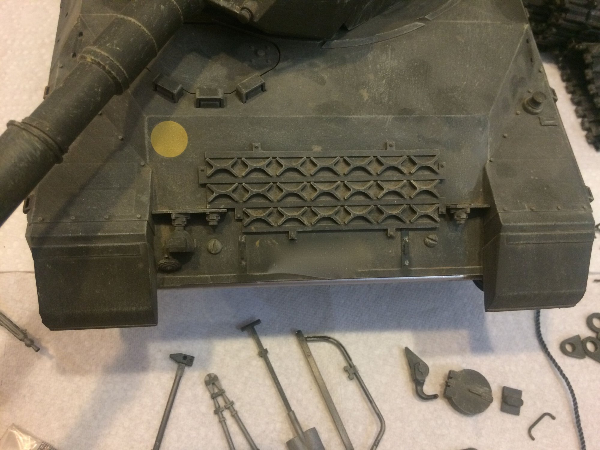

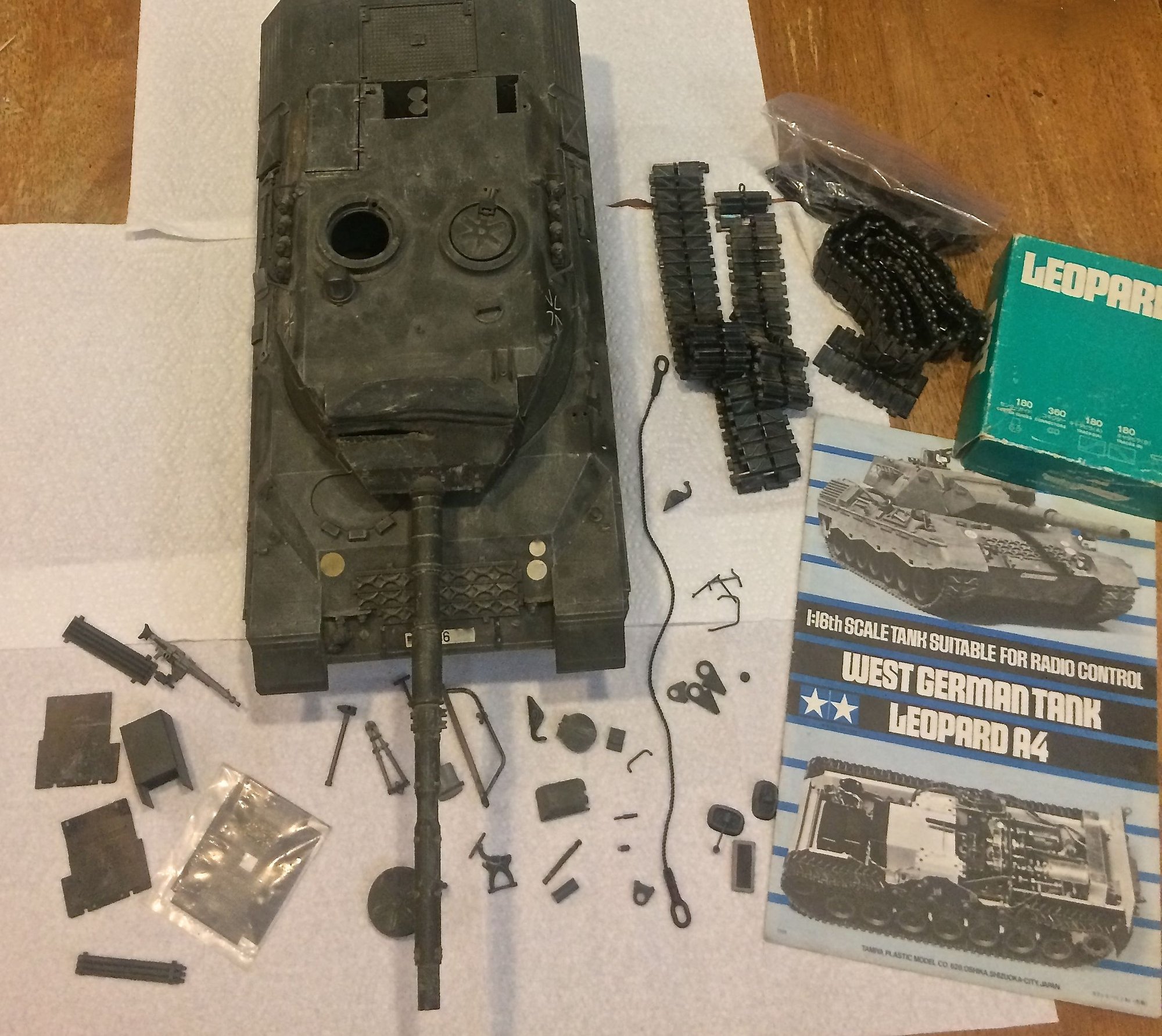

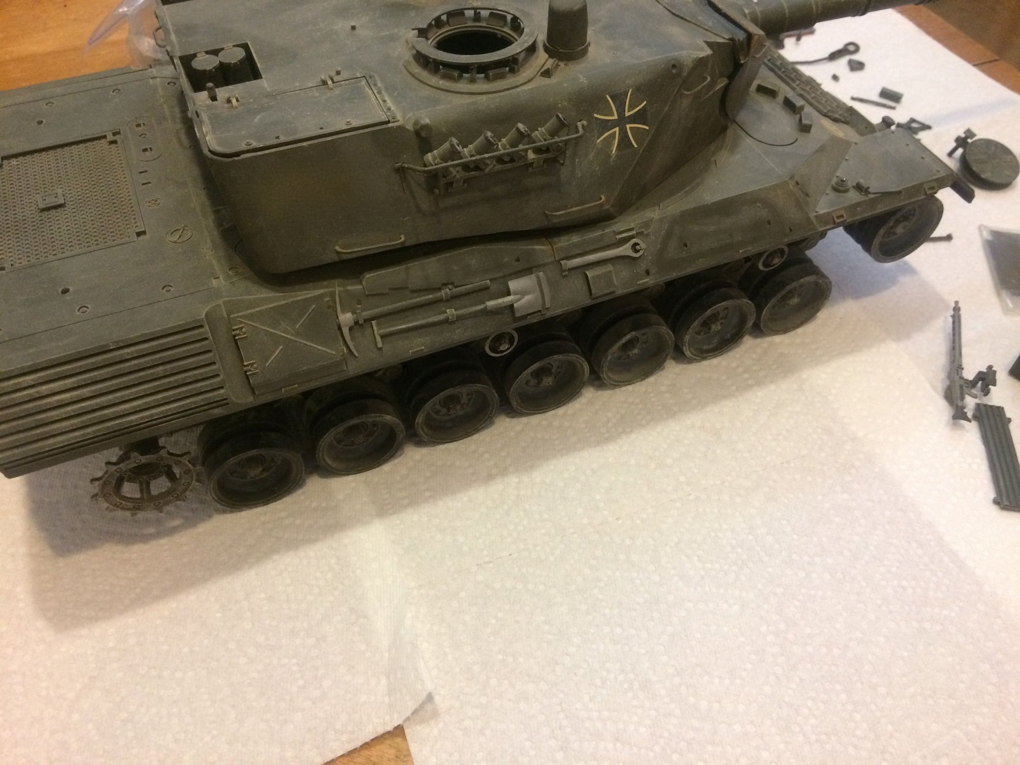

Part 1. Rescue
Well here I go again with another project to refresh and modernize a classic design. This time a late 70s vintage Leopard 1A4 that was found tucked away in the back of some garage for more than 35 years. I have wanted one for some time as the Leopard 1A4 was my first r/c tank I owned back in 1979. Due to my lack of funding and experience at the time (early teens) with r/c tanks and the limited support for r/c anything 35 years ago, it ended up running less than stellar to say the least. My first Leopard was lost to the annals of my modeling history and eventually with the exception of a few parts ended up in the trash over 10 years ago.
This Leopard was found heading for the same fate when it was rescued (cheap). It had 98% of all it's parts, a few original boxes and a complete instruction manual. It was missing only a few very minor accent pieces that can be easily replaced. Funny part is the prior owner bought this Leopard about the same time I did and around the same age I was. He too had the same difficulties as I and soon became frustrated, boxed it up and forgot about for 35 years.

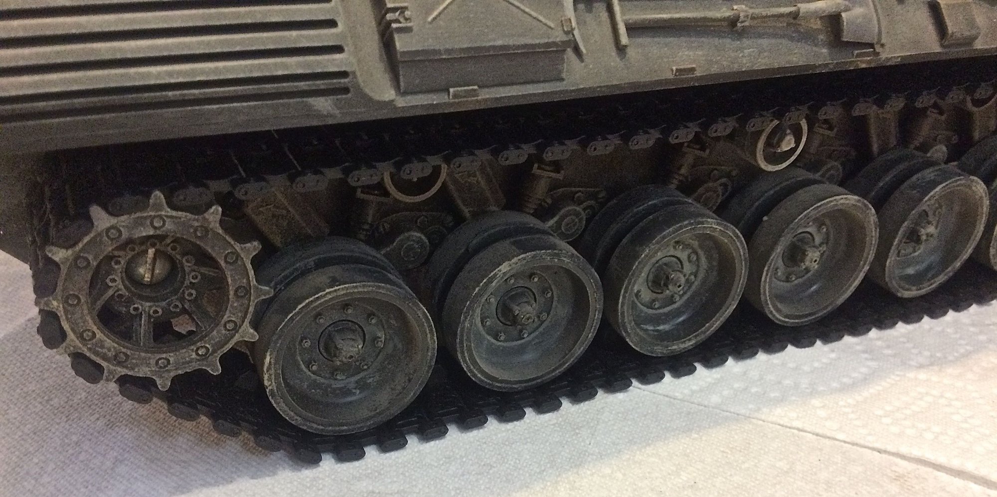

Because of the difficulties, this Leopard has seen very little run time or wear to the suspension and road wheels. The original transmission is in working order, but I have decided not to use as these have never seemed to have much life to them in all my old Tamyia tanks.
So the first phase of the refresh plan for this Leopard 1A4 is to install a new drive system either twin gearboxes or a single box set up ( your thoughts?). The track is being replace for now with HL T90 track as it fits the Tamyia sprocket perfectly and I have a bunch of it sitting in my parts bin. I am also planning to add turret rotation to the Leopard and have a few ideas on this that should prove easy enough. Once the Leopard chassis is up and running I will be starting work on the "modernization" of the turret and hull. So any ideas you might have or want to see let me know.
Here are a few photos of what I am starting with. As always your constructive input is welcome.

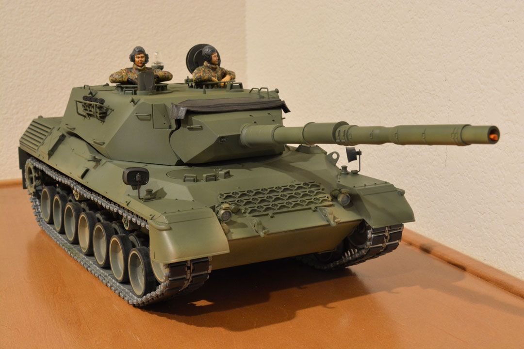

Default My Tamiya Leopard 1A4 Display Kit converted to all Tamiya full option RC IR.
Excellent runner, but not with the Kenny Kong metal tracks on, LOL.
The Henntec idler system can’t handle the weight of his tracks.
I run the kit tracks now days. All in all one of my favorites. John
My Leo 1 Build. A Daryl Turner custom one off collaboration.
Daryl designed and built the full option IR recoil turret
and f/o hull including the metal sponsons, added road wheel bearings
and metal bracing parts. I did the kit assembly, paint finish
and the RC setup for the model. I used trusty Tamiya Panther
gearboxes with ETO Armor Black Can Motors and Impact pinion gears.
