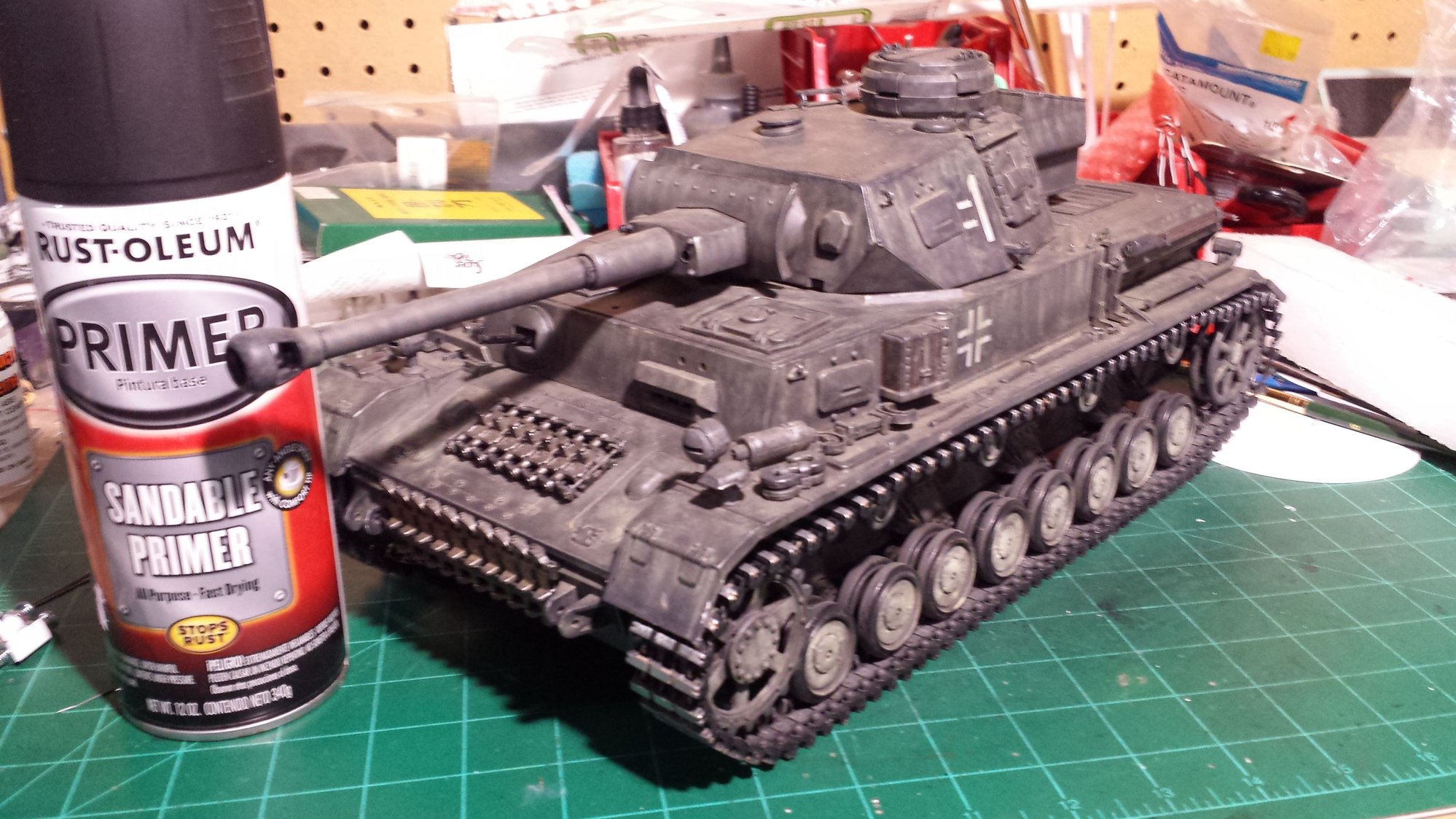

Old 01-12-2019 | 06:15 AM
Joined: Jan 2014
Posts: 340
From: Kenosha,WI
I used a primer on these metal tracks four years ago. The weathering on them is natural.
