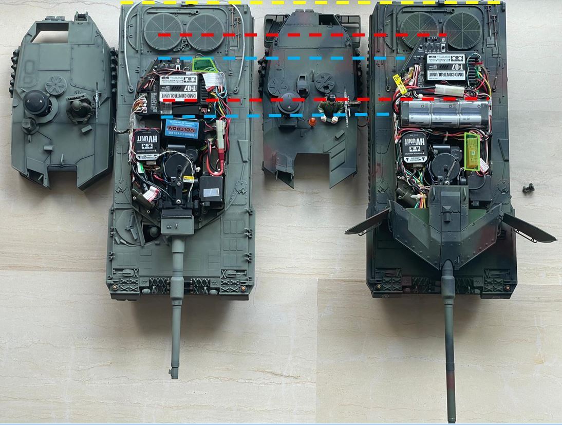

I already owned a Tamiya Leopard 2A6 but always wanted to convert it to 2A4 but studying the exterior dimensions of the 2A4 against the 2A6 in relation to the DMD T-07 electronics package quickly led me to realize that it was far from a simple exercise. Tamiya had made extensive use of the interior space, including the arrowhead cheek armour spaces as well as the extended rear turret bustle to fit everything in. In Tamiya's WW2 tanks, the DMD/MFU are located in the hull and the turret merely carries the gun elevation and recoil gearboxes, flash capacitor and battle unit, but with the Leopard the turret rotation motor, battery, receiver and DMD T-07 utilize this space as well.

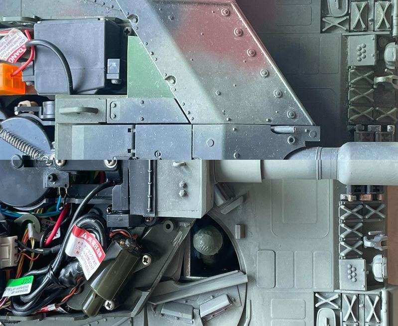

As you can see, every bit of space has been utilized. The challenge then was to figure out how to retain the Tamiya's excellent running gear and electronics while accommodating all of it in 20% less space. When a secondhand used Leopard 2A6 came up for sale, instead of cutting up my 2A6, I had my donor tank from which to perform the conversion. In retrospect it was great that I had an unmolested 2A6 to compare and study because the cutting process was extensive...... the basis of which was Christian Ludwig's 2A4 turret conversion kit. However it was intended for the Heng Long Leopard 2A6 and much more work still needed to be done to make it work together.

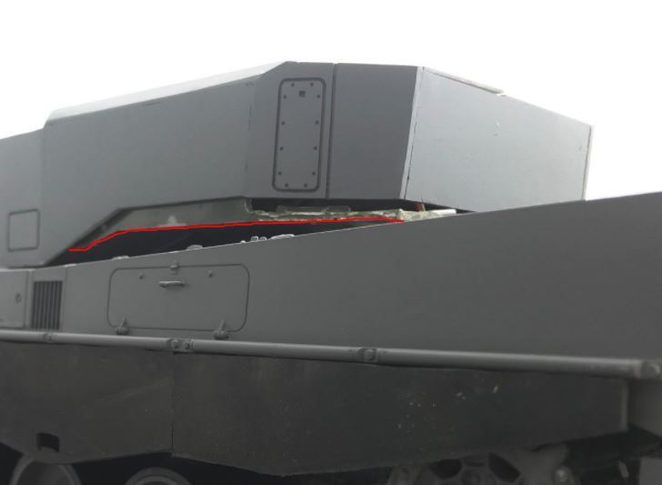

First, a bit of discussion about the two variants (correct me if I am wrong as I am typing off memory) - the 2A6 is an improvement upon the basic 2A4, where it retains the basic turret structure while addressing a number of weak points of the older tank. This includes adding additional armour around the crew spaces, resulting in the arrowhead turret cheek profiles containing spaced armour, and swing-out front side quarters. The front of the lower hull similarly gets added armour plates, with the driver's hatch being changed from a swing-type to a slide-type. A known weak spot, the targeting optics, which were recessed in the 2A4, have been moved to a pod that sits proud of the turret top deck. Side skirt configurations were also changed - while I know the 2A4 uses heavy rubber side skirts, I am not sure but suspect they changed over to steel plates.

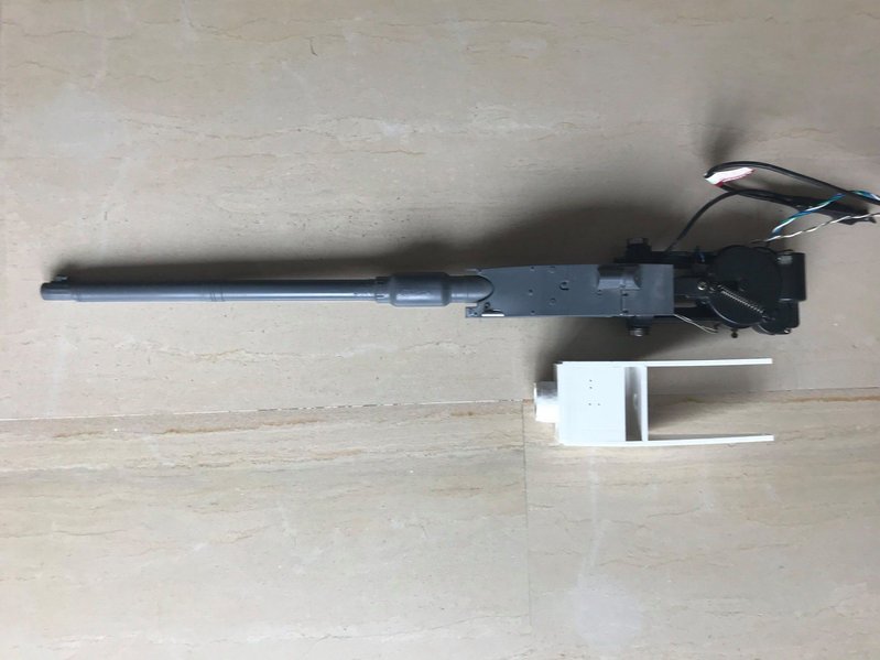

All this is great for the 1:1 tank, but when it came to the 1:16th scale tank, I was faced with a problem. Tamiya designed their 2A6 as a 2A6, and did not take into account the tank's internal dimensions. As a result electronics, wiring, and components used up the entire internal volume of the model - not good news if you need to make all that fit within a smaller space. I quickly figured out what space I would be losing:
In a nutshell, the T-07 DMD/MFU needed to be moved - the wiring for the motor cables and the gun barrel strobe unit needed someplace to go; in a normal 2A6, this was already a challenging task to manage nicely without the dreaded turret sag. Even the optical instruments droping into the turret spaces was critical. With much less volume, it was looking quite impossible!
To be honest, when I started cutting into the turret, I didn't have much of a game plan, except that I might have had to relocate major components into the lower hull by sacrificing the speaker box. Sometimes, instead of planning, you just needed to take that first step!

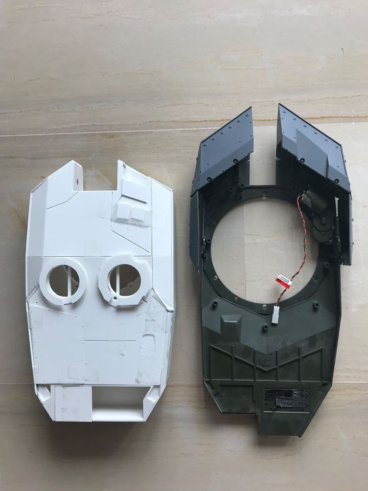

As shared, the turret is one major identifying feature that separates the Leopard 2A0 through 2A4 from the 2A5 and 6. Here are some of the major differences and implications for a RC tank conversion. Note that Heng Long uses an entirely different internal layout, so these challenges are quite unique to Tamiya - yellow is the reference line, with red being the stock 2A6 internal layout and blue being the 2A4's revised layout. Green highlights the relocated radio receiver. Everything aft of the recoil gearbox had to be shifted forward, except for the receiver, which went into the notch next to the power switch. In this photo, I have used a 1350mAH 2S LiPo in order to fit within the reduced volume, as the consequence of shifting things forward was that the battery compartment suffered. Gotta do that, or else the tank is not going anywhere!
In this photo you can also see the obvious difference of an L/44 120mm gun as opposed to the L/55 on the 2A6.

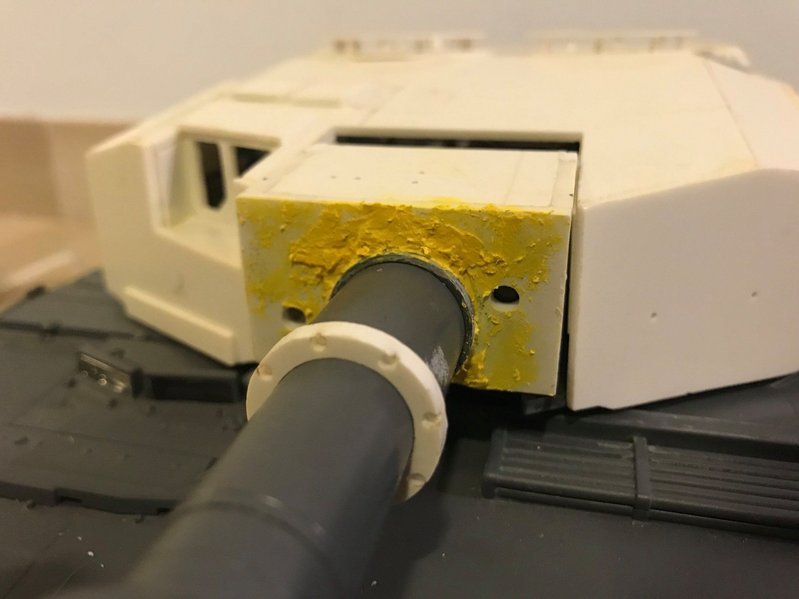

Next up - the mantlet. You can see from this split image that with the entire removal of the arrowhead spaced armour, the base of the turret is exposed. In addition to that, the C-shaped turret portion that surrounds that arrowhead mantlet has also been deleted. This meant using the Ludwig gun mantlet. It is intended for the Heng Long 2A6, and required extensive modification for it to ride on top of the Tamiya gun barrel carrier. I modified the carrier itself, as well as thinned down the Ludwig mantlet before filling in the gap with 2-part Tamiya putty.
Next up, the front arrowhead spaced armour, which is attached to the lower tray of the turret, is cut off with a dremel wheel, using Tamiya's handy panel lines as a guide.

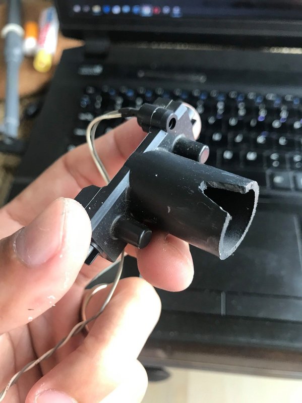

With the mantlet change, the handy mounting spot for the IR LED is also lost. Given the diameter of the 120mm I bought the Tamiya KV-2's sprue for its clip-on IR emitter. The 2A4 mantlet is also wider than the 2A6's and necessitated cutting a notch so that it would clear the gun barrel's pivot. I reckon that the mantlet took up the most time as far as the turret part of the conversion goes.

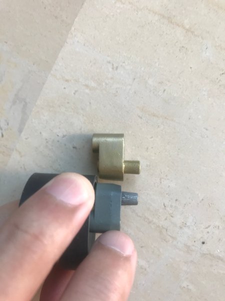

The Ludwig 2A4 conversion kit is intended for the Heng Long 2A6. The Heng Long turret carries very little components compared to the Tamiya, in addition to the required elevation and recoil gearbox which both have, Tamiya adds a battery, a HV flash unit, the large T-07 MFU as well as receiver. In addition, the angles and positions at the blue lines shown below were different, and required additional cutting and filing of the turret base pan in order to fit.
Along the turret sides where the smoke grenade launcher racks were, they didn't match well, necessitating the grafting of addition thin sheet styrene to extend coverage. Both sides had the same problem.

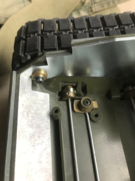

The tank came with some nice upgrades from AFV - suspension reinforcement, shafts as well as hull brace. The suspension arms and track tensioner was from Impact, and the tensioner was incompatible with the AFV hull brace(more on that below), so the owner lopped off the front bit. As I had another Leopard 2 with the same hull and tensioner setup, I knew that the AFV tensioner kit would work with their hull brace and set about ordering replacement parts as I like my tank complete.
This is what an unmodified end plate should look like
This was what was done to fit an Impact track tensioner
The reason is because the standard sleeve is too short to accommodate the thicker plate as well as the plastic tub. Thus the left side piece is required.
Some emails and a lengthy wait of two months from AFV in the summer of 2020, (remember COVID brought a lot of freight disruptions even if it was shipped via DHL) and I had my replacement end plates and adapters.
I had a second surprise though, as the adapter I got was intended for older versions of the adapter that had a tapered profile. The AFV tensioner I purchased was improved and had a square profile which I feel provided a more positive interface during installation and reduced chances of stripping the splines during installation. In the end, I resolved the drama by swapping my brand new tensioners with a friend that had the older version.
Home and all together again. Note that the front glacis features a brace that is now restored to tie the front end together.
