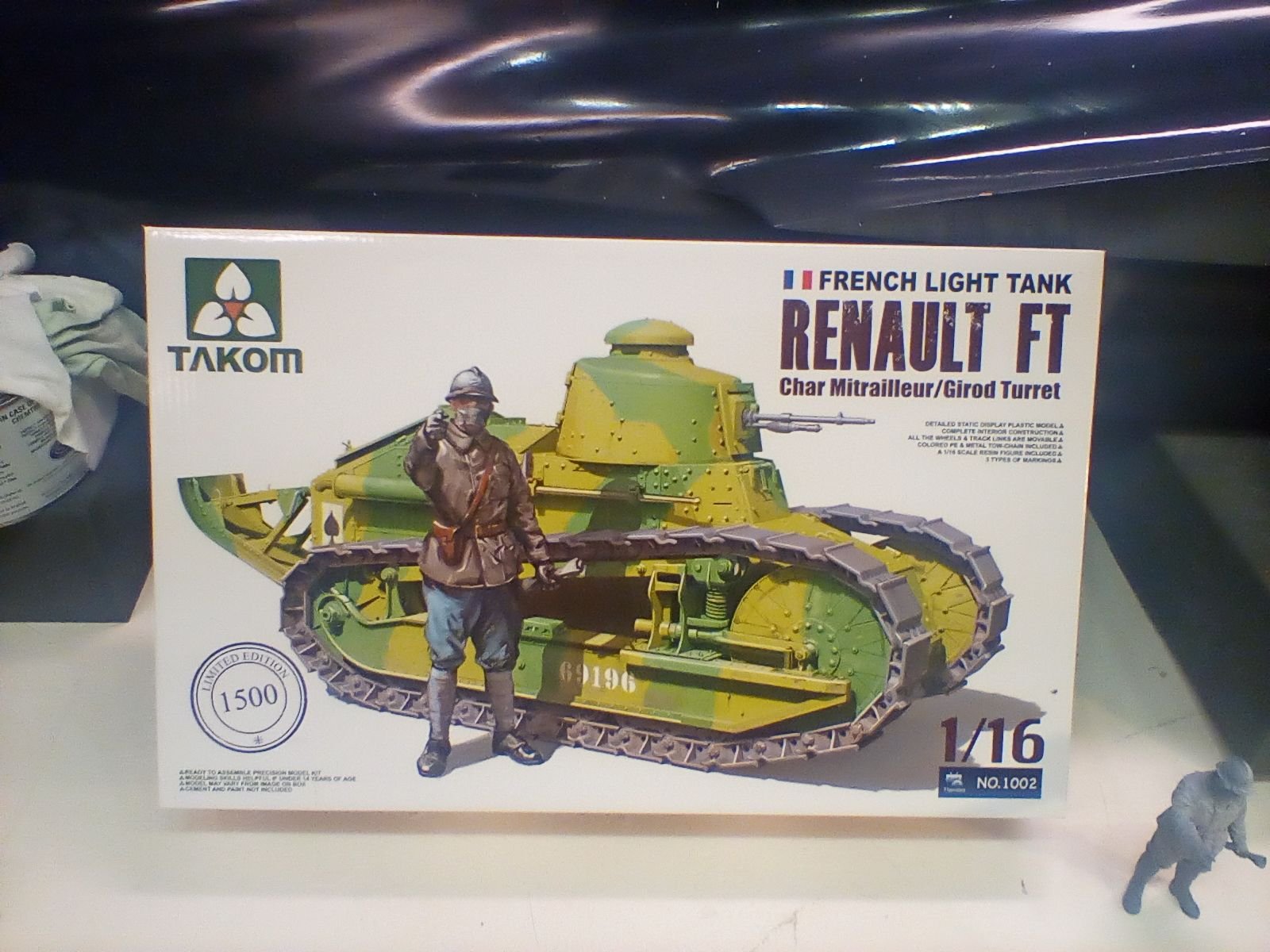

I am currently trying to convert the 1/16Renault FT kit to R/C. I built up the small dual motor Tamiya gearbox and it will just barley fit. My question is this, I need a small proportional speed control for the thing. I thought about buying that tiny 1/72 R/C tiger and robbing the parts from that but it is not proportional speed, it's either "on" or "off" when it comes to the forward and steering.
What is out there in the way of tiny circuit boards that will allow me have a realistic speed and steering of this thing?
Larry
