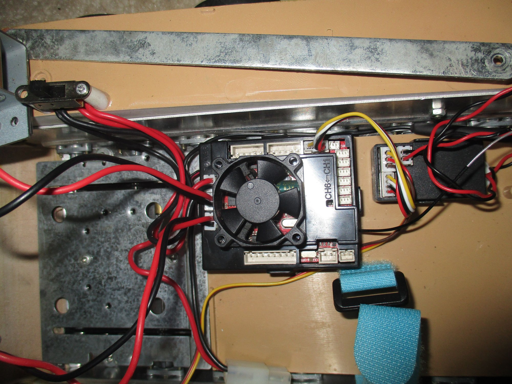

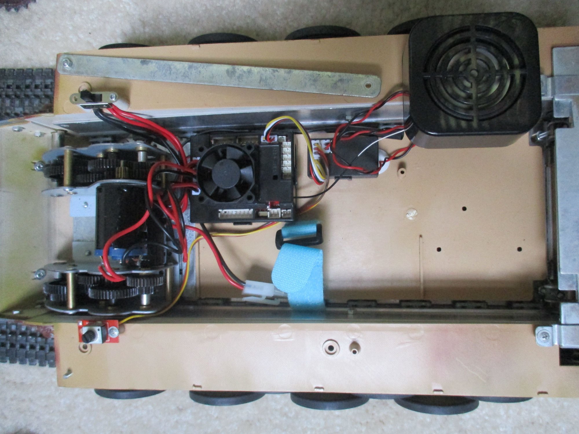

Here are some pictures (and a peak at my paint job)
Peak at Paint Job
