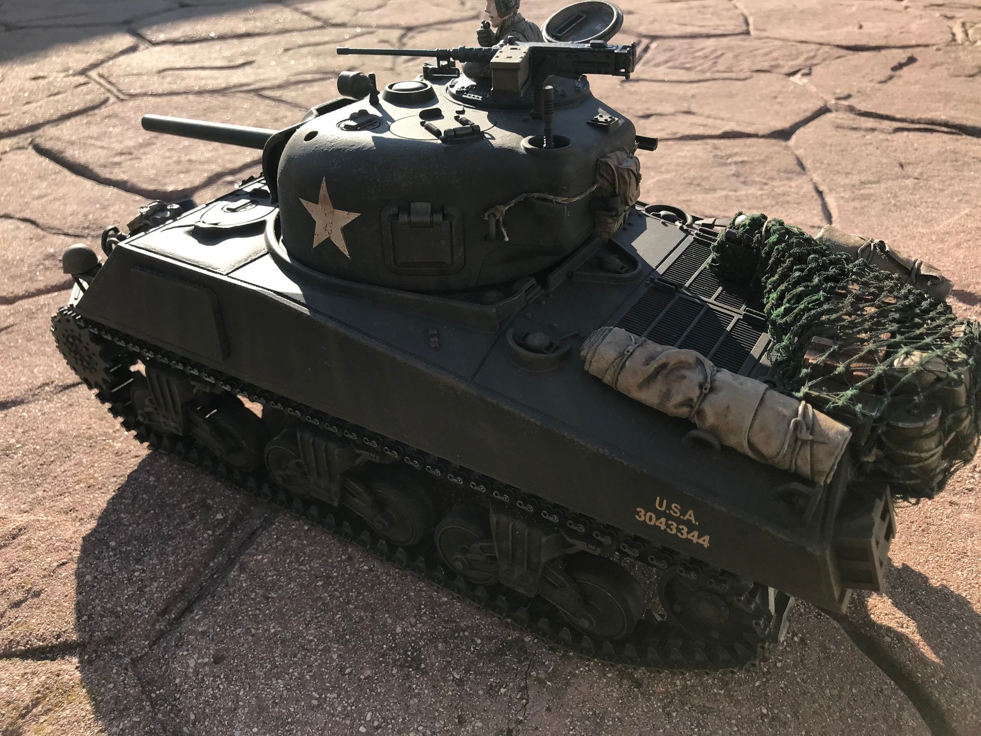

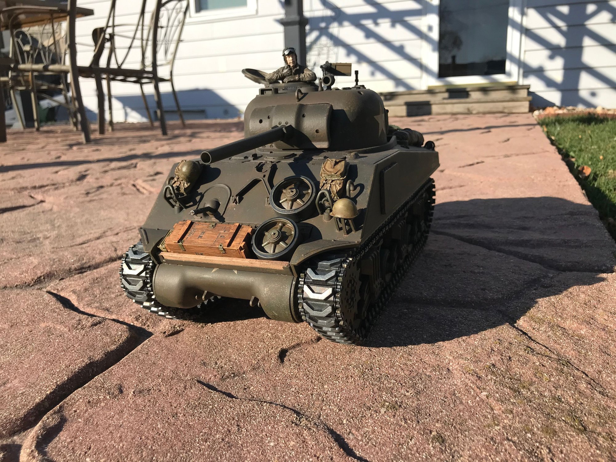

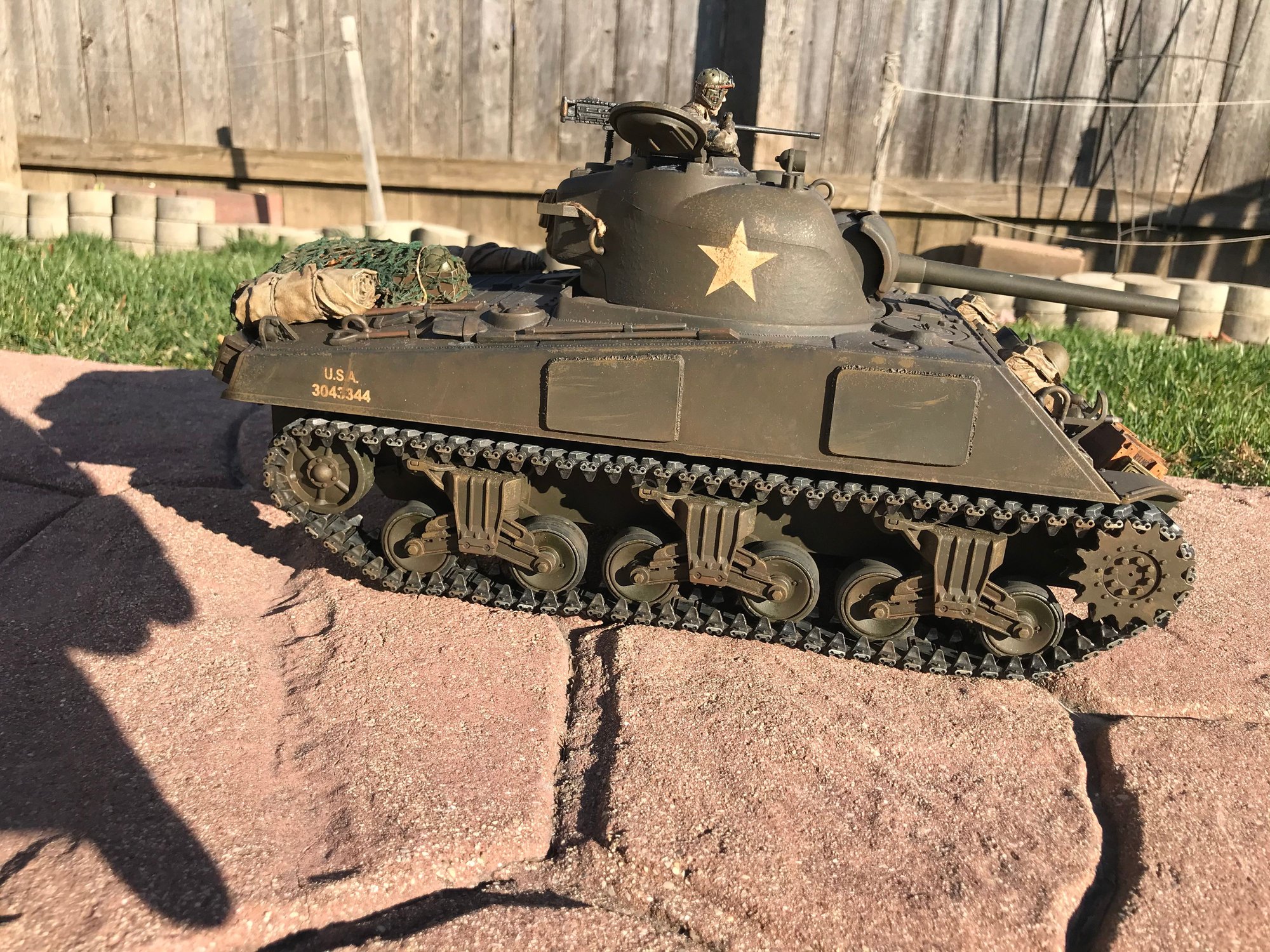

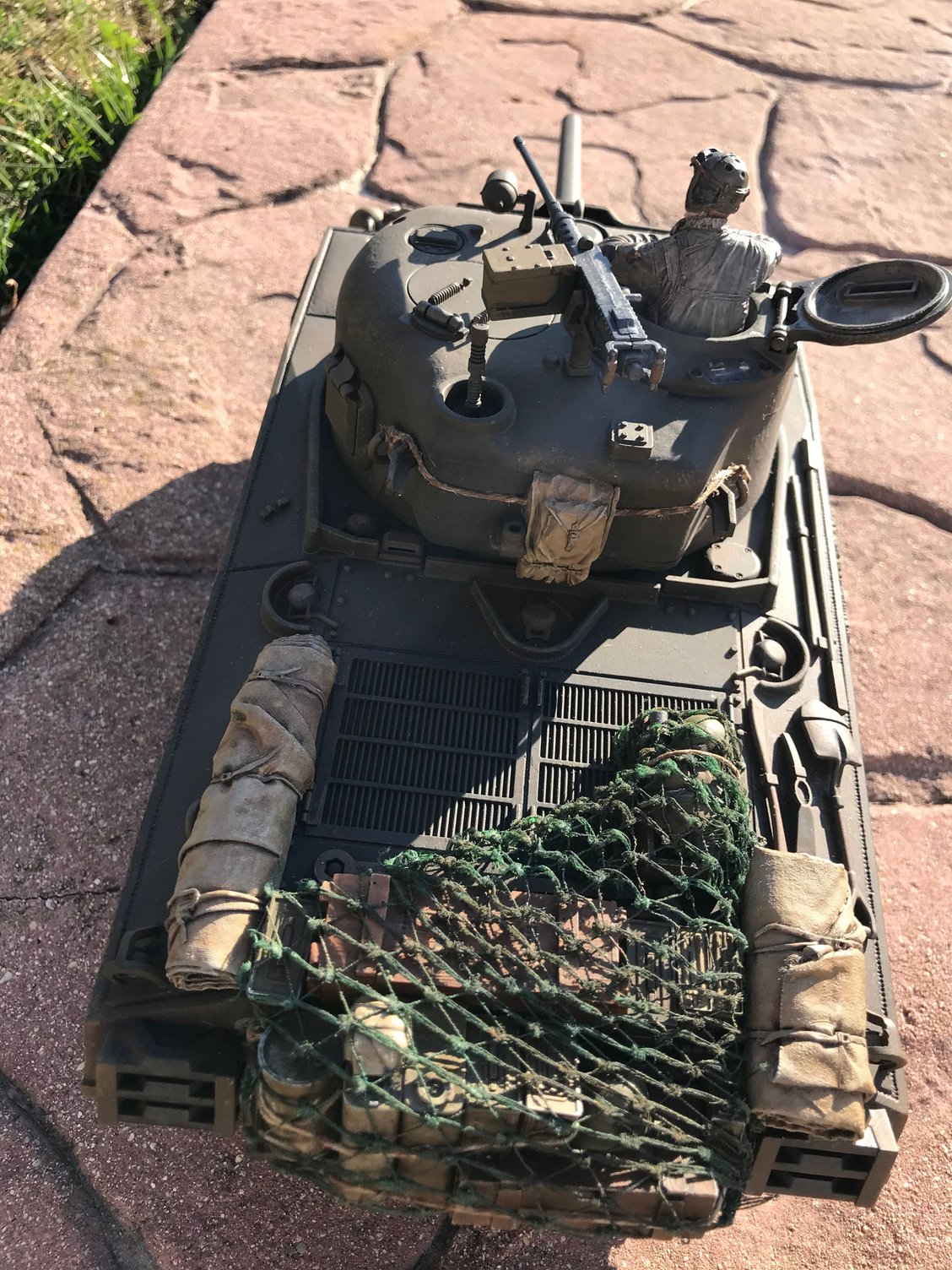

Posts: 19
From: Kenosha, WI,
Default Thanks for the help. constructive criticism appreciated.
Old 11-14-2020 | 10:42 PM
Kear-Skof's Avatar
Joined: May 2018
Posts: 62
Received 7 Likes on 6 Posts
From: Montana
Looks pretty good, where did the net on the back come from?
Old 11-15-2020 | 03:19 AM
Posts: 19
From: Kenosha, WI,
Thanks, All the stowage, net, rope and the tank commander came from "https://dgsselkirk.wixsite.com/dgsmilitaryhobby" Saw the kits on a Facebook page 1/16 rc tank

Old 11-19-2020 | 10:44 AM
Joined: Mar 2020
Posts: 125
Received 22 Likes on 18 Posts
From: Illinois
Love the wooden box on the front. Very realistic looking.

Old 11-19-2020 | 05:03 PM
Posts: 19
From: Kenosha, WI,
Thanks. I'm happy with it. Almost didn't want to put the net on but thought it looked better with something holding it all on the tank.
