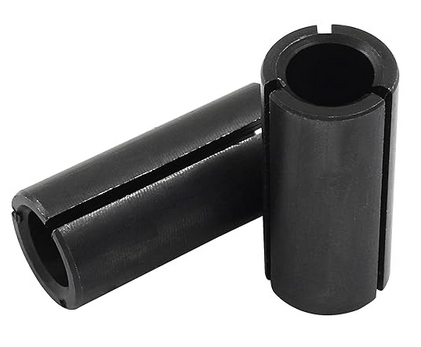

The goal is a low profile system, so I chose the hollow slip ring with a 12.7mm hole, because it is easy to find 12.7mm (1/2") to 8mm sleeves. They are used to adapt US 1/2" routers to take 8mm bits. This way the hollow slip ring fits over the sleeve attaching the 2 8mm shafts.
So I welded the sleeves to the 8mm shaft I bought and mounted a Rigid flange with a 8mm hole.
