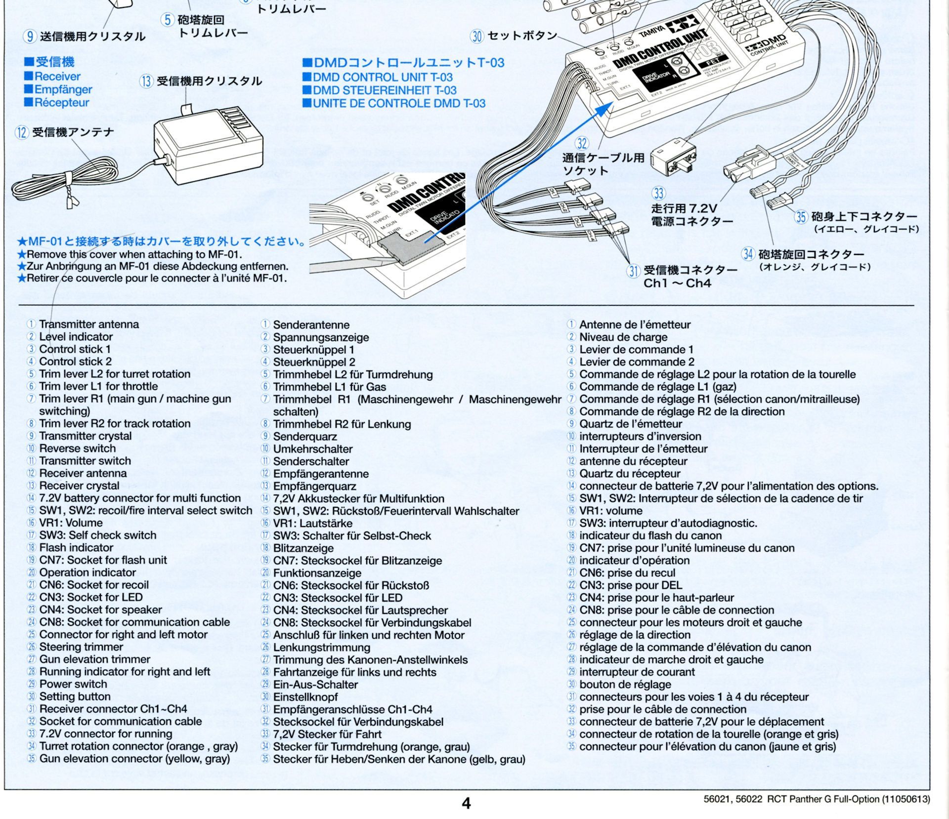

Hello All
Hoping someone can help, I built my first King Tiger 1/16 in the late 80's, I brought the 56018 a few weeks ago and have been painting and building it gradually, I came today to power the hull up and test the ancilaries but have found the communication cable between the DMD and MF-01 missing, does anyone know where I can locate one or can someone give me the pin configs (are th 1 to 1 or is there a swap over)
Many thanks for any help anyone may be able to give
Neil

Have you looked on the AFF Tank Museum web site they have one still listed for the Tiger there the same cable .
RC Communication Cable: 56010
Jimmy

Jimmy beat me to it Neil, that is the cable you want.

Thank you both, do either of you know what the extra 2 connectors comming from the DMD are ?

Turret Rotation - Orange/Gray
Gun Elevation - Yellow Gray

I thought Those connections are on the mf controller

I think they were for extra add on's in the future witch never happened Tamiya built new DMD units like for the Leopard 2A6

The Elevation and Turret Rotation connections are on the DMD # 34 & 35 in the manual.
