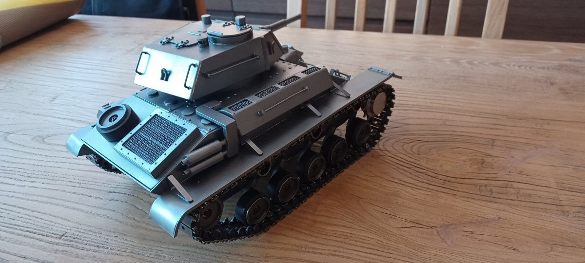

The T-80 is almost ready for getting th ehull primed. A degreasing and a scrub with a brass brush will be all I will do. I need to get it primed before I can fit the running gear so its a bit of a priority at th eminute.
I see now that I forgot a headlamp (as usual) and a spare wheel mount on the rear. I will do them tomorrow.
The big bulge on the front glacis was a hassle and I had resort to filler to get the curvy shape. Such is life I guess.

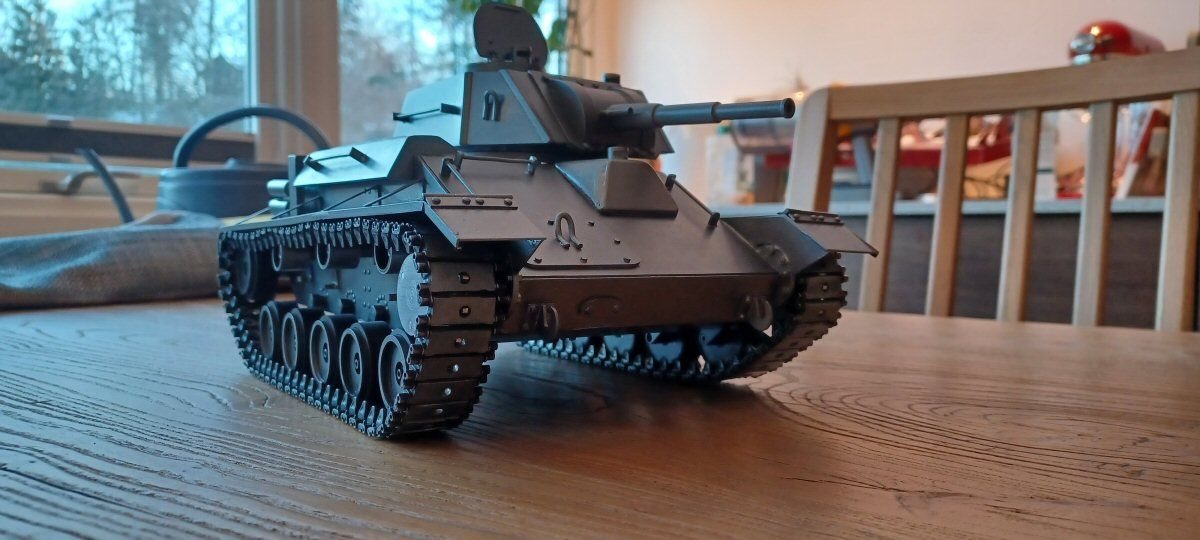

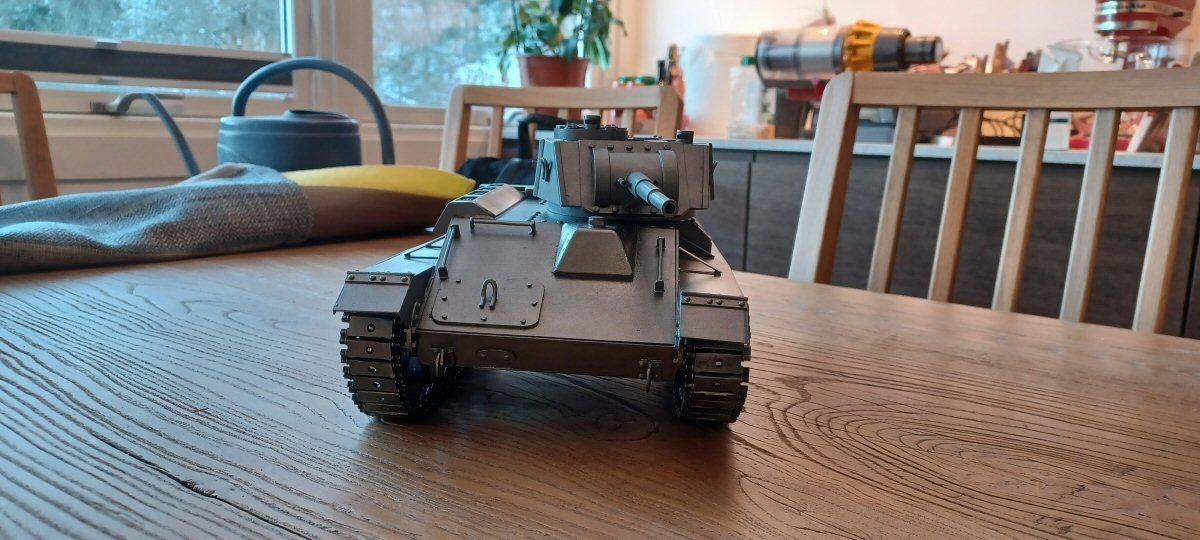

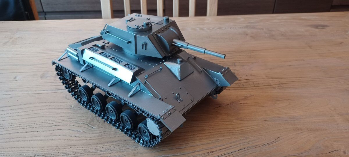

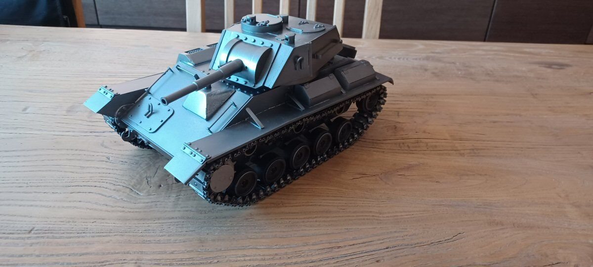

This cursed tank has been back and forth between the bench and the shelf too many times and survived renovations and losing some bits. But I resolved to finish tot over Christmas and I did. Not perfect at all but unique in this scale I reckon and I still....after all this time...like all the towel rails they distributed over it. Plus, it has a nice place in Soviet tank development history and for that it was worth the build. Have to paint a bit to touch up some scratches but I will get to it. Charging points and switches mounted under the rear vents which are held on by magnets. And a happy new year to all!
