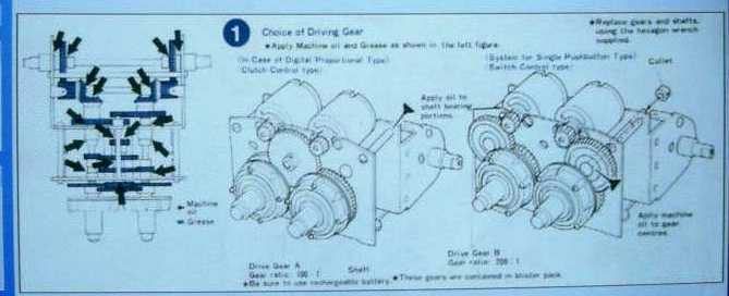

If its clutched, its an RT1601 aka 56001, the first Tamiya RC tank. It shares most of the same parts with the 56005, except it got a revised set of gearboxes (The first DMD units, now called type One DMD gearboxes) Would love to see pics of the beastie.

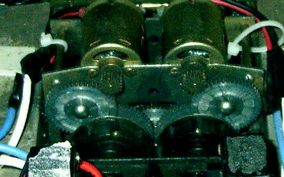

the real tank has clutch and brake. but old tamiya ones only had clutch. that means, even one side is disengaged, but it is dragged along by the moving track because there is no brake. I tried brakes on disengaged side, it worked fine. tank will drive just like real tank.
your clutch gearbox has two motors too, you either can set it up with one big gear in the center or two smaller gear on each side. that way, you can use the old sherman gearbox to be controled by DMD unit. the only modification is to cut the chuncky clutch head, tricky there though.

you will have to tell me more about clutch removal because I just got unlazy and found the 2 motor tank controller on ebay and bought it. have you seen reference to changing the large drive gear to separate gears? i thought it would be possible but there was no reason to go be contemplation. now I must! came to 77 $ cad 62.50 U.S. any help !?!
