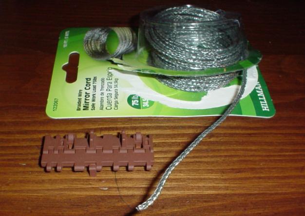

For the cable itself,try going to Lowes or Home Depot and find the section that has hardware for hanging pictures and mirrors.
"Braided Wire,Mirror Cord made by Hillman"
For the loops? Good question,havent figured out how to homemake nice ones myself.....need very small swage kit.
I tried using heat shrink tubing,but it doesnt look right.

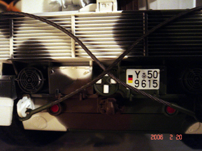

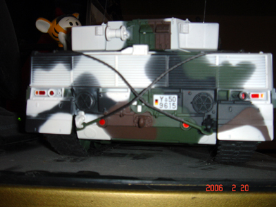

Here are a few photos of my stock Leopard.

Stock Leopard, stock cables. Just an extra touch added by the manufacturer to the Leopard, as well as the light kit.

I ended up going to Ace Hardware and found a Hillman product that very closely represents the Tiger/King Tiger cables! It's called Multi-Purpose Wire 20/6 Steel 100ft Wrap-Pack, Item # 122070. The size is very close to the overall diameter of the wraped tow-cable wire. It's kinda' stiff, but bends and holds shape pretty well.
As for the ends, I found some oversized pieces, which are called "thimbles". These are the cup shaped end pieces over which the wire wraps around on the ends. I couldn't come up with the proper term(even though Brim mentioned thimble) and after finding these, I now know what a "thimble" is. Anyway, like I stated they are a bit oversized, and I have instead cut the ends off the plastic cables and attached them to the steel cable ends. This will do for now, until I find the right sized "thimbles". [8D]

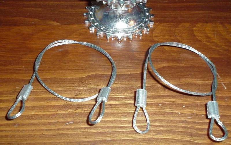

This is what I have come up with(so far)
Hillman wire and cable crimps from the nuts and bolts section(both from Ace Hardware),not exact,but close!
They will also hold a shape pretty good!

The above cables are very strong for their size.When you crimp using a "Klein Tool"(used to crimp electronic splices),the aluminum colars embed into the mesh of the cable.I could not pull them apart by hand.
