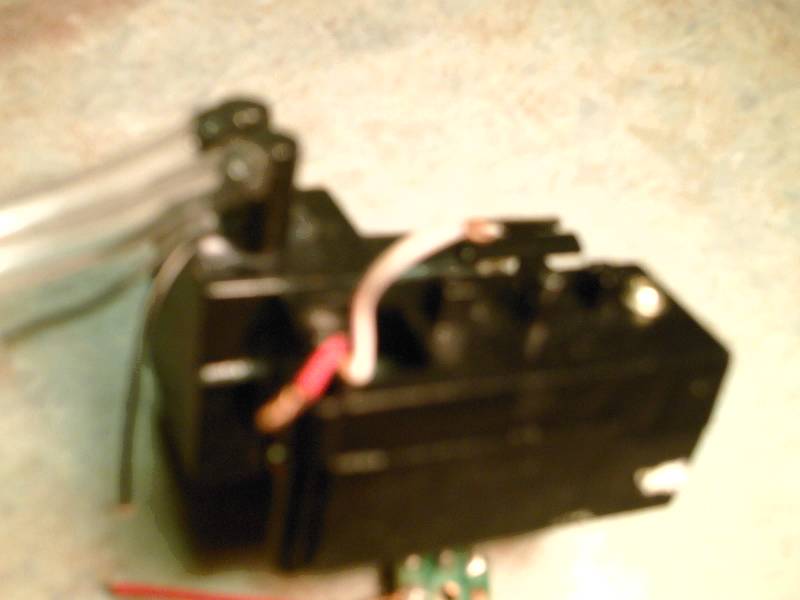

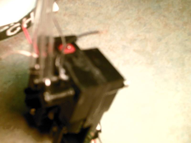

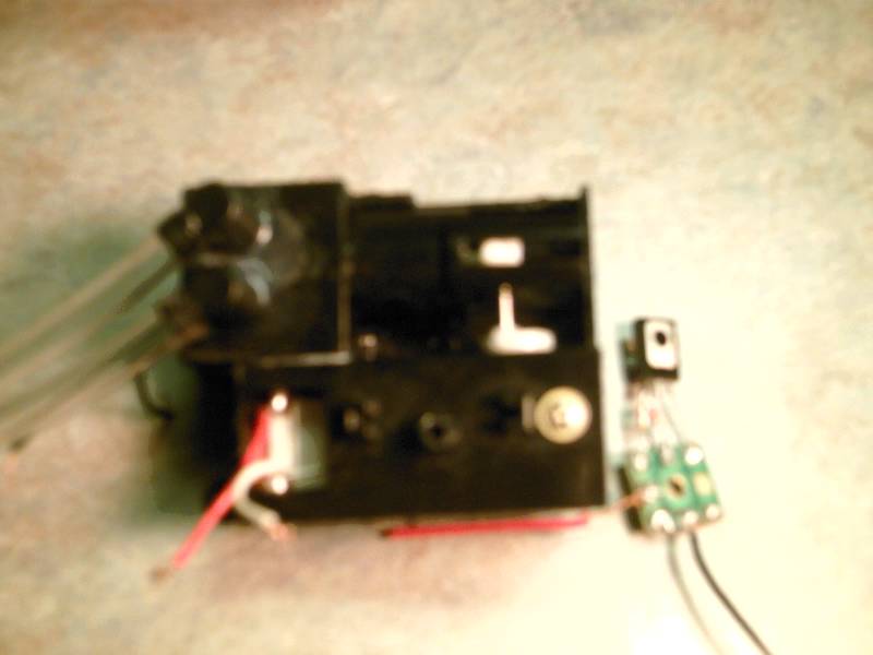

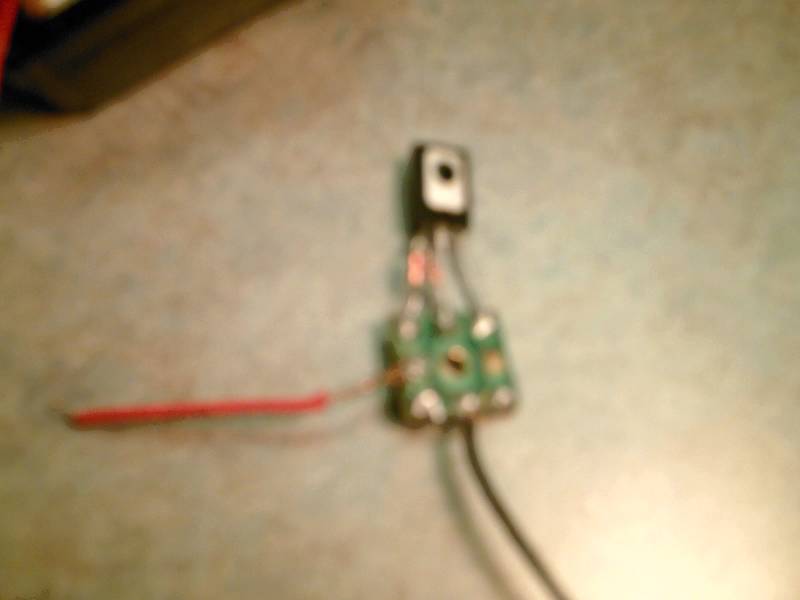

I have been considering putting a HL smoke unit into my Pershing tank, so I took a pretty close look at the one that I have. It seems as though there are two wires that go directly into the reservoir where that aerosol goes. I think that the heat from the wires themselves are what vaporizes the liquid and produces the "smoke".
While experimenting, I hooked my smoker up in the tank and got the pistons moving, but it produced no smoke because I had not connected those two wires to the little, square (I guess it is some kind of relay) that mounts on top of the smoke unit. That little rascal burned my finger! To tell you the truth, I'm kind of afraid to have that hot thing exposed inside of my precious tank because it might catch something on fire. [sm=stupid.gif]
I would cry.
An then curse! [:@]
And then have to replace a lot of plastic. [sm=tired.gif]
I'm skeerd!
Jason

Focus! focus!
I still could not see anything after i put my glasses on.
thanks,tom[8D]

SORRY! It is a very cheap camera and the focus does not work well. [:'(] When my wife gets home, I will make her take a few pictures with her phone.
Jason

i cant see anything. what am i looking at?
