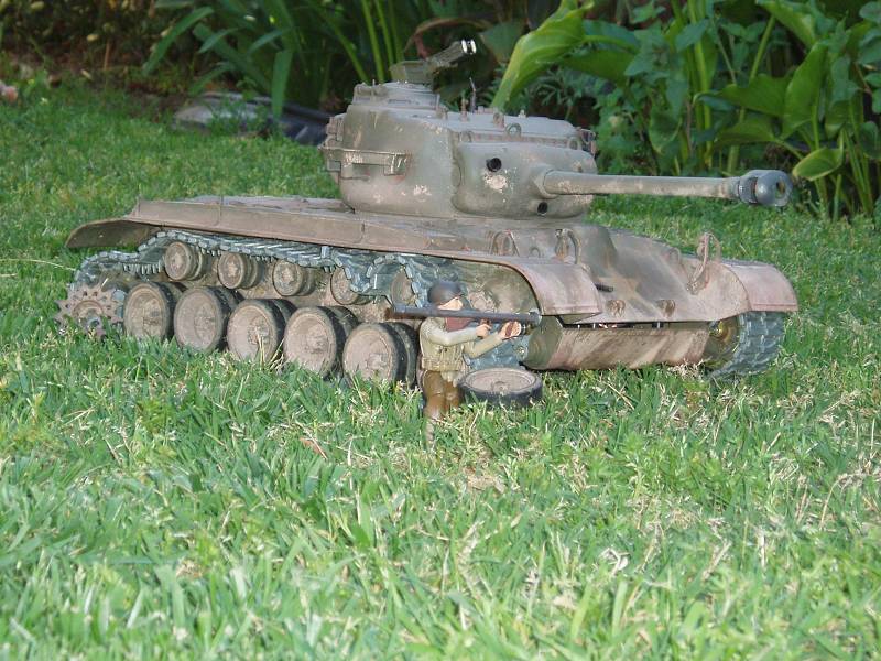

I just opened up the HL S/S pershing, and copied all the wiring(after scrapping the original T34 electronics)
Nothing is labeled on HL boards[&o]
It is not easy to do,take notes,pics etc. of all wiring BEFORE you tear apart(lots of notes).
If you do not know what you are doing.......put it aside and find your answer BEFORE continuing.
Be careful, and just ask for help as you need it(on the forum or PM any of us who are willing to help you)
Also, not a whole lot of room for smoke unit + its messy,so I skipped that part.

Love that t34! Nice weathering!! I know what you mean . . . there's something so tankish abouth these t34's . . . now for your viewing amusement . . . two pics called "Road Rage on the 38th Parallel" . . . "Hey!! Do you have auto insureance!!"

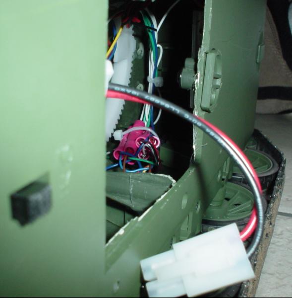

Hi Sownare, Jstrat121. I Received The Tank Yesterday And I Am Pleased With It...
However I Have A Few Problems With It. When I Drive The Tank Over Ten Feet Away
The Tank Judders For A Couple Of Feet And Then It Stops Altogether? I Then Have To Walk
Over To It Before It Starts To Move Off Again, Did Both Of You Have This Problem?
Also Could Either Of You Please Post Some Pictures Of The Modfiyed Battery Compartment
Including Where/How The Female Tamiya Plug Is Fitted...
As I Reckon Keep Buying 8 Batteries For The Tank Will Eventualy Become Boring[&o]
Plus Any Other Mods Will Be Appeciated As Well!

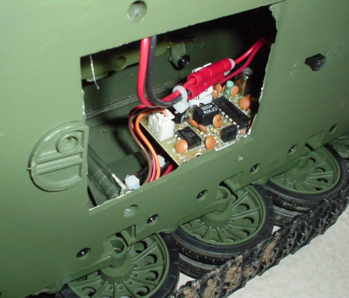

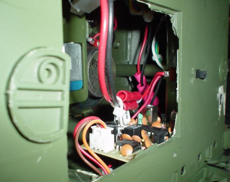

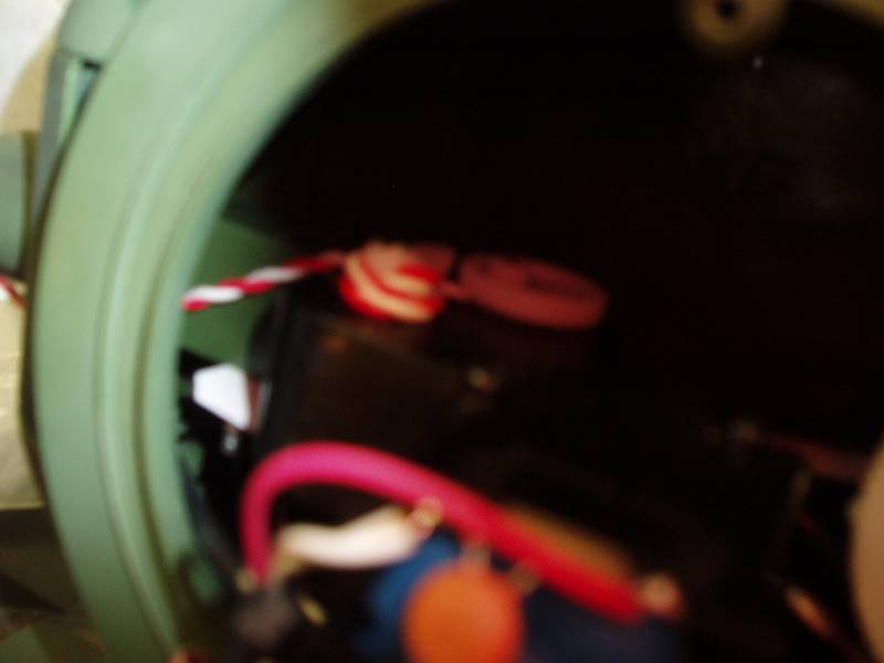

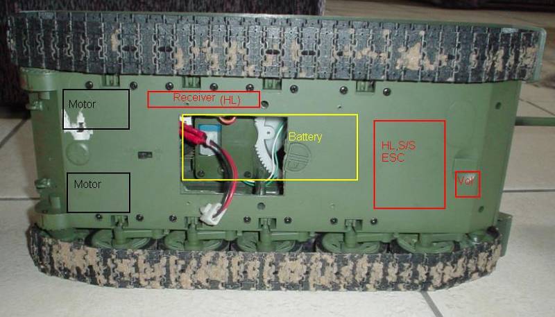

My t34 is running real good right now,I really hate to take it apart if its not broke, as there are a lot of wires running around inside.
I forgot to take pics during the upgrade(took all night + a 12 pack of Bud-light[&:])
This is what I can give you for now.....I may feel froggy and take her apart over this weekend for ya....lets see how it goes
I used hot melt glue to secure both HL boards to the inside of the hull,just kind of "tack welded" them down.
The battery just lays inside werever it will fit(sometimes I just leave in tank while recharging).
All wires are wiretied and "spot" hot melted down to hull.
The only feature I lost was the main gun flash....I fried the LED and was just to tired and drunk[&:] to replace it....maybe one day I will

Hi Jstrat121, Cheers For The Pictures Of The Upgrades! I Think I'll Either Work On And Improve The Existing Electrics Or Buy A
F###ed[X(] Tiger 1 And Have Mechanical Spares For My Tiger And Use It's Boards For The T-34???
BUT For The Time Being I Want To Try And Find Out What The Existing Problems Are[&o]...
Cheers Again For The Photo's And Info Jstrat121.

Jstrat121, How in tarnations do you insert arrows, squares and other graphics and text onto your pictures? Would like to try something like that in the near future . . . thanks again![8D]

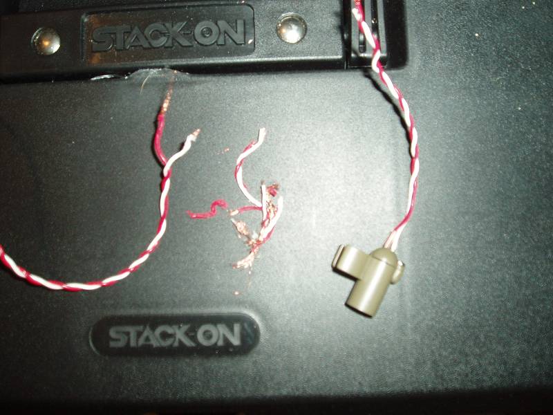

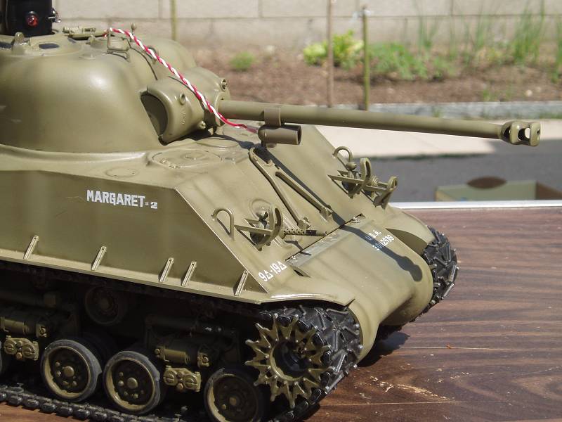

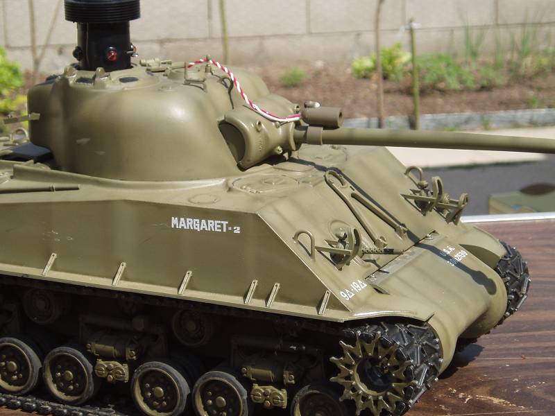

My Sherman wasn't accurately registering hits as well as my t34. The photo on the right ((TBU LED on top of gun barrel) shows an arrangement that didn't work well. The photo on the left (TBU LED on the bottom of the cannon) shows my current installation. A very simple modification that allows my Sherman to work as well as my t34, accurately registering hits from past 20 yards. But, in the most recent battle, my t34 suffered some injury. Stay tuned!

sownare:
A thought on your shooting problem - the clip is meant to attach to the Sherman 105 barrel, and its an even diameter ay that point, right?
Perhaps there is a slight taper to your longer one, and its causing the emitter to be partially blocked by the muzzle brake - the stock barrel had no brake, right? You might try putting a shim on the front edge of the clip, like a scrap of vinyl tape, to counter-act the angle of the barrel.
Other option is moving the emitter into the mantlet, but thats not an easy task after the kit has been assembled.

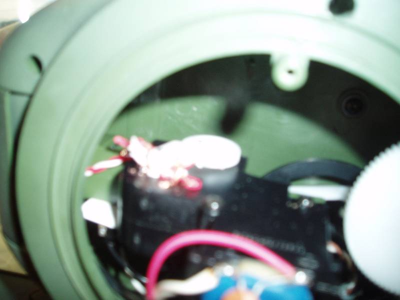

That's pretty much it . . . when the LED was on top of the barrel and either the cannon was slightly elevated or the tank was sitting on a slight incline in terrain, the barrel was indeed partially blocking the infrared beam from the LED. Putting the LED on the bottom of the barrel eliminates the cannon from getting in the way . . .
It felt great, in a guilty sort of way, as driver of the Sherman, perpetually scoring hits and knocking out the t34! It was, indeed, too good to be true. Since the t34 wasn't registering hits from point blank range, when it was hitting my Sherman from 20 yards out yesterday, sometheing had to be wrong. Popping out the hull and inspecting the turret revealed the problem.
The problem is the stock WSN canon recoil mechanism. Unlike the tamiya unit, the wsn unit uses a constant rotating arm to pull back the cannon. The rotating arm caught some loose wire of the LED unit and chewed it up. Man! This little recoil unit packs some powerful torque. It chewed up the wire so tight that I had to cut the bound wires and pull them out with pliers.
I'm debating installing the LED inside the hull like the Tiger one and not using the external mount. What do you guys think about this? How will affect the performance of the LED? Thank all!
