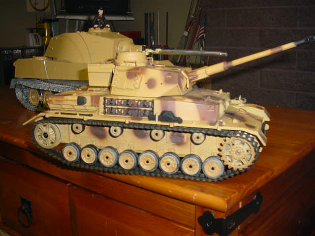

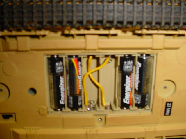

Bought one of those Cheap 49.00, Panzer IV From Walmart the other day for a Nephew that will be Visiting soon. Got it Home and had to try it out. (did not want to give the Nephew something that did not work). Wow That little sucker is Fast. No Control and throws Tracks almost as fast as i put it on the Ground. So I went to work checking it out for a possable trip to the Dump or maybe finding a Fix. What I found is that if you remove two AA batteries and solder wire in there place, Reducing the Voltage. Its a whole different tank. Much slower but yet still has power. More controlable and I have yet to throw a Track. Its actually Kinda Fun. Just thought i would pass that info on for all you Guys that bought one and shelved it shortly after.

pics please. im interested

I Think these might be the pics you wanted.

compare with this one, the tank in the background looks like junk.[&:]
Old 06-15-2006 | 12:32 PM
Bauer66's Avatar
Joined: Nov 2005
Posts: 611
From: Yakima, WA
Default RE: Corny Panzer from Walmart.
Well Tom.............................The tank in the Back ground is just mocked up and now ready for Paint. Wont Look like Junk for Long.

Tom why do you call the tank in the background junk, its not a henlong its a Tamiya KT, get some glasses

It throws track, runs like a spotted ape, and sheds it's hull skirts all over the yard! Didn't like the way it looked when I got it, so I did a whole bunch of modifications to it. All the skirts were done from styrene, and the hull was reworked because, the final drive gears scraped the sides as well as the screw posts. I'm lucky it still runs! I tried the 4 battery thing myself and the only problem was it didn't run for very long. If only they made better tracks (ones where the center guides were on ALL the links), it wouldn't be too bad a tank. That is, with speed control, a suspension, and a whole new radio system!

I run mine quite a bit, too. With 8 batteries, it will run forever! With the 4 batteries, it looks cool turning slower. I also reworked the 5th roadwheel back. On mine, both seemed out of line and lower than the others. It helped keep it from throwing track all the time, and released some of the track tension, too.

I actually liked it just the dark yellow, but decided to try a little camo. It had been a while since I painted an armor model.
When I sighted down the center of the road wheels, I noticed that 5th one wasn't lined up with the rest of them. I think they designed them to sit lower for pivot steering or something. The road wheels are secured with a friction pin and are very hard to remove! You either remove the pin, or remove the whole bogey piece!!!!! I ended up having to drill, pin, and glue one side because I broke the whole piece off. The other side just came right out.
