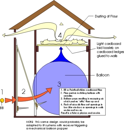

Okay, Tankers! I have just completed a design for an exploding building (non-lethal) special effect. It is untested as of yet - I plan to build a prototype hopefully this week and conduct some tests. I would like to share this with all Tankers here to see if someone may want to build a prototype and test also. With a few good minds working on this we may come with something workable that would add a dimension of realism to an outdoor battleground.
Or, maybe someone has already perfected something like this, if so, I missed it!
Here is a link to a page on my website with diagrams, feel free to print and do with as you like = hopefully improve upon the idea.
http://www.sheridangraphics.com/fx_tank.htm

I'm thinking a simple spring loaded trigger mechanism maybe a door lock actuator would work? Then using an IR receiver someone with some skill in electronics coudl work this pretty simply. I used to dabble in electronics but I bet there is something that could be cheaply. Would love to see some video of it in action.

Well, I had a little time today so I started hacking away at a cardboard box, found a bag of balloons (turned out to be very very small ones) and tried it out.
What I found was that the plastic BB just doesn't have the kinetic energy to push the cardboard flap hard enough to puncture the balloon. The weight of the BB is only around 12-15 grams, so even though it hits the cardboard with enough force to dent it, there just isn't enough mass to follow through. The cardboard flap absorbs the energy and, although it does push the flap, it is just not enough to push the pin into the balloon.
I have read somewhere that you can get BB's up to 20 or more grams. I don't know if that will be enough to do the job. On a more positive note, it doesn't take much more energy to do the trick. And when the balloon bursts it does send the flour "smoke" flying out all the box cutouts - looks pretty darn good!. I will try resting the pin on the balloon in a test tomorrow, I think that way the energy will go directly to the balloon without the "travel" shown in the original design.
I'm also thinking that it would not be that hard to make a "strike plate" switch which could be used to electrically actuate the effect. I'm thinking this one through now and will post any progress as I can. If anyone else is trying this please post your findings.

What are you using for a pin? Maybe with something that is small in dia and super sharp it might work? Was thinking maybe a straight pin for sewing? Trick might be to keep the tension of the cardboard/pin from not puncturing then I suppose.
RE: Special Effects Design
Maybe if the flap in the cardboard were cut so that the "hinged" side was on bottom, it would work better. You could attach the pin as well as a lead weight to the flap and let gravity help you pop the balloon. As long as the cardboard is a snug fit against the moving part it will stay up, but when the projectile hits it there should be enough energy transfer to put the flap in motion.

See! Get the great minds here working and solutions abound! Great idea! Now, why didn't I think of that! Ever since I started thinking about this all kinds of new and interesting ideas have been bouncing around in my head. But first things first! I'll try the weighted flap idea today and as shelden3 mentioned - he is probably right in that I am not using a straight pin but was using a nail (small brad). The weight of the nail was probably counter-productive in trying to push the flap up, but would be an advantage if the flap is pushed down!
By the way, since this is a prototype, I haven't spent much time on aesthetics, but I did put a coating of Stonewall on the front of the box.
During my test firing yesterday I found that the BB hits the plaster like covering with enough force to chip the coating off the box!! If I under coat with paint the visual effect would be convincing damage to the building.

IT WORKS! Thanks to Icrecreamslick's suggestion! A little cumbersome to set up, but with the weighted flap and pin device set to fall down on the balloon instead of being pushed into the balloon it works great. The balloon popped after two BB shots to dislodge the flap hanger and POW! Flour dust came out of the window cutouts just fine (don't try this in the house!). Now all that is left is to try to work out a little more sophisticated flap and pin latch and some sort of tray for the flour that will be even more affected by the air burst - It is a good start and I'm sure it will lead to even better devices to do more varied effects. I don't have a video camera but I will post an updated drawing and some photos when I get the "building" a little more presentable - right now it just looks like a cardboard box with rectangle cut-outs.
Now, if someone can figure out a way to pump the balloon full of smoke.... or maybe put the flour in the balloon?
