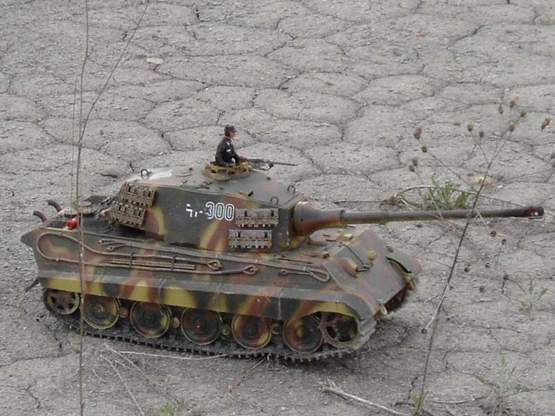

Here's a pic of one of my KT's...no zimm.

Yeah, I got my Battle Systems mixed up, that TBS is for my Tiger which is painted dark yellow (XF60) while the KT is a base of Desert Yellow (XF 59) with a brown enamel wash then drybrushed metallic grey.
